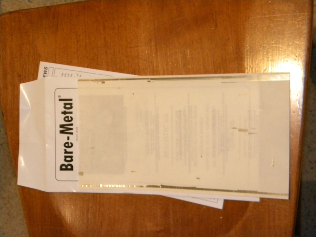

StevenGuthmiller Posted March 4, 2016 Posted March 4, 2016 Thanks for all the replies, fellas. There's a lot of food for thought here, and I've bookmarked this thread for future reference. (Perhaps this is one reason I like the 30's cars that I do, very little chrome to fiddle with.)Kevin.I just took a second look at your photo above & noticed something that may be causing some of your problems.There are a ton of wrinkles in the sheet laying under the GTX body.Those wrinkles translate into a cracked foil & consequently wrinkles in the trim. Obviously, some where along the line, that sheet of foil was not treated with the care it needs.BMF foil should be kept absolutely flat.Any bending or rolling can produce those wrinkles & cracks & create havoc with your foil jobs.Just an observation that may help out. Steve

Roadrunner Posted March 4, 2016 Author Posted March 4, 2016 OK, Steve, Richard, points taken. Steve, the sheet is just a few months old and arrived that way. All the wrinkles run lengthwise, so I make all my cuts in the same direction. Those wrinkles are bad enough that if I cut across them, the strips just break at those wrinkles, every time.I always try to store the stuff dead flat, and try to take care not to bend it all to heck. I have a brand new sheet of aluminum (not chrome) here right now, but haven't looked at it yet to see if it too is damaged or not. If it is, I may just have to seek out a new vendor.

StevenGuthmiller Posted March 4, 2016 Posted March 4, 2016 All the wrinkles run lengthwise, so I make all my cuts in the same direction. Those wrinkles are bad enough that if I cut across them, the strips just break at those wrinkles, every time.That's the right approach Kevin.If you have those cracks, you definitely can't cut across them. I'm not sure why the cracks appear sometimes.I've had the same issue occasionally, but never on the scale that yours has.I always assumed that it happened because of too much "flexing" of the sheet. Steve
