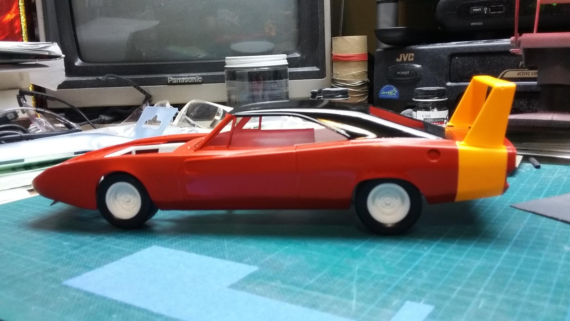

mikemopar70 Posted June 14, 2016 Author Posted June 14, 2016 (edited) Hi everyone! Finally a little update on my project. Something was bugging me with the front fenders, they looked wrong and not looking like the NASCAR thing, so i modified them a bit by cuting the down portion and straightened a bit outwards before putting filler and primer again... And finally there's some paint on the body, after applying the last primer coat , i shot the first coat of red lacquer (Tamiya bright red). I decanted the lacquer and shot it with my airbrush, note that i didn't do the top since it's gonna be flat black... I will sand the paint next week-end, after a week of drying time, before shooting the second red coat o the body. Edited June 14, 2016 by mikemopar70

mikemopar70 Posted July 20, 2016 Author Posted July 20, 2016 (edited) Hi Folks! It's been a while since my last post, i had less time to be at the workbench lately, but i managed to get some work on my Daytona... I woked more on the body colors, can't wait to get this cleared with urethane. I shot a coat of black (gloss base coat) on the top, because there will be a large #6 sticker, i will shoot a flat clearcoat when done. And i done the rear Daytona Stripe, with a Auto Air fluorescent orange like the real car had back in the day, lots of masking have been involved, but i'm pretty much satisfied with the result. Next step, i will do Bare Metal Foil and top decal before clearing. See ya, and have great summer vacations everyone. Edited July 20, 2016 by mikemopar70
