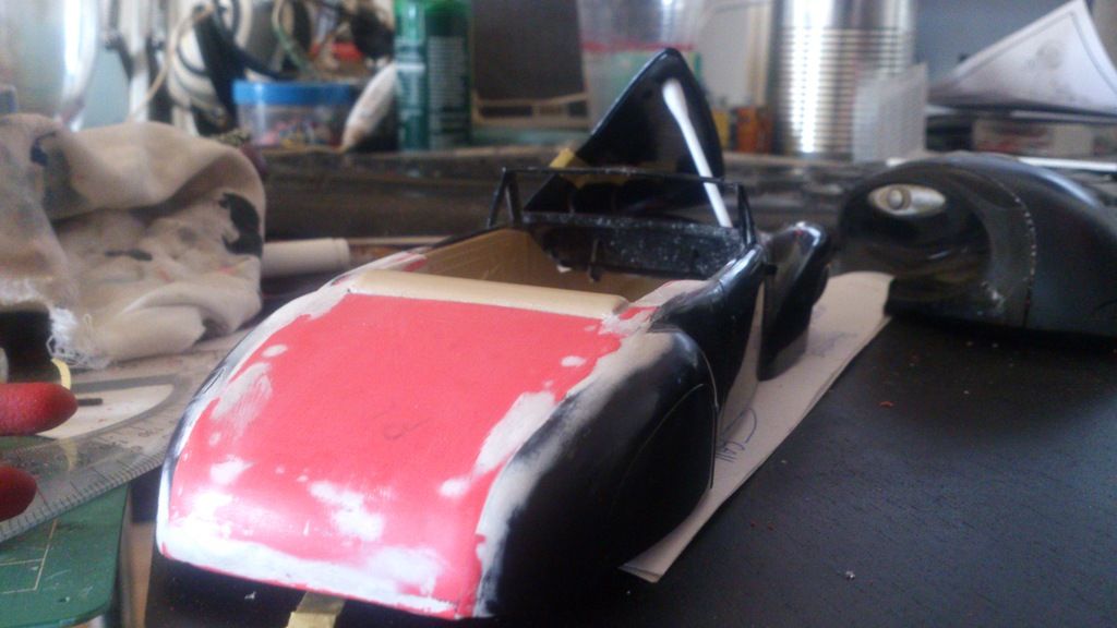

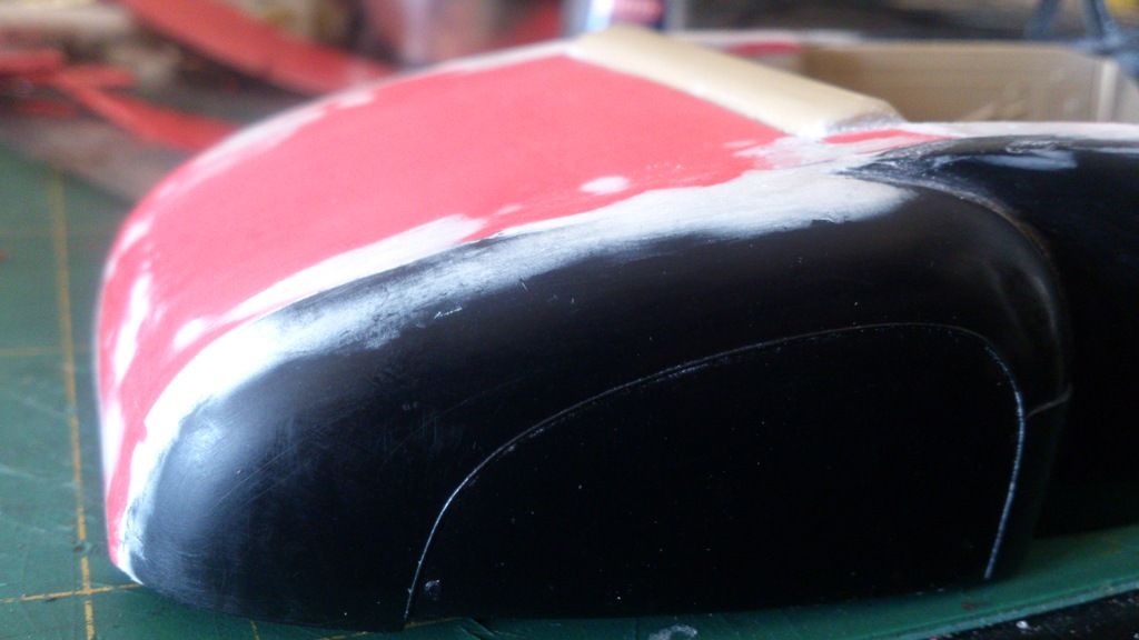

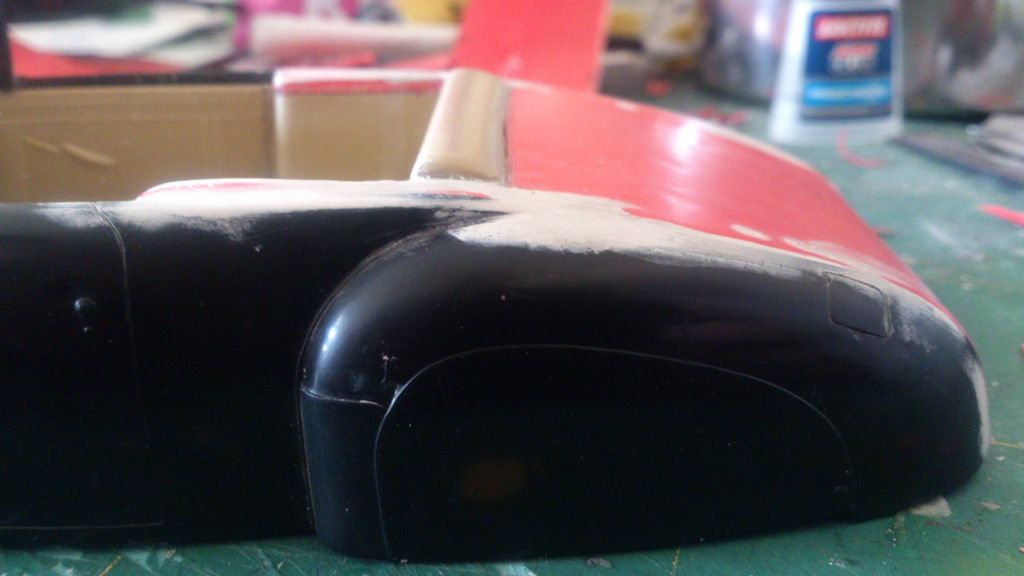

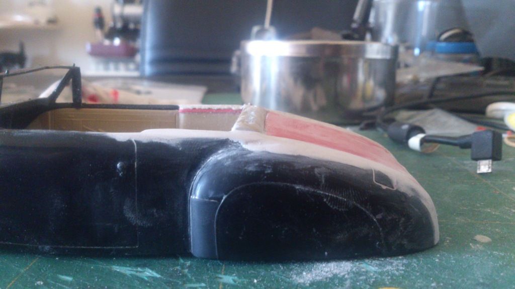

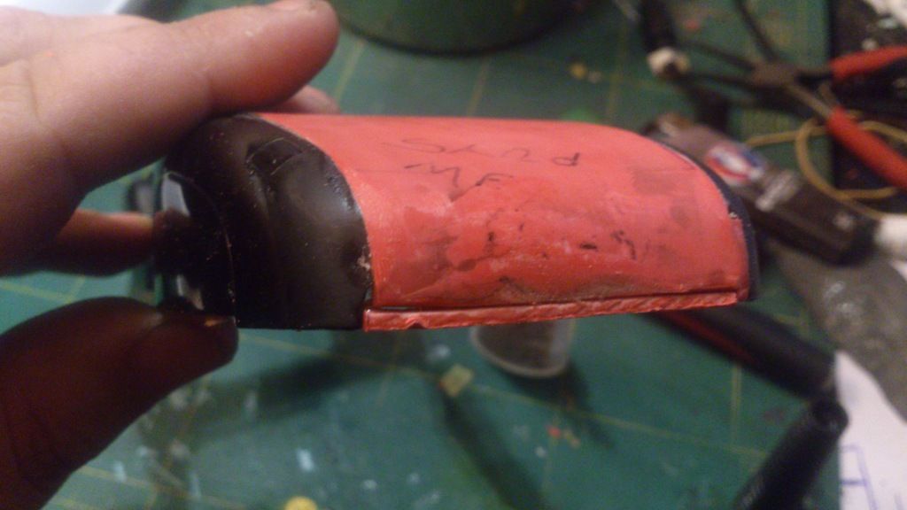

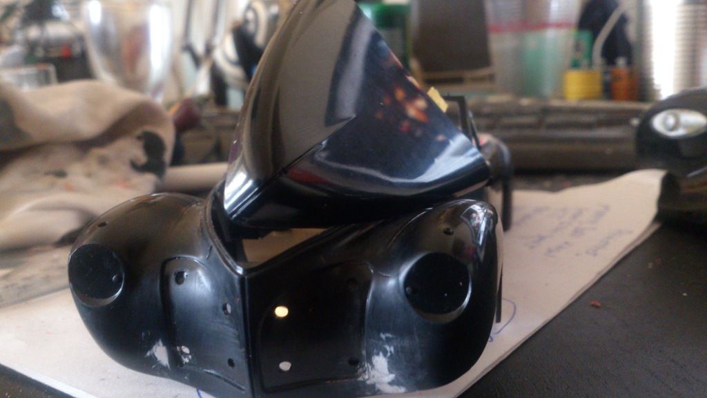

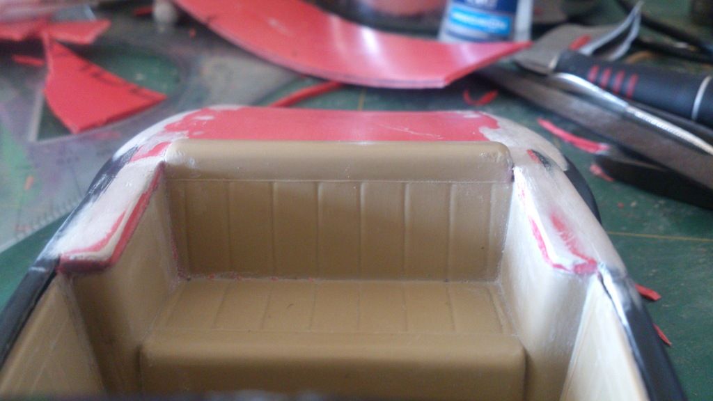

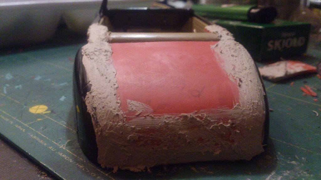

The Danish sprue wrangler Posted April 30, 2016 Author Posted April 30, 2016 Live from The west coast in Europe its John with the Way past bedtime "Progress report" been sanding like a Mad man for hours and also added another strip of plastic in the bottom of the back to make it flush with the fenders Unfortunately i had to glue in the interior at this point because of the way i chose to build it earlier . this will be a bit annoying when it comes to painting . but ok this Build also gave me my first chance to pull out the Putty and i just Might have used a bit Much . i call it part of the Learning Curb soo alot more sanding in my near future . na na na All together Now ,,,,"Hooray for paper with sand glued to it" like i said way past bedtime .

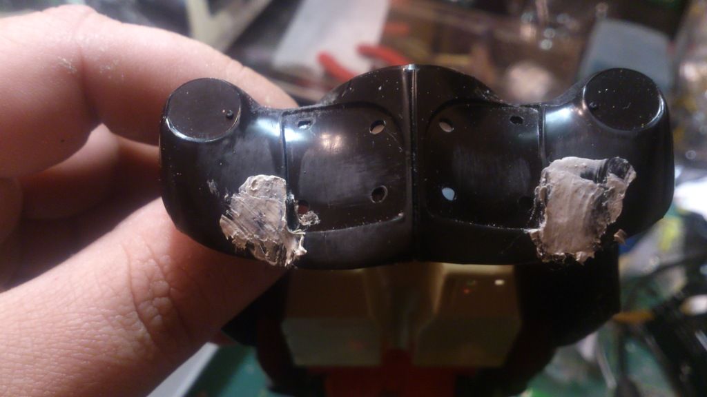

charlesdcamden Posted May 1, 2016 Posted May 1, 2016 Just a small tip Sprue, since i also just recently began messing with the contour putty.... Let that stuff cure up for like 3 days before you start to sand on it. Itll come off much smoother and leave a better surface. And always remember that primer is your best friend when finding low spots looking good so far!

The Danish sprue wrangler Posted May 1, 2016 Author Posted May 1, 2016 Just a small tip Sprue, since i also just recently began messing with the contour putty.... Let that stuff cure up for like 3 days before you start to sand on it. Itll come off much smoother and leave a better surface. And always remember that primer is your best friend when finding low spots looking good so far! hey thanks for the tip. now i only did let it cure over night . but its still good comes of as a very fine powder .result seams to be pretty smooth . i just had to re-putty some very small holes and im thinking it will be good to finish tomorrow ... im using Revell Plasto putty ..

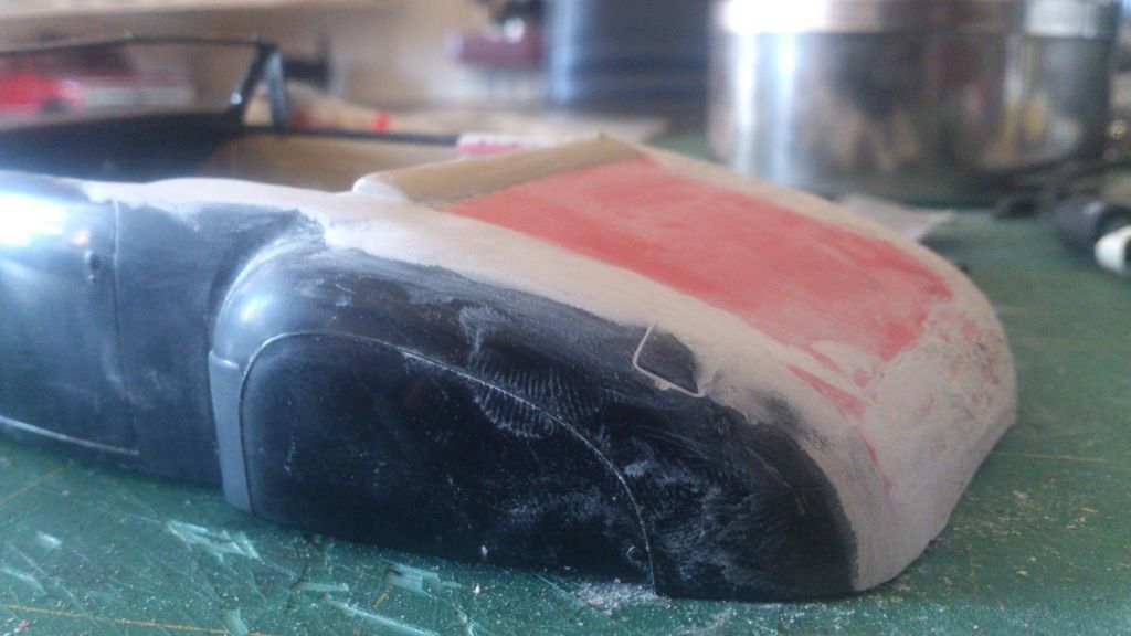

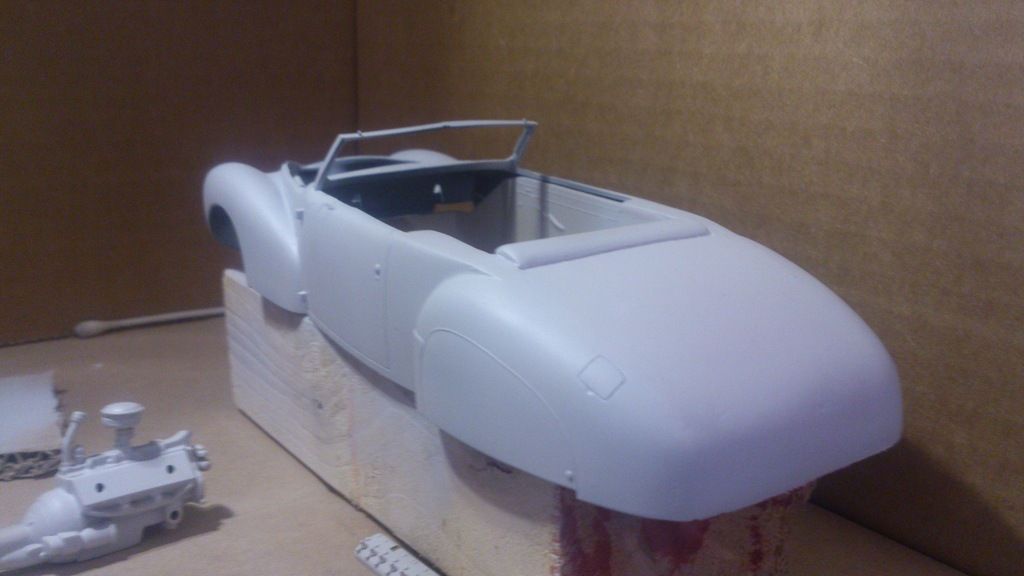

The Danish sprue wrangler Posted May 2, 2016 Author Posted May 2, 2016 been sanding alot and applying more putty and sanding some more . im real close to beeing ready for primer . so this is where i am now . feeling good about it so far . and this showed up during the weekend sooo that means this will be the first car that get airbrushed , cant wait

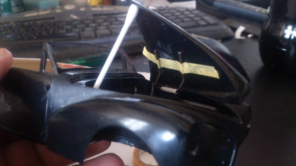

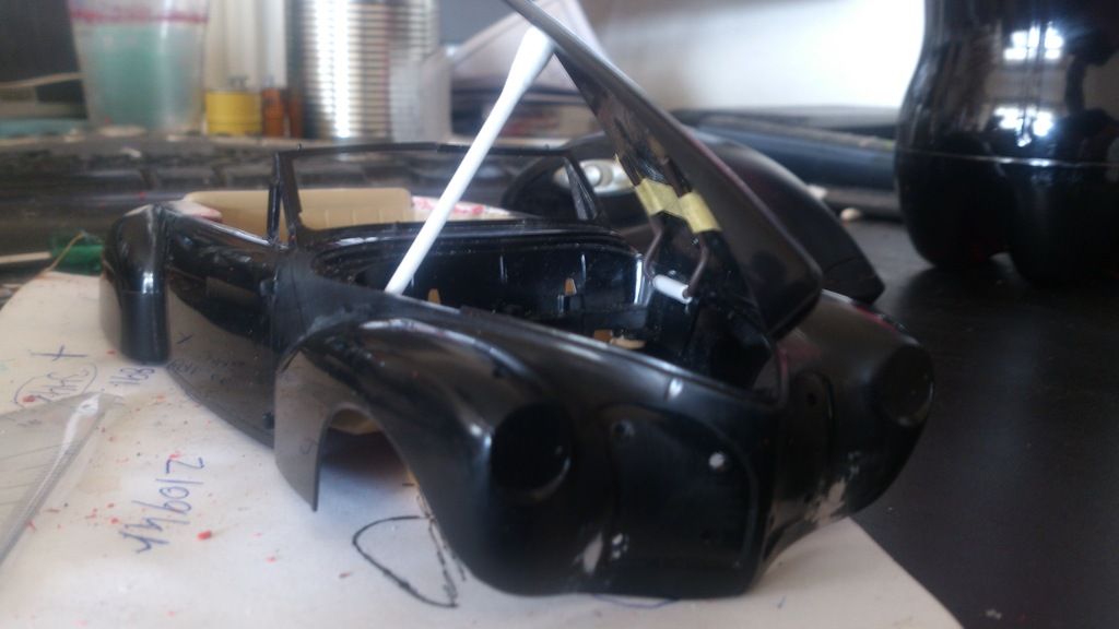

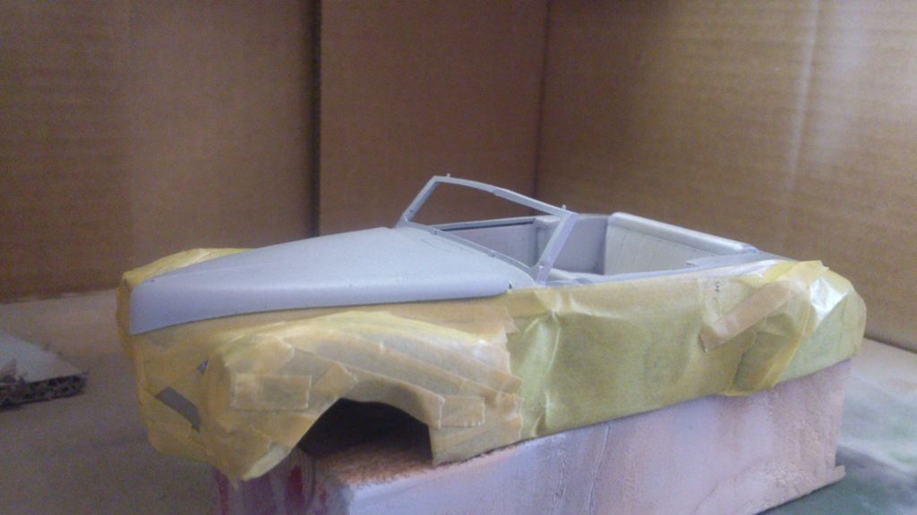

The Danish sprue wrangler Posted May 2, 2016 Author Posted May 2, 2016 (edited) going for a side opening hood . i think it looks good . Edited May 2, 2016 by The Danish sprue wrangler

IHSS Posted May 4, 2016 Posted May 4, 2016 Thats looking awsome John. Can't wait to see it in the under glass section. Just a small tip on applying putty. When you get credit card offer's in the mail, save the fake credit card and cut it up to use as a spreader. You can get a smoother application that makes it easier to sand and not use as much putty in the process.
Rider Posted May 4, 2016 Posted May 4, 2016 Welcome to the AB world side of model painting, nice looking kit there.The build is looking great, I have alway like the look of a side opening hood, just always think of how you service the master cylinder, change plug, etc on that side. I guess you just climb right in there.

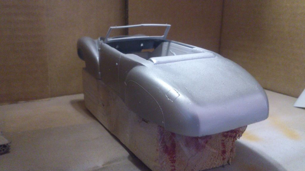

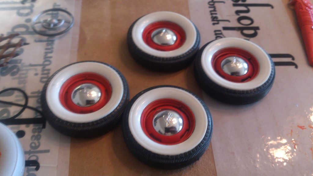

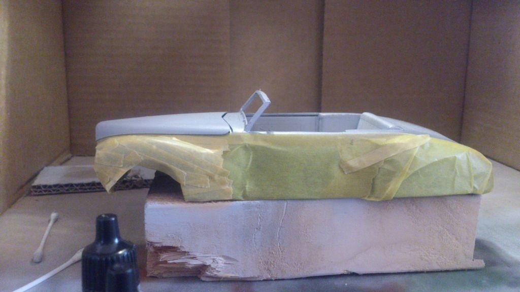

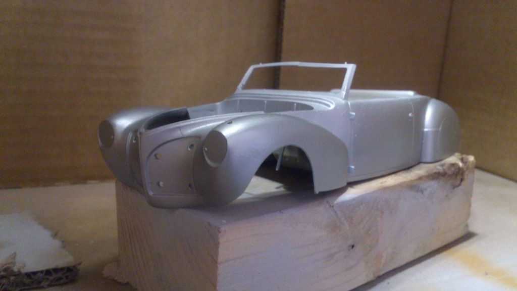

The Danish sprue wrangler Posted May 4, 2016 Author Posted May 4, 2016 soo I have been busy . and also a little anxious to start the painting process with the new air brush system . but jumped right in now . got her in primer . and then some silver then went to work on some of the small bits the airbrush is awesome much smoother finish on parts and then taped the body up for color two .. I also just happened to start a little side project wich I will reveal with the car . and I know the paint or even the putty work is not perfect but I really feel like. as everything on this build is a first for me its ok . I'm glad you all follow this build . I'm doing my best to make it a beauty
