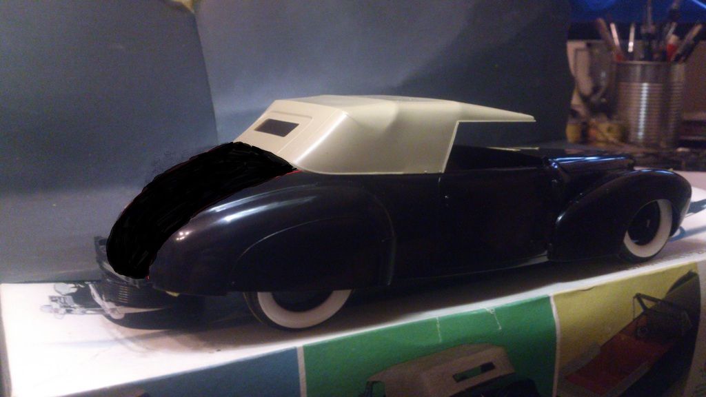

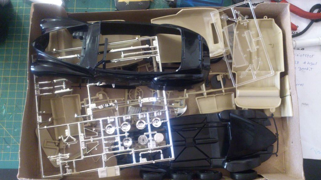

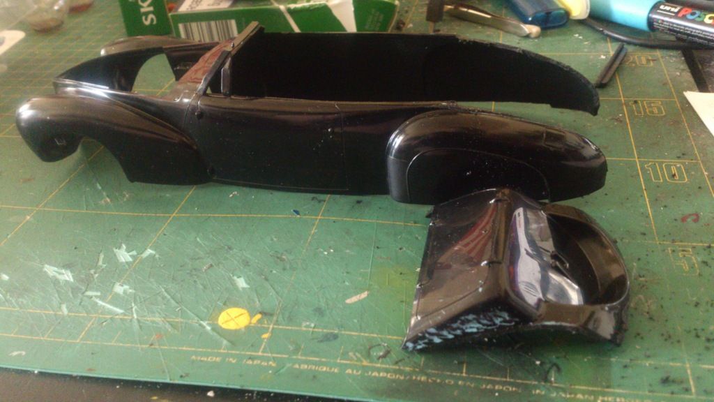

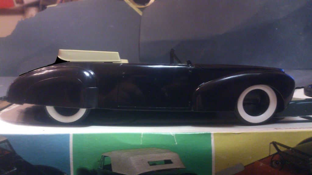

The Danish sprue wrangler Posted April 27, 2016 Share Posted April 27, 2016 (edited) just getting ready for this one . so i thought i would make a build tread for it .. its a complete 1972 kit but weirdly enough there is some extra parts in the box . like extra roofs both cab and vinyltop and there is also extra axles and a extra interior tub . might come in handy in the future for other builds . i like the look of the 41 but i really cant stand that Humpback whale style trunk .it just has too much junk in the trunk . so ive decided to cut it of and just give the whole car more of a custom rod look. will possible also fill in all bumper mounting holes . just make the body really clean. and do something fancy with the hood . colors i dont know yet and ofcourse it will be lowered the body in the kit has a broken a pillar but its in the kit so it can be fixed . here,s what im thinking with the trunk let me know what you think . and ideas is always welcome . Edited April 27, 2016 by The Danish sprue wrangler Quote Link to comment Share on other sites More sharing options...

62rebel Posted April 27, 2016 Share Posted April 27, 2016 If I were taking the boot off, I'd leave the roof off as well, and contour the deck using the deck from a '40 Ford. Losing the bumpers? I could go either way on that, once the slope is established. I built three or four of these over the years, wouldn't mind trying another even though it's a BIG car in 1/24 around my 1/25 builds. So were the Packard, Rolls, and Duesenberg I had.... ex-girlfriends have/had them after I got tired of them. Quote Link to comment Share on other sites More sharing options...
The Danish sprue wrangler Posted April 28, 2016 Author Share Posted April 28, 2016 If I were taking the boot off, I'd leave the roof off as well, and contour the deck using the deck from a '40 Ford. Losing the bumpers? I could go either way on that, once the slope is established. I built three or four of these over the years, wouldn't mind trying another even though it's a BIG car in 1/24 around my 1/25 builds. So were the Packard, Rolls, and Duesenberg I had.... ex-girlfriends have/had them after I got tired of them.yes the roof will stay off . it just looks better / cleaner dont know about the 40, ford thing . would have to get one first but ill look into it .as for the bumpers we will see when we get to that .and yes this car is massive beside the other models . Quote Link to comment Share on other sites More sharing options...

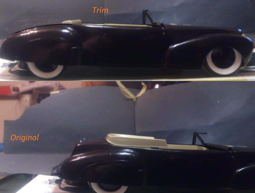

charlesdcamden Posted April 29, 2016 Share Posted April 29, 2016 You get an A+ for hump removal.... It looks more like the long decklid of the 40 fords which makes those cars sooooo sexy lol. Keep it up! Quote Link to comment Share on other sites More sharing options...
62rebel Posted April 29, 2016 Share Posted April 29, 2016 The hump makes it a Continental, but Sprue isn't building a Continental... I see it reverting somewhat to it's Zephyr origins... and Zephyr's were swoopy cars.. beautiful, sleek beasts. Quote Link to comment Share on other sites More sharing options...
mod3l Lover Posted April 29, 2016 Share Posted April 29, 2016 The 40 Ford idea is right on the money! Before even reading throughthis thread I was thinking that the contours of the deck area had 40 Fordwritten all over them. I think a chunk out of the deck from a 40 Ford wouldn't take much tofit it into the void there. David S. Quote Link to comment Share on other sites More sharing options...

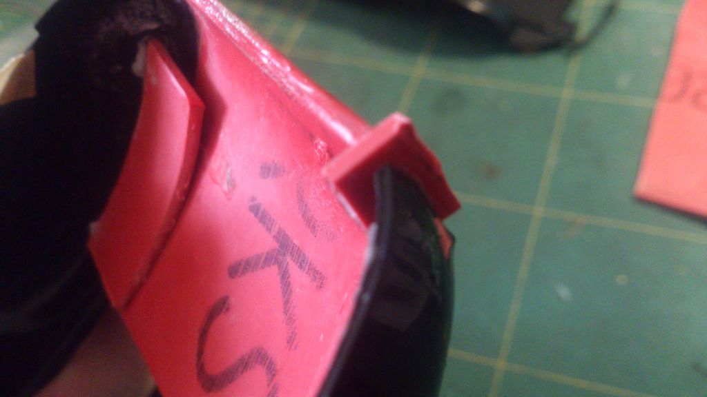

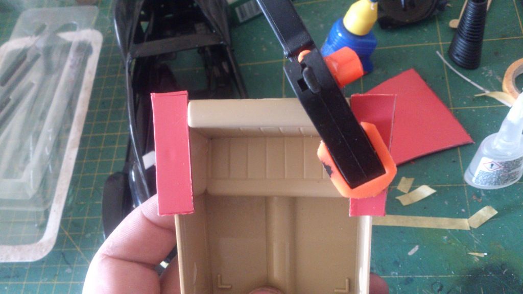

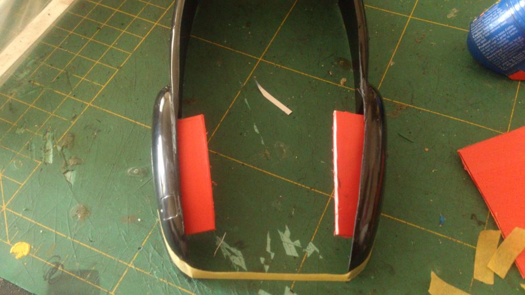

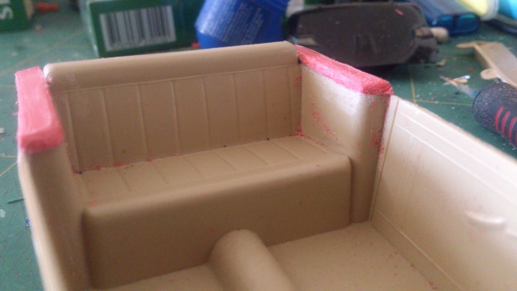

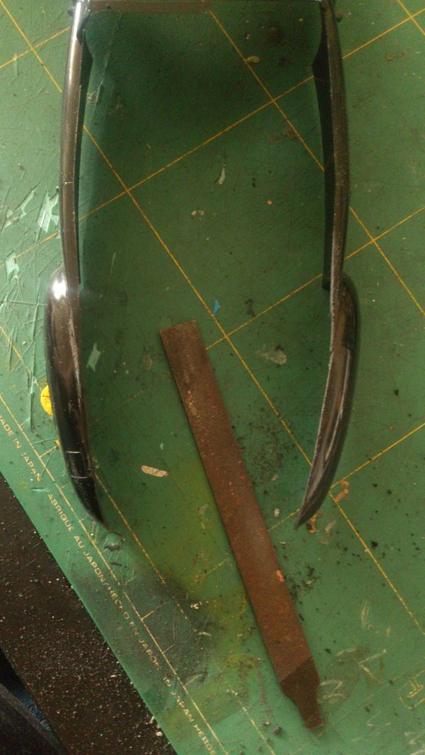

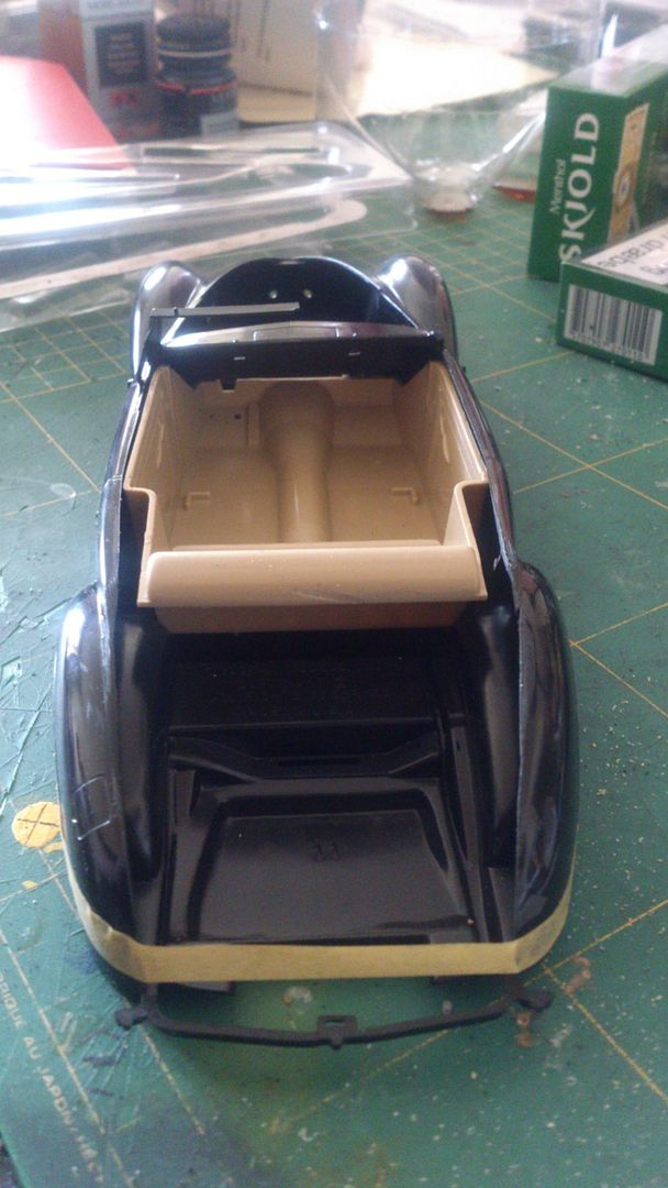

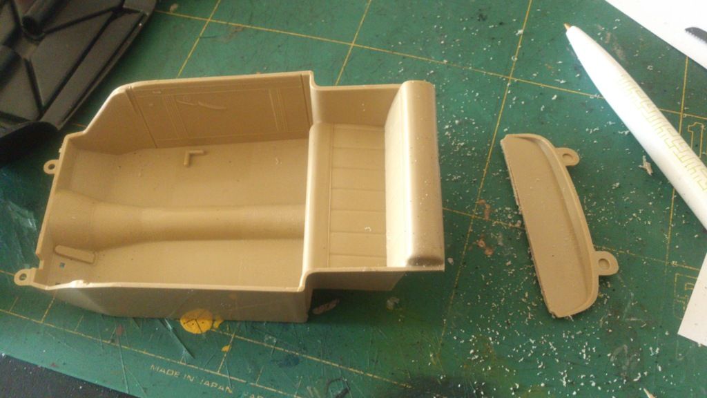

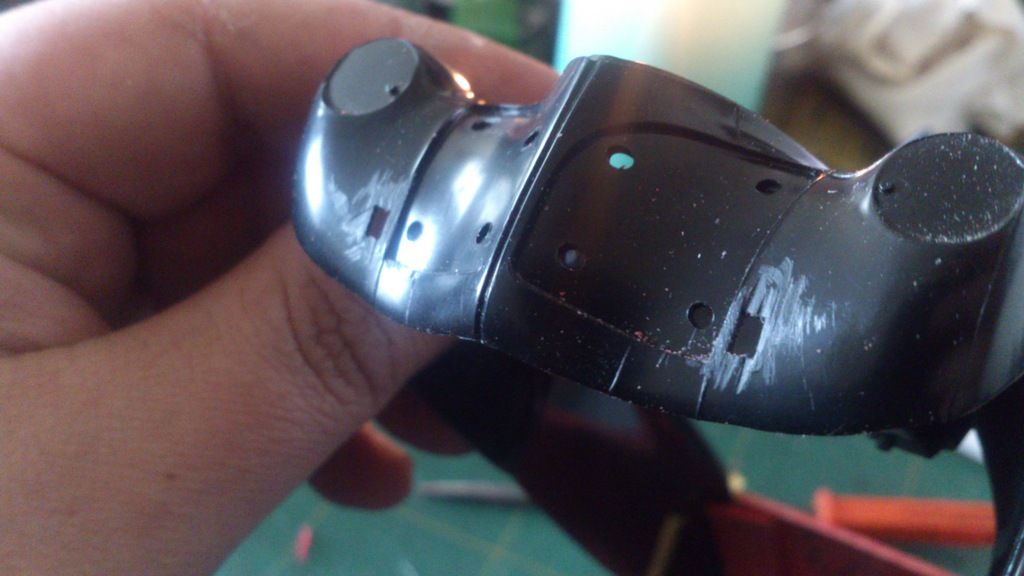

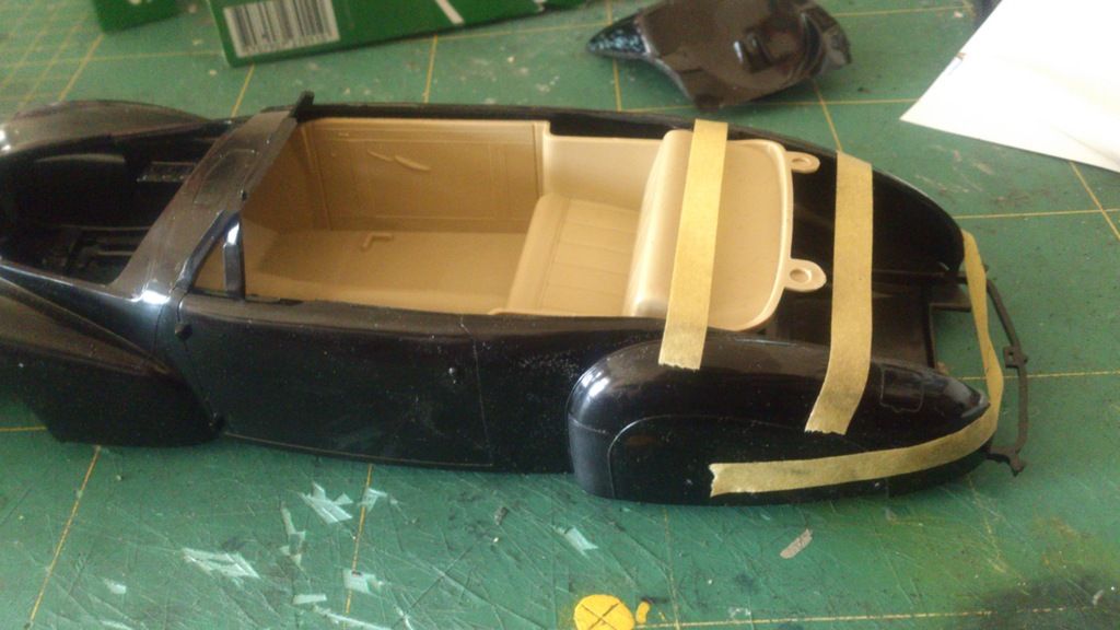

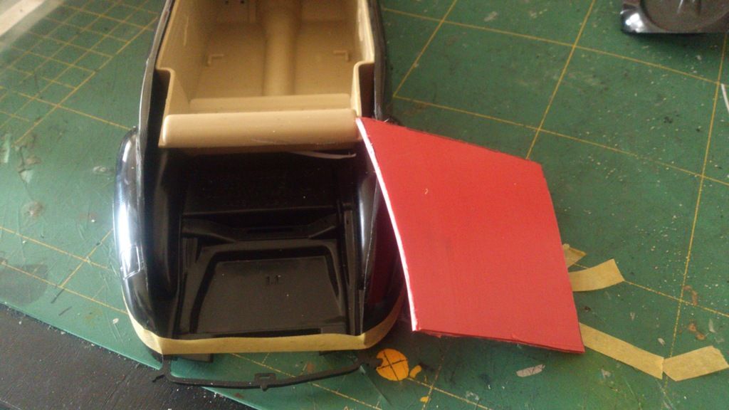

The Danish sprue wrangler Posted April 29, 2016 Author Share Posted April 29, 2016 woooh alot of interest in this one i see . well awesome then apperently im building a Zephyr custom now .ha ha . well lets get to it have got a little work done . cut the lid out filed the edges test fit interior had to trim the shelf need to fill in those holes where the soft-top would fold down and sanded them to the right shape Quote Link to comment Share on other sites More sharing options...

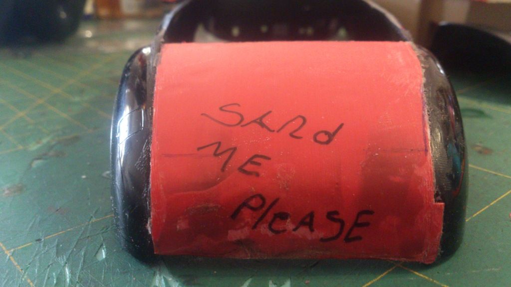

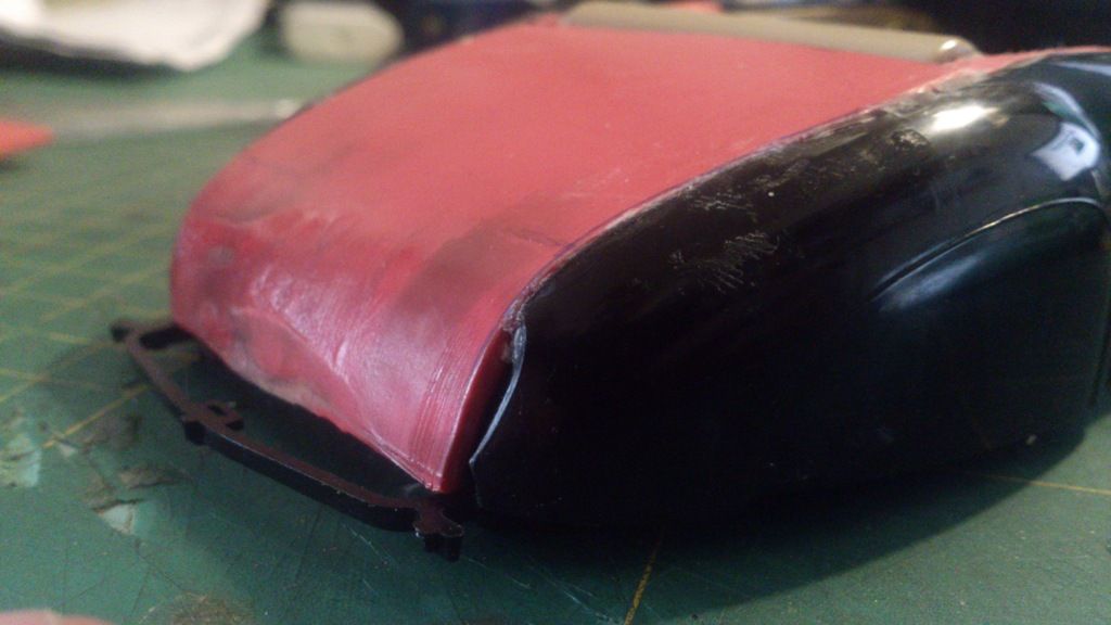

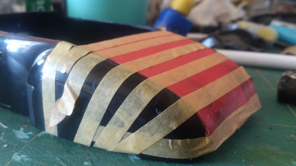

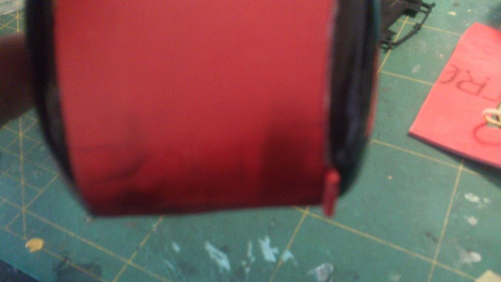

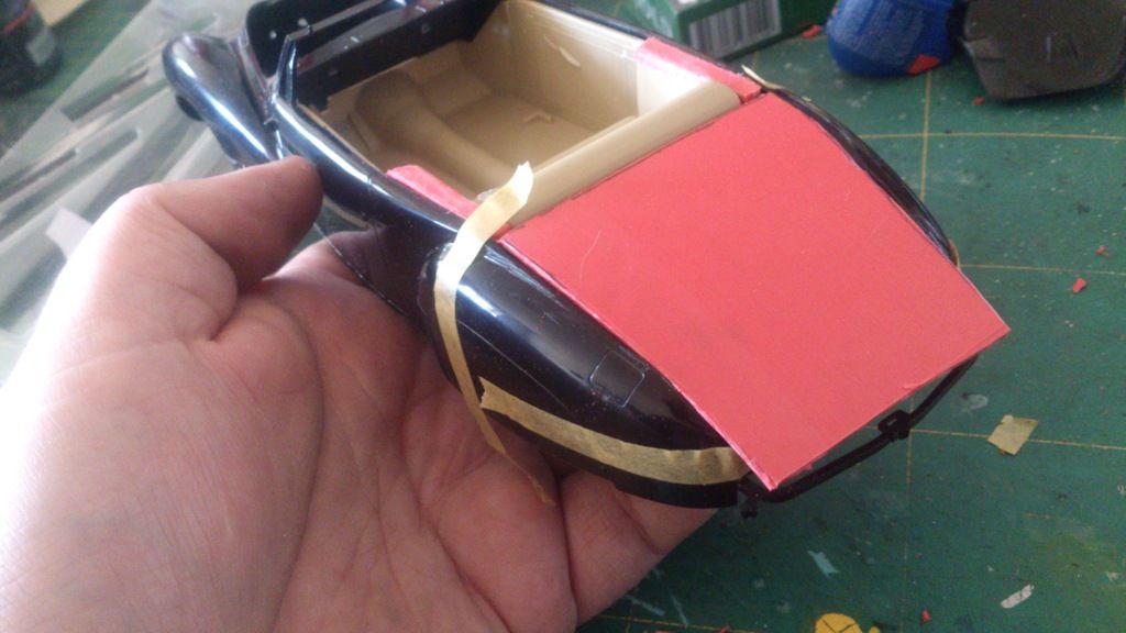

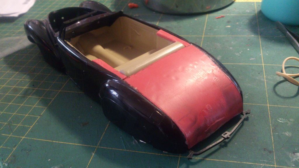

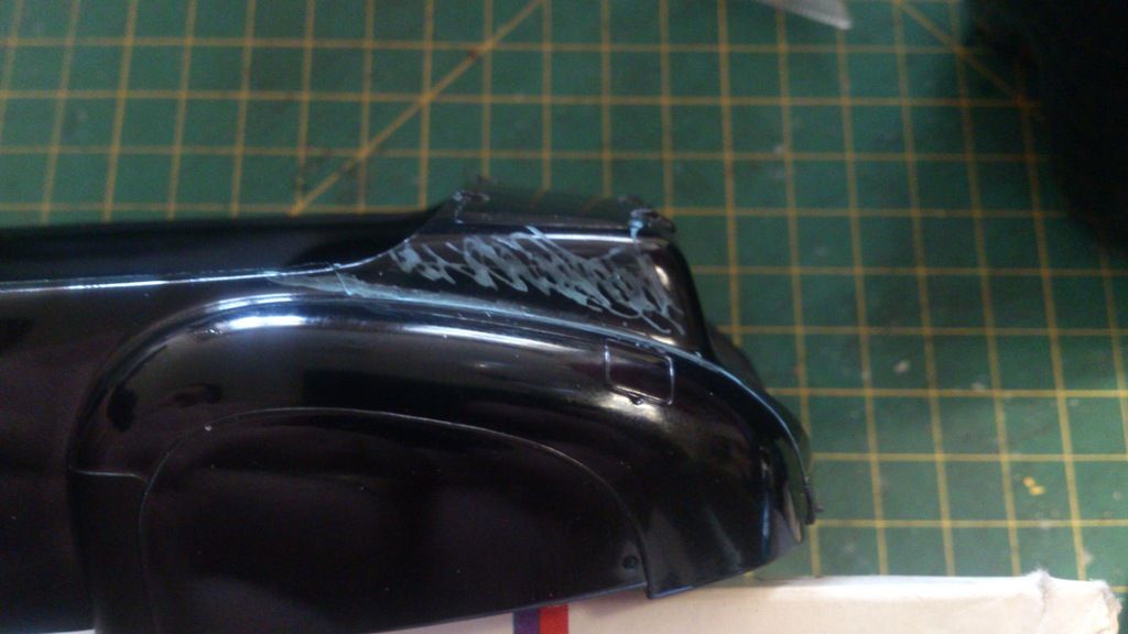

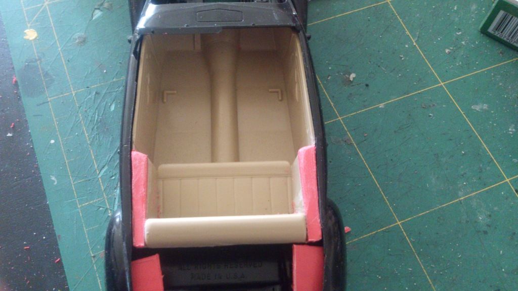

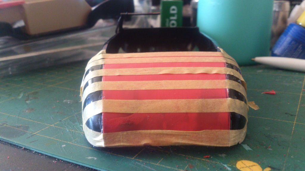

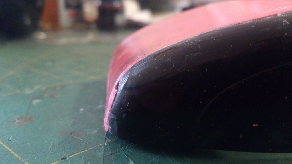

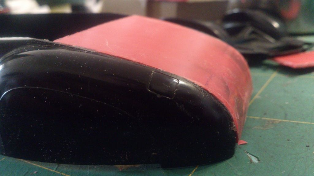

The Danish sprue wrangler Posted April 29, 2016 Author Share Posted April 29, 2016 (edited) continue . a little support for the new lid cut out a new lid from som thick bendable plastic . i got a whole big roll of it and its good for building.. starting to glue it in .and will bend it slowly to the contour still had to use a candle to heat the plate to make it bend that much the tape helped keep it in place while glue dried . hey this isent half bad i think . body got a little heat damage from the candle on this corner . fixing it by putting in a little piece of plastic and cut it down so this isent bad i think. never done anything like it before its only my 4th model also filed down the mounting holes for the bumper i want it clean so they will be filled in . it needs more work with bondo all over . but for now ITS JUST ASKING FOR IT Edited April 29, 2016 by The Danish sprue wrangler Quote Link to comment Share on other sites More sharing options...
The Danish sprue wrangler Posted April 29, 2016 Author Share Posted April 29, 2016 i know it looks rough right now but im sure it will be good with bondo and alot of sanding Quote Link to comment Share on other sites More sharing options...

GerN Posted April 29, 2016 Share Posted April 29, 2016 You're brave doing a custom for your fourth model. Good start with the new trunk area. A candle!?! More bravery! What kind of plastic did you use? I try to make sure body parts are very well attached and supported I often use super glue plus baking soda for an easy reinforcement on the back side where it won't show. Helps to avoid problems when I'm cutting, shaping and so forth. Quote Link to comment Share on other sites More sharing options...
The Danish sprue wrangler Posted April 29, 2016 Author Share Posted April 29, 2016 You're brave doing a custom for your fourth model. Good start with the new trunk area. A candle!?! More bravery! What kind of plastic did you use? I try to make sure body parts are very well attached and supported I often use super glue plus baking soda for an easy reinforcement on the back side where it won't show. Helps to avoid problems when I'm cutting, shaping and so forth.Thanks Gerald . i havent build any of the last 3 models box stock either . afterall its only plastic allmost anything can be fixed. but i guess i just jumped right into the hobby with an aditude of just go for it. learning by doin as i go yep a Candle to heat up parts and bend em works good if you are careful. the plastic i use is actually .......how do i explain it . well do you know when they dig trenches for laying down high voltage electrical cables they always lay down a plastic sheet on top of the cable before filling in dirt . so you wont cut the cable with a shovel later on when you are digging around the garden or house. i got a big 30 meter roll of that from work and its perfect for building the one i got is 2mm thick but they come in many sizes. i will order some styrene too but this was free and its gets the job done and i have alot of it . and yes i used superglue for the trunk too . dident know about the backing powder i guess that works as a activator to make it cure faster . . Quote Link to comment Share on other sites More sharing options...

misterNNL Posted April 29, 2016 Share Posted April 29, 2016 John you are a brave man to attempt such a complicated body modification on your fourth model.That rear deck replacement is not easy task no matter how you do it.It would be cool to build it in low rider style with an extended rear bumper shelf and a old school continental kit. Quote Link to comment Share on other sites More sharing options...
The Danish sprue wrangler Posted April 29, 2016 Author Share Posted April 29, 2016 (edited) John you are a brave man to attempt such a complicated body modification on your fourth model.That rear deck replacement is not easy task no matter how you do it.It would be cool to build it in low rider style with an extended rear bumper shelf and a old school continental kit.so they tell me . i dont know really just had a idea and went for it. pretty much how i do alot of things. some times you fail but the rest of the time is pretty good and you can only learn and gain experience by trying. you will never succeed if you are scared of trying anything for the first time. ( the biggest difference between a master and a quitter is that the Master have failed more times than the quitter have even tried )and lowrider style hmmm im not sure . but i wont write anything off Edited April 29, 2016 by The Danish sprue wrangler Quote Link to comment Share on other sites More sharing options...
