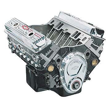

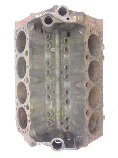

The photos (below) show typical smallblock Chebby blocks. They're all about the same, so all you need to do is to make those ledges on the ends of the block that protrude from under the heads look more like the real block casting. Reference photos abound as to what it SHOULD look like.

LOOK at the photos of the real blocks. :D
The block needs to be modified to look like the real one.
That huge ledge at the rear of the driver's side of the model block isn't there on a real block.
There's also not as much meat at the front of the passenger side of a real block as there is on the model block.
LOOK and compare the shapes.
