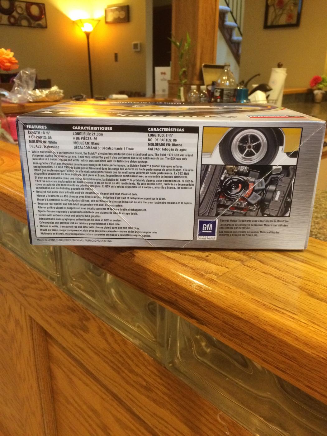

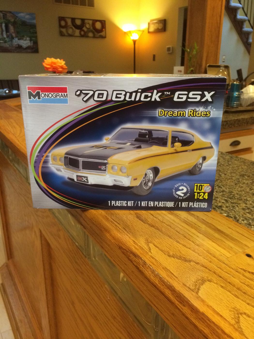

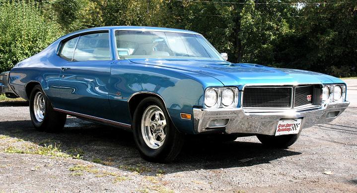

JerseeJerry55 Posted May 20, 2016 Posted May 20, 2016 Hello all. My Monogram 1970 GSX has finally arrived from Hobbylinc. Pretty excited about it. As I have previously posted its my first car model in 30 or so years so I think the basic build should take place. Tamiya Royal Blue with a black interior. I thought about a white interior but that may be reserved for when I am more experienced. I will post my progress as it goes (hopefully it goes well). Planning on doing it as a 1970 GS as the GSX decals have me a bit skiddish as does photetched parts. Thanks for looking.

JerseeJerry55 Posted May 21, 2016 Author Posted May 21, 2016 Enjoy it. I recently started my first model in about 30 years too. Now I have four started. Eventually I will finish one. Plan out what gets painted the same color and paint them all it once. Most things can be stripped and redone if you aren't happy with it. Test fit the pieces before you paint and make adjustments as needed. Next thing you know, you will have a complete model. Thanks. I am really looking forward to this build. Have chosen to build as a GS Stage 1 rather than the GSX. So no spoiler or body colored headlight bucket covers. Have chosen to paint her a Royal Blue similar to the picture I uploaded. Although my model will have a Black interior whereas the picture shows a White interior. I picked up Testors rattle can royal blue, flat black, and their grey primer last night. Have read that Testors may be a no no these days. Anybody's thoughts on the paint brand will be welcomed. Gonna be raining here in South Jersey over the next 4 days so the painting will be put off a bit. So if I'm making a mistake on the paint brand I can return it,
GMCMAN52 Posted May 21, 2016 Posted May 21, 2016 That blue Buick is just too sweet, Can't wait to see your progress

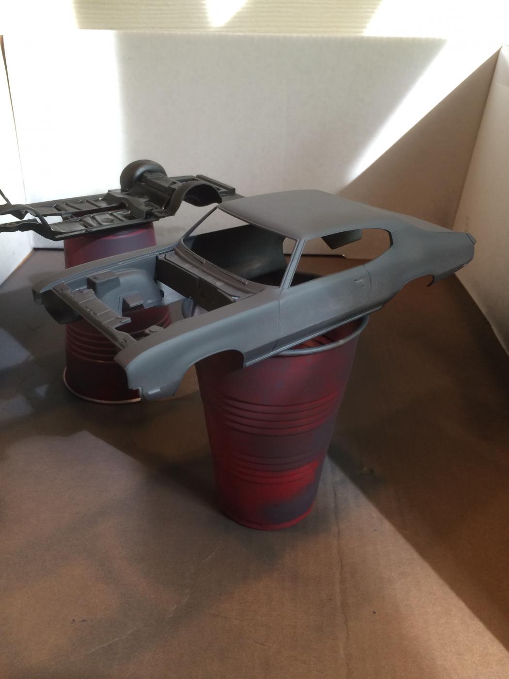

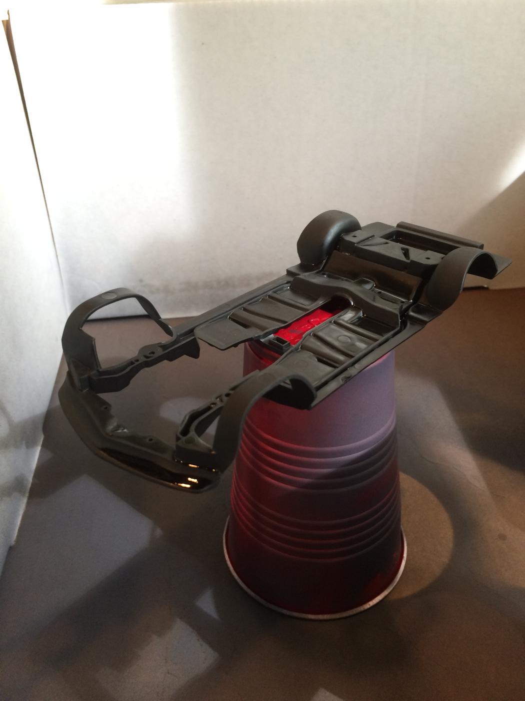

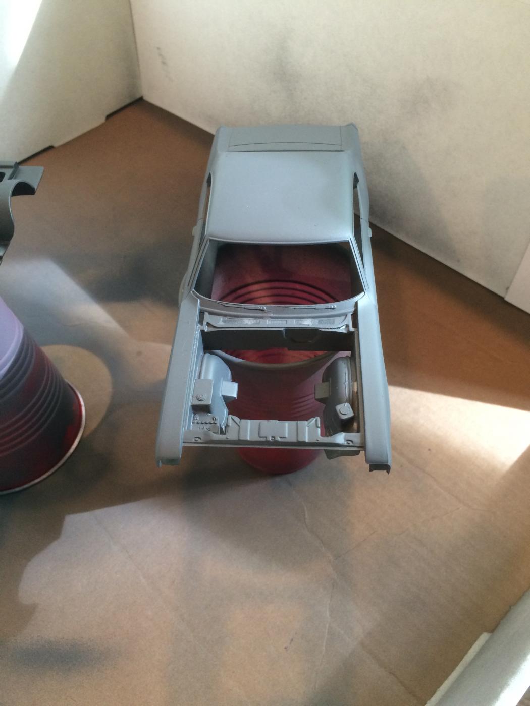

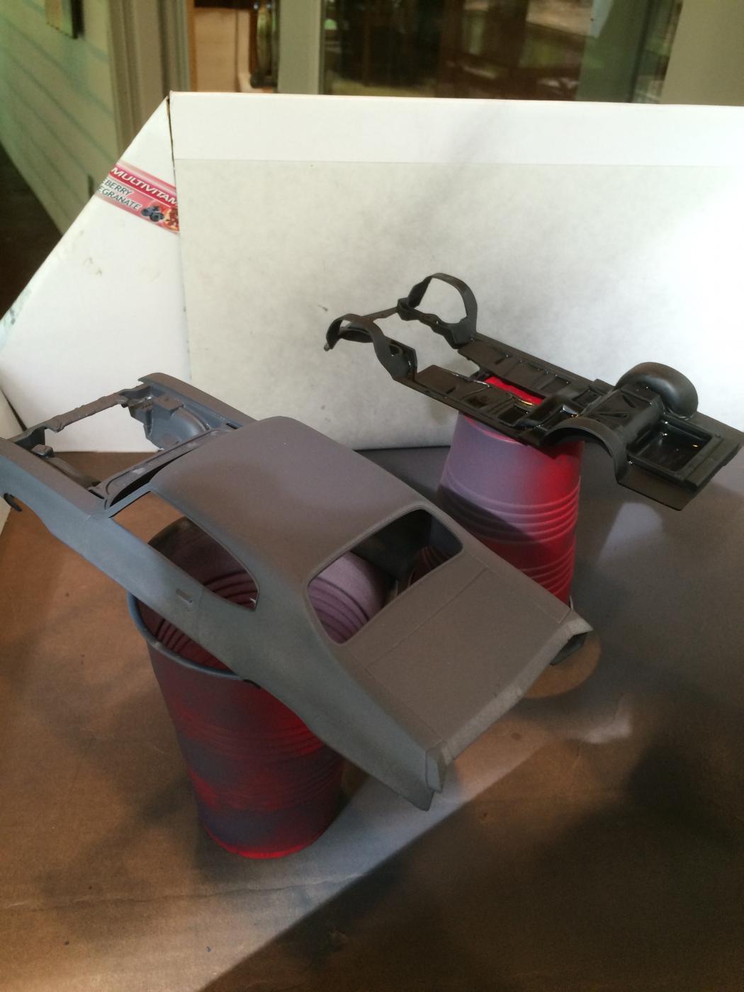

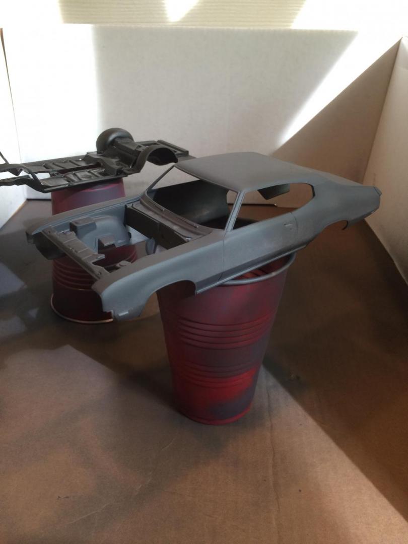

JerseeJerry55 Posted May 23, 2016 Author Posted May 23, 2016 Also do I have to sand the primer before painting? If so what grit, how hard do I press, and anything else I may need to do to prep for paint. Thanks for looking. So far, so good...........................I think.

mikemodeler Posted May 23, 2016 Posted May 23, 2016 Also check to see if there are any mold lines in the body before you put color on it, you will be glad you did! Not familiar with that kit and where the body lines might be, but a close inspection should show them.Welcome back to the hobby and enjoy. As you have found out, there are some helpful people here and don't be afraid to ask questions, that's what we are here for!

1972coronet Posted May 24, 2016 Posted May 24, 2016 Jerry - That GSX is coming along quite nicely . In regard to parting lines ; I recognise that the C-pillars have one on them ( I can see them in your photos ) . They're right around the area where the roof and C-pillars meet ... ... just like on the "1:1" car
JerseeJerry55 Posted May 24, 2016 Author Posted May 24, 2016 Jerry - That GSX is coming along quite nicely . In regard to parting lines ; I recognise that the C-pillars have one on them ( I can see them in your photos ) . They're right around the area where the roof and C-pillars meet ... ... just like on the "1:1" car Thanks. Quick question since it's been primed do just sand the lines flat or does it take more than just sanding?

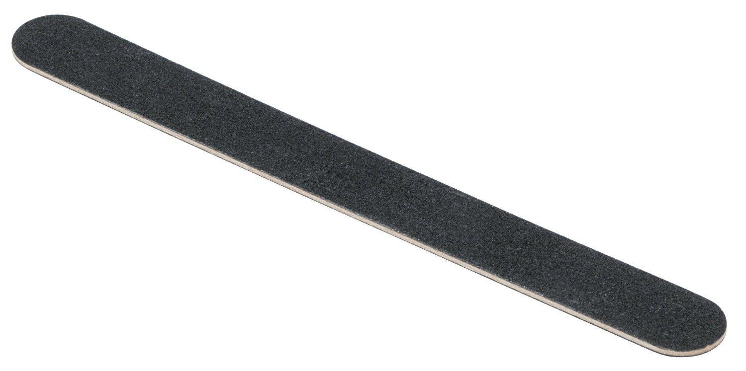

1972coronet Posted May 24, 2016 Posted May 24, 2016 Thanks. Quick question since it's been primed do just sand the lines flat or does it take more than just sanding? The most popular tool to use is an emery board . They're available in various grits , just like sandpaper . That's what the primer does ; it shows imperfections in addition to its 'regular' job .
JerseeJerry55 Posted May 24, 2016 Author Posted May 24, 2016 The most popular tool to use is an emery board . They're available in various grits , just like sandpaper . That's what the primer does ; it shows imperfections in addition to its 'regular' job . So just get an emery board (sanding stick) and sand the line flat? What grit and shoot a second coat of primer? Never have done this before so want to be sure on this.
1972coronet Posted May 24, 2016 Posted May 24, 2016 Depends upon how much of the line needs to be eliminated . I know that the C-pillar parting lines on the GSX are mild (e.g. , not as 'offencive' as others') , so I'd suggest that you start with the blue-coloured board , and finish with the lighter pink board . You can use flat black as a "guide coat" in the areas you're sanding / reworking (personally , I use alternating primer or flat colours when reworking an area ; grey primer , red oxide primer , and flat black allow for one to check their progress ; finish up with your choice of matching , final primer colour --grey in your case) .Any hobby shop should carry the emery boards . I recommend that you start with the dark blue / light blue & pink / light pink board , that way you have all of the grades you need on one board .
JerseeJerry55 Posted May 24, 2016 Author Posted May 24, 2016 Depends upon how much of the line needs to be eliminated . I know that the C-pillar parting lines on the GSX are mild (e.g. , not as 'offencive' as others') , so I'd suggest that you start with the blue-coloured board , and finish with the lighter pink board . You can use flat black as a "guide coat" in the areas you're sanding / reworking (personally , I use alternating primer or flat colours when reworking an area ; grey primer , red oxide primer , and flat black allow for one to check their progress ; finish up with your choice of matching , final primer colour --grey in your case) .Any hobby shop should carry the emery boards . I recommend that you start with the dark blue / light blue & pink / light pink board , that way you have all of the grades you need on one board .Thanks I appreciate all the help as I know my skill set is limited as compared to others on the board. I have a ton of ideas and with help I hope to achieve them. The way I look at it if I am 50% as good as the excellent modelers on the board I will have succeeded.
Brizio Posted May 24, 2016 Posted May 24, 2016 Paint and chassis looks good. Also you can make a sanding tool yourself, buy some sandpaper and glue it to a piece of wood, or other hard material.

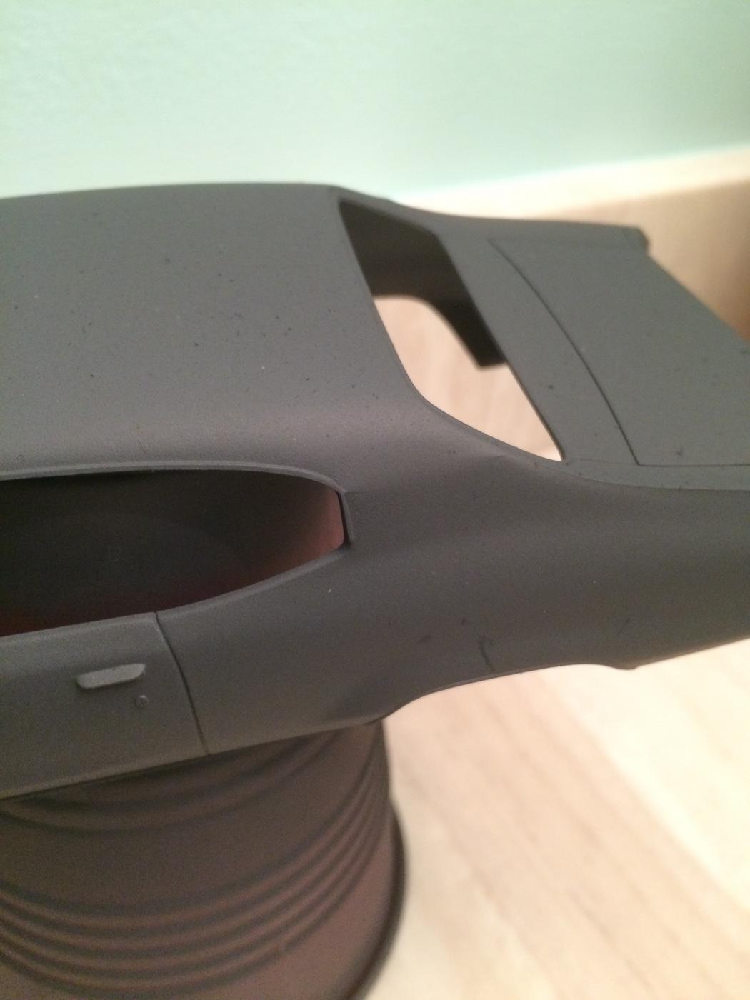

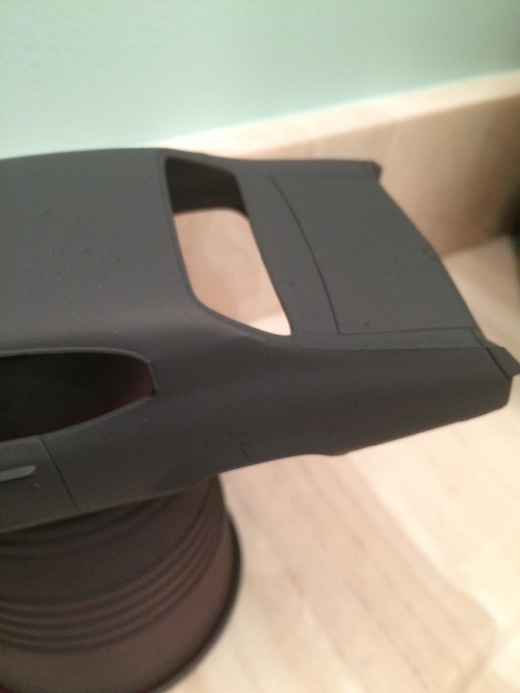

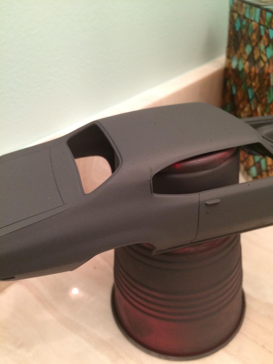

JerseeJerry55 Posted May 29, 2016 Author Posted May 29, 2016 Sanded seam line and reshot primer. Thoughts and suggestions welcomed. Thanks for the tip Sanded seam line and reshot primer. Any thoughts or suggestions are welcomed.
randx0 Posted May 29, 2016 Posted May 29, 2016 It's coming along nicely , all I would add is keep it fun on this first one . try not to get bogged down with doing everything "right" . build it , ask questions you want answers to , and then when you're done assess the job you did and decide where you want to improve . good luck !
