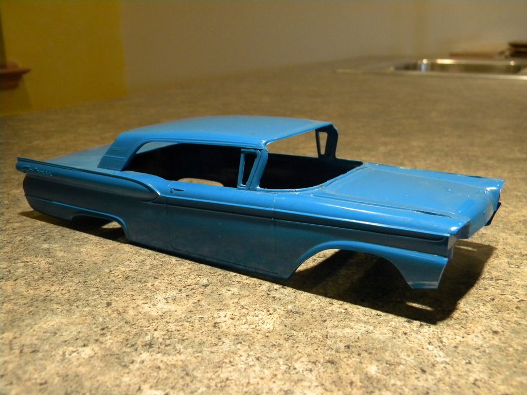

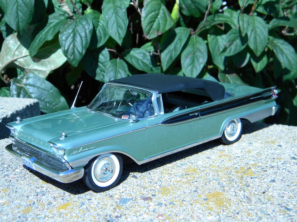

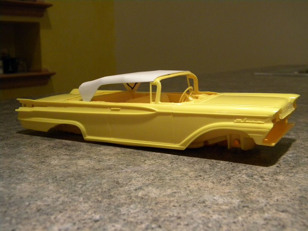

 photo DSCN3384_zpsqfrwekyu.jpg photo DSCN3548_zps5b4d7329.jpg photo DSCN3179_zps1djuczsj.jpg photo DSCN3355_zpskdztqqly.jpg
I don't have a before pic, but this '59 Edsel started the same color as the above '59 Ford.
