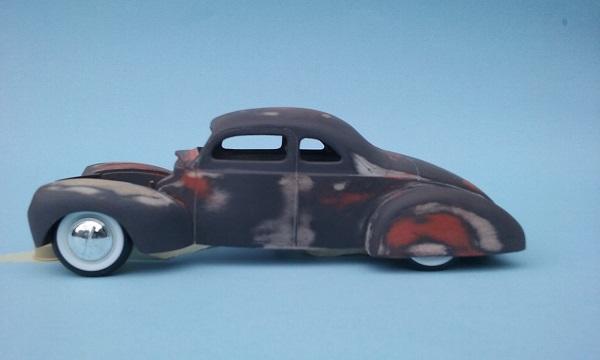

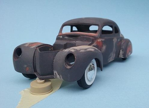

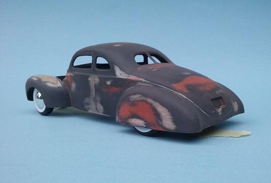

Ferbz Posted May 30, 2016 Posted May 30, 2016 Since my last post, I sprayed an initial primer coat and started the spot putty process. I'm making it look ugly so it can look pretty! I dislike this part of the bodywork process but I'll get through it ....! I still have to glue and fine tune the already sectioned hood making sure it lines up with the body/fenders. Stay tuned...

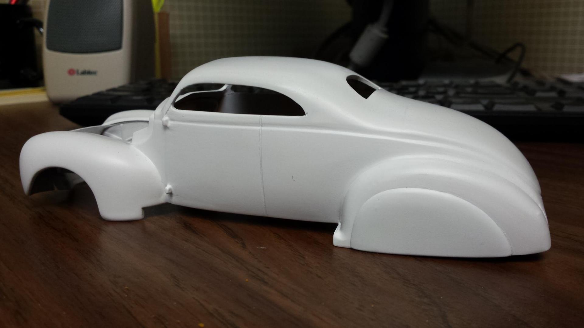

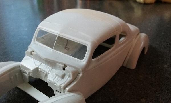

Ferbz Posted May 31, 2016 Author Posted May 31, 2016 The body lines really flow well. I have been told this body style top is hard to chop and have the rear side windows look right. Yours look perfect. Thanks! It is tough to get this top to look right. I think mostly because the top is so small and so round. In my eyes, I still don't have it quite right but it's close enough! I tried my best with this project to have a keen eye about proportion and fixing some of the odd things(in my opinion)about this body style. Included in the top chop is the slight leaning back of the A pillars(the factory angle of the windshield looks too vertical to me). I also reduced the height of the windshield opening by filling it at the top(the factory windshield also looks too tall to me. Chopping the top alone doesn't fix this). Check out the attached image:

espo Posted June 1, 2016 Posted June 1, 2016 Thanks! It is tough to get this top to look right. I think mostly because the top is so small and so round. In my eyes, I still don't have it quite right but it's close enough! I tried my best with this project to have a keen eye about proportion and fixing some of the odd things(in my opinion)about this body style. Included in the top chop is the slight leaning back of the A pillars(the factory angle of the windshield looks too vertical to me). I also reduced the height of the windshield opening by filling it at the top(the factory windshield also looks too tall to me. Chopping the top alone doesn't fix this). Check out the attached image: Thank you for the additional photo of how you chopped the top. I knew it was difficult but just never realized how many cuts had to be made to achieve the proper proportions.

Ferbz Posted June 1, 2016 Author Posted June 1, 2016 Thank you for the additional photo of how you chopped the top. I knew it was difficult but just never realized how many cuts had to be made to achieve the proper proportions. You're welcome. It's one of the progress shots of how I added the inner lip for the windshield glass to mount to(an idea I got from Steve Boutte). There are better pics of the chop in my previous post of this project. It's not too different from how others have done it successfully out there. One difference I think is the windshield being laid back and glass opening reduced. BTW, in hindsight I would have chopped it just a tad more to give a better 1:2 height proportion of the top to body. No turning back now!
