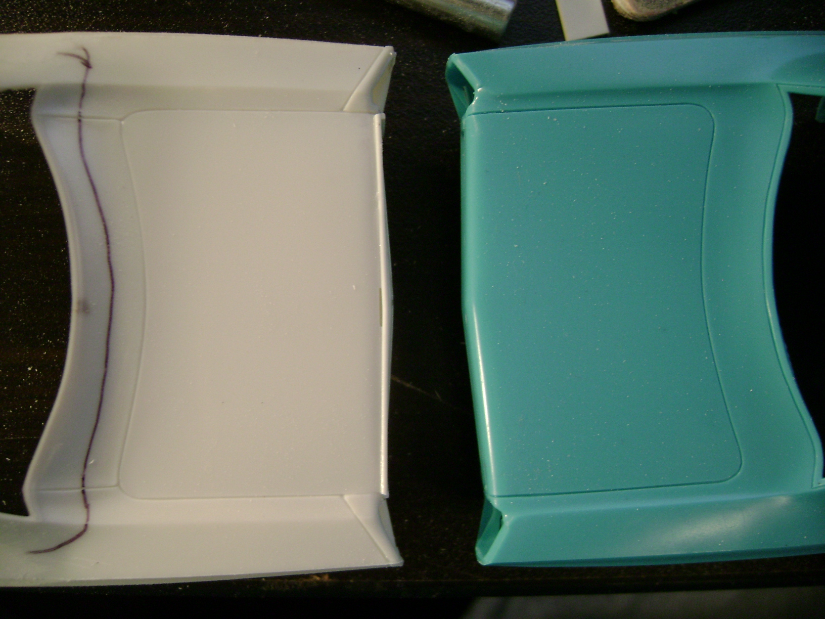

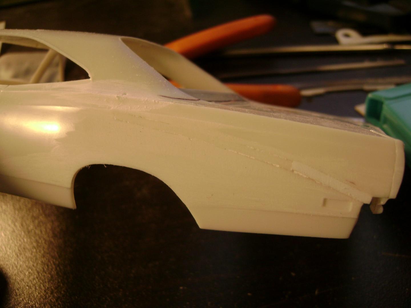

Mr mopar Posted July 15, 2017 Posted July 15, 2017 Ok I started to do the fix on AMT's 69'GTX and change it to a 69' Roadrunner ,one thing you must have is a 69' roadrunner Johan rear bumper because it has the peak in the meddle of the bumper , and cut out the rear panel of the AMT GTX and make the bend in the meddle , will have photos later of work.
MrObsessive Posted July 15, 2017 Author Posted July 15, 2017 Doug, you might not need to get a Johan bumper to correct the AMT body. One can make the "splits 'n' bends" in the AMT one to correct it. If you've got extras excellent! But not everyone does and sometimes just getting separate parts for those old Johan kits is like pulling teeth.I'm curious as to your take on how you fixed AMT's bad body. This is beating a dead horse, but why they keep missing the mark on body lines is frustrating to me, and in this day and age with CAD systems and all, they should be spot on.Shouldn't they??
Mr mopar Posted July 16, 2017 Posted July 16, 2017 Bill I followed your lead on this one ,I did everything you did. and I must say it dose look much better with the back fenders lifted up .

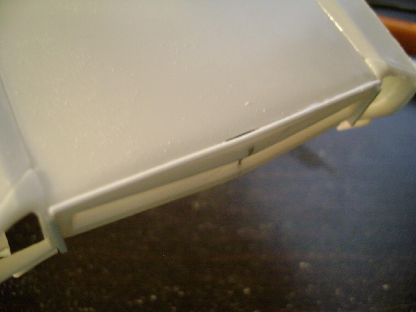

Mr mopar Posted August 6, 2017 Posted August 6, 2017 This is coming slowly but there is one thing you must use the Johan rear bumper because it is wider then the AMT bumper.

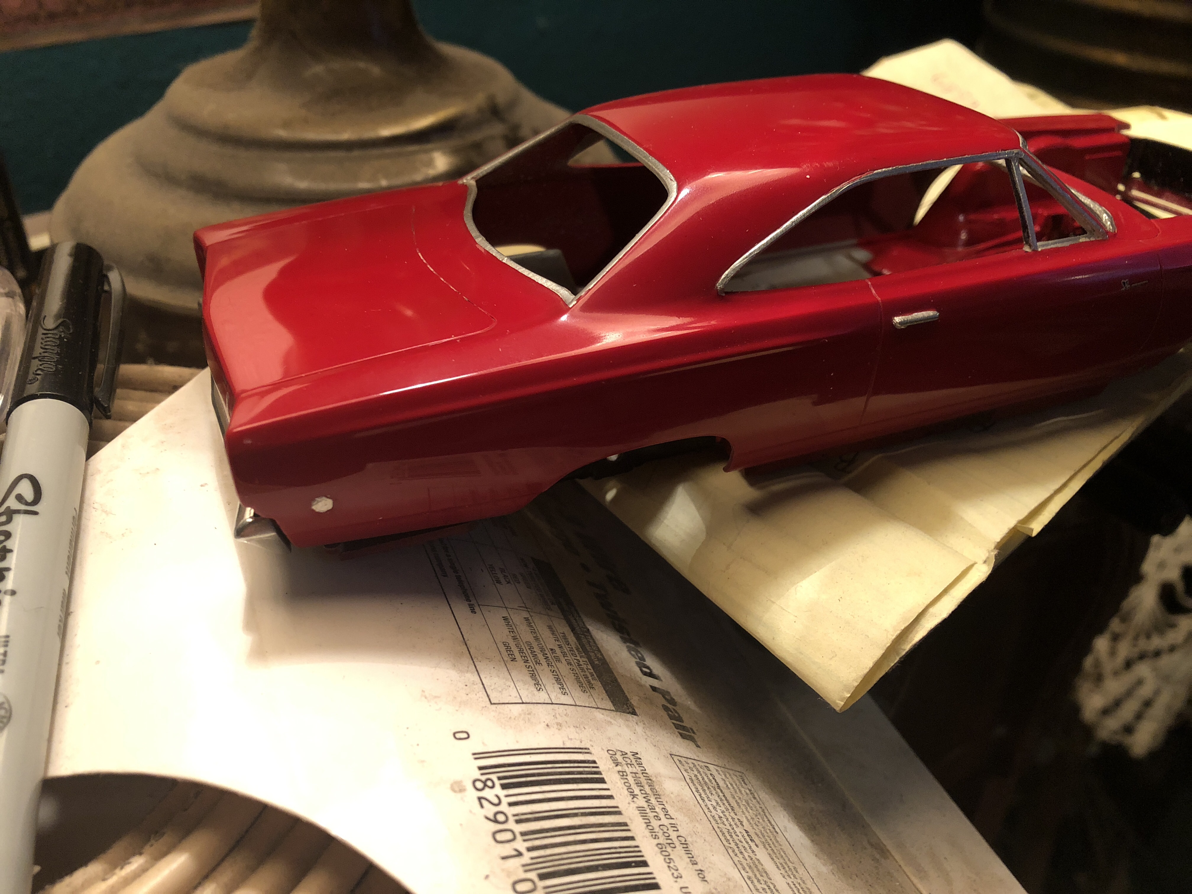

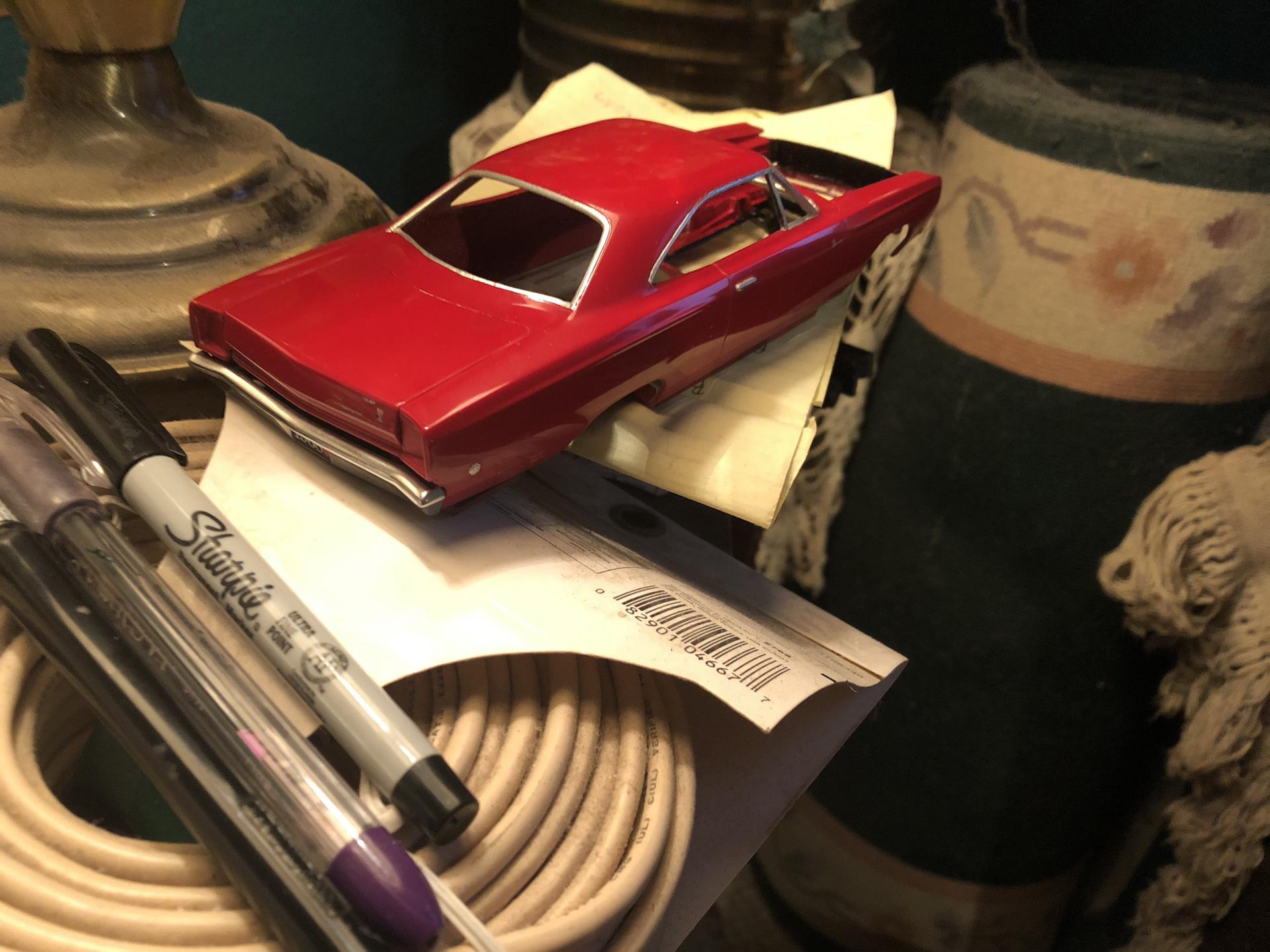

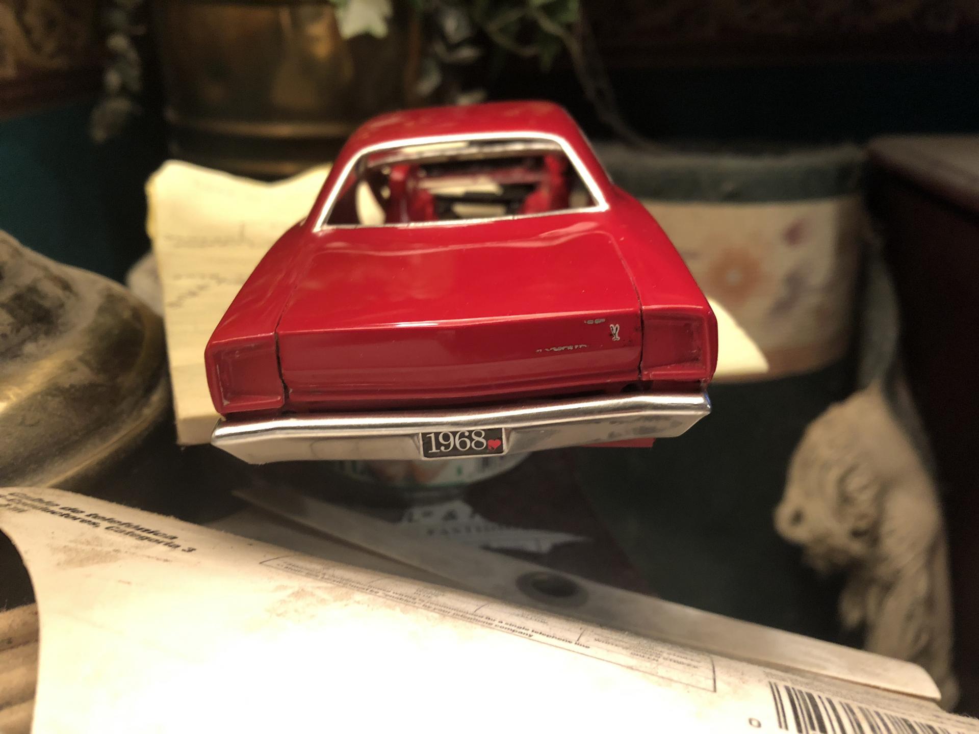

Peavus Posted January 31, 2018 Posted January 31, 2018 I have done the backdating of my 69 road runner to a 68. The trunk tail panel was cut from the amt body along with the tail light housings. One other thing is the side marker lights on the amt are recessed into the body. Those lights are supposed to mount flush on the body.

mikemopar70 Posted February 1, 2018 Posted February 1, 2018 I agree 100%, i planned to fix my Road-Runner this way comparing it with the Jo-Han... You did a prefect job correcting it!! Now the proportions are correct and the body looks like the real car!
Peavus Posted February 2, 2018 Posted February 2, 2018 On 2/1/2018 at 12:02 PM, mikemopar70 said: I agree 100%, i planned to fix my Road-Runner this way comparing it with the Jo-Han... You did a prefect job correcting it!! Now the proportions are correct and the body looks like the real car! Expand Another thing that I did was fill the underhood scoop cutout in the 68 hood. I have found if I don’t it will leave a ghost cutout line after painting. I think the thinner plastic on the cutouts, has a different expansion rate than the thicker plastic surrounding the cutout on temperature changes. As the thicker plastic around the scoop cutout warms, it expands enough to push the thin plastic cutout line up. It’s doing the same on the other side of the cutout line. No matter how much sanding and paint the cutout line will always show on top. Anybody on the forum ever experienced this or is it just me?
