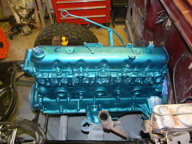

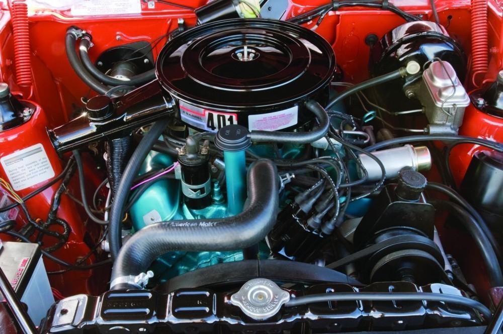

I have read on an AMC forum that the correct engine color is Ditzler # 13730 or Seymore EN #66.This color was used on a variety of AMC engines and covers the 69-73 model years. Eastwood also makes an AMC Aqua Metallic Blue color that is a passable match. However, the Eastwood AMC Aqua Metallic Blue is not close enough for a concourse or high-dollar show car. The Ditzler # 13730 & Seymore EN #66 is a bit deeper turquois with a tad more gloss finish. Hope this helps.
Ditzler # 13730 / Seymore EN #66:
