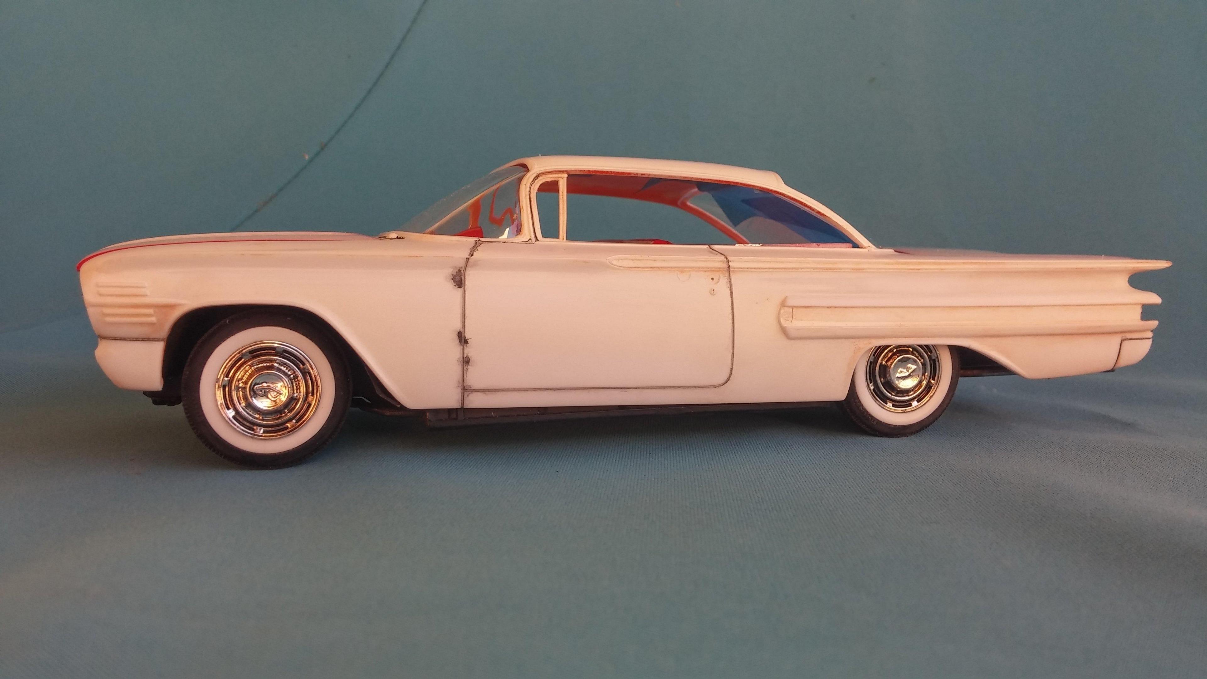

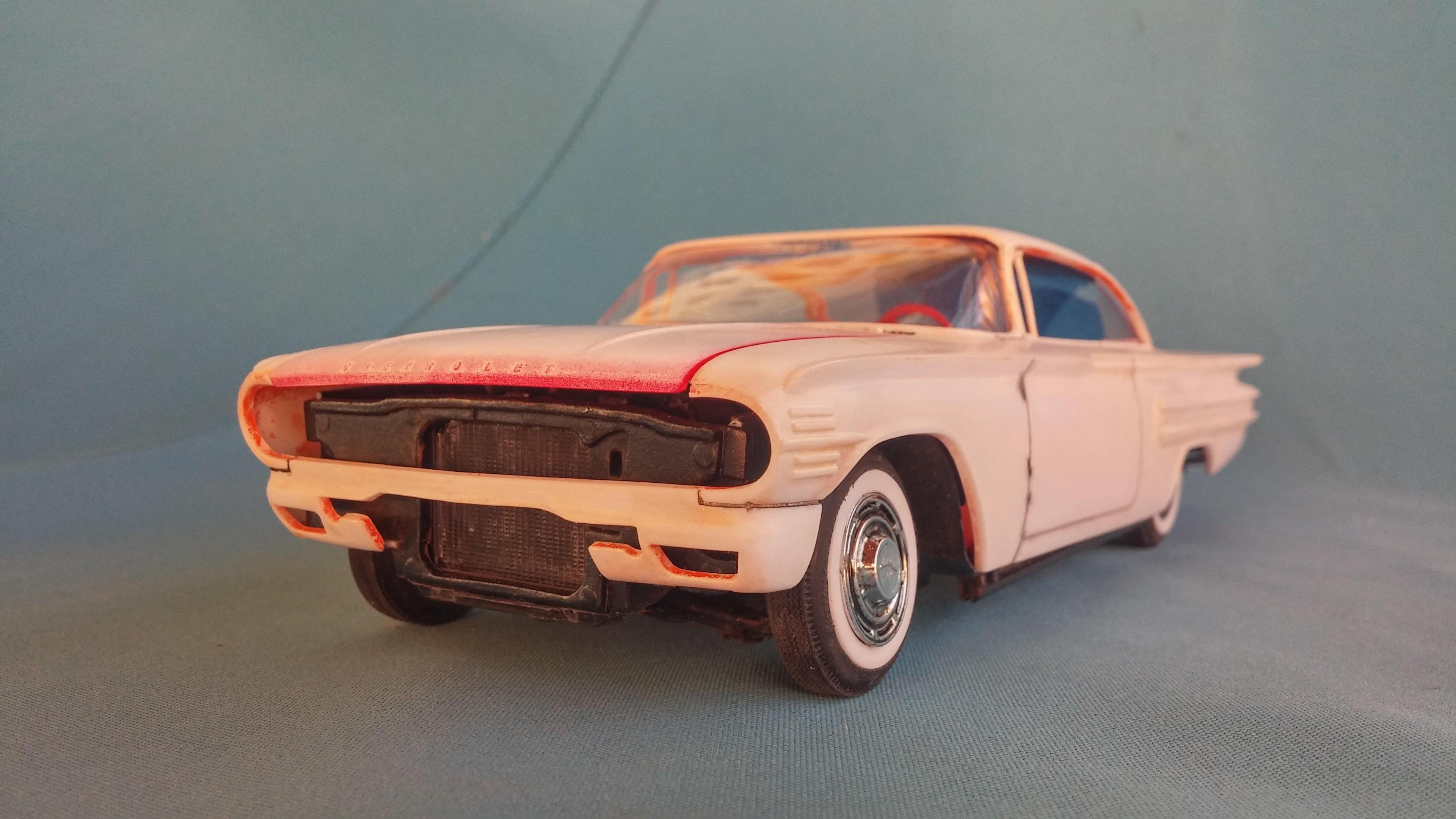

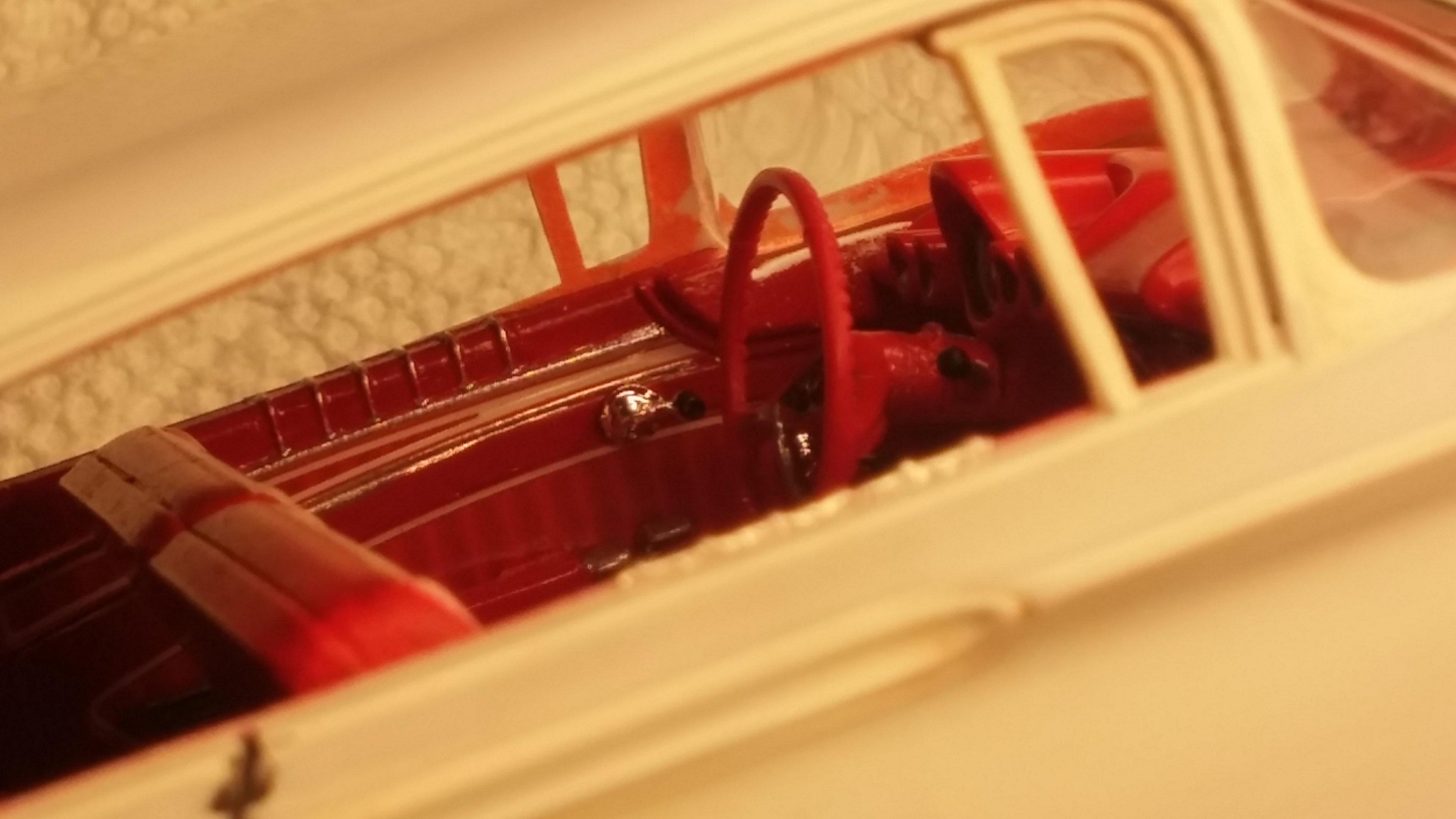

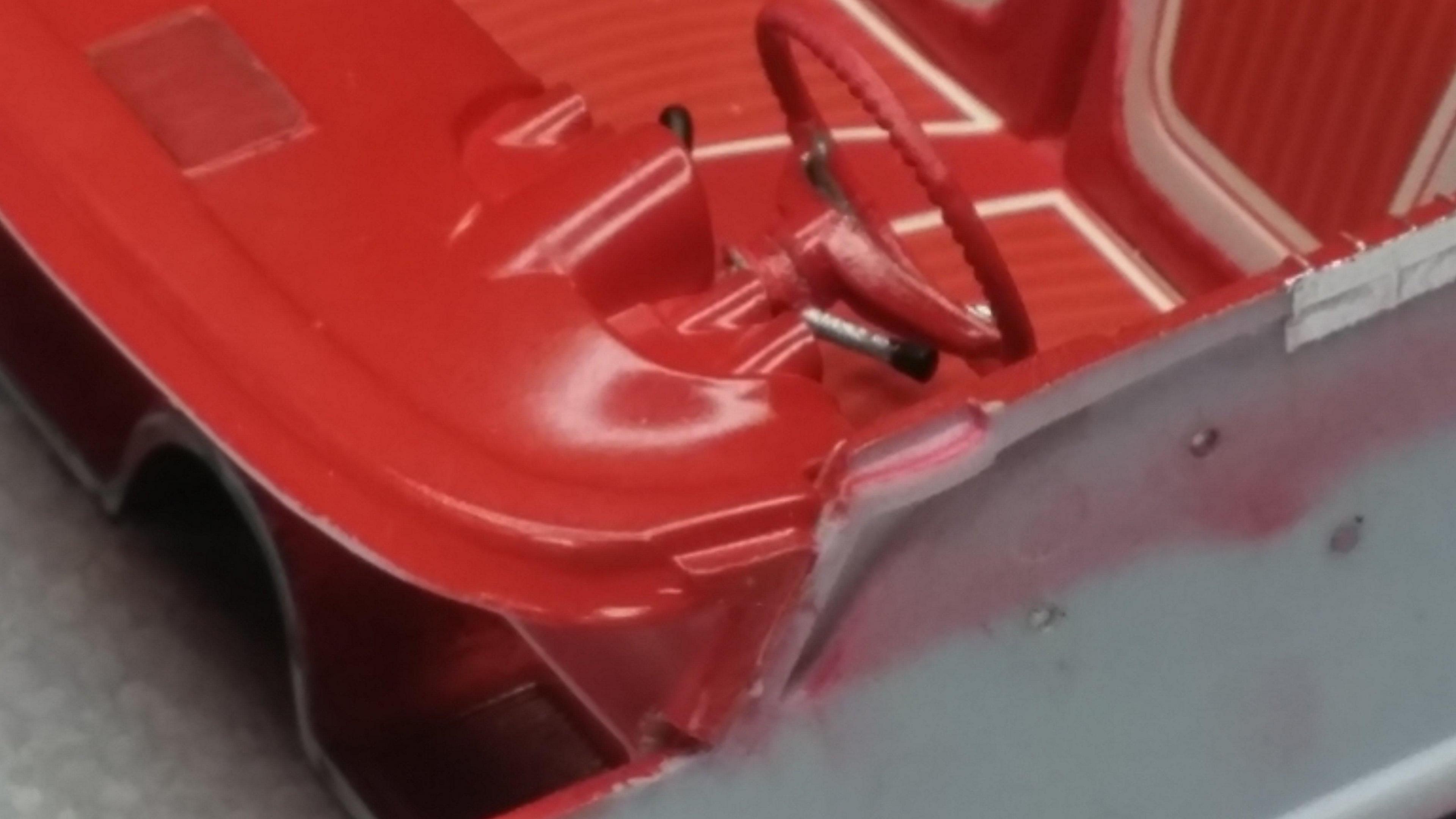

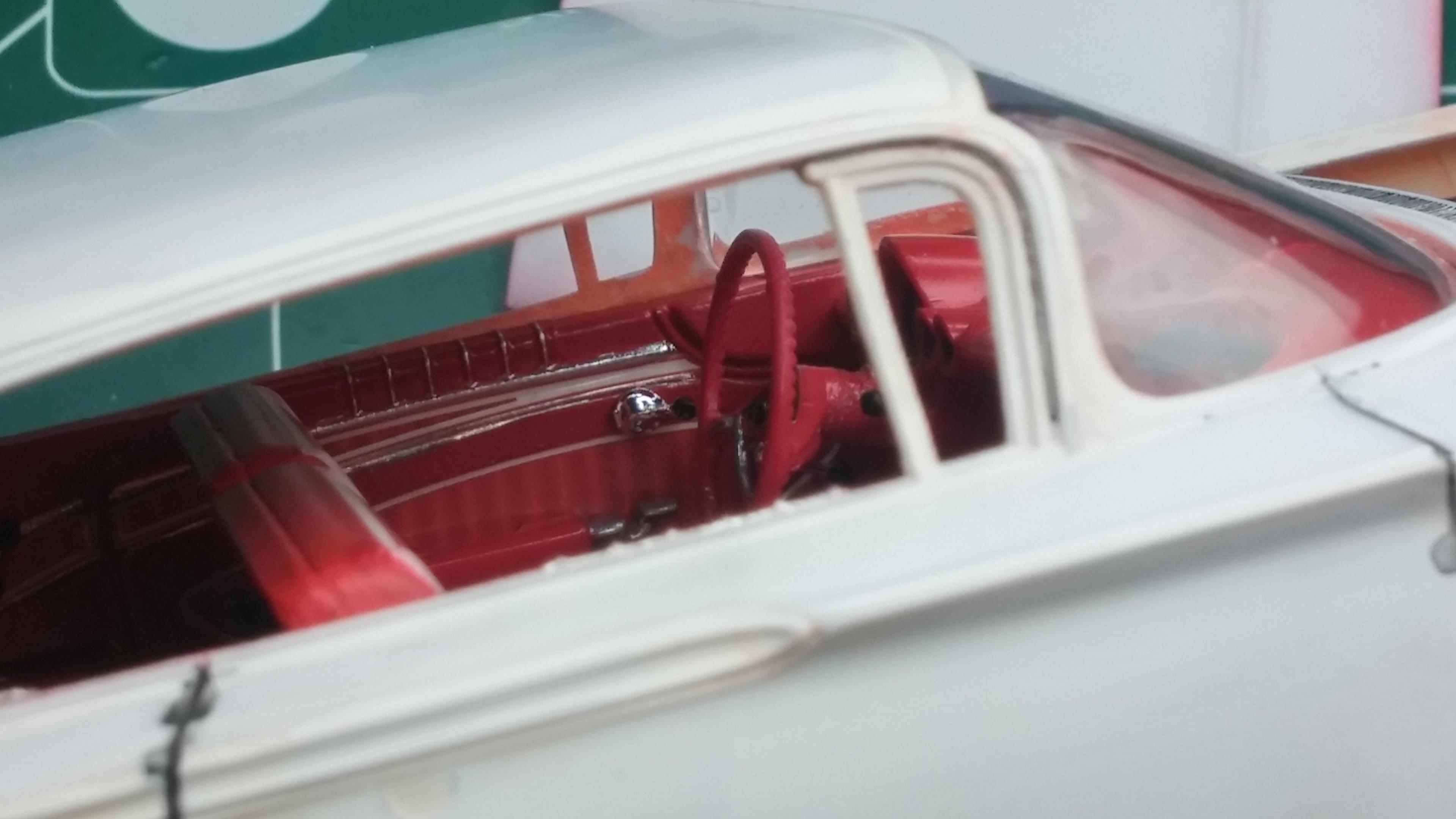

Here is an update on the interior fit issues.
The test fit revealed that there was something at the front of the interior assembly that wasn't allowing the body to settle all the way down over the chassis.
Upon inspection, it seemed that the windshield and dashboard were in conflict. Lowering the dashboard was the next step. I removed the dash and took a 2 mm notch out of each of the two positioning tabs on the sides.
The next test fit revealed more work to be done. Lowering the dashboard allowed the side panels to come into conflict with the windshield. They would also need to be altered.
Looking at this notch in the interior side panel, it would seem that Revell did anticipate the windshield conflict. It didn't work out that well in practice though.
Rather than taking a chance on cracking or chipping the windshield, I decided to make the adjustment on the interior side of the equation.
Just about there. At least it looks like I'm on the right track.
Though the frame rails are visible below the body, they are parallel to it.  I am declaring this problem solved and moving on to the next one.

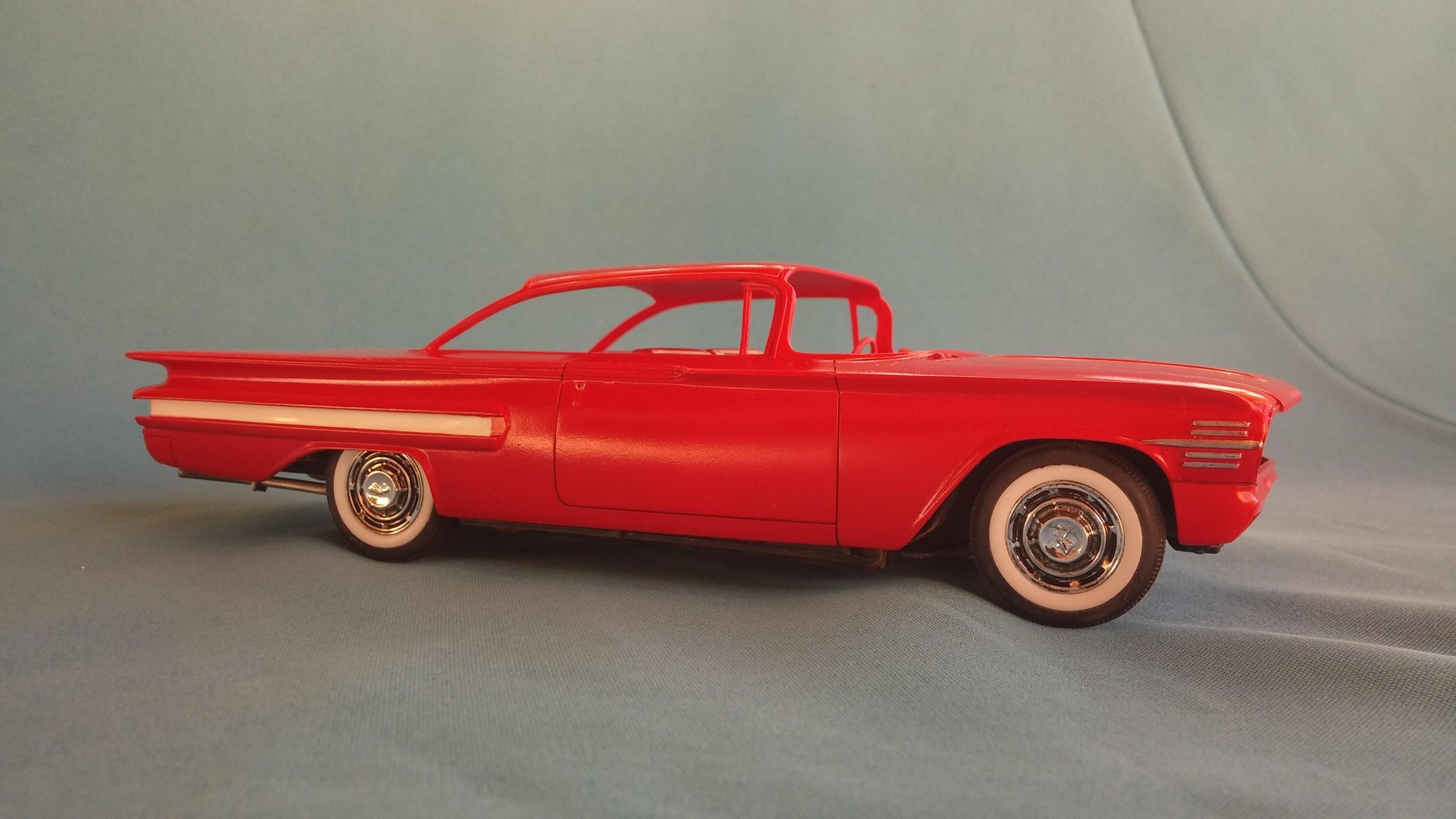

I started this kit back in 2011. When I opened it I found that the roof had been squished and twisted to one side. So i began having problems, literally, right out of the box. As I recall, it took several days to correct. I used scalding water to soften the plastic "A" pillars just enough to allow them to be moved into the proper position and held there and quenched in cool water to fix them into position. This process had to be repeated probably a couple of dozen times to gradually coax the plastic into recalling its rightful place in the universe.
When Revell issued this kit they used the chassis from the 59 Chevy. One of the differences between the 1959 chassis and the 1960 chassis is that the 59 chassis has a spare tire well in the floor of the trunk behind the right rear wheel. The 1960 chassis does not.
I corrected this error by cutting the offending wheel well out of the chassis, and replacing it with a piece of flat styrene. I then used heavy aluminium foil to create an impression and copy the floor ribbing from the left side and glued it to the right side. Sorry for the old blurry photo.

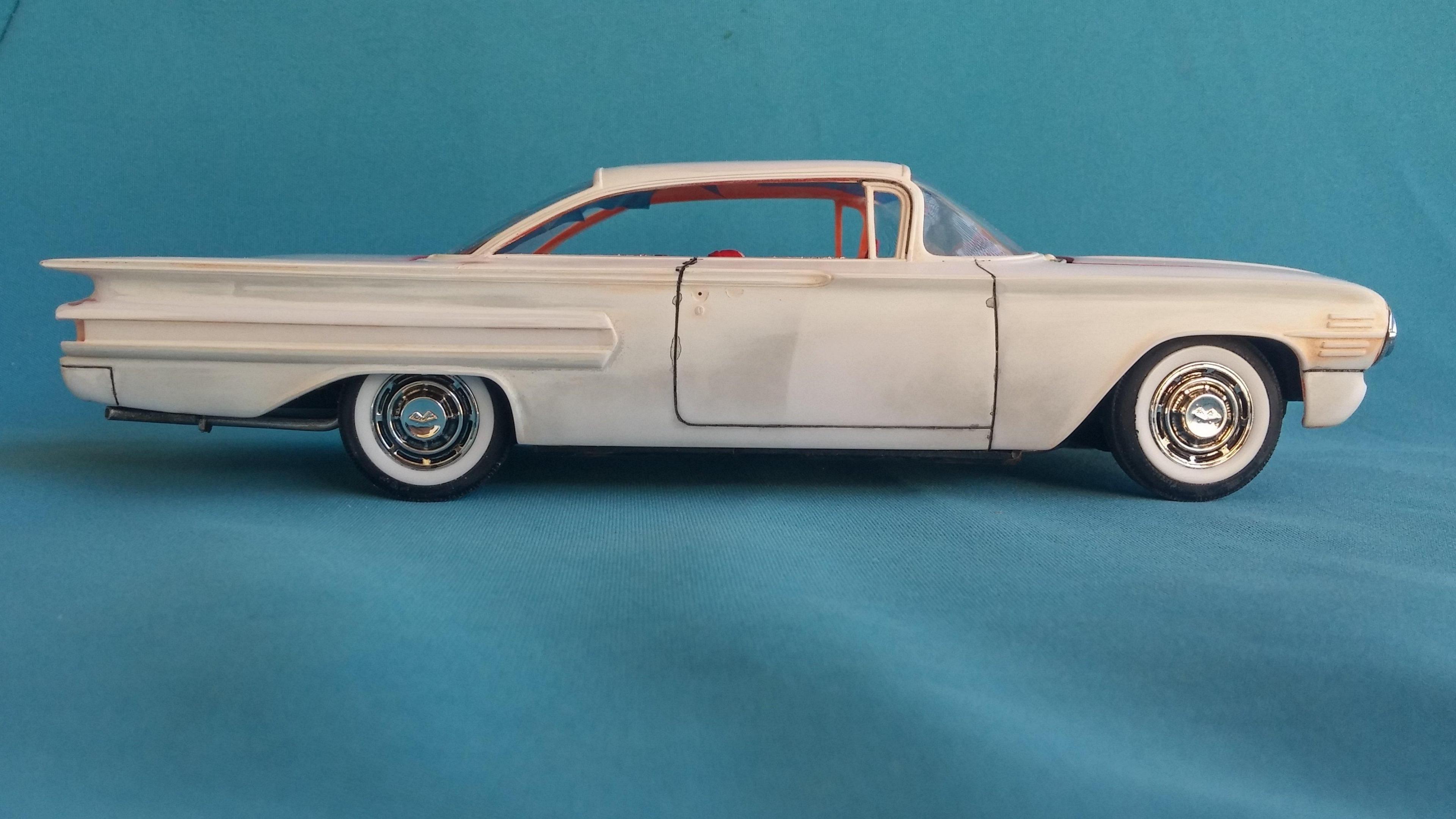

I finally got some more bench time, so here's another update.

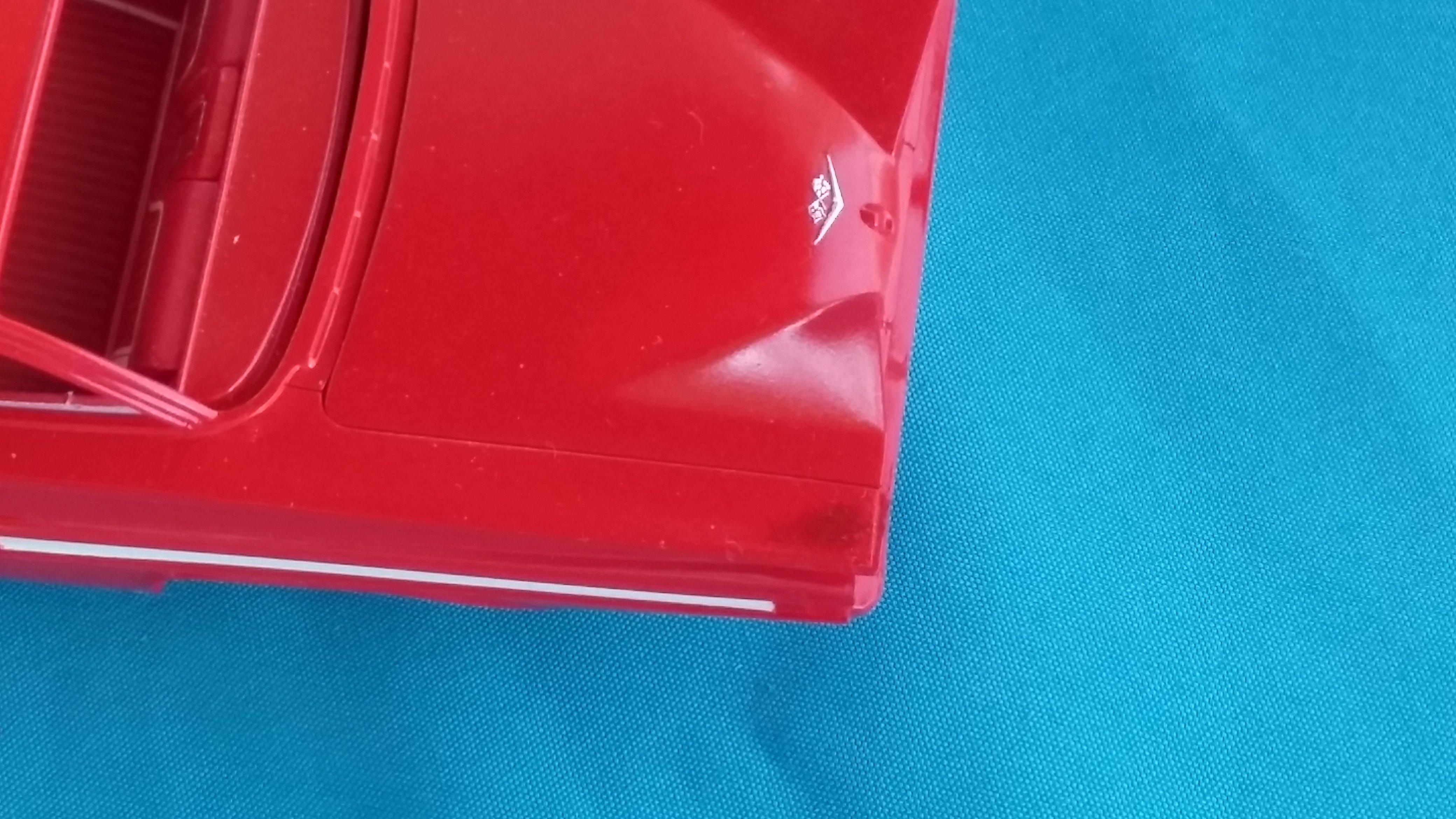

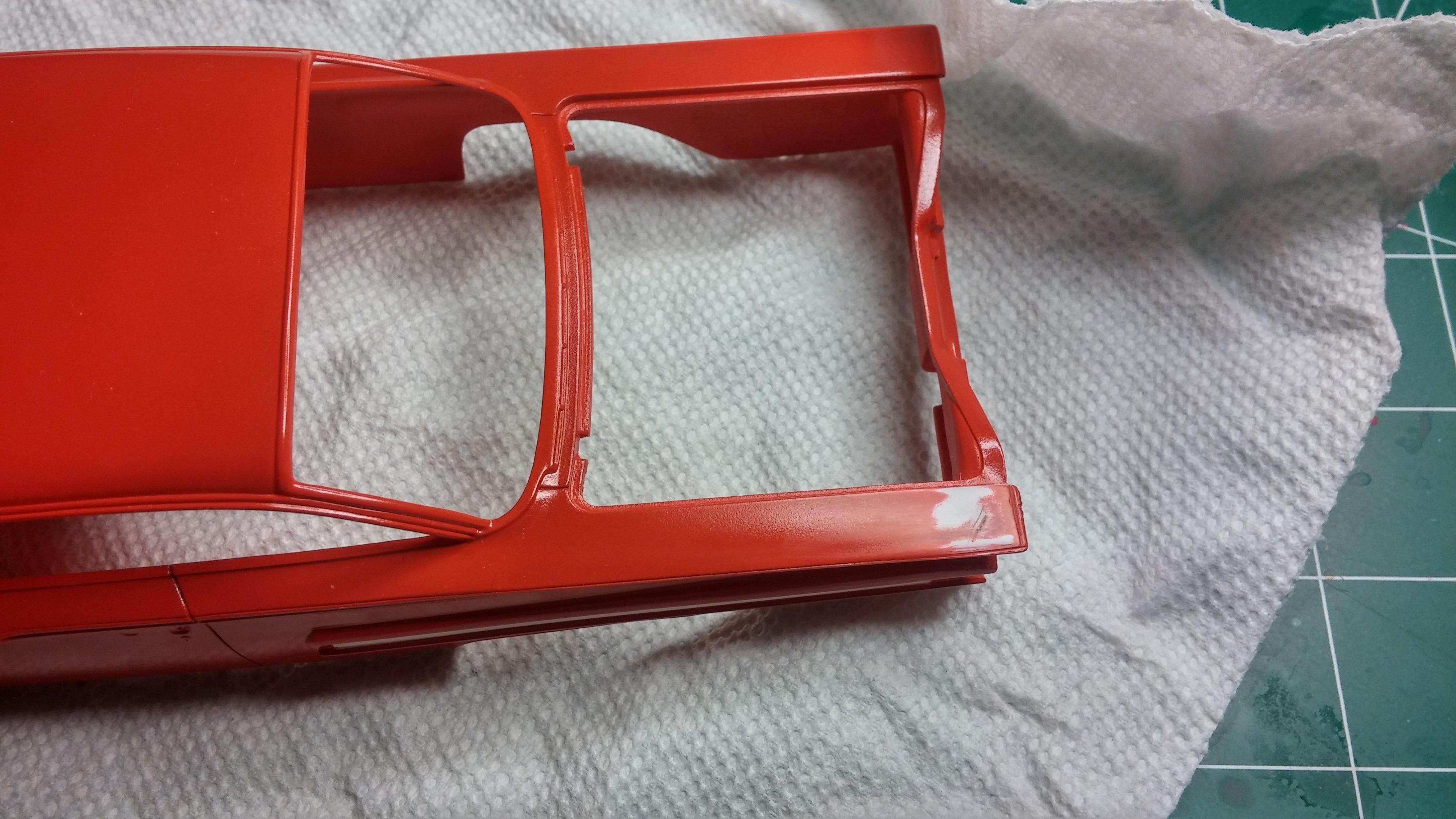

Now that the body fit issues are mostly sorted, it's time to move on to paint... for the third and hopefully, final time. It seems that a little color sanding will be needed.
This dark spot is caused by the body filler I used to repair the sink mark that lies directly beneath it. It appears that I should have made better use of the primer.
Additionally, the body filler didn't fill as well as I would have liked.
Hi-Ho, Hi-Ho, it's back to the bench I go with a little skim-coat and sanding.

Finally, it looks like I got some good paint laid down.
After two more coats of paint and some color sanding, these are the results.
Our little flaw even smoothed out nicely.
With a nice even color.
I think I can let this cure and then do a final polish.
As always, thanks for taking the time to look, and feel free to comment.
