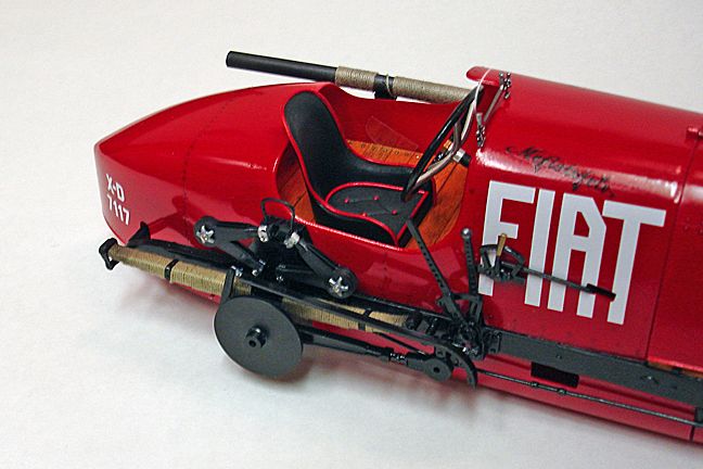

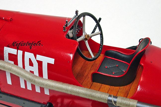

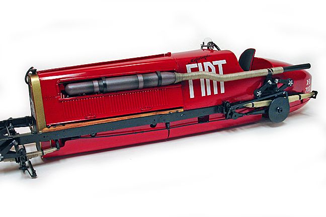

Twokidsnosleep Posted August 7, 2016 Posted August 7, 2016 She is looking great, really coming togetherIs that weathering or overspray on the "F" of the fiat in the last picture???
Harry P. Posted August 7, 2016 Author Posted August 7, 2016 That's soot that blew through the less than perfectly sealed exhaust manifold.
Twokidsnosleep Posted August 8, 2016 Posted August 8, 2016 (edited) That's soot that blew through the less than perfectly sealed exhaust manifold.ahh, good, your soot looks fine. I heard this engine blew out a lot of oil as well.I like to black wash and slightly weather my builds, but likely won't make them look abused and uncared for....as I care for my own real cars obsessively . Edited August 8, 2016 by Twokidsnosleep

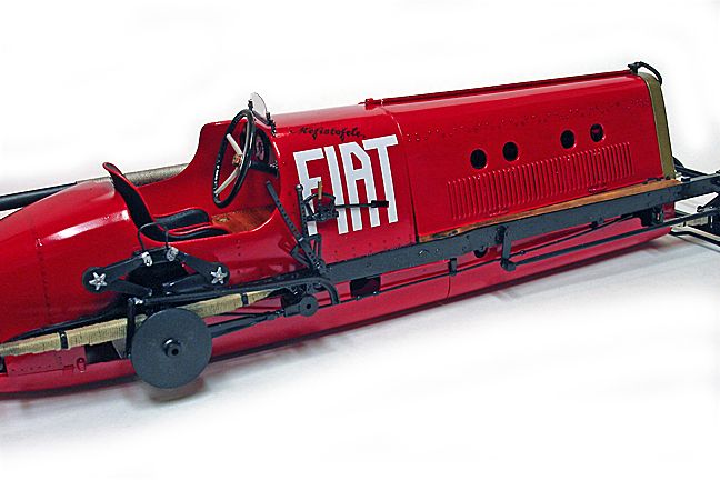

Harry P. Posted August 8, 2016 Author Posted August 8, 2016 Got the belly pans installed. I'm down to two last steps... fitting the hood, and the drive chains.Fitting the hood is the easy part. Those drive chains are the thing I've been putting off. Still looking for some 1/12 scale pre-assembled roller chain. I have found several sources... just have to decide who to go with, and this baby will be ready to go "Under Glass!"

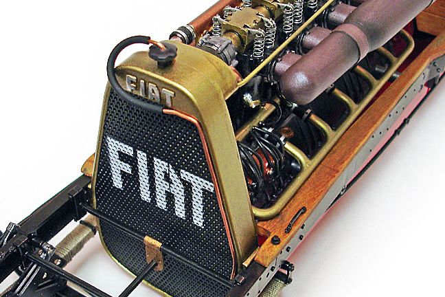

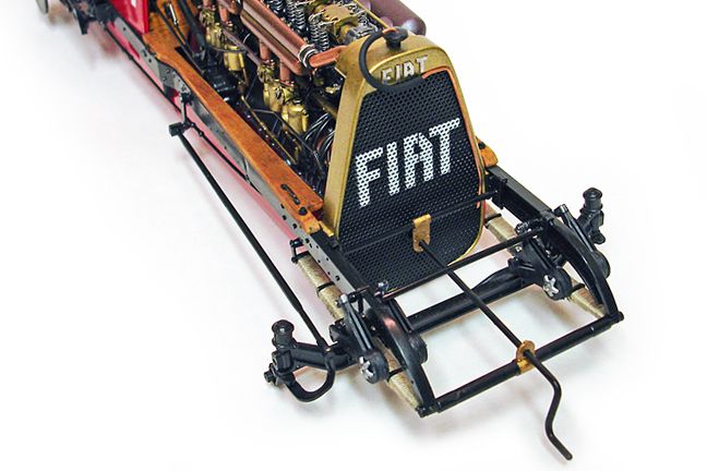

Harry P. Posted August 14, 2016 Author Posted August 14, 2016 One of the very few details not included in the kit is the radiator overflow tube. Going by my reference photos, I used copper wire to represent the copper tubing, and some soft, flexible rubber tubing that I found at Hobby Lobby in the jewelry aisle for the connector. Also in this photo you can see the scratchbuilt attachment bolts for the wooden frame rail "caps," which I had to scratchbuild because I replaced the kit's molded plastic caps with real wood caps.

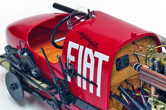

Harry P. Posted August 14, 2016 Author Posted August 14, 2016 And finally... got the crank handle and the steering assembly installed. And yes, the steering really does work through the steering wheel! Once my Grandt Line drive chains and sprockets arrive, all that's left is to install them, install the hood, the wheels, and the seat, and this baby will be finished!

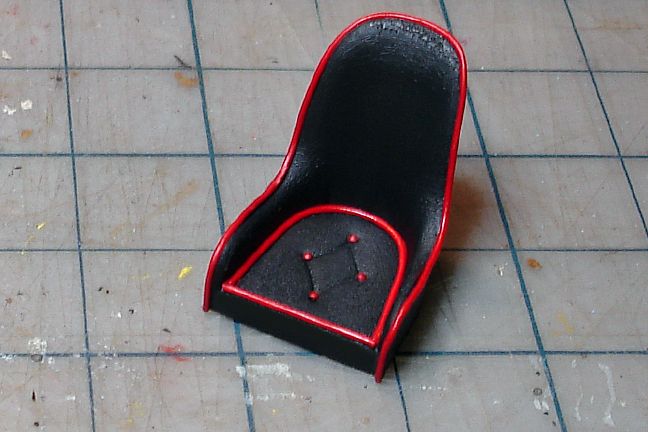

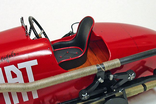

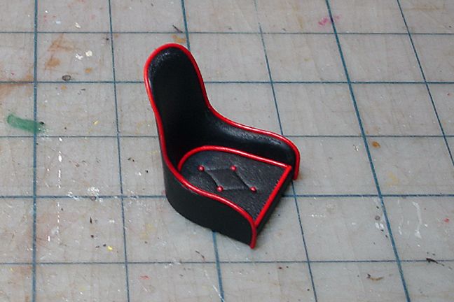

Harry P. Posted August 15, 2016 Author Posted August 15, 2016 More baby steps. I added the red piping on the seat because that's what the real one looks like. I didn't have the right color of soft, insulated wire, so I took some of what I had (orange) and painted it red. Before gluing it in place, of course. Once I had all the piping glued on I sprayed the seat with a satin clear to even out the tones (but really to hide the CA glue smears! ) Technically, the seat cushion should be plain and the button tufting should be on the backrest, but since they already had the button tufted pattern molded on the seat cushion, I said the heck with it. I'll leave it as is. How many people on Earth would even know that?

Harry P. Posted August 16, 2016 Author Posted August 16, 2016 Got the hood installed. The hood sides don't fit particularly well... But then again, they don't fit particularly well on the real car, either!
