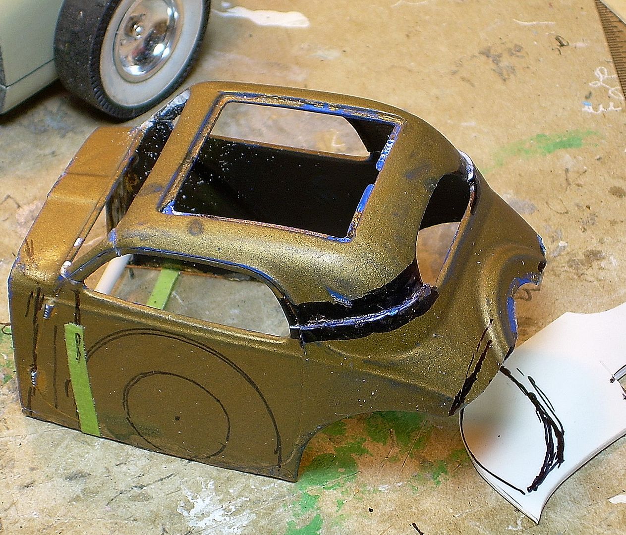

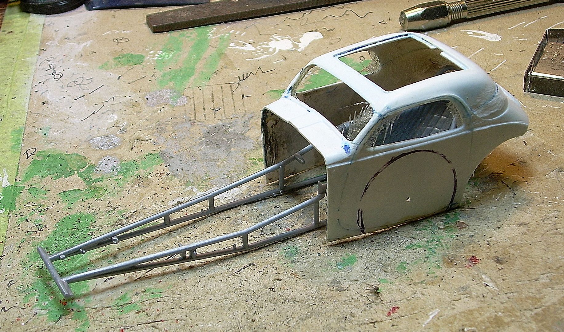

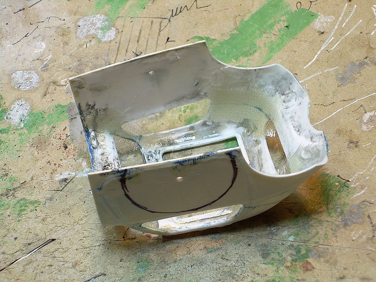

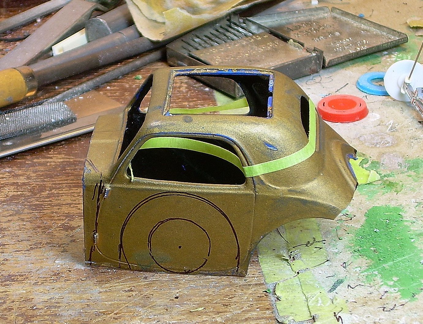

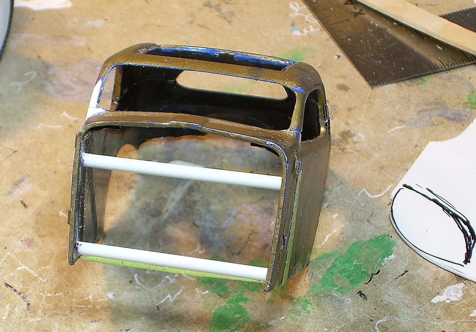

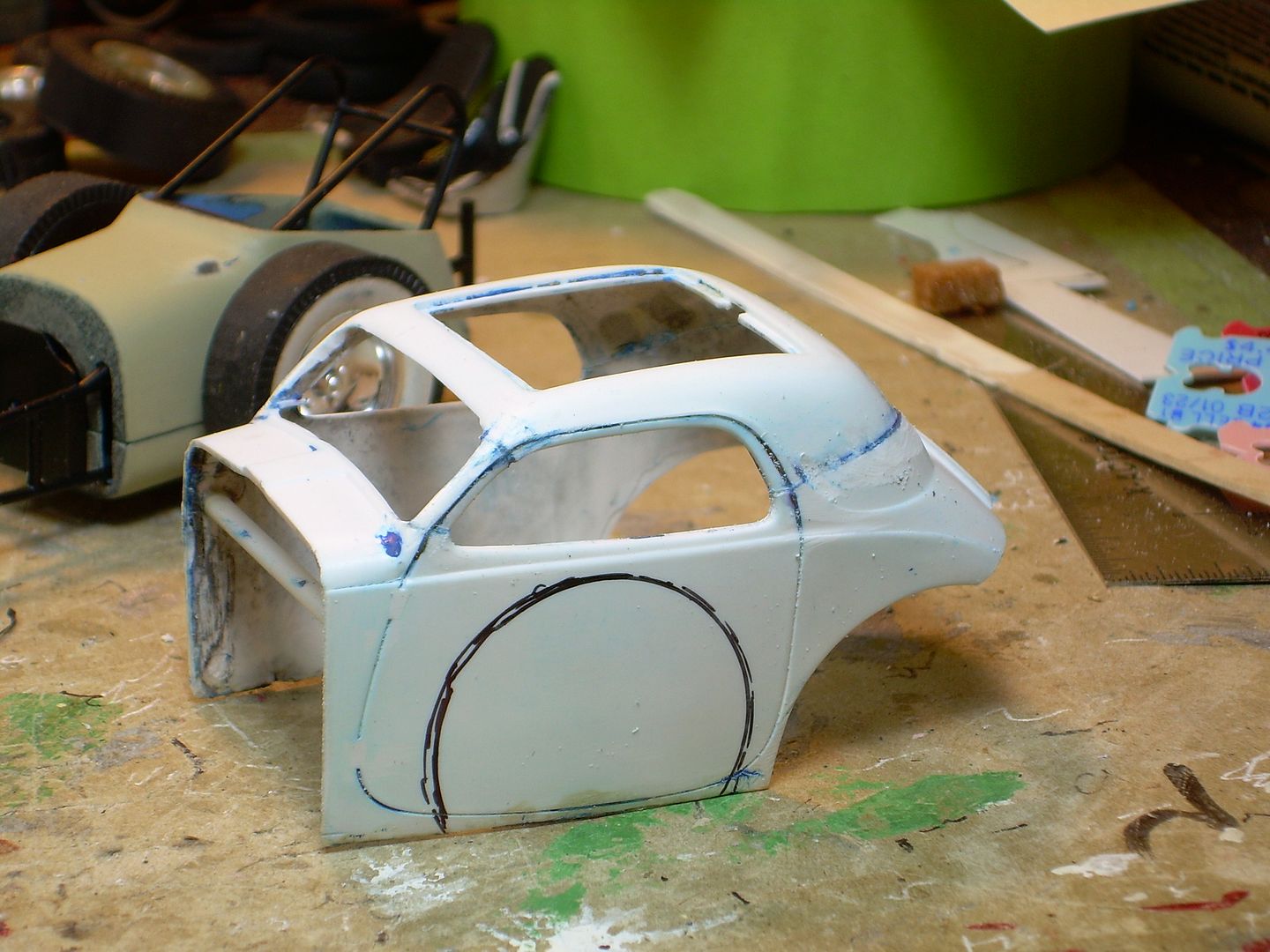

Ace-Garageguy Posted July 13, 2016 Posted July 13, 2016 (edited) While I was working on researching a short wheelbase blown dragster typical of the late '50s, (it's over on the dragster section) I came across this photo of a '60s Comp Coupe with a Fiat Topolino body shell and fell immediately in love. This was really my favorite class of drag cars back in the dim recesses of history, and I'd wanted to build one for a long time. Building the earlier little digger had me in the groove of doing tube frames and steerable axles, so it seemed a good time to take another diversionary tack, but kinda on the same ultimate path. I had a ratty old Topo body on the bench that I'd pirated the bellypan from (for another ongoing lakes-car build), and it needed a better purpose for its existence. After the chop... It was getting a little fragile and floppy, so it got some temporary reinforcement to hold it all together during rough handling while stripping. After the strip. The windshield pillars got leaned back to match the inspiration shot. There wasn't much meat left after the chop, obviously, so I reinforced the insides of the pillars with epoxy and fiberglass. Beginning to fit it to the chassis, which will be a pretty much box-stock build of the Tony Nancy Plymouth-powered car...but refitted with an early blown Chrysler Hemi. Edited July 14, 2016 by Ace-Garageguy

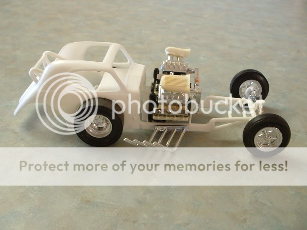

Lizard Racing Posted July 14, 2016 Posted July 14, 2016 I've always liked the '60s Altereds. They're probably the most bizarre dragsters.I noticed you changed chassis from the Tony Nancy to the twin-engined AMT Double Dragster. I built a number of those in the day.
Ace-Garageguy Posted July 14, 2016 Author Posted July 14, 2016 (edited) I've always liked the '60s Altereds. They're probably the most bizarre dragsters. I noticed you changed chassis from the Tony Nancy to the twin-engined AMT Double Dragster. I built a number of those in the day. 1) It's not an altered. It's a "competition coupe". Though related and sometimes even overlapped, they're different classes. The comp coupe in this time frame was often a hollowed out small car body on a rail dragster chassis. Altereds tended to be shorter wheelbase cars. 2) The model on the "double dragster" chassis belongs to Greg Myers. This is the problem with putting one's models in somebody else's thread. If the thread isn't actually read, the assumption, as here, is that all the models are by the OP. This would be a typical Fiat altered of the period which is represented by the Fiat in the "double dragster" kit. Edited July 14, 2016 by Ace-Garageguy
Greg Myers Posted July 14, 2016 Posted July 14, 2016 The model on the "double dragster" chassis belongs to Greg Myers. This is the problem with putting one's models in somebody else's thread. If the thread isn't actually read, the assumption, as here, is that all the models are by the OP. Ooops, Sorry about that. Reading is fundamental.
Ace-Garageguy Posted July 14, 2016 Author Posted July 14, 2016 Ooops, Sorry about that. Reading is fundamental. No problem here. I like your twin-engined car.
