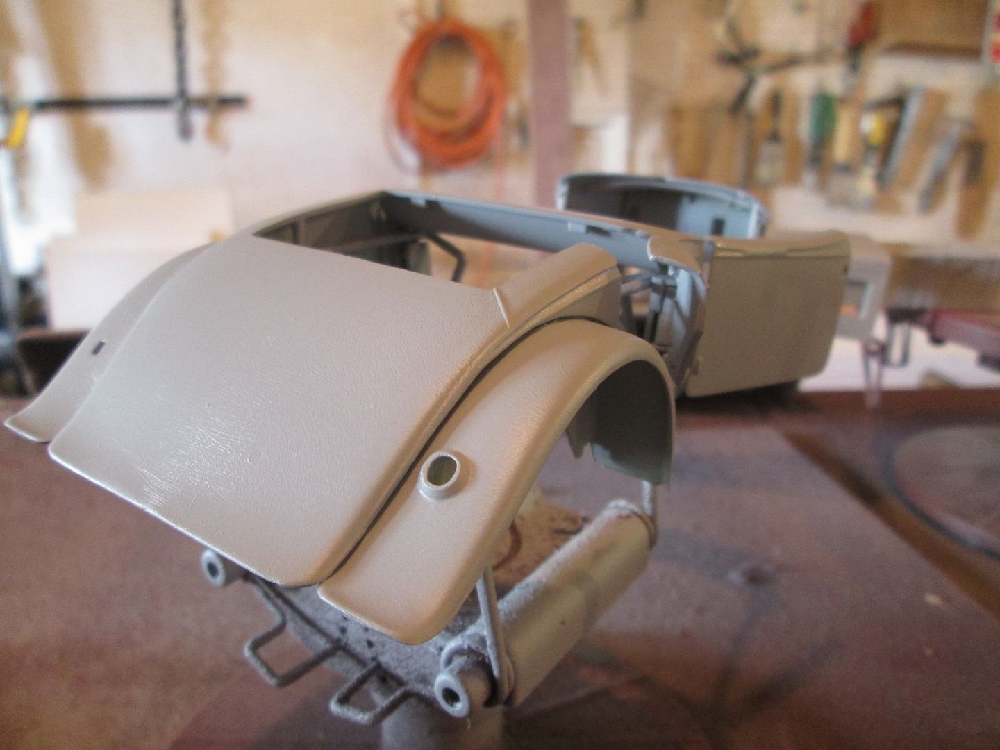

Following Art's lead, i cut both cowls off then Mated them together with a gap that I filled with styrene. A butt weld would have been impossible here. :rolleyes:
Edited by landman
After several coats of different color fillers I think we have a cowl/hood match.

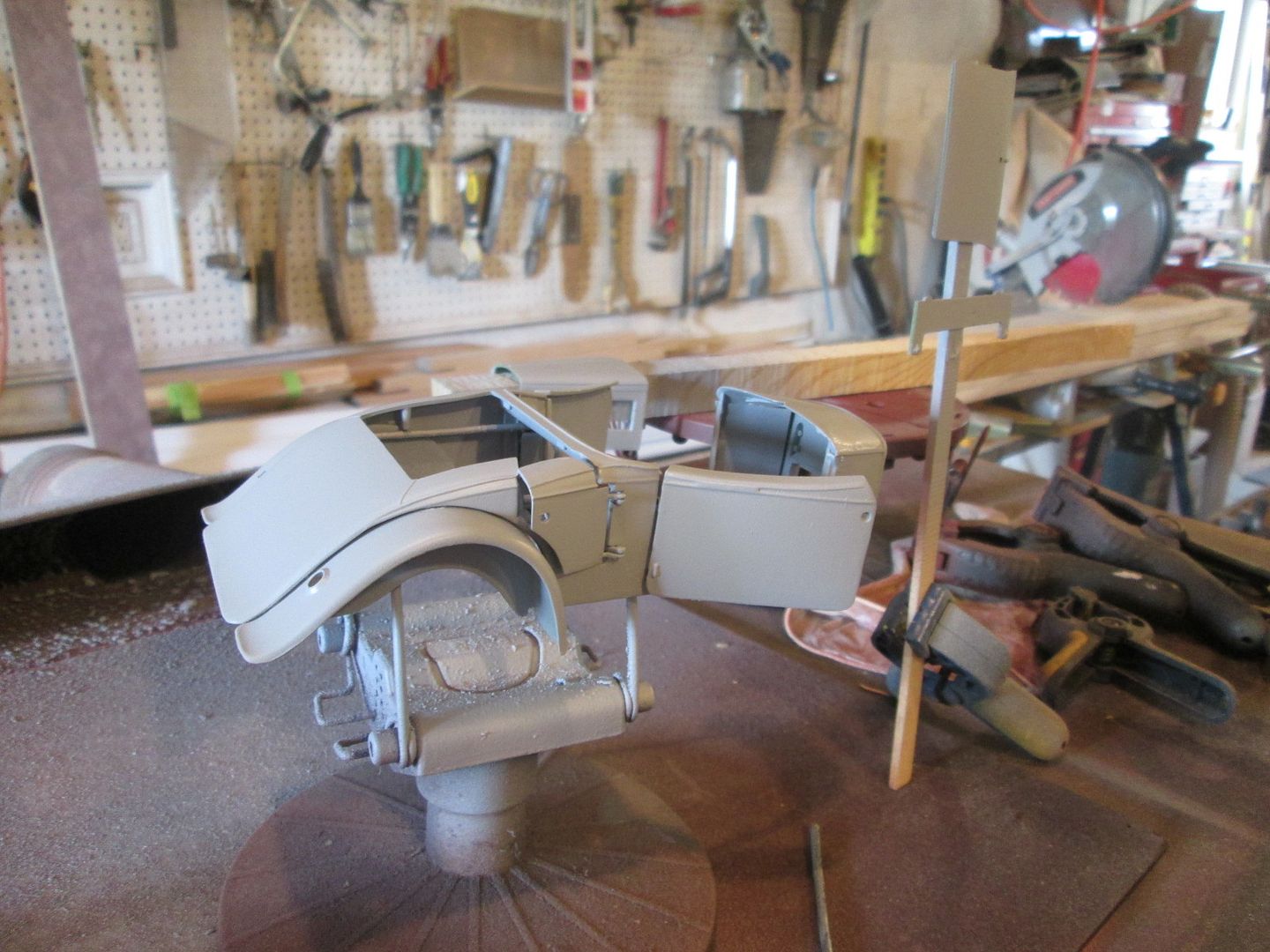

First update in 2 weeks. Busy, busy, busy. Body work is ongoing
Chassis is coming along. The Lego block is the spacer required  to line up the hood & cowl.

Sanded the filler on the splash apron. Put it back together to check fit, alignment, etc.So,so. I have to modify the moldings. Wiull likely sand down the flat molding on the hood, remove the flat I added to the cowl and bring the ones on the body forward with half round.
