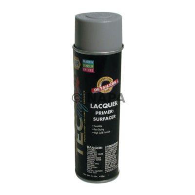

my80malibu Posted October 21, 2016 Posted October 21, 2016 (edited) I use the Martin Senour Tech Nique brand from Napa Available in Three colors, Easy to obtain, Not to expensive, Empties the entire can, comparable to both Duplicolor and Plasticote. I painted the new Revell 29 roadster with it and it did not craze. Edited October 21, 2016 by my80malibu
