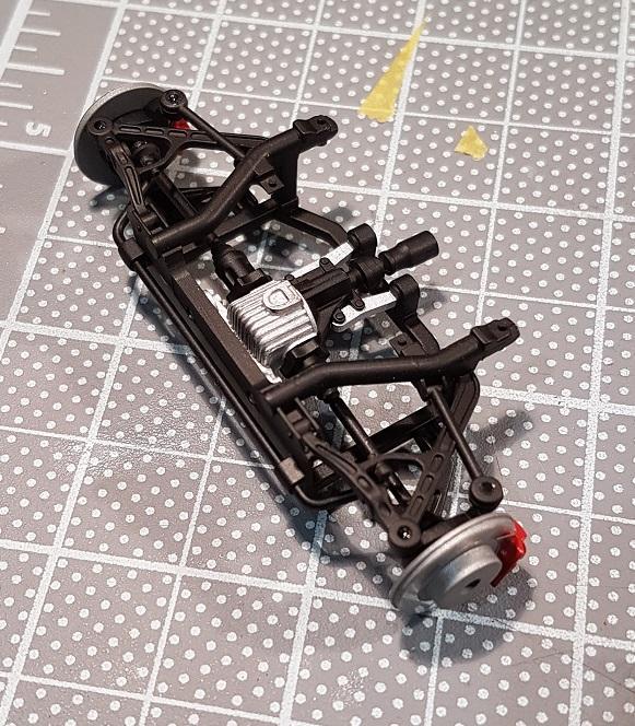

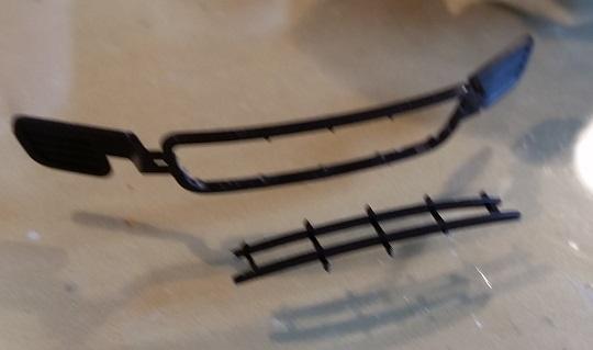

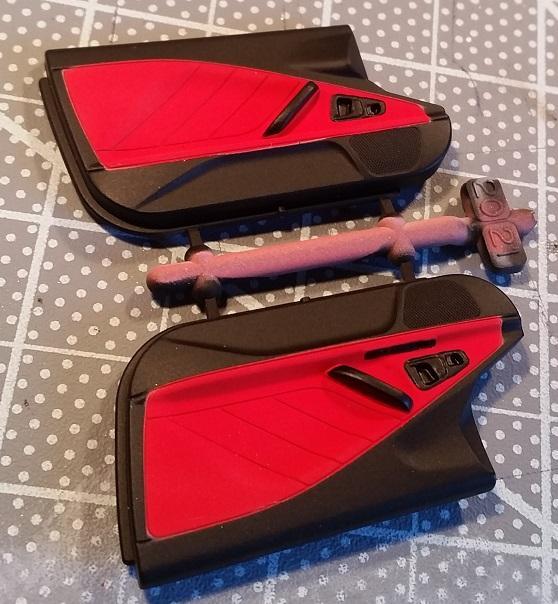

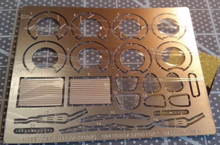

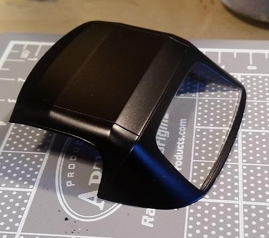

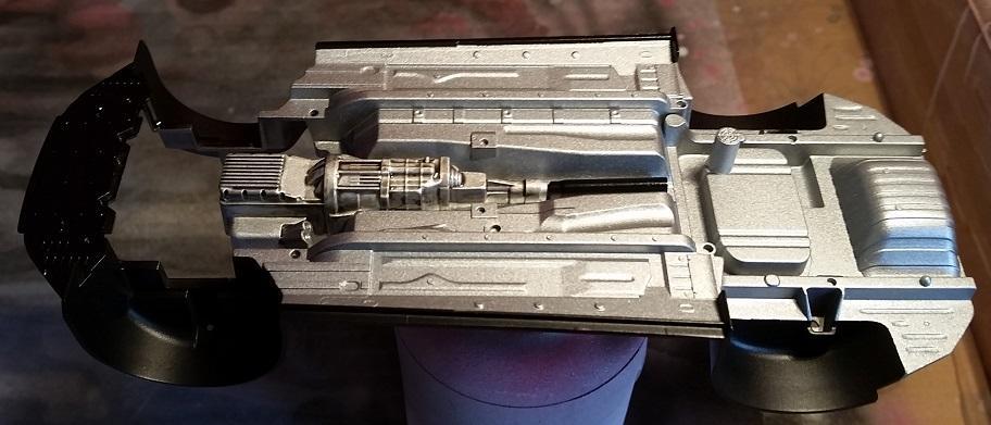

Funkychiken Posted October 25, 2016 Posted October 25, 2016 I always wanted an S2000, but it was too impractical, so I ended up with a civic type R instead - which is a car I loved to own, so much so, that I ended up keeping it for 5 years and sold it on at 90k on the clock (miles). Any how, decided to do this build as it's curb side, and should be quick. I haven't actually finished a model in 2 and a half years due to house renovations. This will be a quick build with not too much detail, I want to learn more about clear coating with 2K, and use my first set of PE in earnest. Box art: Using Hobby Design Photoetch: I've cut out the grill to add P/E later: Finished the chassis: (made a hash job of the wash on the sump & transmission) Finished 2 bits of the interior too: and the cabriolet hood:

Toast Posted October 26, 2016 Posted October 26, 2016 That photoetch kit is really nice. The details that add alot to the kit.Looking good so far.

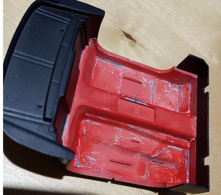

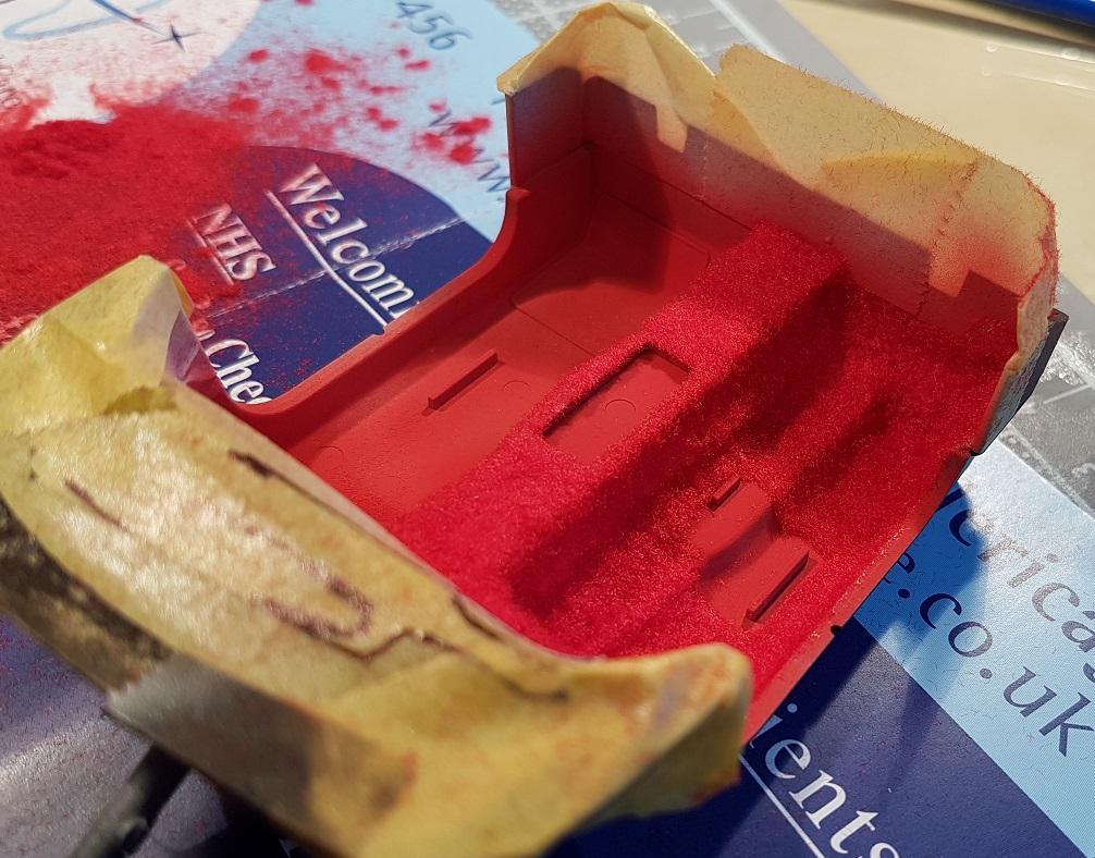

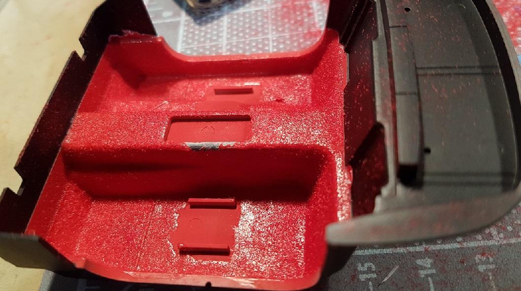

Funkychiken Posted October 28, 2016 Author Posted October 28, 2016 So fell into some problems! Nice & neatly masked & painted the interior tub ready for flocking I have used some flocking from HiroBoy, And some PVA glue. Did one half first - so as not to allow the PVA to dry up Patted it down with a brush, then did the other half. But it turned out really weak & see-through, you can see the glossy glue underneath So I've stripped it & will have to start again. Any ideas as to what I'm doing wrong? Should I have watered down the PVA?
DiscoRover007 Posted October 28, 2016 Posted October 28, 2016 Hard to say honestly. Perhaps you didn't put enough flocking material?For the record I use spray adhesive from auto zone and it works great. Any touchup areas after that I use the white glue method.
Modelbuilder Mark Posted October 28, 2016 Posted October 28, 2016 I tend to use paint in a similar shade.
Harry P. Posted October 29, 2016 Posted October 29, 2016 You could have saved yourself a lot of work and just given it a coat of flat clear to hide the shine instead of stripping it all off and starting over.

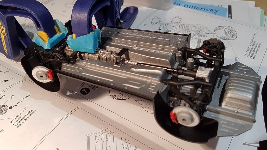

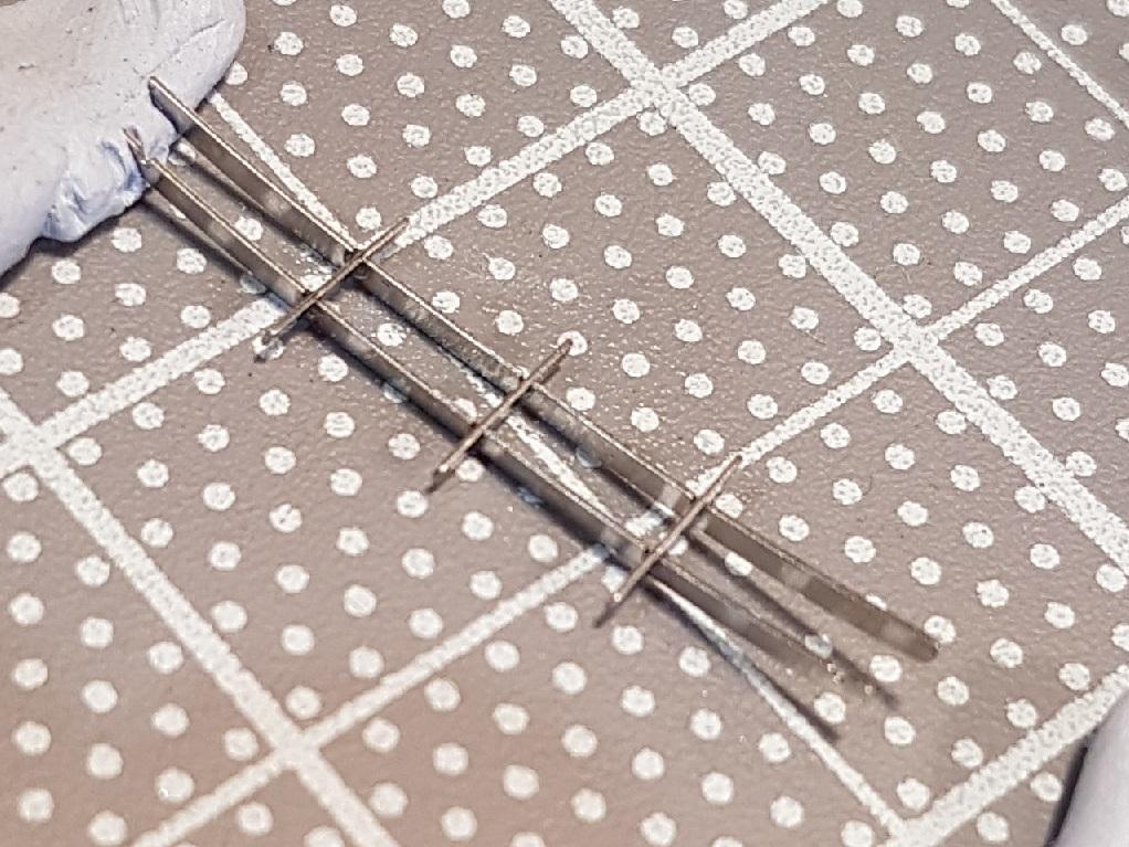

Funkychiken Posted November 5, 2016 Author Posted November 5, 2016 Made some progress on this motor, the chassis is finished, and went together really well, Tamiya make great kits that are well detailed, and well engineered. The problem I have is the grille, without a jig it's really difficult to get it together without it being wonky! Any pointers out there?

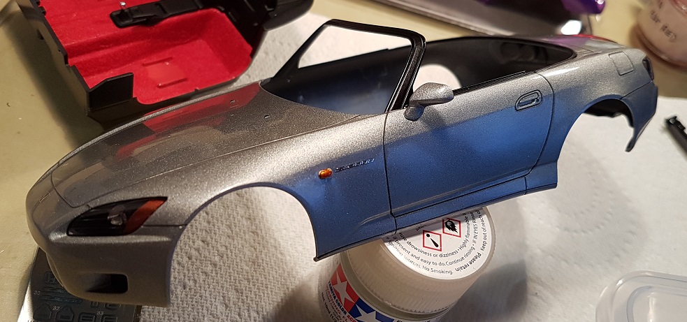

Funkychiken Posted November 28, 2016 Author Posted November 28, 2016 I have now re-painted the interior tub ready for re-flocking. I've also 2K clear coated the body shell, but I think the hardener was off. It clumped up in the airbrush & caused some spluttering. I plan to sand / buff these out, but it's going to take time...!
superbike-shaun Posted December 5, 2016 Posted December 5, 2016 Looks AWESOME,I think those r just minor setbacks,that clear looks pretty glossy!

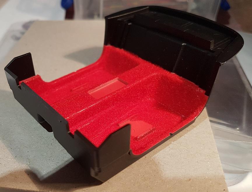

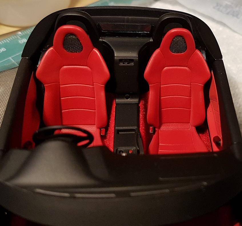

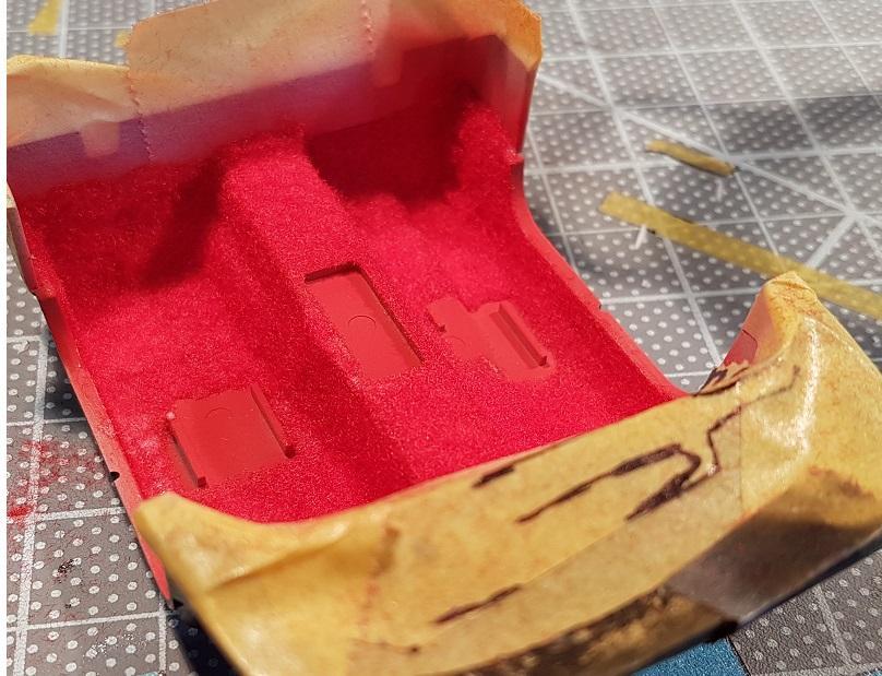

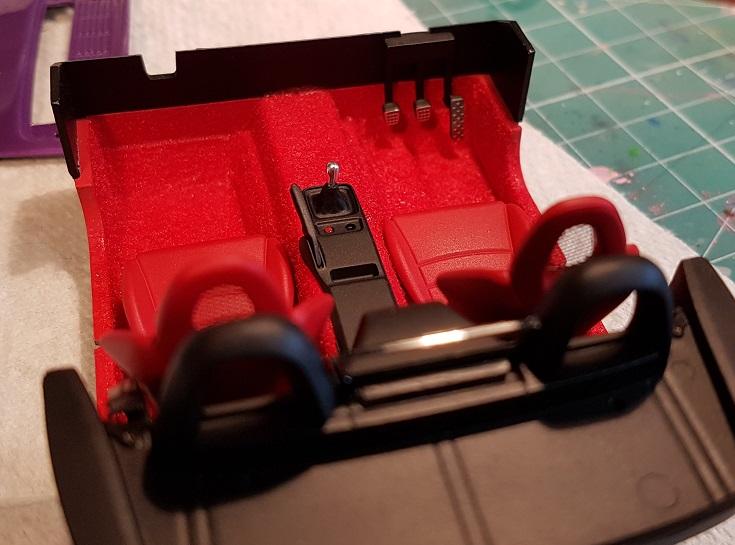

Funkychiken Posted December 24, 2016 Author Posted December 24, 2016 Thanks for the comments guys! 2nd attempt at flocking the interior, also with hiro boy flocking, but what I changed was diluting the white glue about 1 to 1 with water and doing the flocking in different orientations so that it didn't flow too much, it took 5 orientations to complete, but looks better now, ready for the interior to be assembled. I am having some trouble with the P/E kit seat belt material, I will post a question in the help section to see what people think...

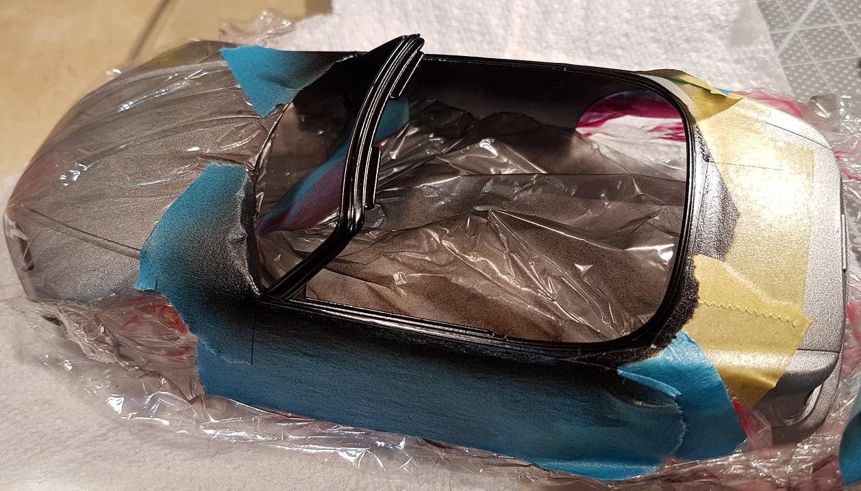

Funkychiken Posted December 31, 2016 Author Posted December 31, 2016 Masked & painted the black part of the body. I won't be doing both X1 & X18 (part gloss, part semi-gloss black), as it's tedious, I just did it all in X-18 Semi-gloss. Not long to go now....

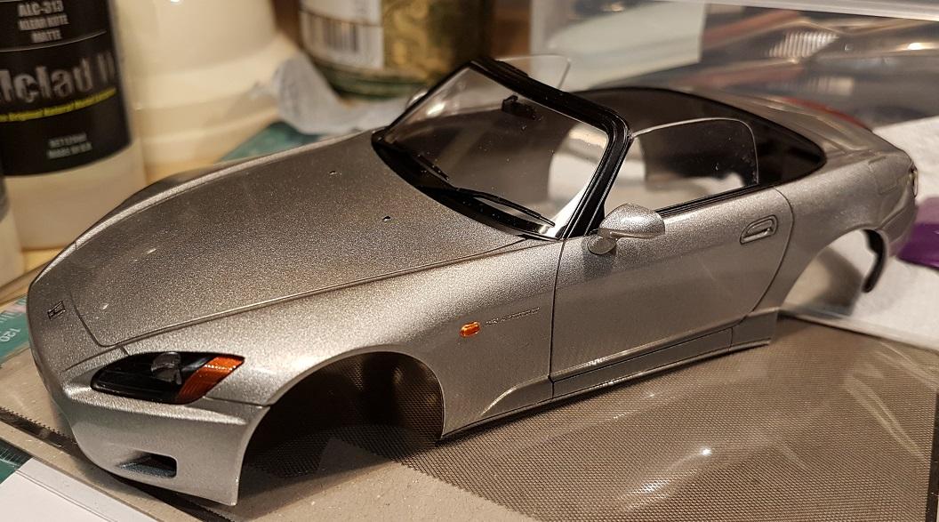

Funkychiken Posted January 15, 2017 Author Posted January 15, 2017 Thanks for the comment Jonathan! It's been polished out a few times, the paint blemishes look like bubbles stuck in the paint, but as you can see, it doesn't turn out too bad in the photos. This was sanded using Tamiya sand paper, polished using Novous 3 stage compounds - for stage 1 I used a dremel, it made a chuffing mess everywhere, but the results are great...

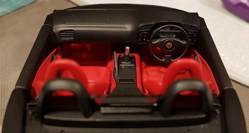

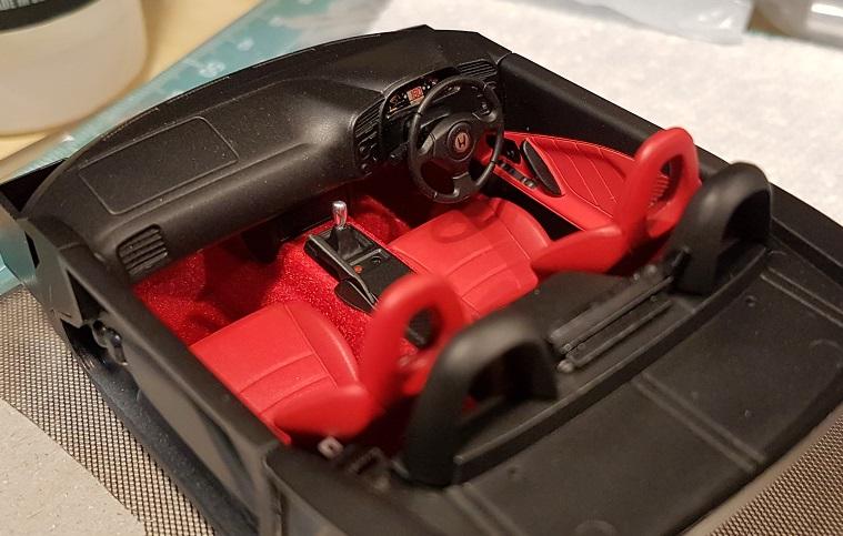

Funkychiken Posted February 13, 2017 Author Posted February 13, 2017 Interior is now finished. What took time was the seatbelts AND YOU CAN'T EVEN SEE THEM IN THE PHOTOS! But I know they are there.... :-( Now it's assembled, I don't know why I bothered with the photoetch on the pedals. The glass is also in the body shell. Only lacking exhaust tips now, they have had the chrome stripped, and are waiting for spraying... this one is not far off from being my first of 2017!
kelson Posted February 14, 2017 Posted February 14, 2017 Nice work so far,it's good that you added the seat belts especially in a convertible and because someone would point out 'how come you didn't add the seatbelts?'
