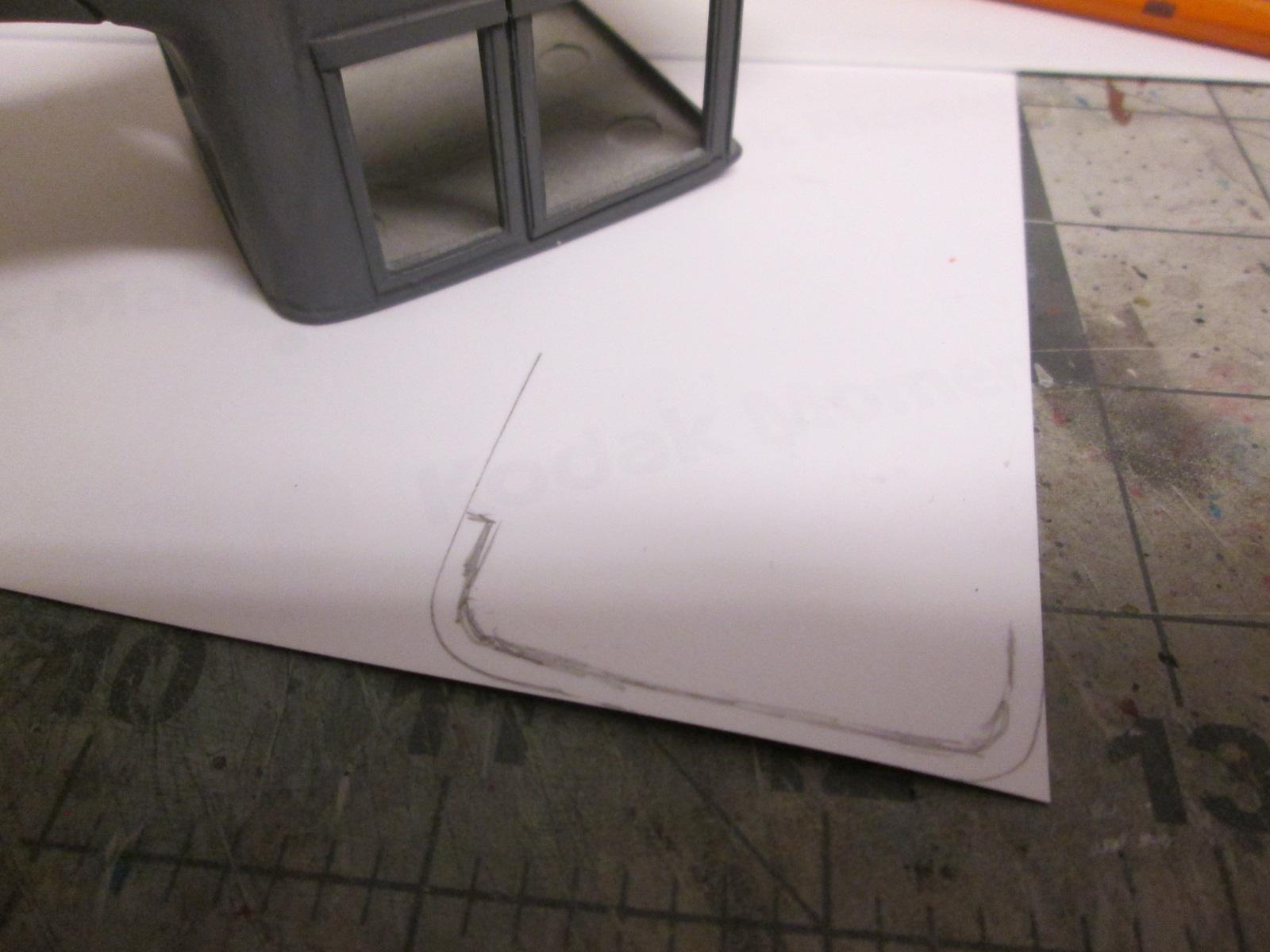

I'm glad you like it Art. working on the parcel shelf tonight. Made a template using the curve of the roof and narrowed it until it just hangs in there by itself.

I'm enjoying this too :)
It very definitely no longer looks like a Ford. Great work on all the little details that differentiated the Dodge from other similarly-appearing vehicles of the time!
