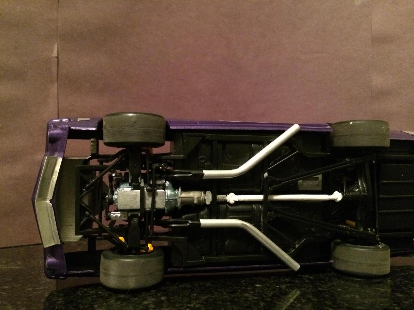

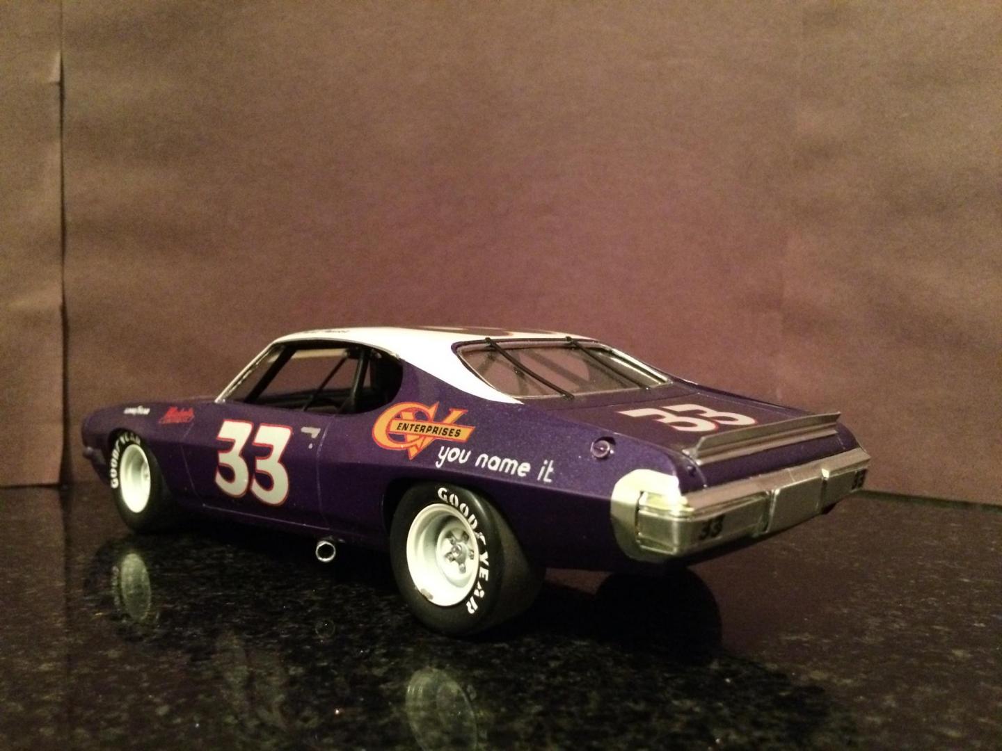

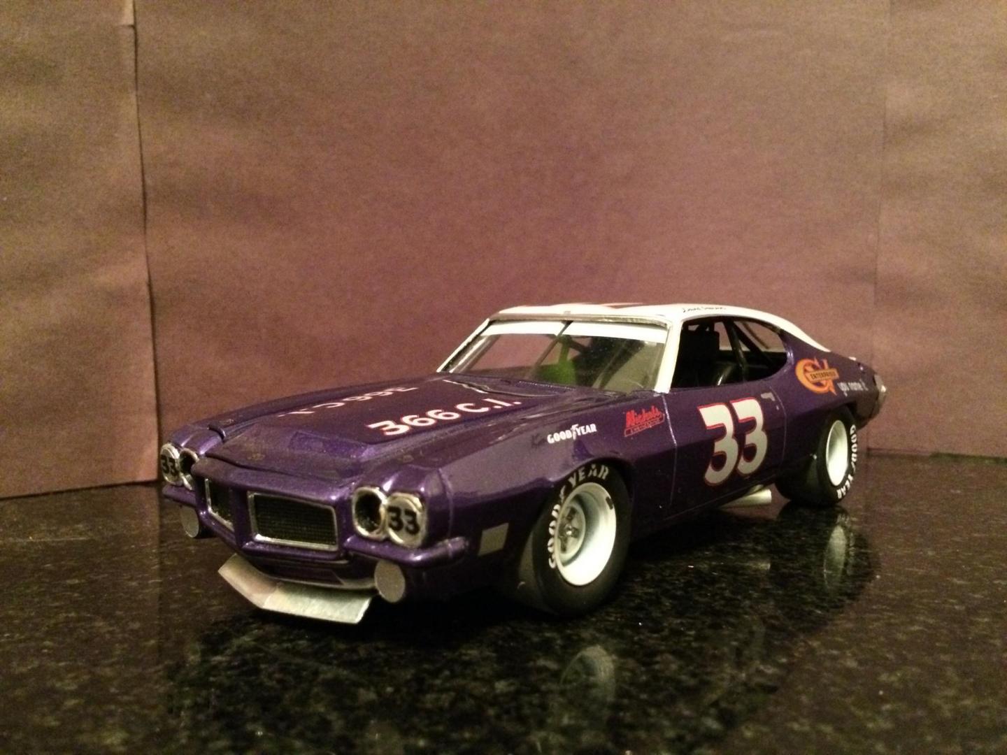

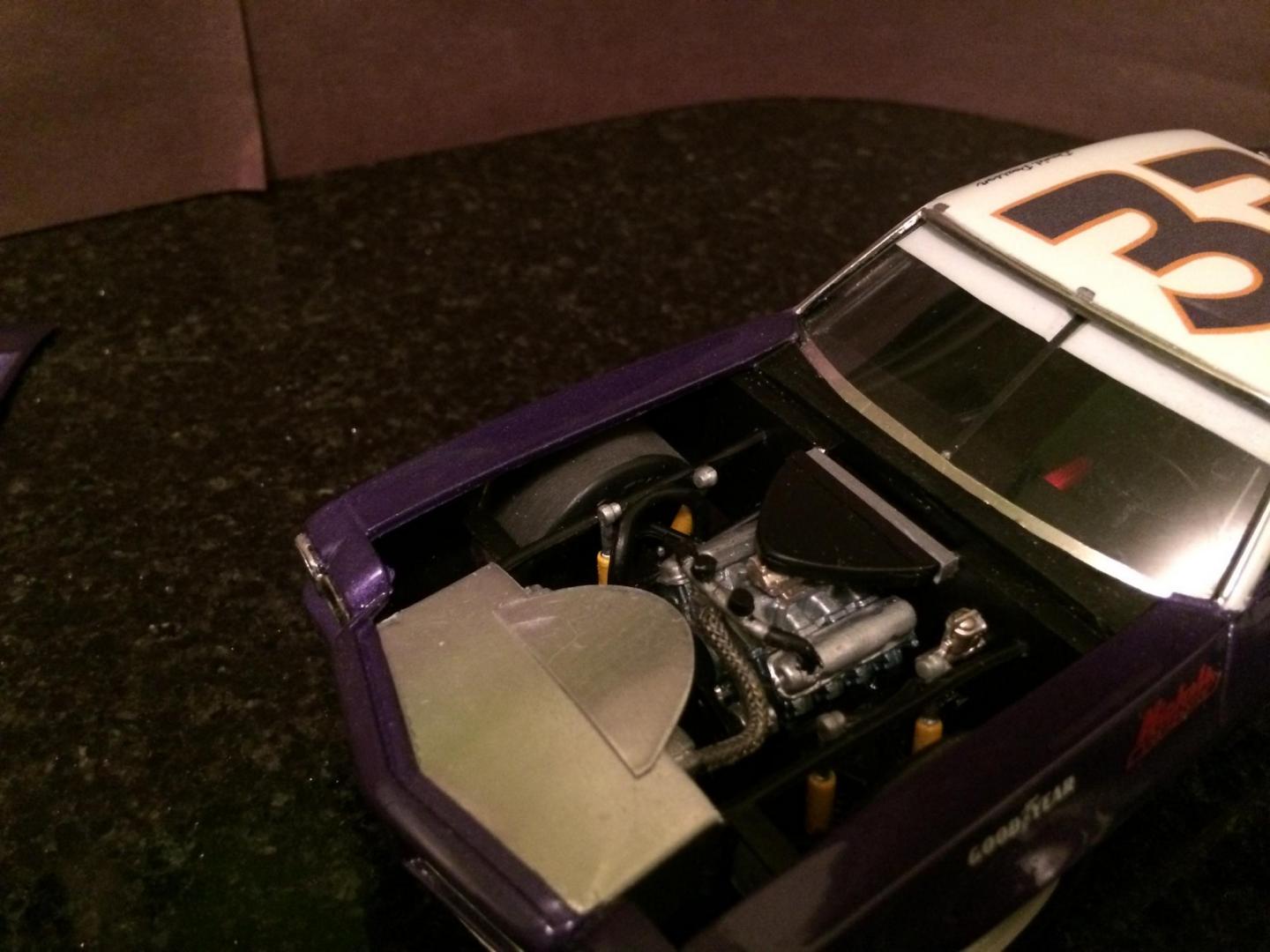

yellowsportwagon Posted December 29, 2016 Posted December 29, 2016 (edited) I tried to build this car just as Nichels Engineering built the real car. Used a frame from a Polar lights 64 GTO because it was separate from the floor pan.Cut off the frame at the firewall and attached a Holman Moody frt frame section. Put Chevy truck rear control arms on the back . Modified a Polar Light Talledega roll cage to fit.Then I filled the fender and hood scoops. Opened up all wheel openings and flared the frts. Moved the grille forward made the spoilers and narrowed the rear bumper.Painted Plum Crazy and White with Billy Goochie decals. PPP tires with AMT NASCAR tires. Stock GTO kit engine with AMT NASCAR 351 Cleveland heads reshaped to look like Pontiac RAV heads.Lots of other scratch built bits and pieces.Almost forgot that I moved the back wheel wells back1/8 inch to stretch the wheelbase as was common on GM cars in NASCAR at the time. Tim Edited December 29, 2016 by yellowsportwagon
