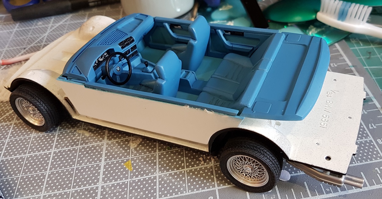

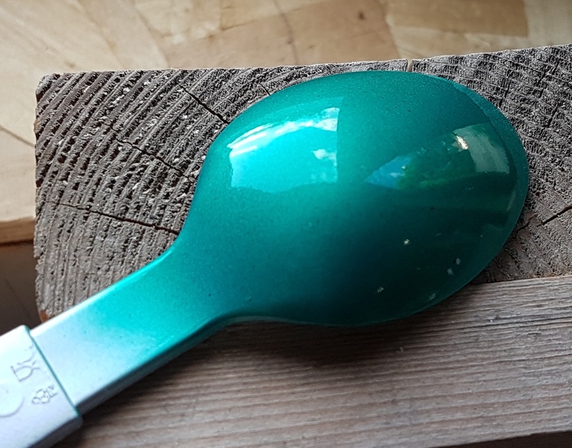

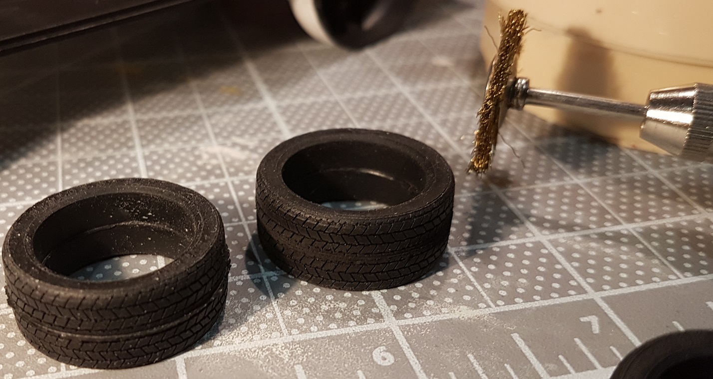

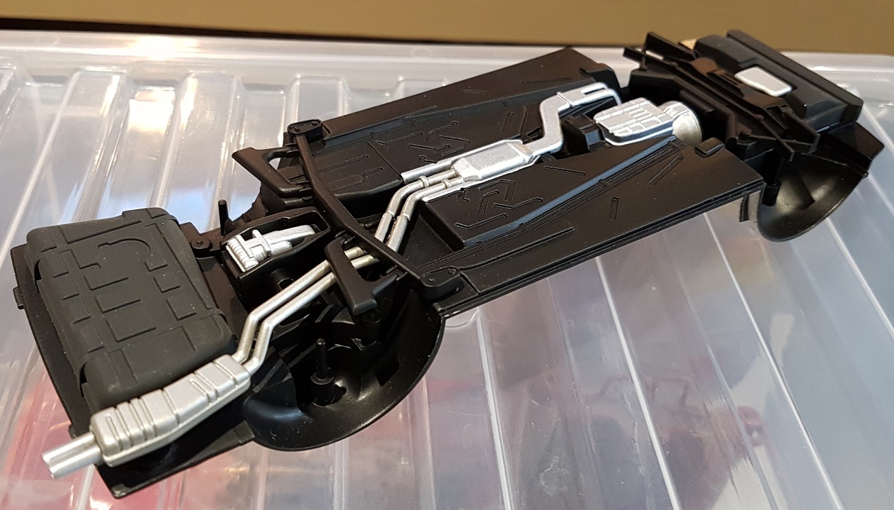

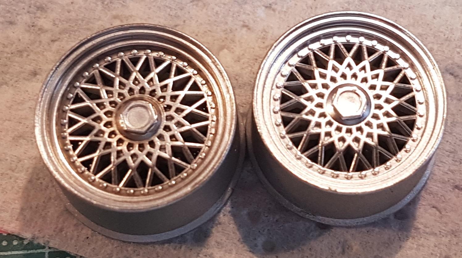

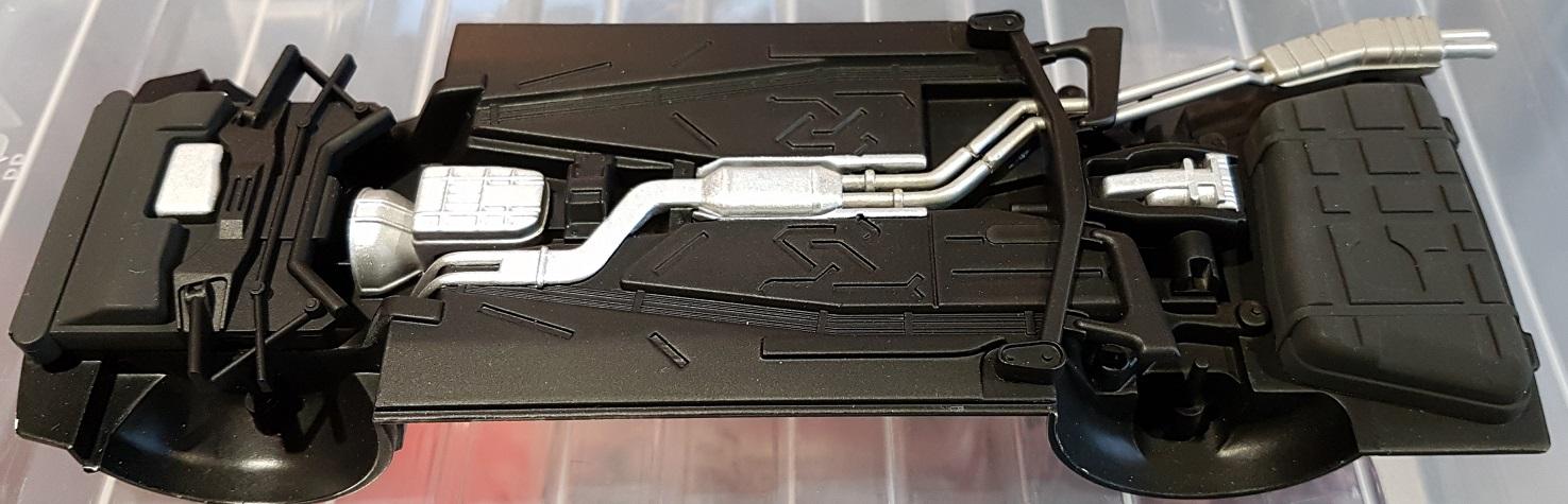

Funkychiken Posted July 27, 2017 Author Posted July 27, 2017 The Chassis is now complete, the only issue was the exhaust position, it was too high & offset to one side. I made a simple washer out of plastic & it sorted it out. I conducted another spoon test. The photo is not good, but the spoon on the right is under-coated with Tamiya silver spray, and the paint has been filtered through some tights, and thinned with Lacquer thinner. There are some large dark spots, but it'll do... The tyres' flash was removed with this dremel thing, it made a bloody mess everywhere, and I almost lost the thread. A bit of diluted Indian Ink lifts the details on the wheels... just the body left now.

tmathew1us Posted August 7, 2017 Posted August 7, 2017 (edited) Coming along very nicely, you don't see a lot these kits completed. Looking forward to the finished product.It looks like you are getting a lot of splatter and dark spots on your test spoons - is the paint being thoroughly mixed? Spraying at about 25 PSI? Just make sure to test again on the spoons before spraying the paint onto the body. Edited August 7, 2017 by tmathew1us misspelling

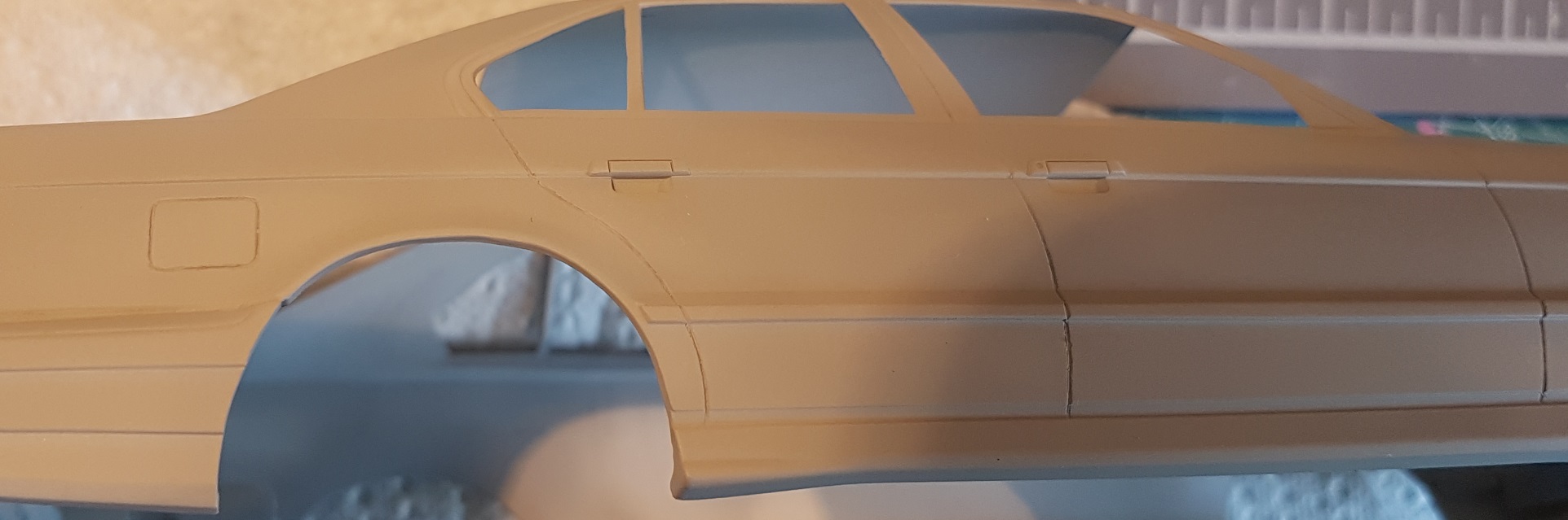

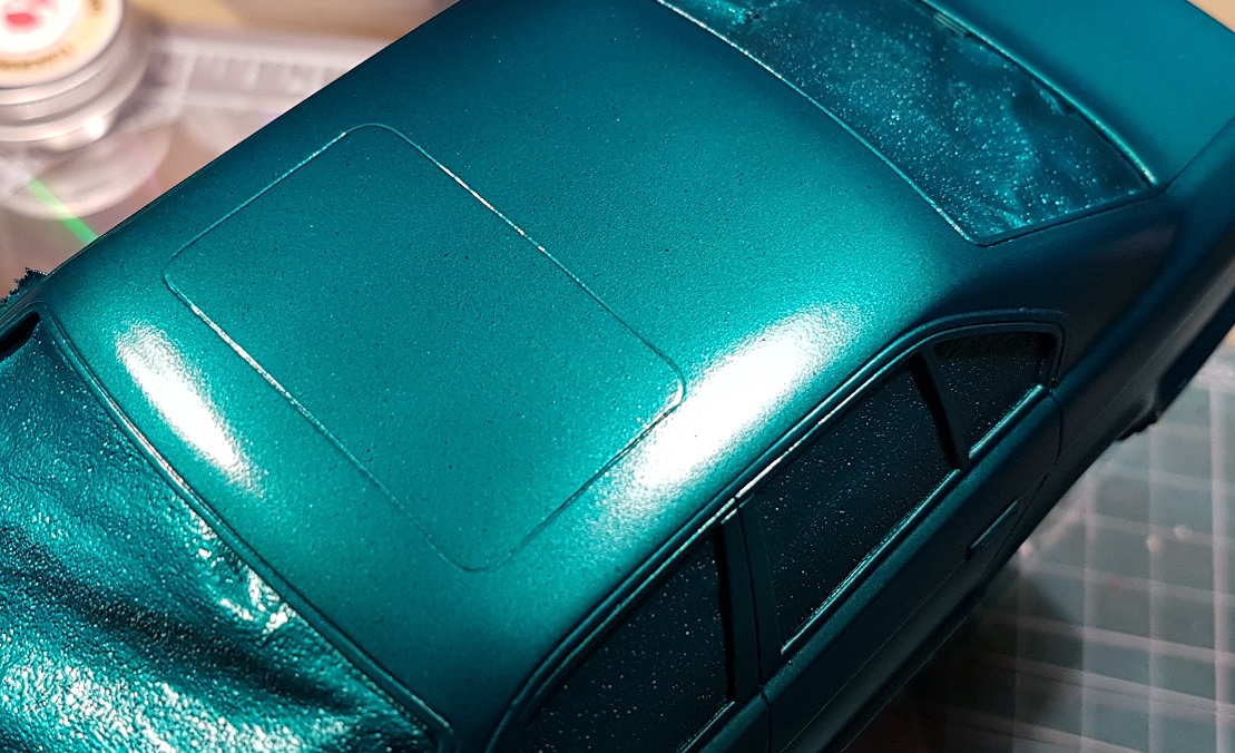

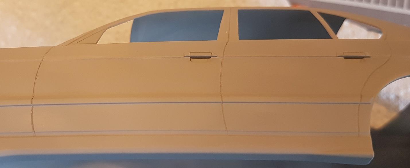

Funkychiken Posted September 7, 2017 Author Posted September 7, 2017 The body shell has been a battle. I've been trying to deepen the panel lines, and ended up having to fill my mistakes. You can see how it turned out in the sun roof... not great. So I've decided just to paint it as is. It's Zero Paints primer, then a couple of coats of Tamiya spray can silver - with a light sanding in-between coats... I'll let this sit for a few weeks then go over it with the boston green...
Dann Tier Posted September 8, 2017 Posted September 8, 2017 I still think it looks good.......maybe the paint will help fill-in a bit and distract.

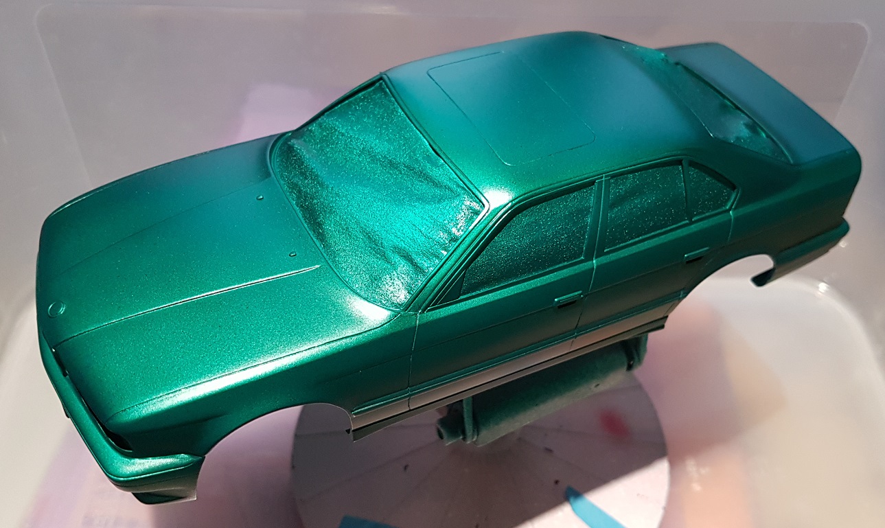

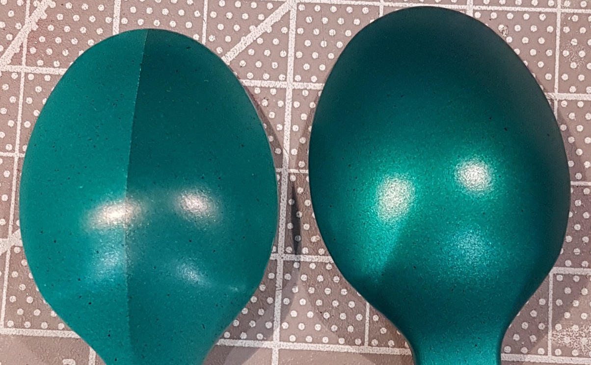

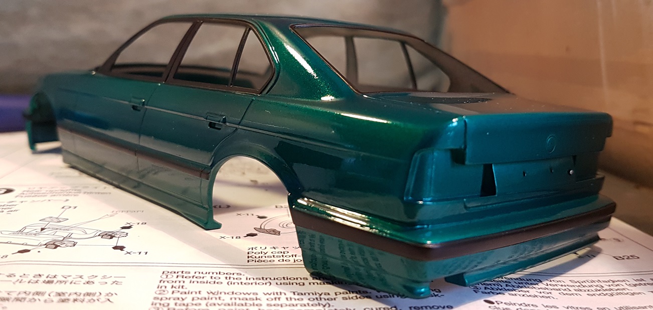

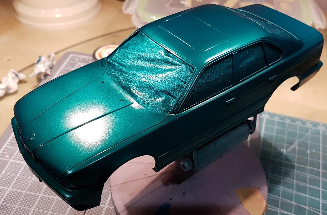

Funkychiken Posted September 25, 2017 Author Posted September 25, 2017 (edited) This is the body with the Boston Green Touch up paint applied. It's Filtered through some old tights - due to heavy dark sediments. Not sue if that's part of the colour, or it's a defective mix. It is also diluted quite a lot with lacquer thinner (Tamiya brand) It has 1 mist coat, then 2 medium coats, then a few days drying, a light sanding with 6000 grit cloth, which went through to the silver substrate, then 2 more medium coats. It's a strange colour, it looks really dark, but held up to the light and after a photo, it looks great. Not so great in real life, it's too dark. The spoon is coated with Zero Paints 1K clear. It's had 1 mist coat & 2 heavy coats. Looks great to me. give it a week & I'll be applying the clear...! Edited September 25, 2017 by Funkychiken mistake

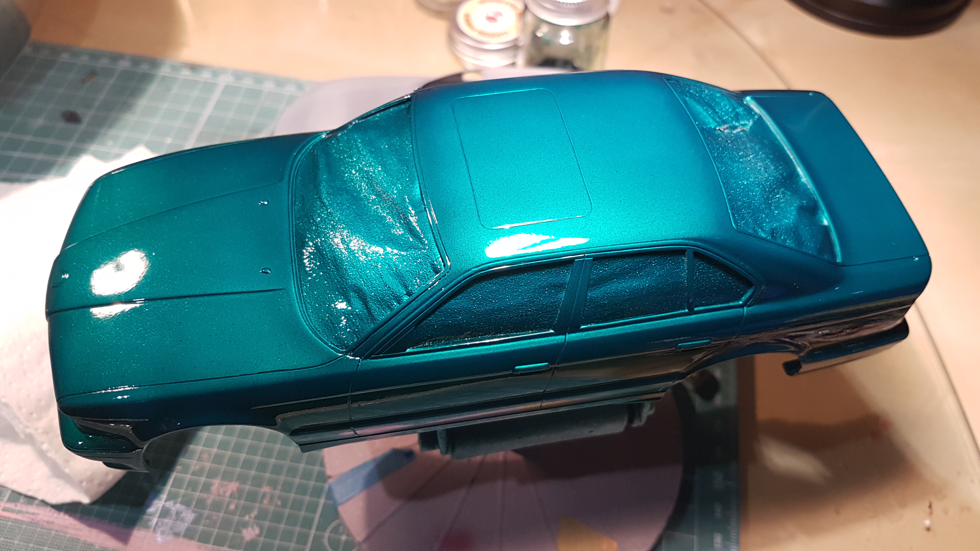

Funkychiken Posted November 5, 2017 Author Posted November 5, 2017 So applying to a spoon is one thing, but on a body, an entirely different kettle of fish... I tried to coat the 1K over the body, using the same technique as I did with the spoon, and it was a bit patchy. Plus I had a bit of dust embedded. I tried to sand too soon, and ended up ruining the clear-coat. I tried to recover it, but it didn't work. SO I keyed the whole body again, and re-sprayed the body. a few shots of that to follow. Only need to clear coat again now... but it'd getting cold...

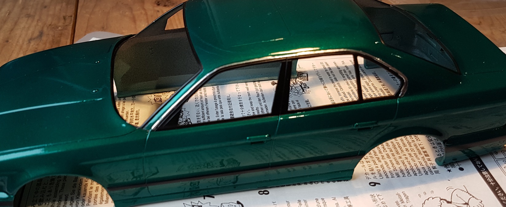

Funkychiken Posted November 10, 2017 Author Posted November 10, 2017 And the final clear coat is down. 1 light coat and two heavy ones. Looks like it will need a polish, I don't think I'll be trying to sand it out. Would be good to finish one this year...

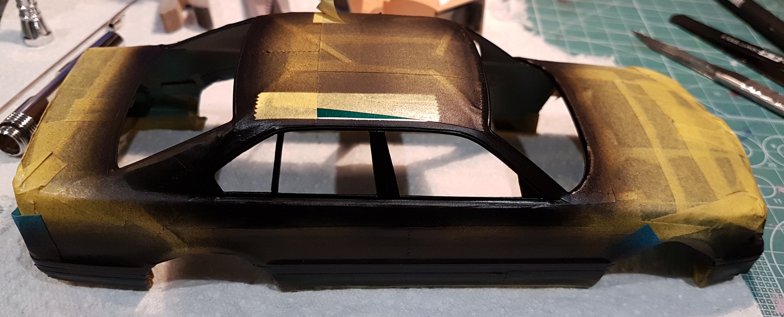

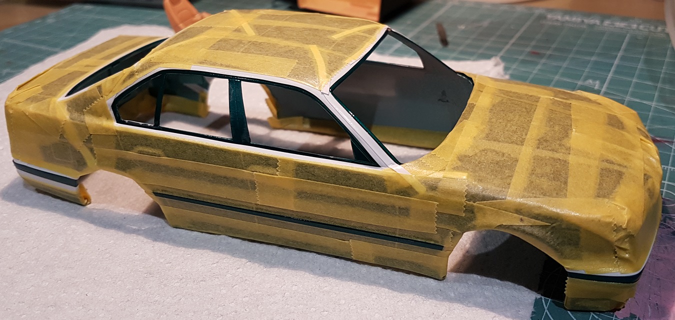

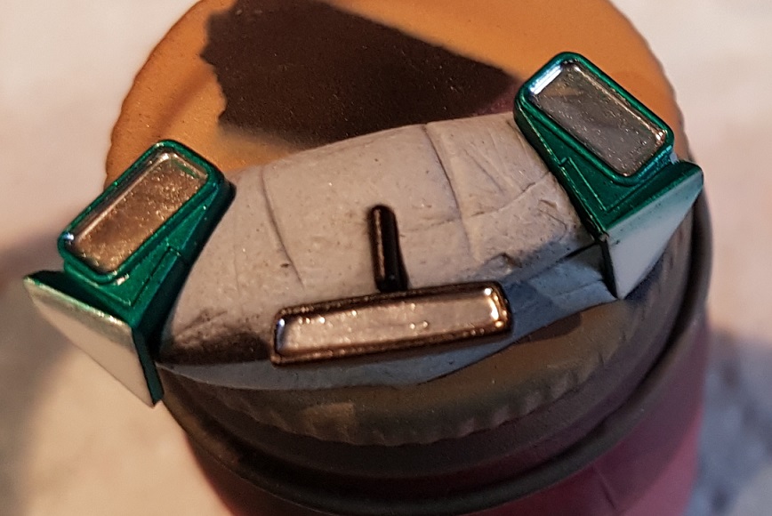

Funkychiken Posted December 10, 2017 Author Posted December 10, 2017 Masked & sprayed Tamiya Acrylic Black, I lightly scuffed the gloss prior to spraying. just the final detailing now...

kelson Posted December 11, 2017 Posted December 11, 2017 Nice looking paint job!,glad to see the masking came out nice and clean,i;ve had to repaint countless times because of bleed through.

tmathew1us Posted December 12, 2017 Posted December 12, 2017 On 12/10/2017 at 5:02 PM, Funkychiken said: Masked & sprayed Tamiya Acrylic Black, I lightly scuffed the gloss prior to spraying. just the final detailing now... Masking came out great! What is the white stuff you are using under the Tamiya tape?
935k3 Posted December 12, 2017 Posted December 12, 2017 8 minutes ago, tmathew1us said: Masking came out great! What is the white stuff you are using under the Tamiya tape? I think it's the new flexible trim tapes from Tamiya
Funkychiken Posted December 15, 2017 Author Posted December 15, 2017 On 12/12/2017 at 3:58 AM, 935k3 said: I think it's the new flexible trim tapes from Tamiya Yes it is, and they work a treat for me

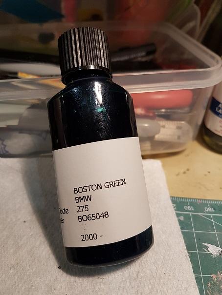

PatW Posted December 29, 2017 Posted December 29, 2017 On 26/02/2017 at 10:13 PM, Funkychiken said: And thanks to Mr Espo, It got me thinking, and I decided to go for Boston Green. Got this little bottle off eBay for about a fiver. The pic is the colour I'm aiming for It's the same colour as our 7 series we had a few years ago, nice!
