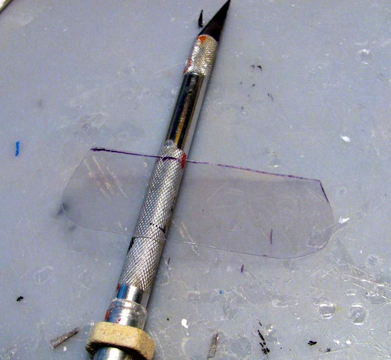

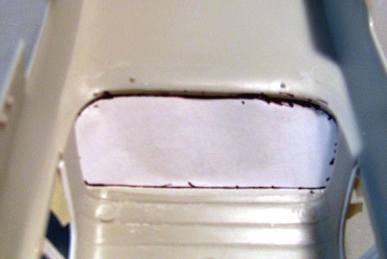

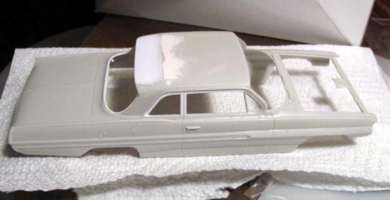

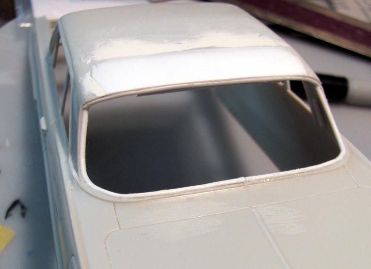

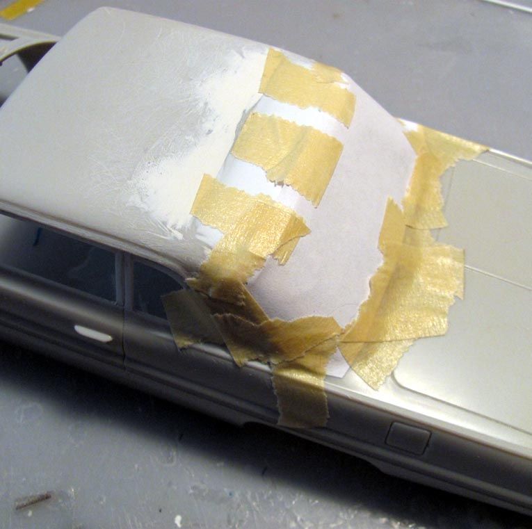

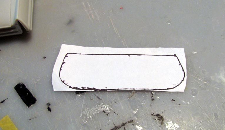

I have to make a back glass so this I how I'm going about it. I used just regular old printer paper. Draped it around the outside of the opening then trace on it from the inside to give myself a pattern for the glass. It still has to be trimmed but it gets me in the ballpark. You cut out the paper pattern and transfer it to some clear plastic. I got this clear plastic from a knife sharpener I got for Christmas. Never throw away your clear plastic packaging material it might come in handy some day. I installed some strips around the back glass opening and this will allow me to just snap the glass into place using the strips to hold it there. I borrowed my wife's hair dryer to heat and bend the back glass into the basic shape I need. I tried using some evergreen clear plastic sheet but it was too thick and when I tried to bend it, it left stretch marks in the plastic. I will still probably need to use some white glue but hopefully just a minimal amount. The strip at the bottom of the opening is actually two strips which form a type of gutter for the glass to sit in.

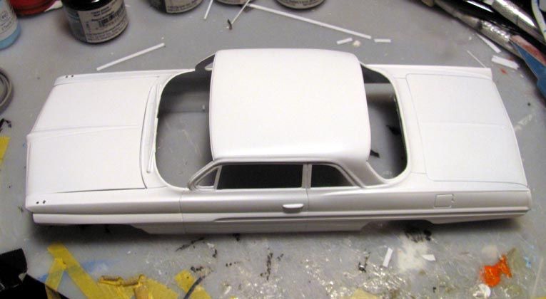

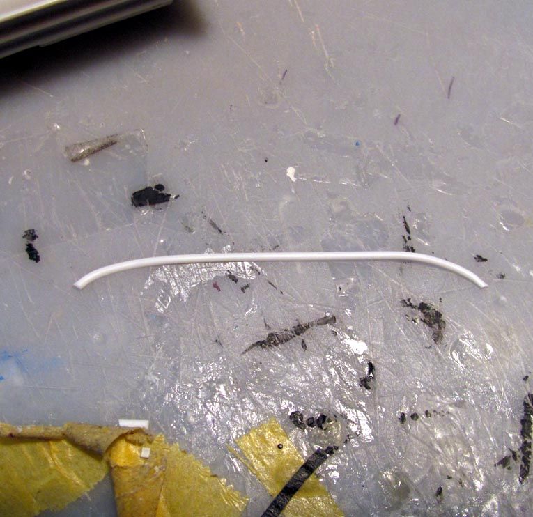

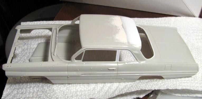

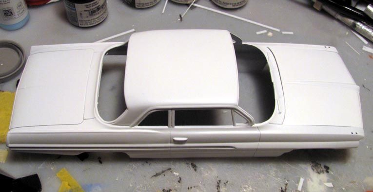

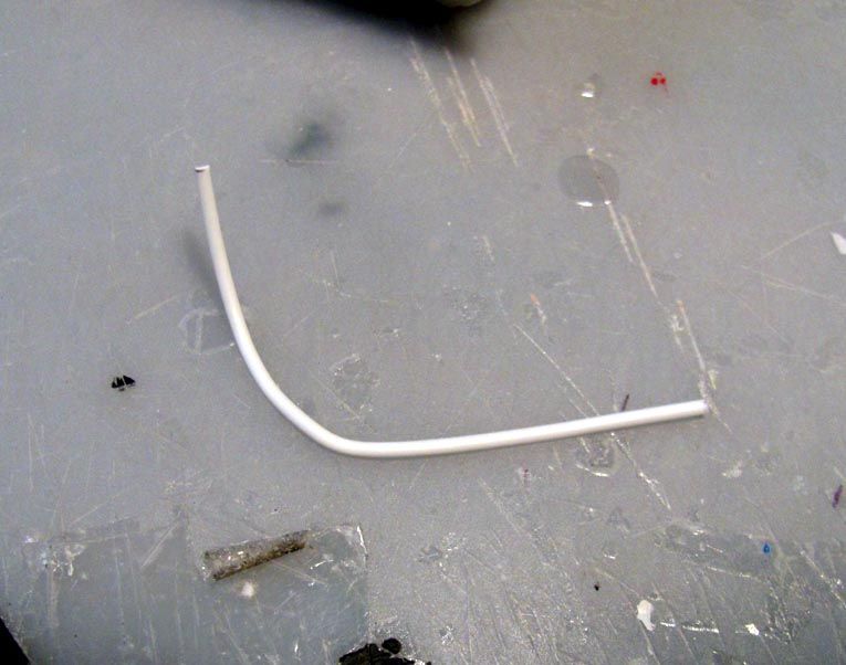

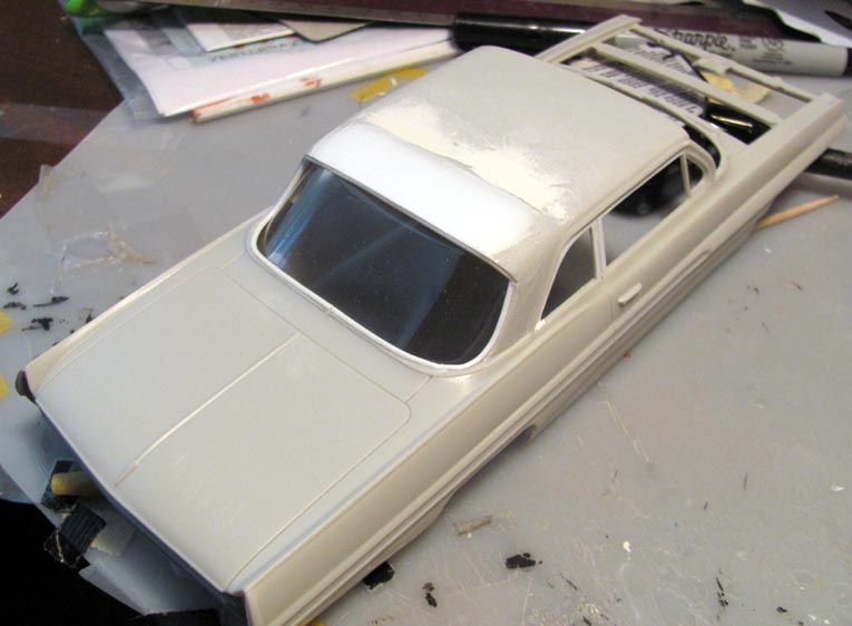

I made back glass mouldings from half round styrene strips. I am through with the roof mods and ready to move on to priming the body and then painting. The back glass snapped into place pretty good. When I do the final install of the back glass I can get it to fit a little more flush in the corners. It will actually fit better than some kit glasses I have installed.

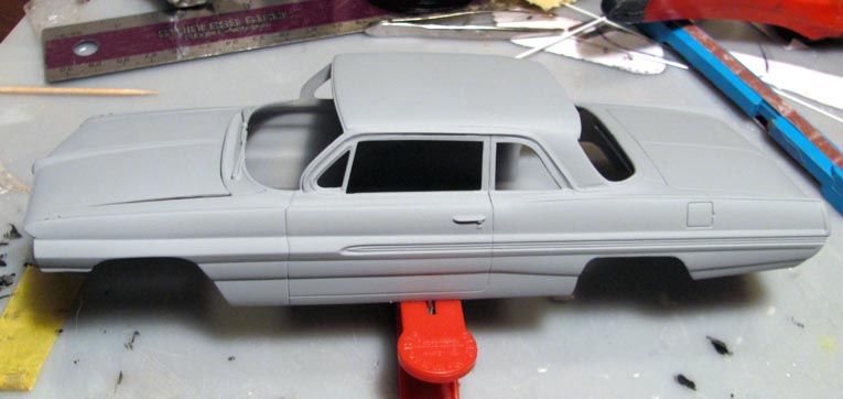

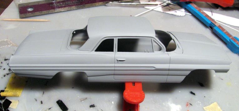

Got the first primer coat on. A couple more rounds of primer and block sanding should get the body ready for paint.

Making that rear window from clear plastic packaging is a great idea. I've tried to heat up sheet acetate a couple of times but never succeeded in it. I think I'll have to try this one next.

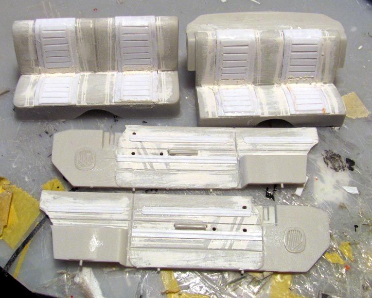

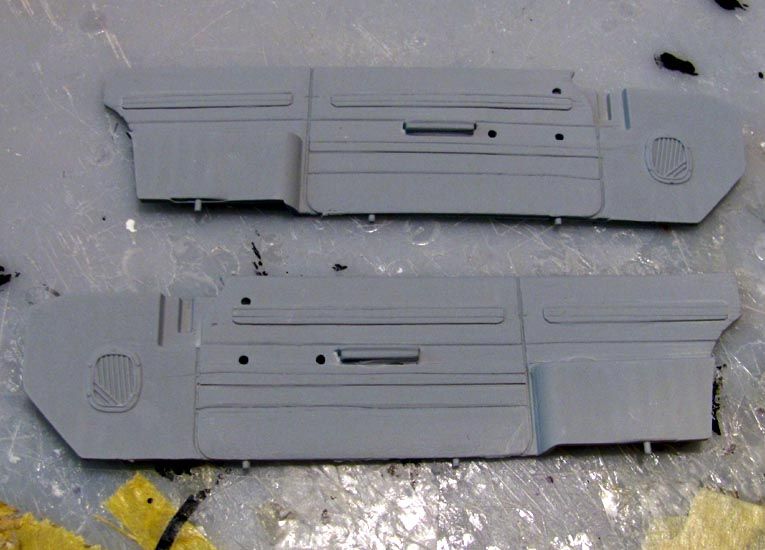

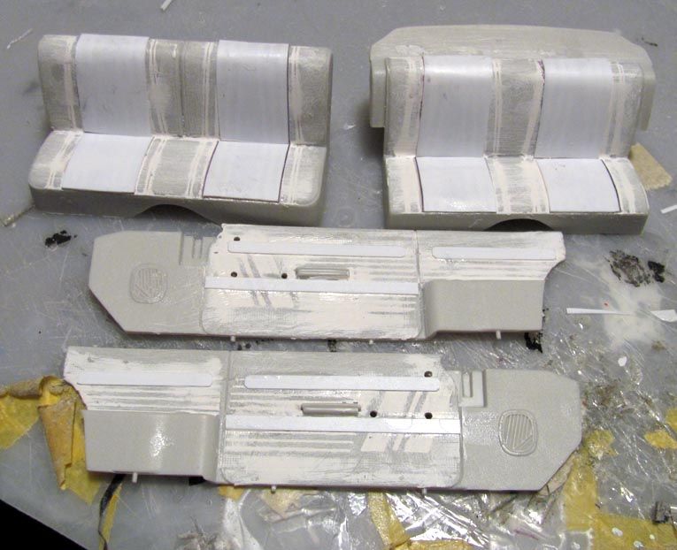

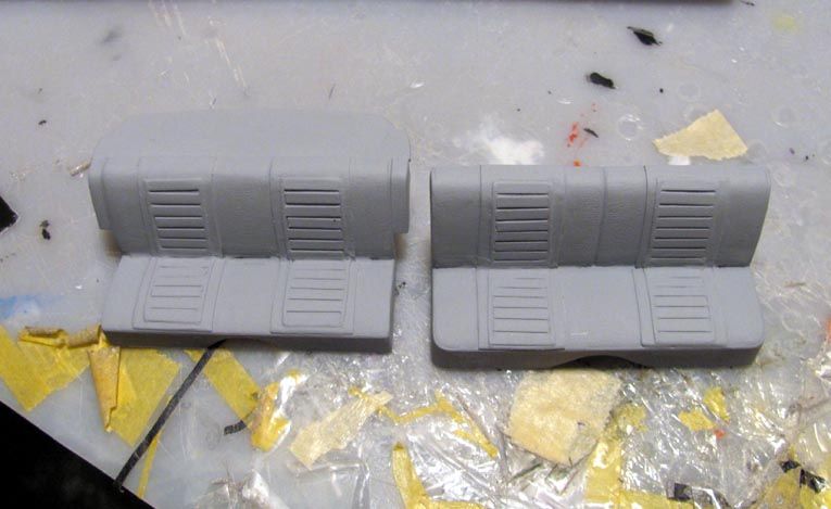

When the owner of the original car got it from the factory, he decided to put aftermarket seat covers on the seats to protect them. I am trying to duplicate them the best I can using one picture from a bad angle. The original car had different trim panels then what comes in the kit so I am trying to change them to look a little more like what was on the real car. Again the picture I have is not that good quality so they will just be in the ball park but not exactly like the ones that came in the real car. I will have to make new door handles from scratch but it should not be that hard. They are just small pieces of rod and strips glued together. 62donmosech1_zpslowrkkvp.jpg

I am finally ready to paint the body. I had to order some paint from scalefinishes because I could not find the right color from Tamiya or Testors in an aerosol can. I will have to dust off my airbrush and relearn how to use it. Its been years since I have used it. I have heard good things about scalefinishes and have seen pictures of models on google that were finished with their paints and they looked beautiful. I have a spare body to practice on before I paint this one. I need to add some more putty to the seats and do some more sanding and I need to add door handles to the door trim panels. A great friend on the board has come through and will send me the missing wheels I need.

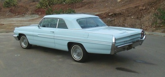

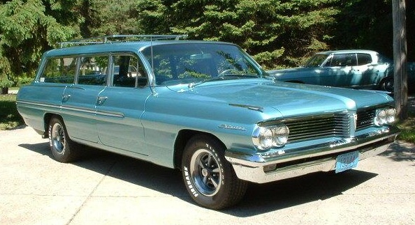

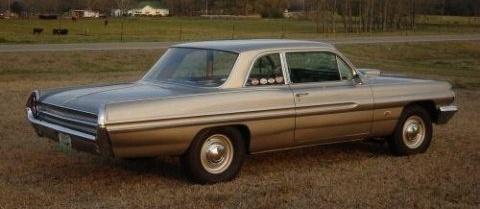

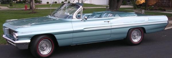

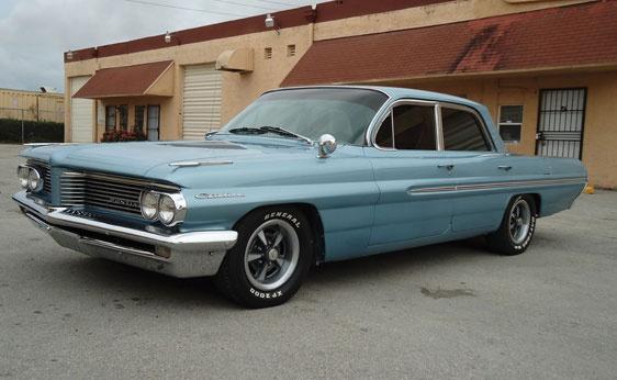

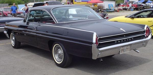

I had to Google this car to see what the difference in the back window was, but the more I looked, the more choices I found.   3 different coupes, a four door, wagon and convertible.
Hmmm..........This "bubbletop" would more than likely be a custom job as Chevy was the only one to keep that roofline in '62 for the Bel Air. That might have been proposed, but the powers that be decided for whatever reason to go with the more formal roofline like the first one you have pictured. Very nice looking car though! B)
