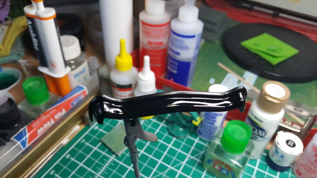

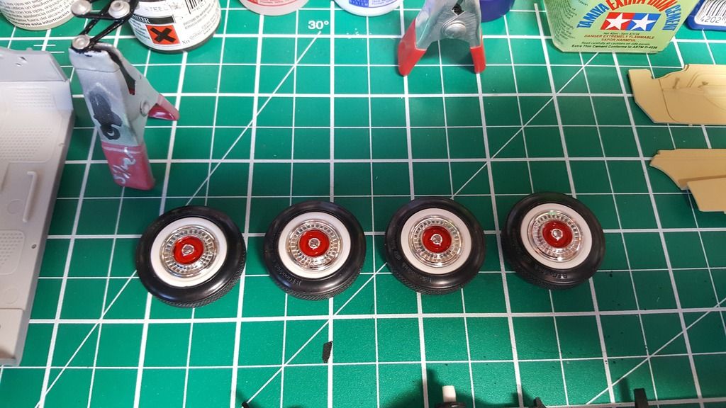

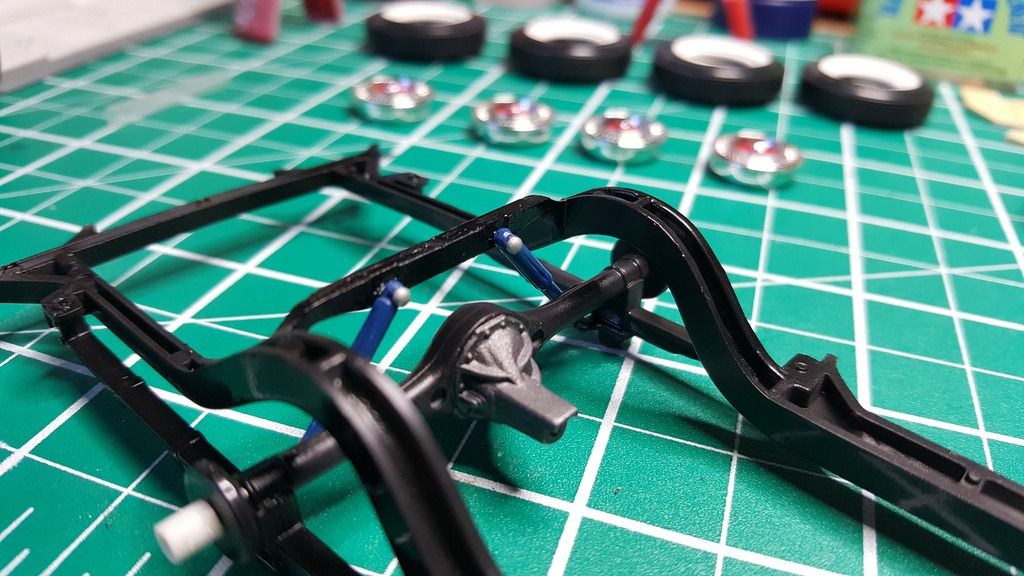

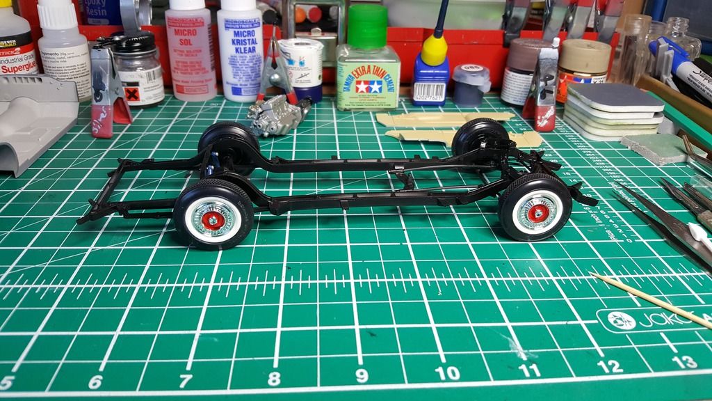

GeeBee Posted February 4, 2017 Author Posted February 4, 2017 Rear bumper chromed using K Colours chrome paint Rear shock absorbers fitted, the pins were airbrushed in Testors Steel Wheels finished, the whitewall inserts were airbrushed using acrylic white primer Rocker covers masked up so the black can be airbrushed

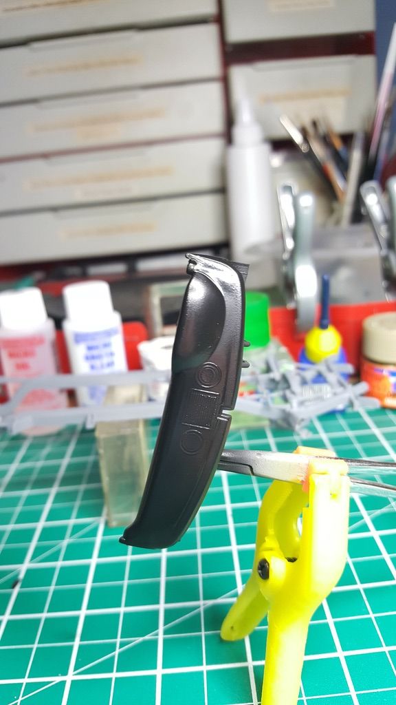

GeeBee Posted February 5, 2017 Author Posted February 5, 2017 Thanks Geoff I didn't realise it was from Italy . Got some on order though they had a stand at the ipms nationals at Telford last year, thought I'd give them a try, I'm glad I did, just a tip, you need to build up the black basecoat in fine layers, leave to dry for half an hour or so, and then do the wet coat, then leave to dry for 72 hours before starting the chrome.

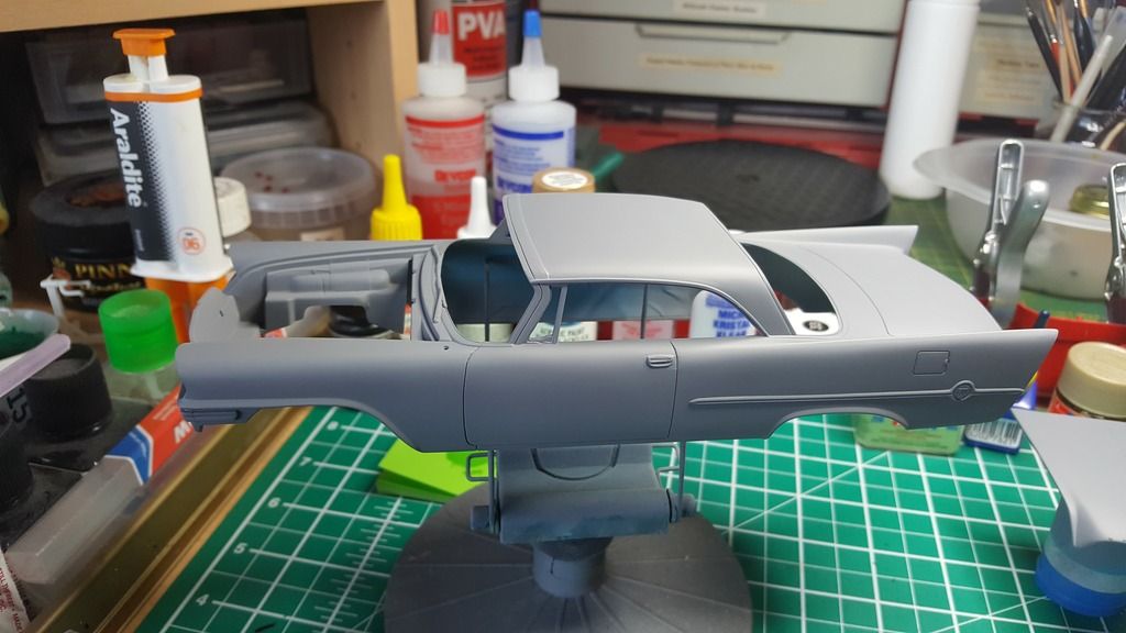

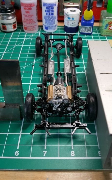

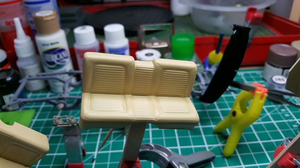

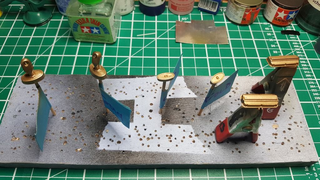

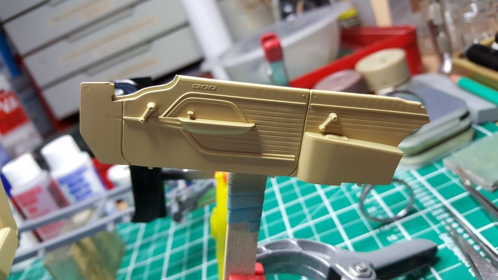

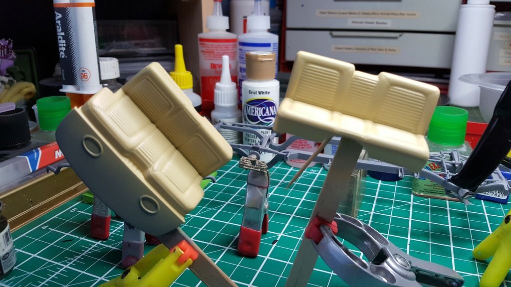

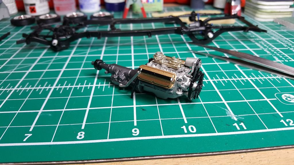

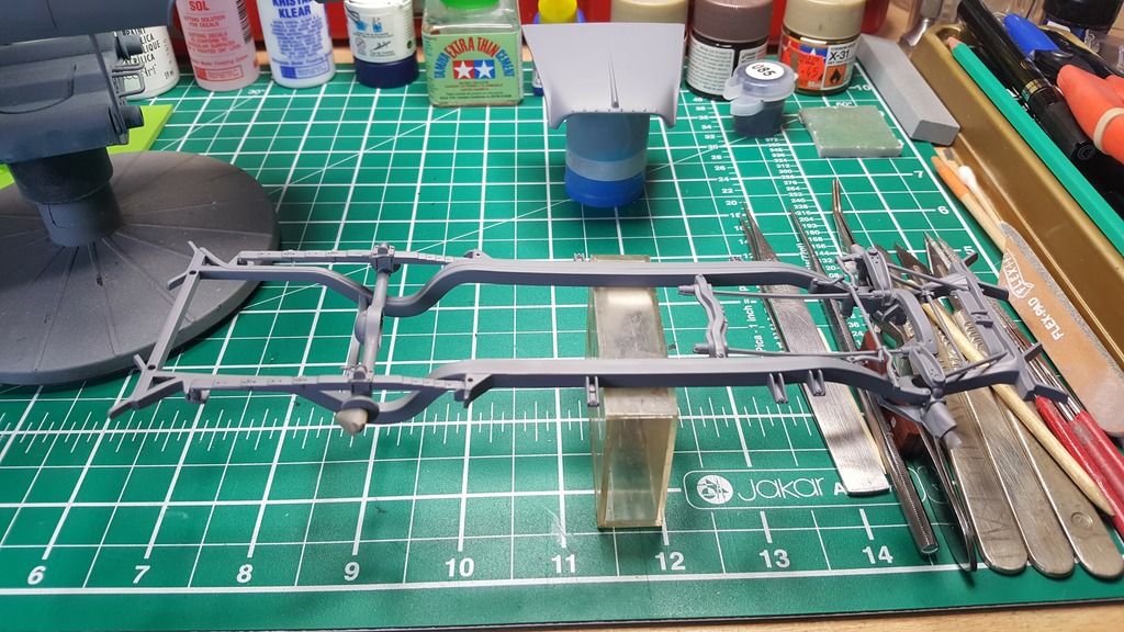

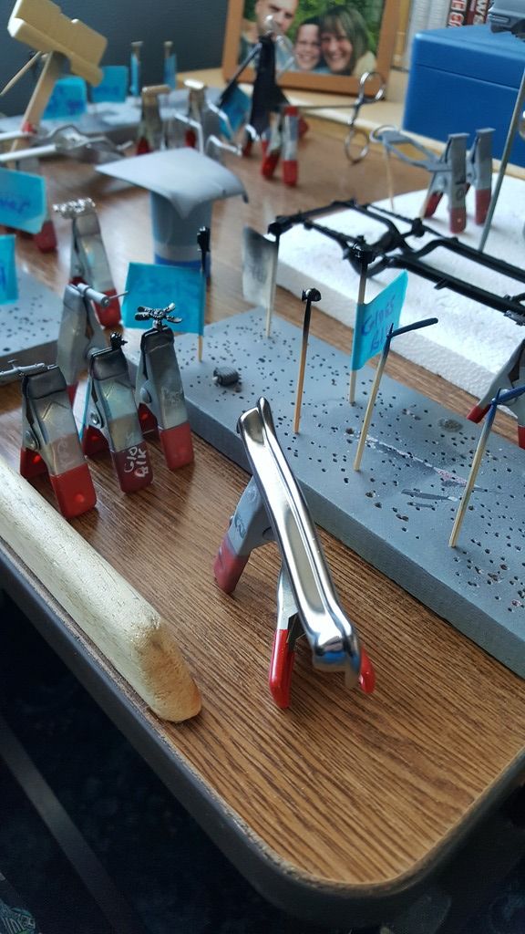

Crizila Posted February 6, 2017 Posted February 6, 2017 While waiting for the paint and the photo etch detail sheet to arrive, I've been busy airbrushing all of the other parts Engine parts painted gold Bumper painted gloss black basecoat ready for the chrome Body in primer Chassis built up and primered Dash top painted in satin black Seats and interior side panels airbrushed Impressive work!! Can't wait to see it done. My father owned one in 57. Loved it. 380HP 392 hemi was pretty fast for the time.

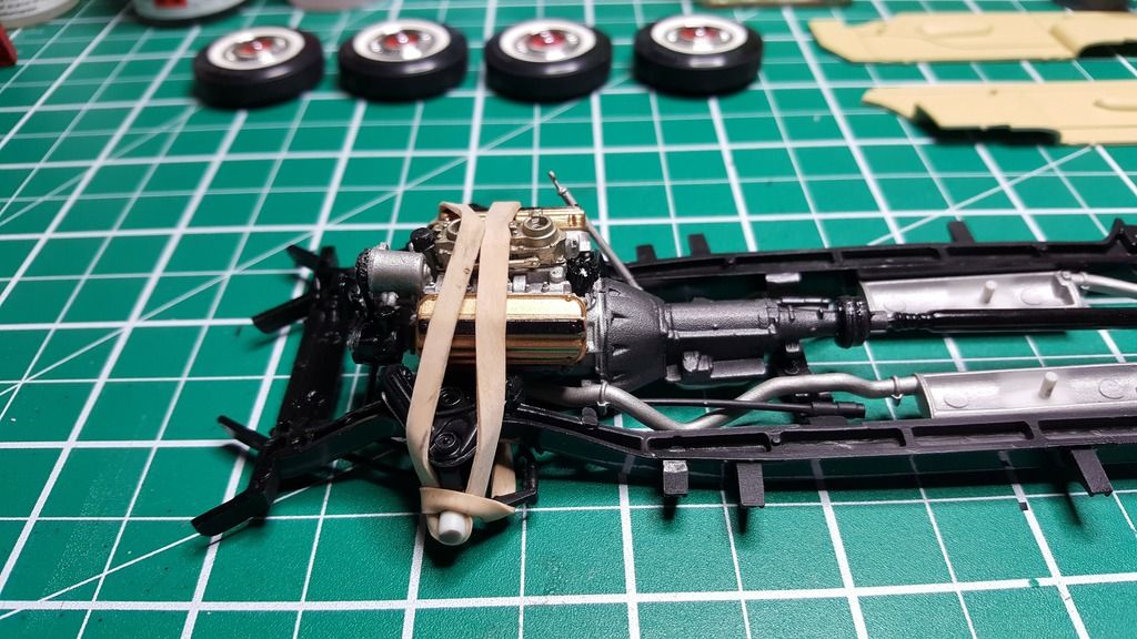

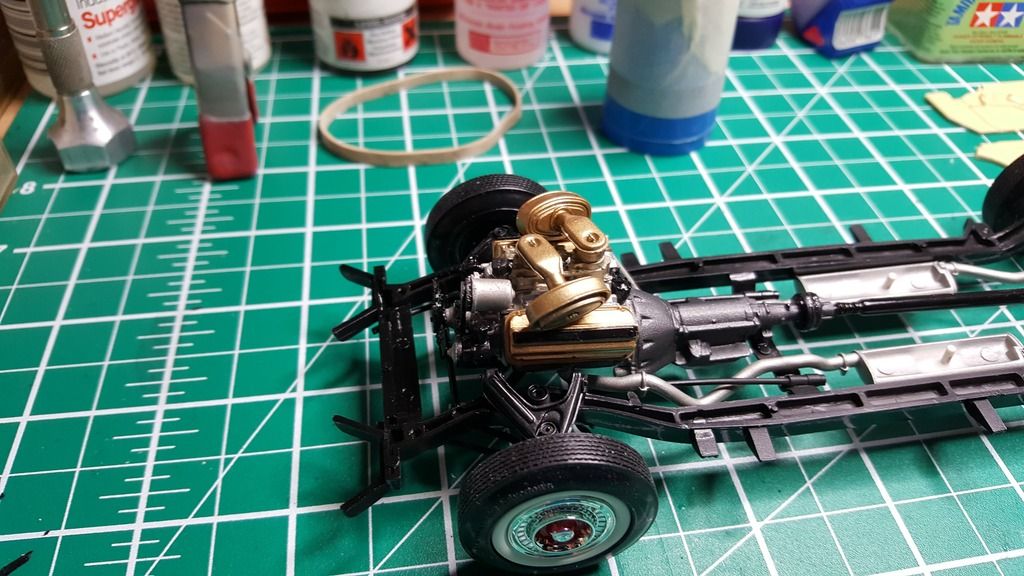

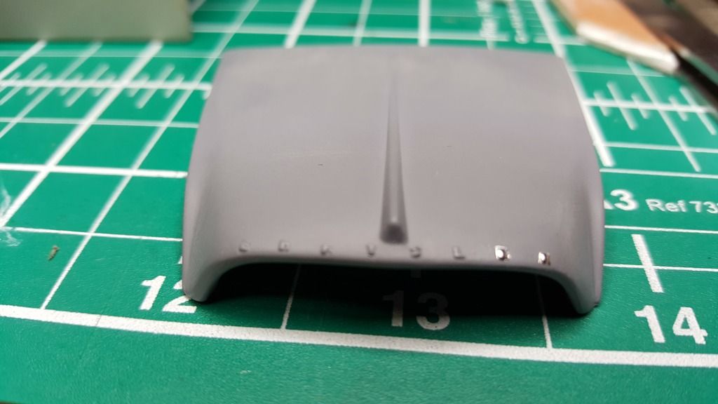

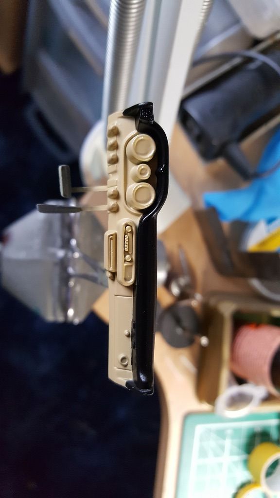

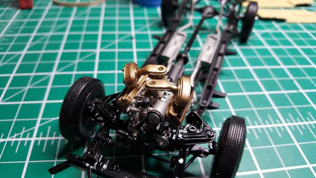

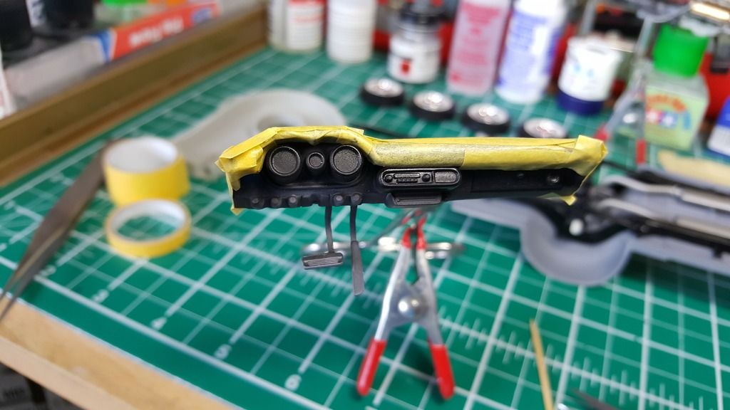

GeeBee Posted February 6, 2017 Author Posted February 6, 2017 Just waiting for the oil filter and air filters to be installed Dash Masked up so the light tan can be airbrushed Probably one of my best masking jobs ... Engine installed in the chassis Started the bmf on the bonnet (Sorry, Hood) All four wheels fitted, and as a bonus, they all tough the ground at the same time ...

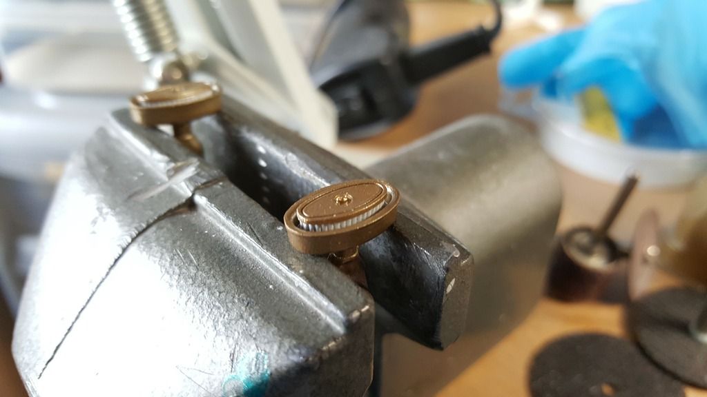

GeeBee Posted February 6, 2017 Author Posted February 6, 2017 Air Filters assembled Air Filters fitted

espo Posted February 7, 2017 Posted February 7, 2017 Outstanding detailing on this build. The dash looks special.

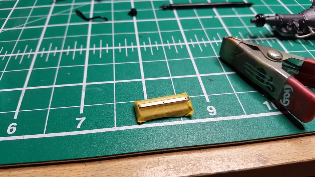

GeeBee Posted February 7, 2017 Author Posted February 7, 2017 Outstanding detailing on this build. The dash looks special. Thank you, but with a little work, it now looks a little better, chrome was done using the Molotow liquid chrome pens
