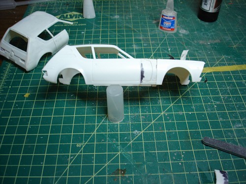

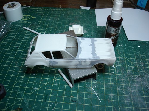

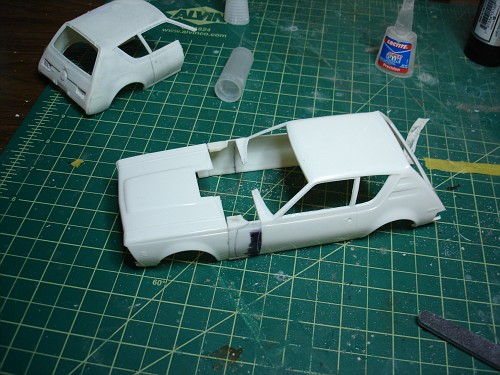

6bblbird Posted February 18, 2017 Share Posted February 18, 2017 What to do with two Gremlin bodies and a lot of putty! I added a little over a scale foot to the nose using sections from a donor body. Quote Link to comment Share on other sites More sharing options...

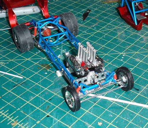

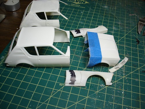

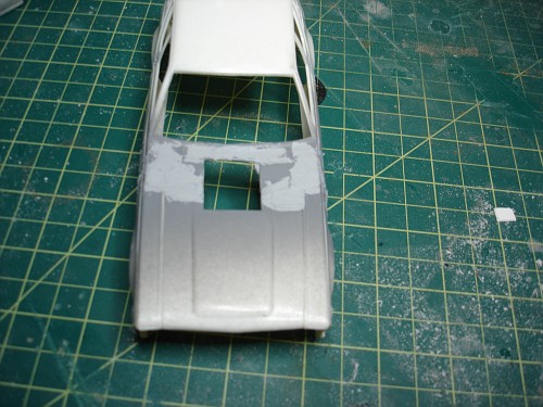

6bblbird Posted February 18, 2017 Author Share Posted February 18, 2017 Fenders were easy , this part, I don't know. Quote Link to comment Share on other sites More sharing options...

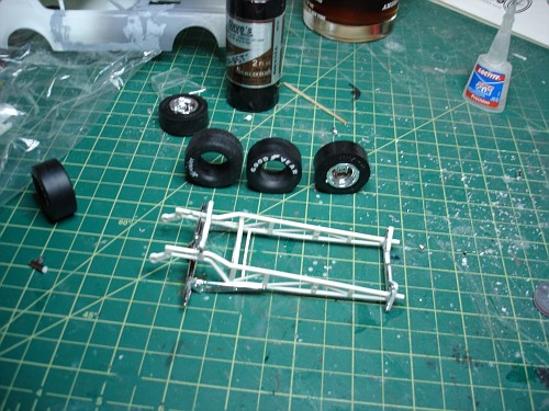

6bblbird Posted February 19, 2017 Author Share Posted February 19, 2017 Body was stretched while the Polar Lights chassis had to be shortened! Quote Link to comment Share on other sites More sharing options...

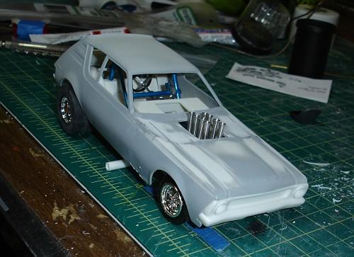

6bblbird Posted February 19, 2017 Author Share Posted February 19, 2017 Lots of "mud" ! Quote Link to comment Share on other sites More sharing options...

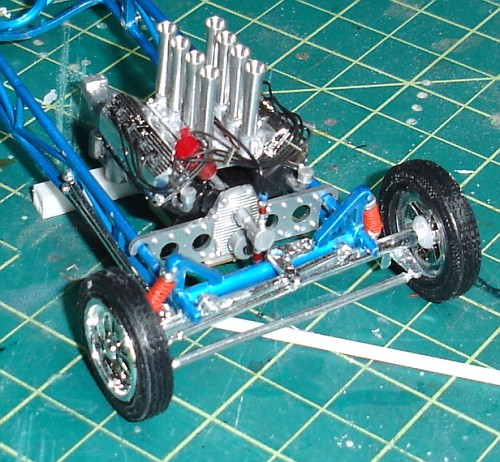

6bblbird Posted February 19, 2017 Author Share Posted February 19, 2017 (edited) It took a lot of filing and sanding but I got it to look ok to my eyes. Engine is tight in the chassis! Just for fun, I made my own coil over shocks using red wire. Edited February 19, 2017 by 6bblbird Quote Link to comment Share on other sites More sharing options...

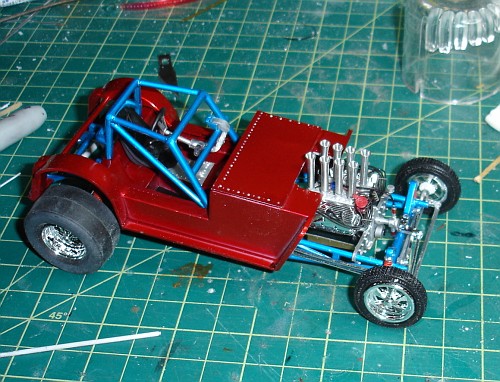

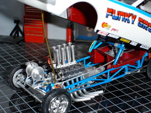

6bblbird Posted February 22, 2017 Author Share Posted February 22, 2017 Experimented with rivets. Drilled out all the rivet marks on the engine cover and pushed .035 rod through, sanded them down, and painted the engine cover gloss aluminum. Next, I painted the cover with clear red to simulated anodizing. Finally, I carefully removed the paint above the rivet heads. A lot of work! Fuel injection system was plumbed and ignition wires and boots installed. WF Quote Link to comment Share on other sites More sharing options...

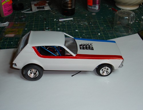

6bblbird Posted February 23, 2017 Author Share Posted February 23, 2017 Thank you all! Paint! AMCs have to be red, white, and blue, right? Quote Link to comment Share on other sites More sharing options...
Straightliner59 Posted February 23, 2017 Share Posted February 23, 2017 Of course, they do, Walt! You're ready to match race the Cox Pinto. I've always liked Gremlins. Nice build, sir! Quote Link to comment Share on other sites More sharing options...

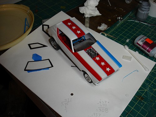

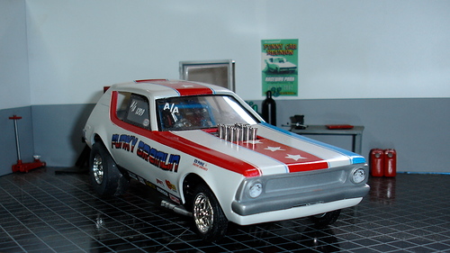

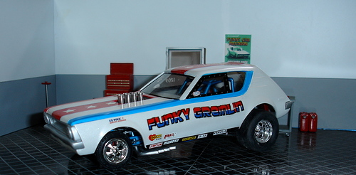

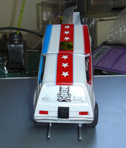

6bblbird Posted February 28, 2017 Author Share Posted February 28, 2017 (edited) Stars and stripes Edited February 28, 2017 by 6bblbird Quote Link to comment Share on other sites More sharing options...
Dragline Posted February 28, 2017 Share Posted February 28, 2017 Wowzers. The ante continues to rise. Quote Link to comment Share on other sites More sharing options...

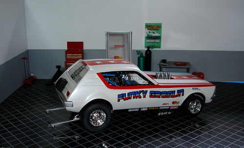

6bblbird Posted March 3, 2017 Author Share Posted March 3, 2017 I did a play on the " Funny Gremlin" name. Decals were ink jet printed. Quote Link to comment Share on other sites More sharing options...
