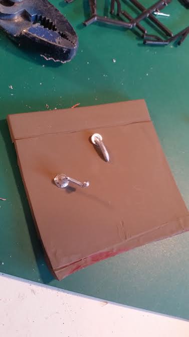

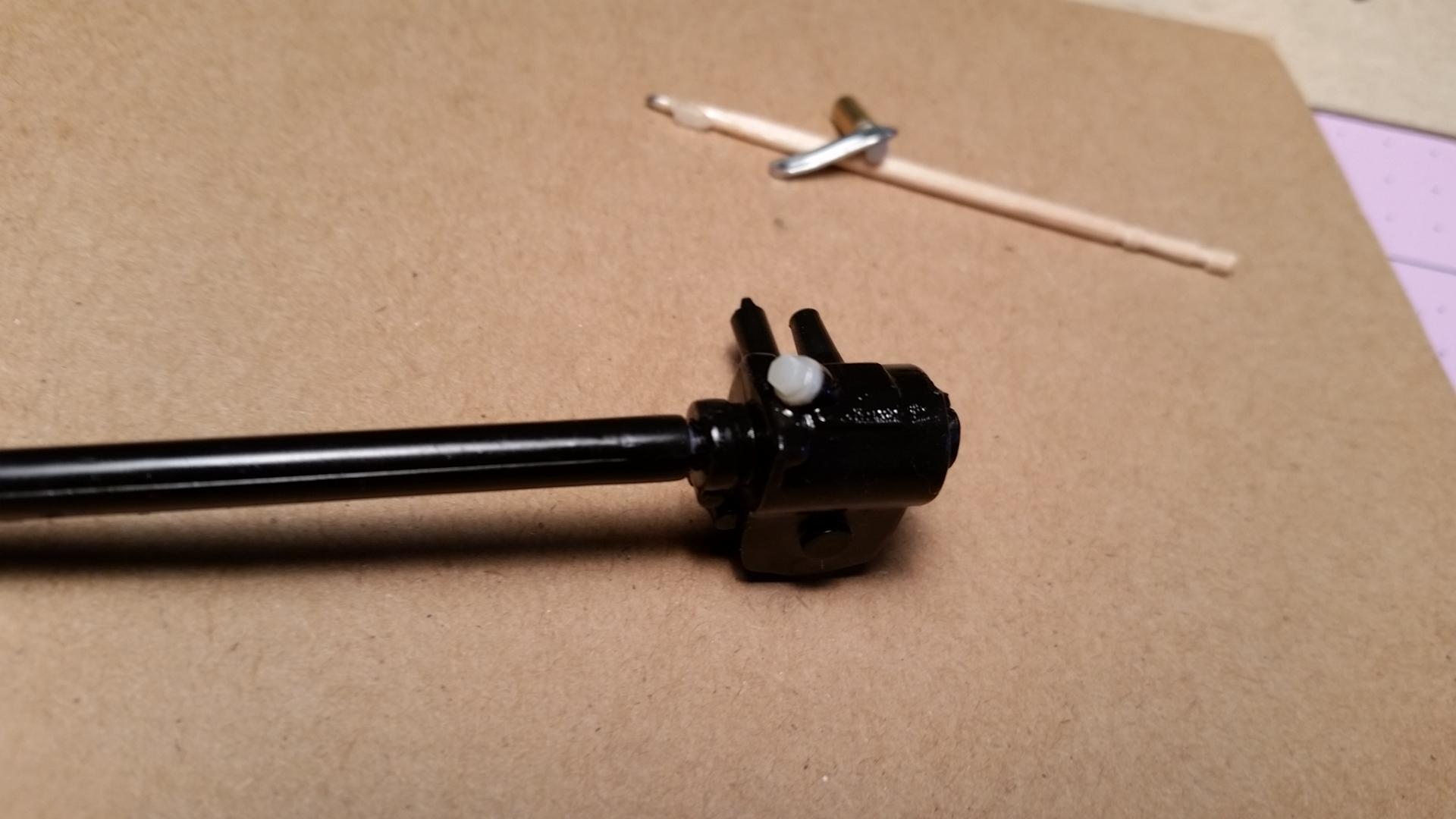

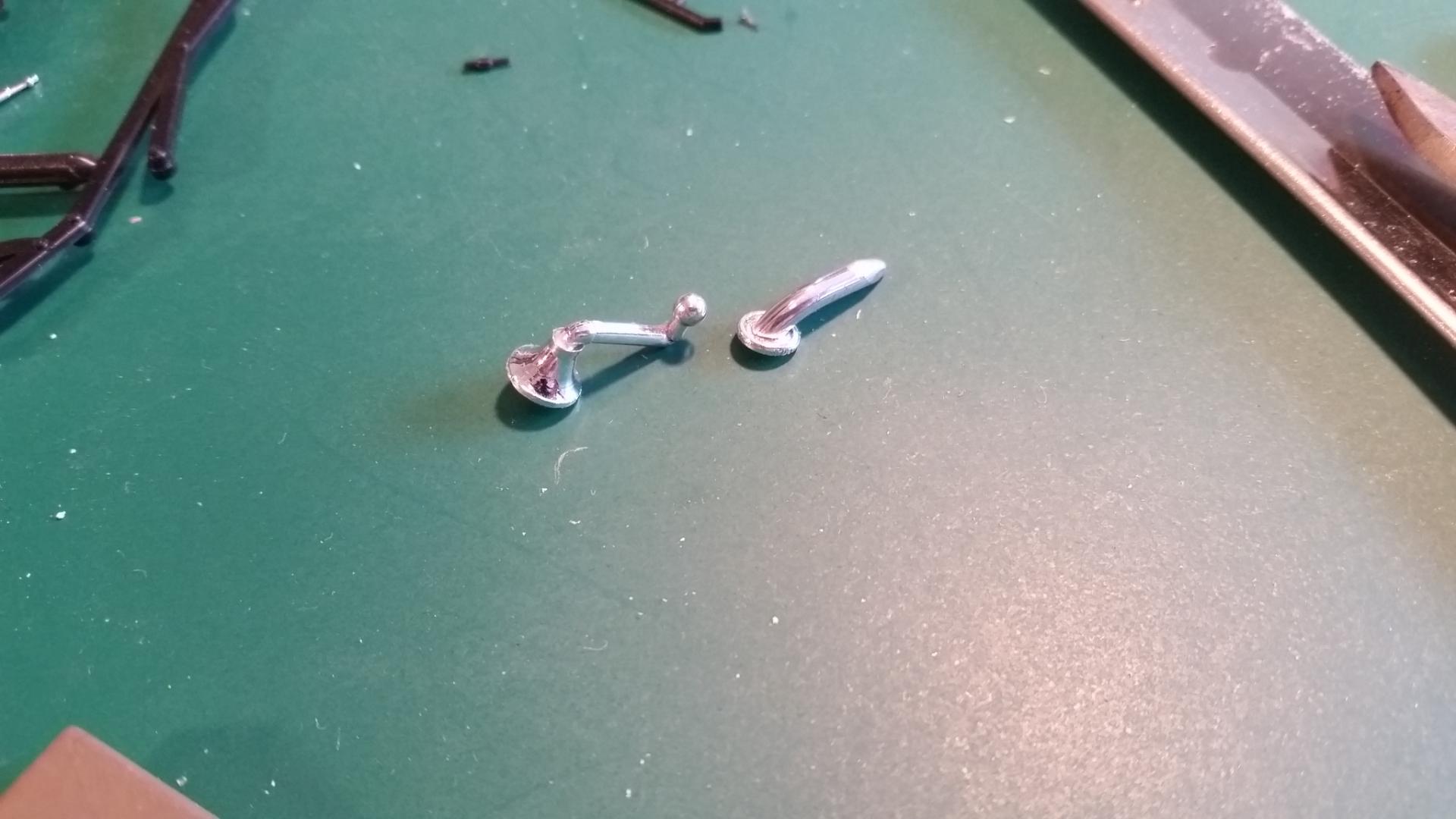

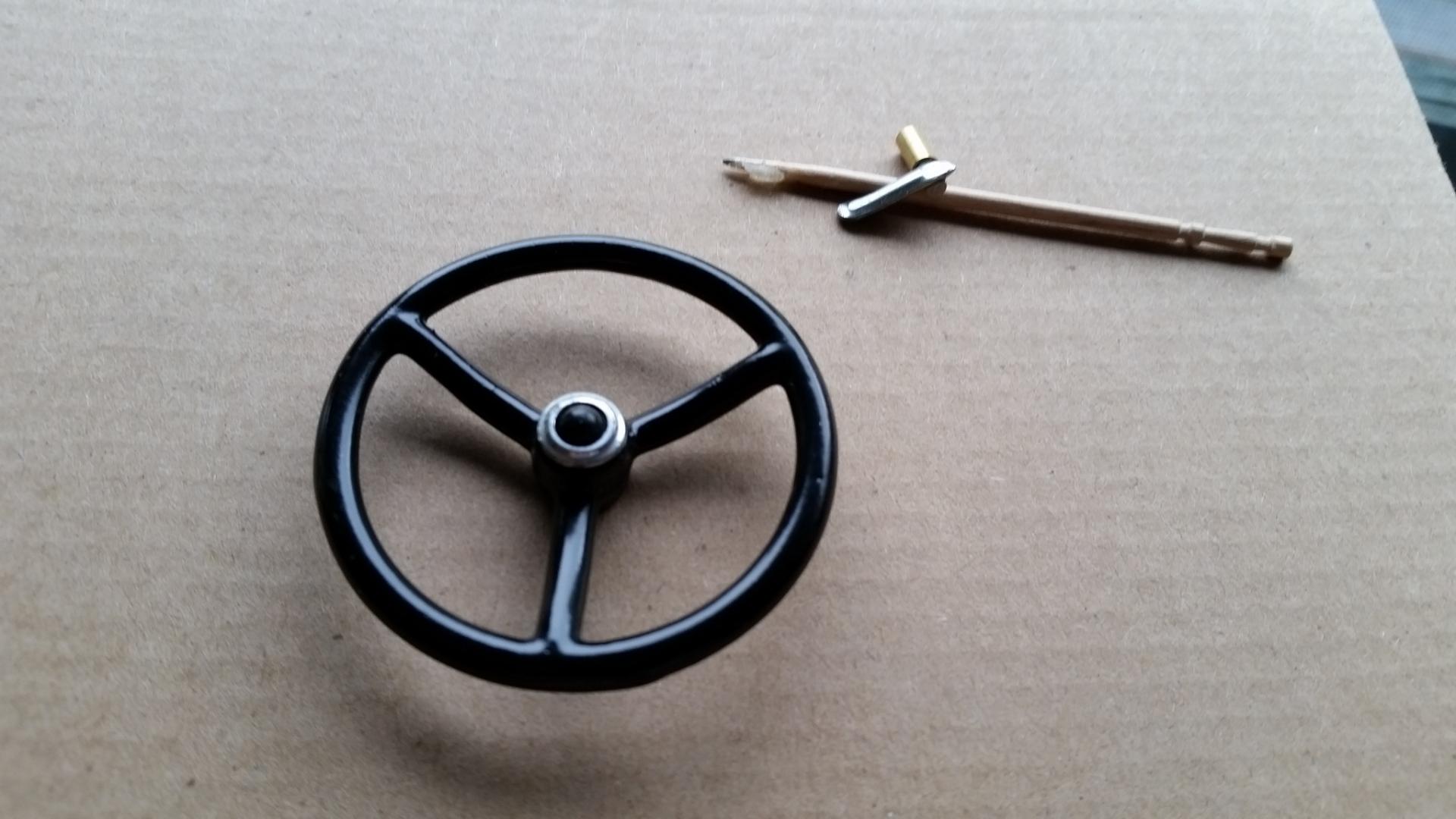

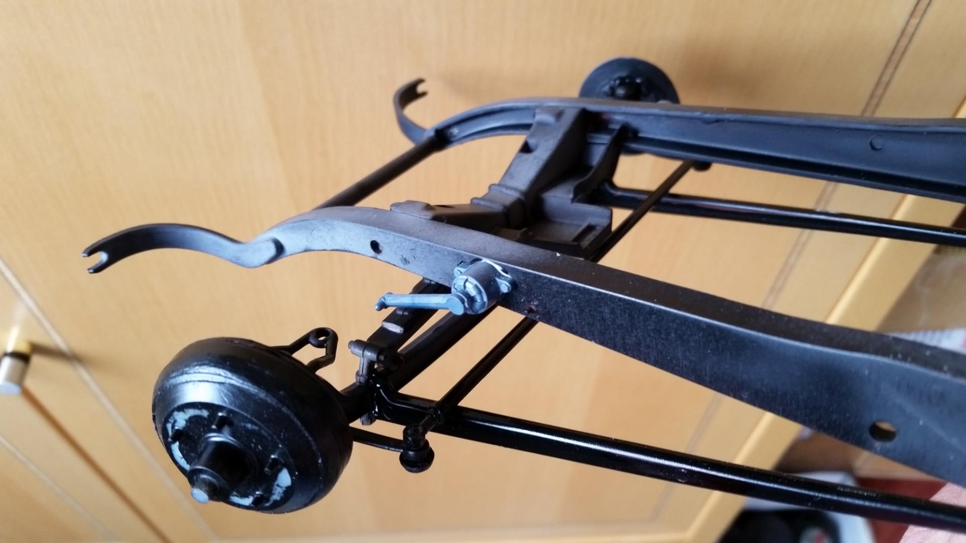

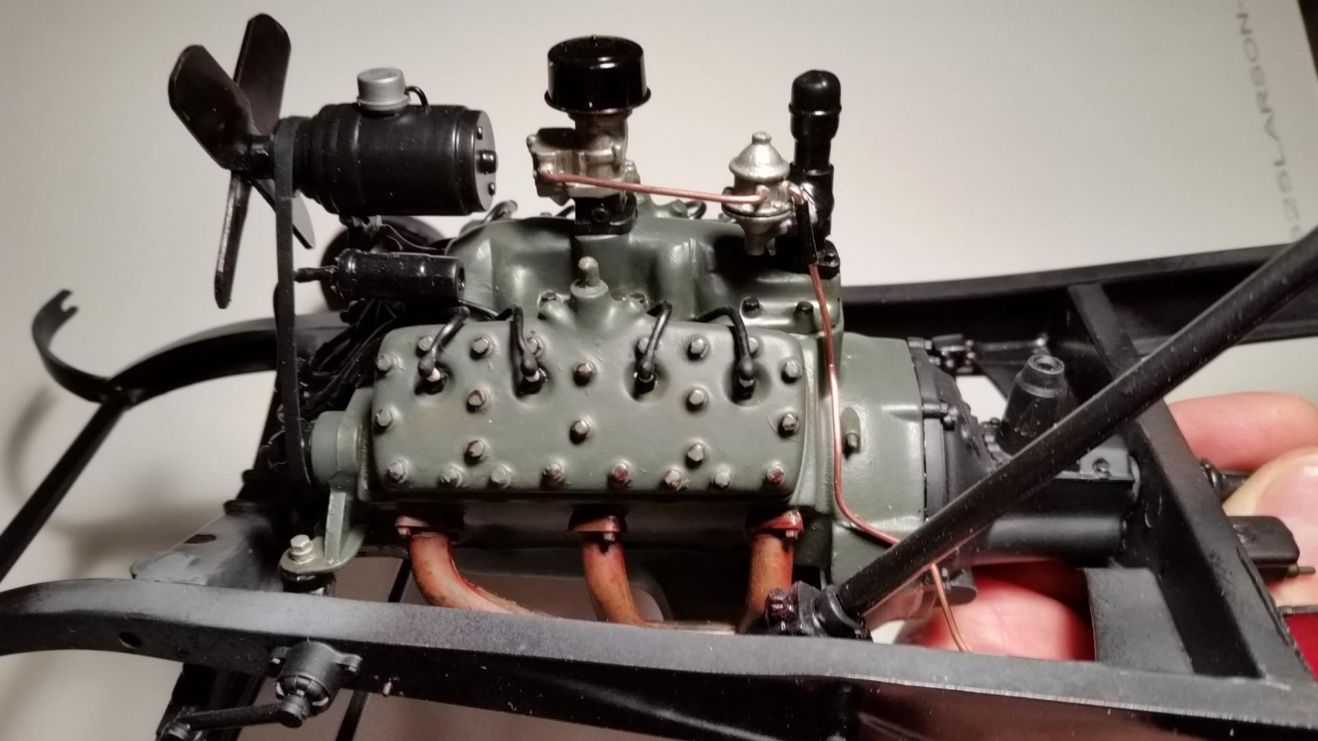

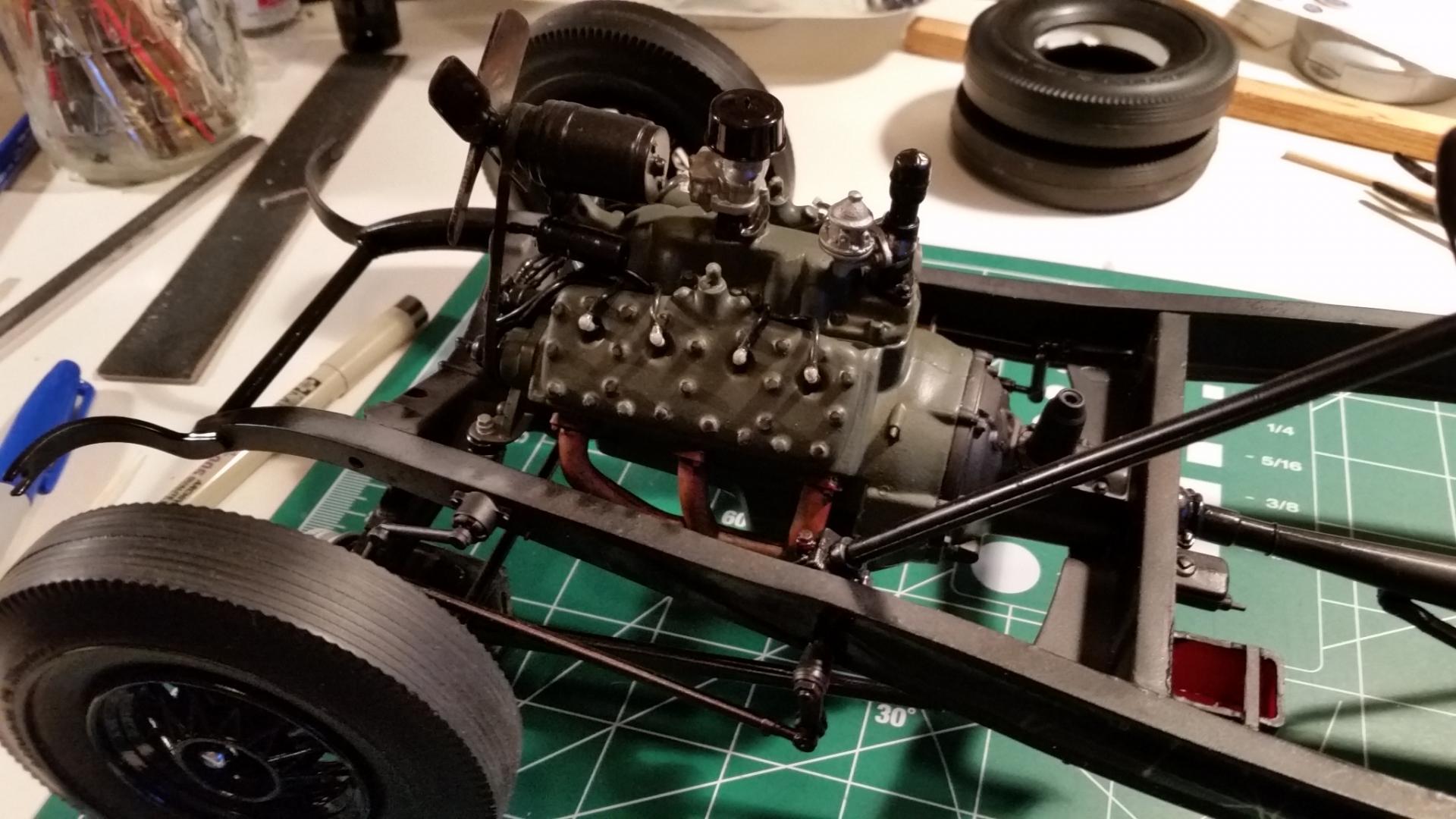

f1ford48 Posted March 5, 2017 Author Posted March 5, 2017 adding some small details today- there were no motor mount bolts- so I made those up. made a steering wheel and horn button-the ring was cut from some other chrome part and adapted.[to get the bezel detail] door handles made from metal from a toggle bolt. and a better filler plug for the steering box-also the front end coming together with stock lever action shocks....... 1

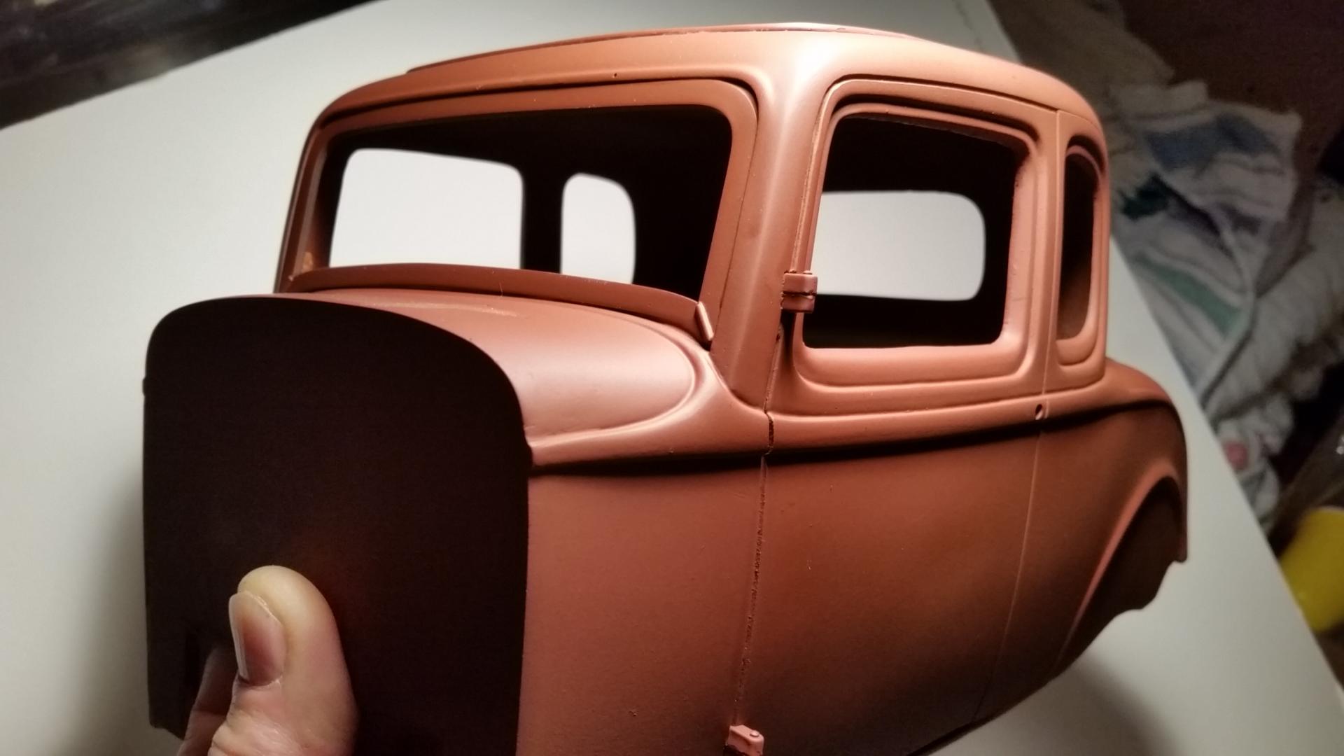

f1ford48 Posted March 23, 2017 Author Posted March 23, 2017 As they say in Spanish ''El Chassis es Completo''! starting to prep the body and after washing 2 times with detergent I still have a fish-eye problem....Nuts!!!!!

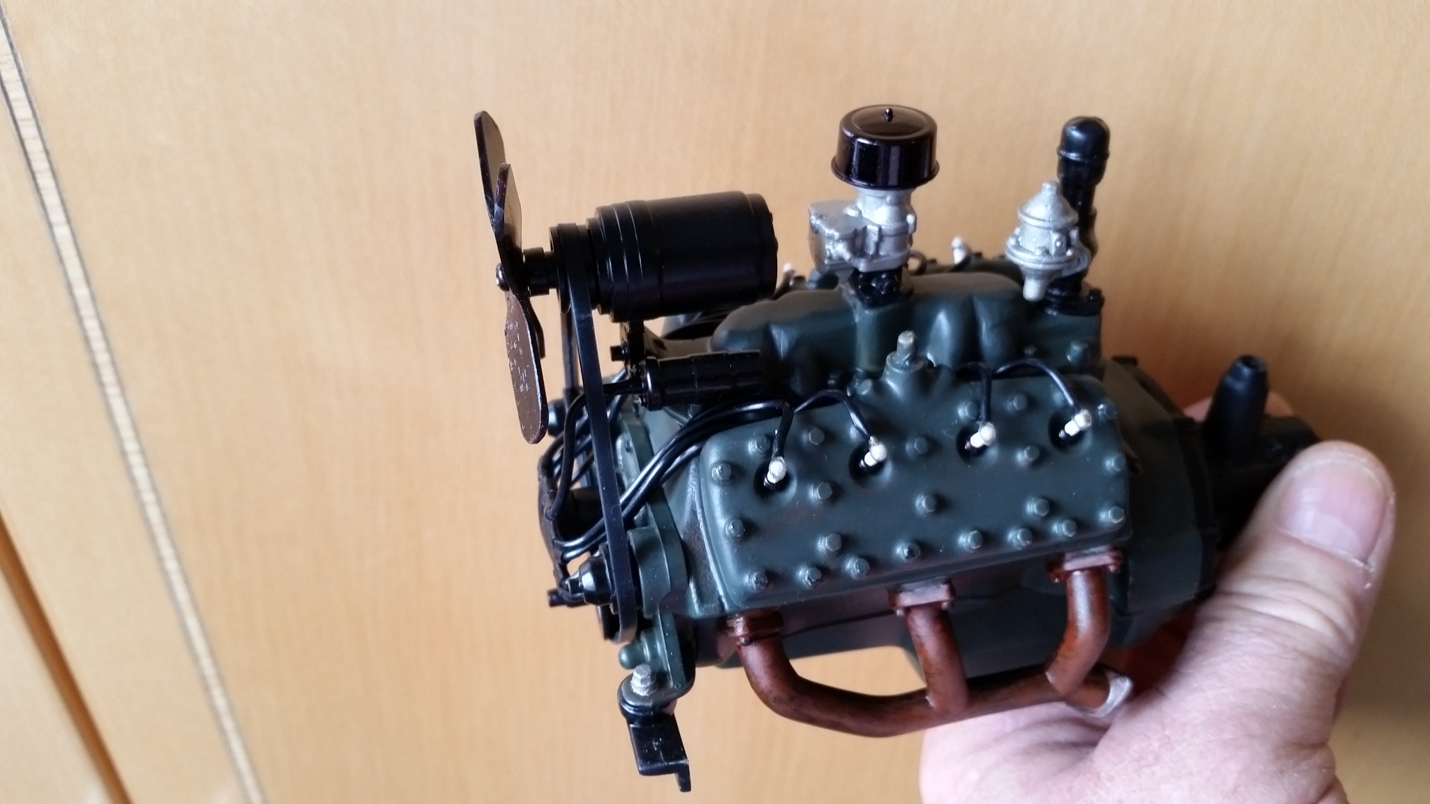

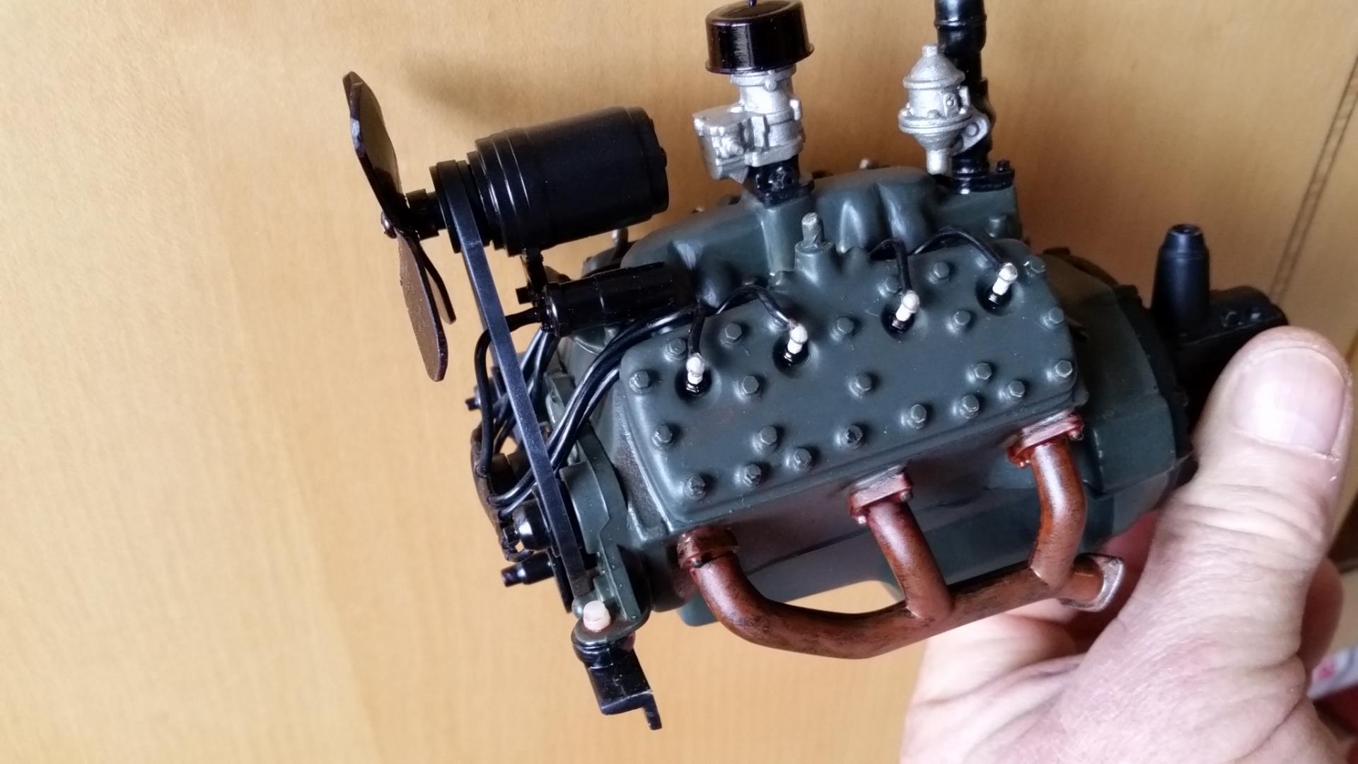

Frank Posted March 29, 2017 Posted March 29, 2017 I hate to be picky, but that is the wrong engine for a stock 32
f1ford48 Posted March 29, 2017 Author Posted March 29, 2017 I hate to be picky, but that is the wrong engine for a stock 32that is true- the correct engine has the water outlets and pumps mounted to the front of the heads.

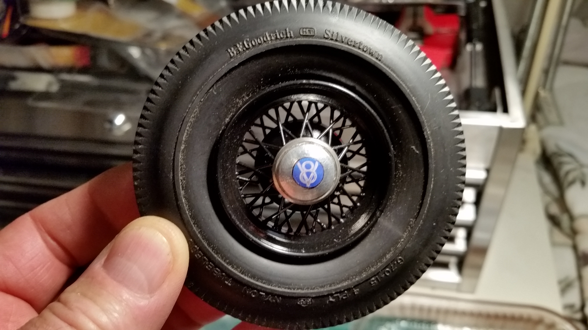

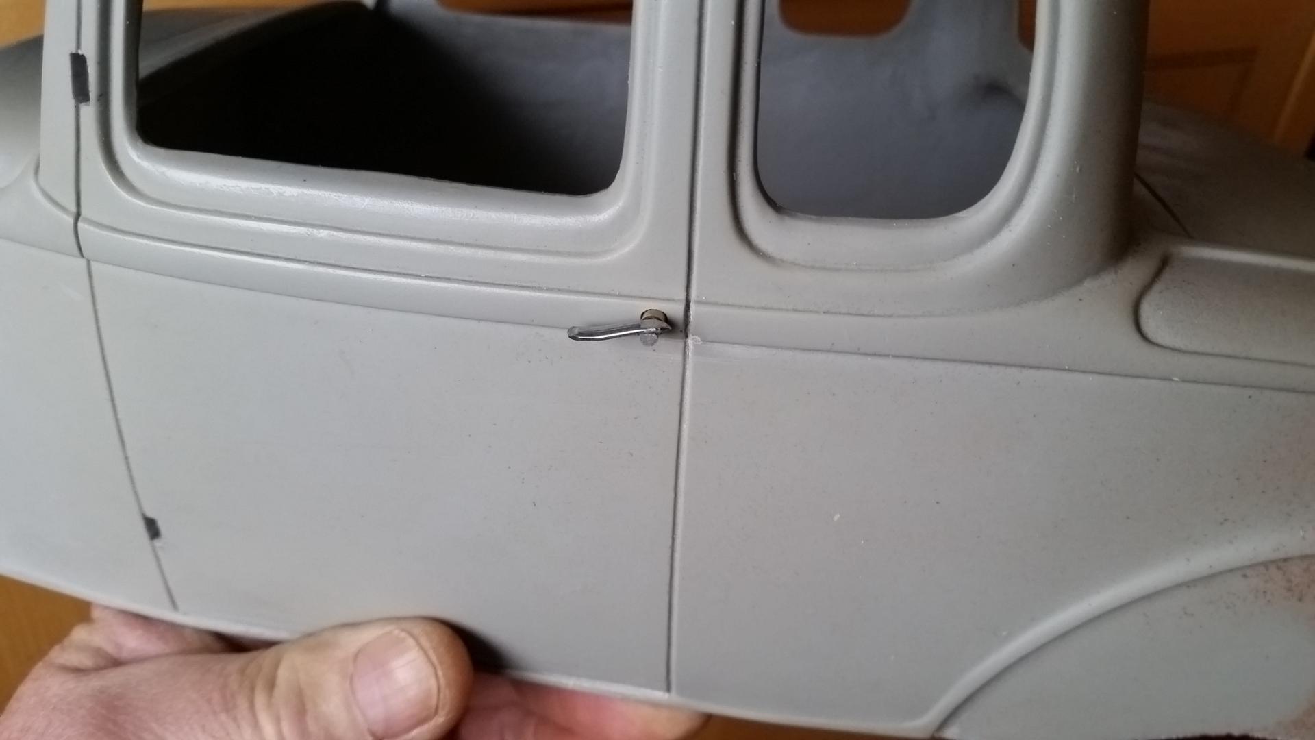

f1ford48 Posted April 8, 2017 Author Posted April 8, 2017 (edited) After hearing the sad news about Harry I decided to dedicate this build to him. I had dreamed about building this car and mentioned it to him as well- and now it is in the final stages . so this is for you Harry. the ''V8'' stamping on the hubcaps needed to be more sharp- so I had a printer do the inserts in vinyl and I like the way they turned out. they stick just fine and stretched to the convex of the cap-so that is done...... I scratch built a generator cut out for the engine and plumbed the carburetor. also made up hinges and pins on the doors- for a more authentic look. the body is now holding primer so I will work on the topcoat tomorrow-weather permitting. Edited September 7, 2017 by f1ford48 additional info. 1
f1ford48 Posted April 16, 2017 Author Posted April 16, 2017 (edited) Scratch built some interior door hardware and panels today. the doors are not going to open so the detail is good enough for a peek inside the window...... Edited April 16, 2017 by f1ford48 no text

f1ford48 Posted May 1, 2017 Author Posted May 1, 2017 thanks guys for the nice words. should have more pics up soon.... the resin body has been a major pain- first with the fish eye in the primer and now with the paint that I had to strip in parts. I just remembered its supposed to look like a car that has been on the road for 20 years so maybe i'm being too picky about the finish......

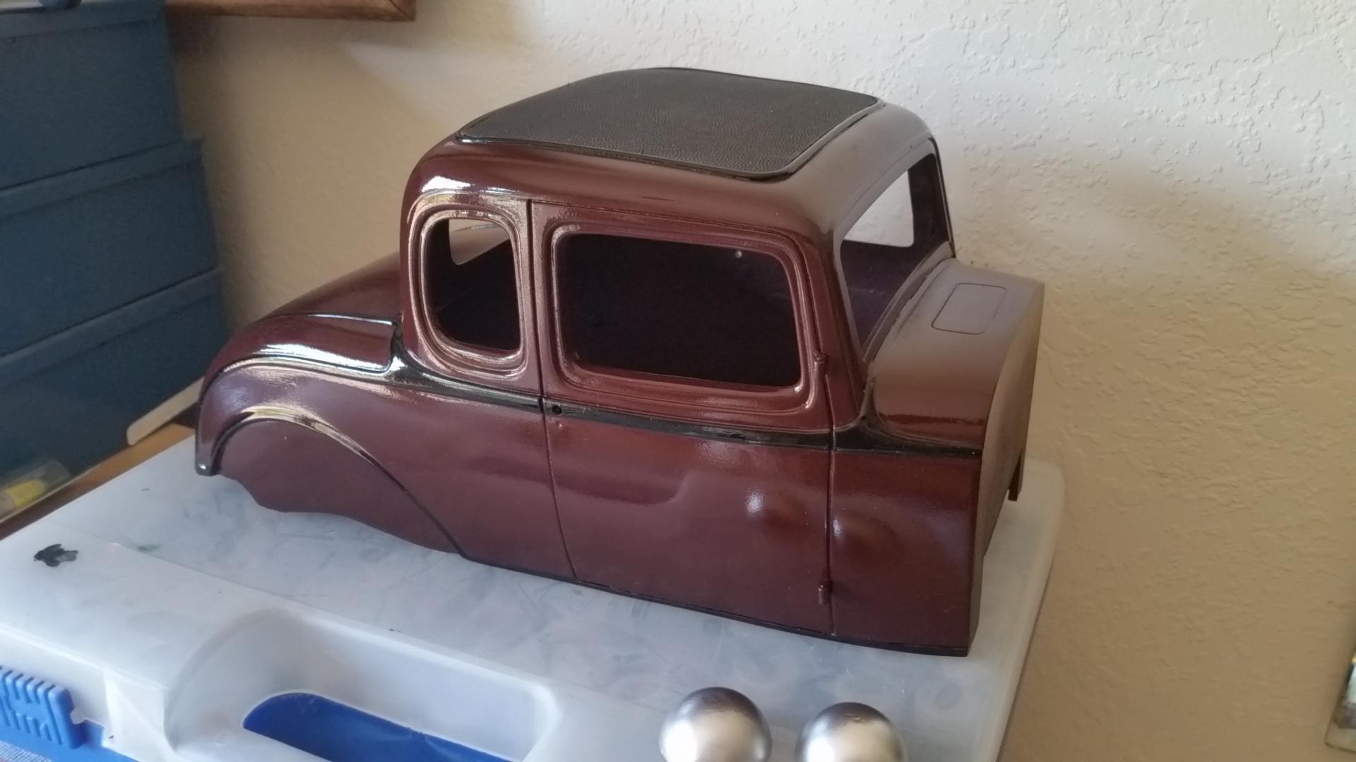

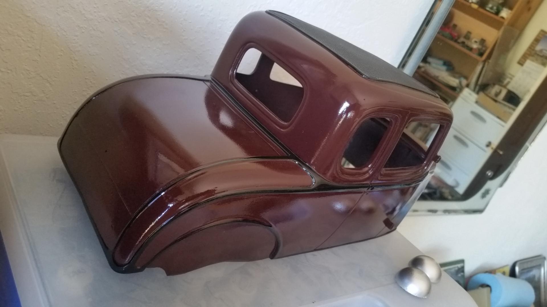

f1ford48 Posted August 26, 2017 Author Posted August 26, 2017 finally got some paint on the body. and the moldings painted too. I ended up doing the black moldings by hand as the masking tape I was using was not cooperating. I think they turned out even better with no bleeding. the top insert was cut from an old school binder that had a nice ''grain'' to it . the colors are original Ford. Thorn brown and black moldings. 1

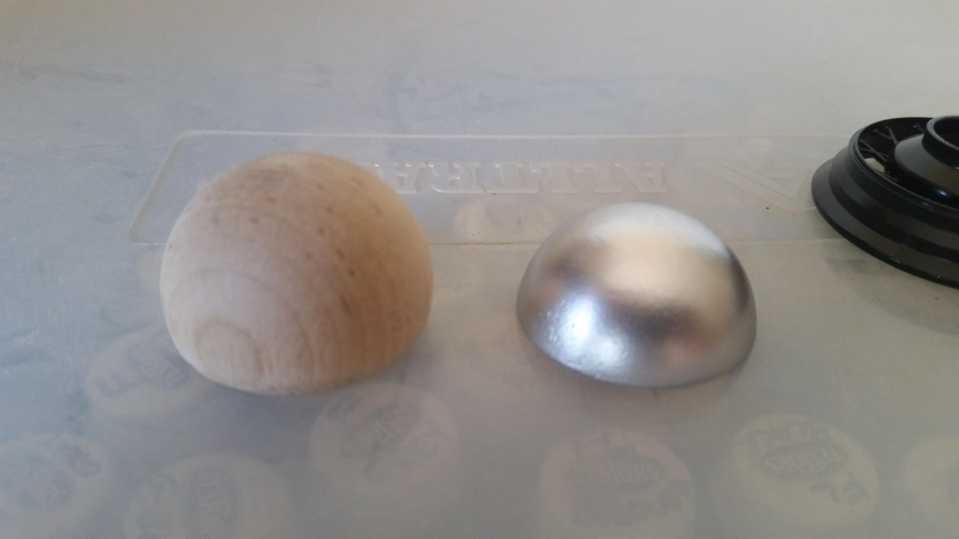

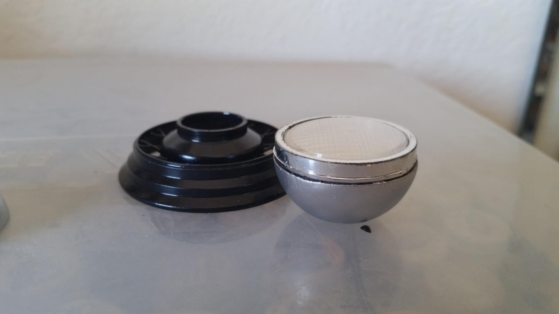

f1ford48 Posted August 27, 2017 Author Posted August 27, 2017 (edited) If you have seen a stock 32 you know how big and highly mounted the headlights are. the big deuce gives you small hot rod lights so some improvising needed to be done again here. I cut the buckets from 1.5 inch wooden balls and painted with semi gloss black paint then a special metallic -also from Rustoleum. the backs of the lenses were cut from a chrome card stock and the rims and lenses modified from a BIG motorcycle toy. the real ones are stainless so this should be convincing enough. you guys are probably laughing at the '' OLD SCHOOL '' stuff going on here- my ''hobby shop'' is the Hardware store! Edited August 27, 2017 by f1ford48 spelling
