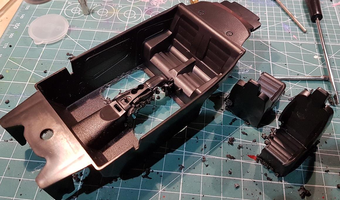

Funkychiken Posted March 14, 2017 Posted March 14, 2017 So I wanted to complete an easy kit, to start getting through the stash - which keeps growing, and gives lots of ammunition to the better half, who keeps pointing out that I "can't take them with me". I bit premature to be saying that, but I'm sure I will not get the time to run through them all... Anyway, I was not happy with the interior, and started to hack it up. Wishing I didn't now, but will try and follow through and get this completed within 3 months....
Funkychiken Posted July 2, 2023 Author Posted July 2, 2023 We are about 6 years later after starting this "3 month build", but after hacking up the interior, it stayed on the bnech getting overlooked... Only a small amount of clean up and filling required...

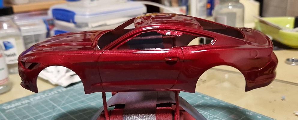

Funkychiken Posted July 2, 2023 Author Posted July 2, 2023 I've primered with Zero grey, several coats and light sanding with Tamiya 1500 then 3 coats of Zero Pagini Red then 2 coats of Zero Smoke (transparent black) then 1 mist, and 1 wet coat of Zero 2K diamond clear. It's probably my best finish yet, but far from flawless... a bit of dust & pitting on the bonnet, will need to be sanded 9
bisc63 Posted July 2, 2023 Posted July 2, 2023 Agreed on the color! Looks great on this beautiful body style. 1
beeRS Posted July 6, 2023 Posted July 6, 2023 Great paint job. Im surprised Revell never did a full detail version of this. 1
Dirkpitt289 Posted July 14, 2023 Posted July 14, 2023 Where were you going with this when you were cutting out the interior?
Funkychiken Posted July 30, 2023 Author Posted July 30, 2023 On 7/14/2023 at 3:45 AM, Dirkpitt289 said: Where were you going with this when you were cutting out the interior? Literally only cut the interior to get better front seats in. Not worth doing TBH, but the moulded in seats are tosh.

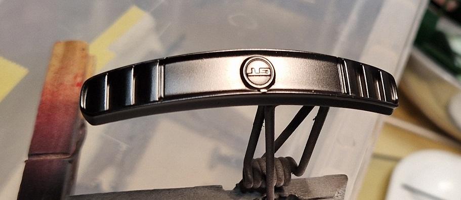

Funkychiken Posted August 29, 2023 Author Posted August 29, 2023 The dials in the dash are certainly not accurate, but they look good from a distance. Any ideas what I could do to make the screen bit look like a screen? 1
