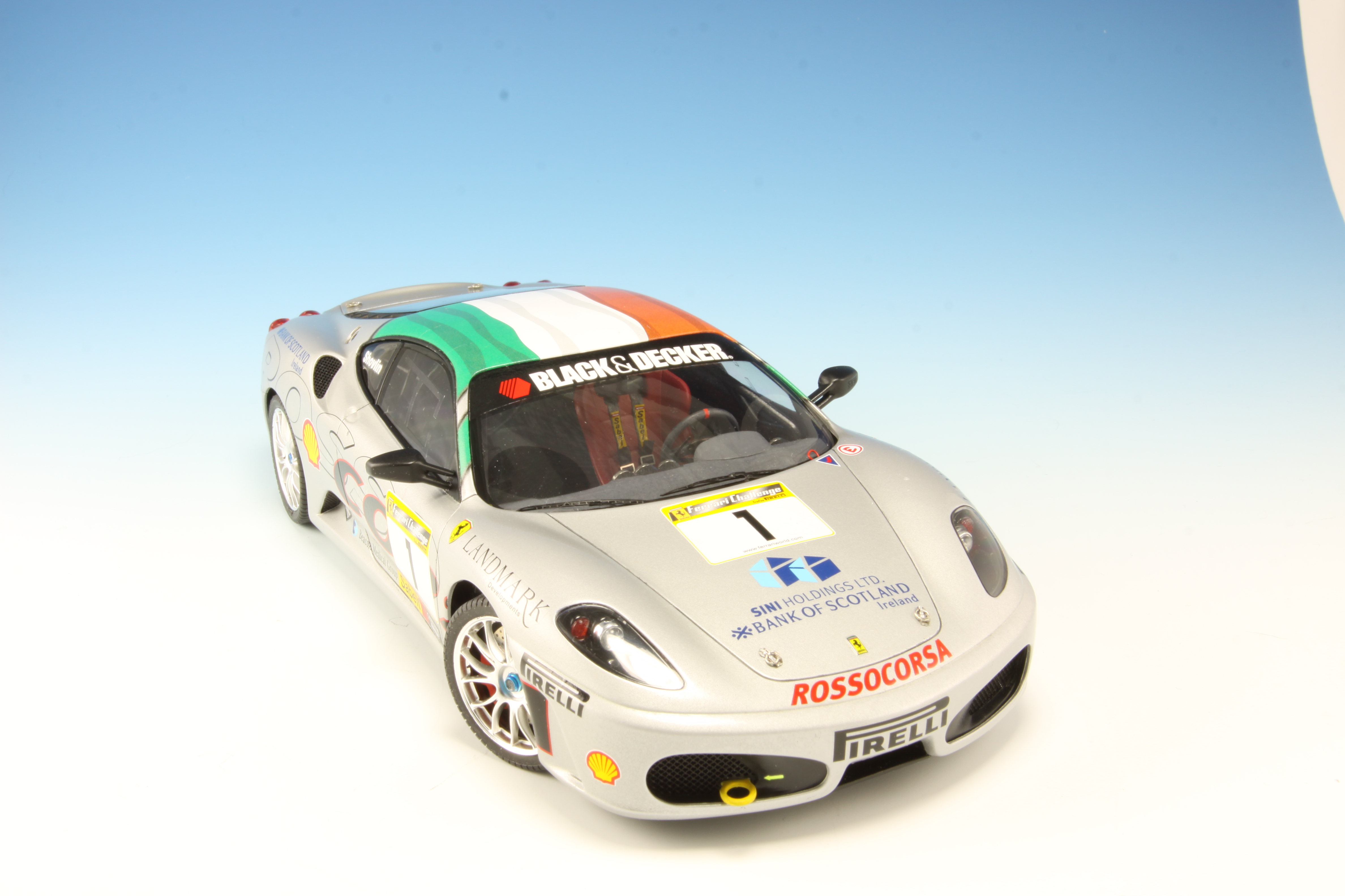

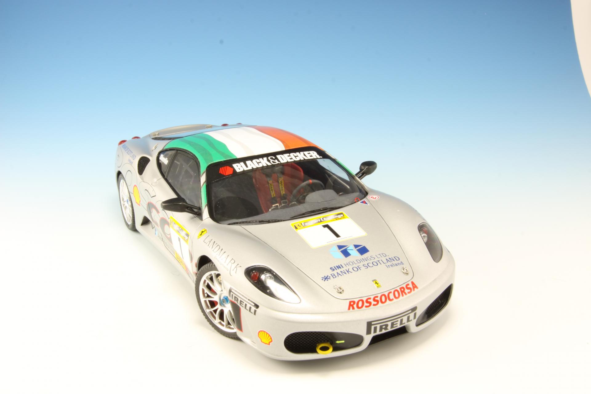

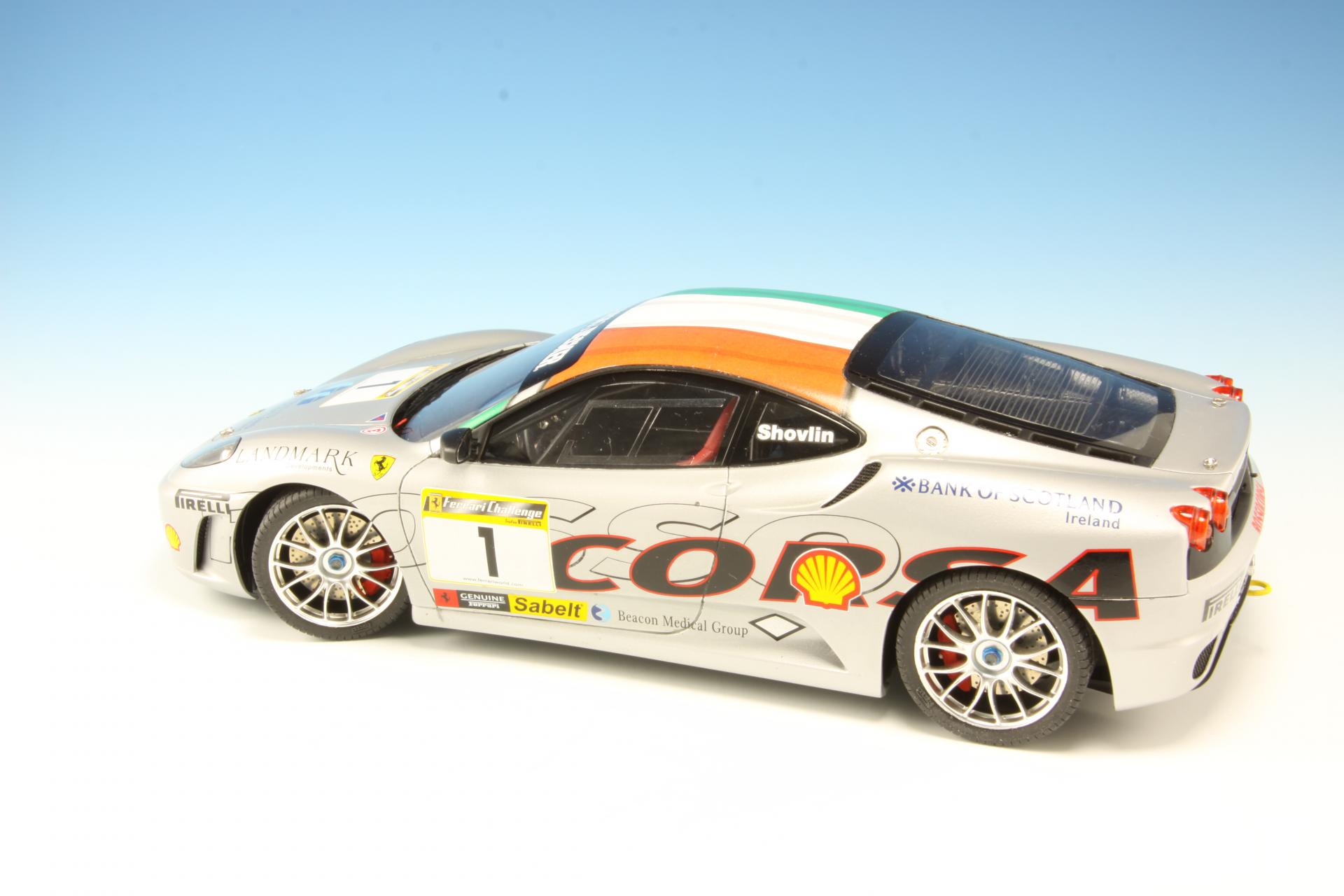

This is the hardest one to find. I have this one , but did the shark nose graphic one instead. The rear under tray is the italian flag. I'll look to see if I can find all the photos I have  on it. Great start, can't wait too see it finished

Thanks, Tim, that would be great.  I'm not finding many pictures of this car.  Mostly finding pictures of diecast cars.
