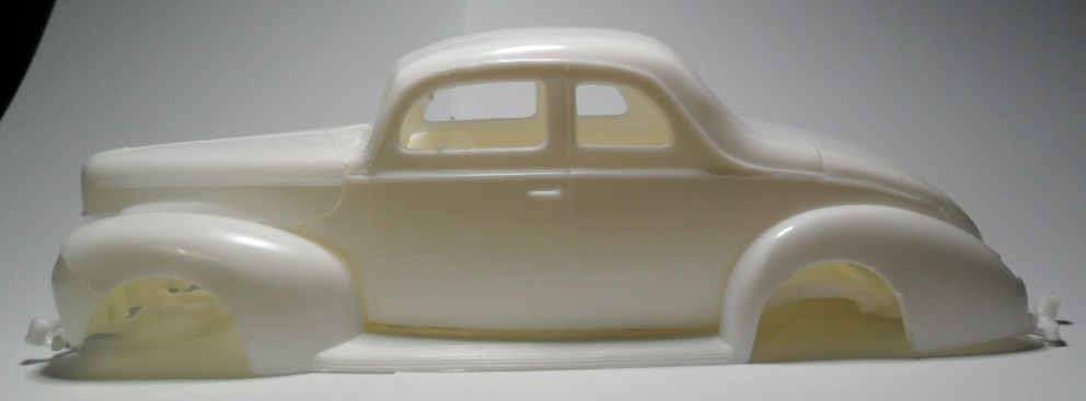

So, after the 41 Plymouth turned out so well, I thought a 40 Ford would look good sitting next to it. Grabbed one off the shelf, opened it up and found this.
SAM_0874.thumb.JPG.fcf00add40ca618e7b9ec
Heavy flash, short shot, and other issues. So while it was sitting there, on the verge of going back on the shelf, I decided that rather than ever tackle the the problems to make it look as good as the Plymouth, I'd let it tell me what it wants to be.

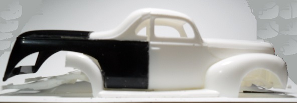

And suddenly, the back half of the body was gone! What will take its place?
SAM_0878.thumb.JPG.7ac1ffda1172ec923514d

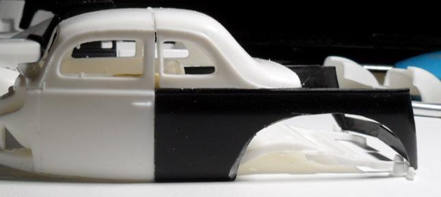

Ah, the back half of a Gravedigger body presented itself. But not all of it.
SAM_0894.thumb.JPG.2efcea199a85581cf64cf

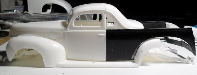

The rear quarters join the front of the body.
SAM_0897.thumb.JPG.f54b1dd51e651d39a59c9
Then the back of the roof comes back, but that isn't right.
SAM_0900.thumb.JPG.a72138874f394178e43bb

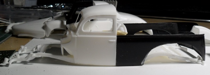

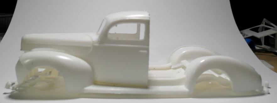

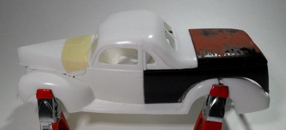

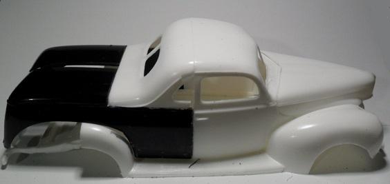

So another cut is made.  Looks like it might be getting closer to becoming something. The back half of the rear fenders have come off, since the cutouts on the quarters are somewhat larger than the original body. No worries, by extending the fenders, I can get some bigger tires back there.
SAM_0889.thumb.JPG.ace27cd405043aae721b3SAM_0892.thumb.JPG.ee399ea1125ae014e1fd9

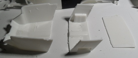

A quick sectioning of the interior bucket will provide a guide for the final cuts to the top of the body.
And so the first cuts are made. I have no idea where this is going, but I see a few more cuts, a lot of modification, and scratch building some custom parts.
First profile mock-up
SAM_0904.thumb.JPG.41f2f3523346a59b2fc74

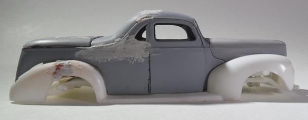

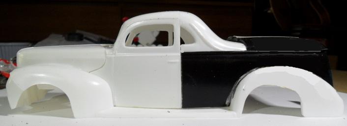

Coachwork is starting to come together. Still need to make the tailgate and a center strip for the tonneau, pillars for the cut down sidelights, and tidy up the back valance. Once the front fenders are opened up a little, and the rear fenders are finished, it will be time to start the process of filling and sanding to get that first coat of primer on.
SAM_0908.thumb.JPG.35c4f739f9bcd251c56f4SAM_0909.thumb.JPG.2d6df5b5d168335122f26
Back to the bench for me, and thanks for having a look, leaving comments, critiques, or suggestions. Happy Building!

Minor update. Tonneau fabrication under way. Rear fender spacing and rear quarter tweaking under way. Tailgate under construction. Package deck created for the interior.
SAM_0910.thumb.JPG.9887af197e8e8bc314d50SAM_0911.thumb.JPG.701bcf12b5a2f737d7044
Still need to do some judicious filing to bring the tonneau down about 1/32" to meet up with the body. Once that's good, will get the final placement of the rear fenders and the gaps filled in, and the wheel wells reshaped. Then any other filler work before the first primer coat.

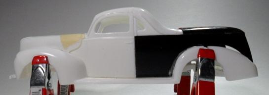

Thanks, Dave. Body work is progressing slowly, but it is progressing. Profile is shaping up.SAM_0915.thumb.JPG.771faf4849d31daaf1d68
SAM_0913.thumb.JPG.21bd0177f02e3c4bca536
The more I look at the profile, the more I feel like it wants to sit really low in the rear, and get full skirts. Tonneau still needs a slight shave to bring it down flush with the body. Don't need to to do much else to the rear wells, the slight lengthening gave it the space needed. Front wells still needs a reshaping.

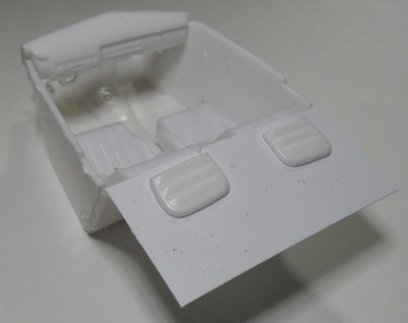

Work has also begun on the restyling of the interior. Using the tub and dash, but everything else is coming from the parts stash.
Guess I need to start giving thought to the color going on this one as well.
Thanks for following along, and for the comments, critiques, and suggestions. Happy Building!

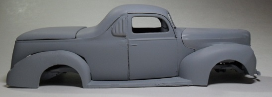

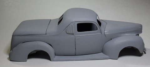

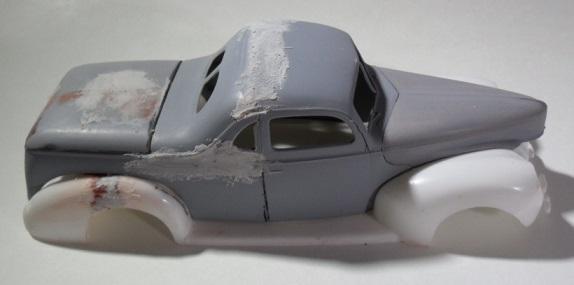

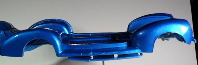

Most of the major body issue addressed now. Added louvers to the side lights. Finally got everything under a primer, some minor tweaking and sanding. Small spot on the rear fender needs a skim and sand, then hope to get a silver base coat on her as decide the final body color. Yellow? Red? Purple?
SAM_0916.thumb.JPG.c3539a23d07888ffd10a7SAM_0917.thumb.JPG.a595356700d3a8b3db7ac

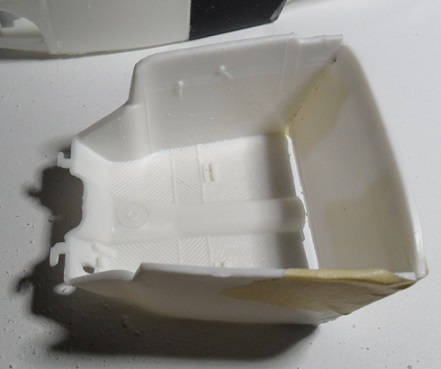

Started the mock-up of the tub.removed a wedge from the bucket, 1" at the floor pan, .75" at the top, and reattached the back panel. Then created a package deck from a piece of sheet styrene. Seats are from the Dan Fink Speedwagon. The bits on the package deck are the pieces left over from trimming down the window louvers for the sidelights. Interior will likely be white, with some details picked out in the body color to tie it together. Not going crazy on the interior detailing since it will be mostly hidden by the coachwork.
SAM_0918.thumb.JPG.7cae792477241e7bdf78dSAM_0919.thumb.JPG.c32523134323fe5da4579
Got the panels re-scribed on the body, and still need to replace some side trim and minor tweaks to the drip rail. Pretty happy that the seam in the roof cut is approaching invisible now.  Tailgate fabrication is under way, and have started bringing together the parts for suspension and drive train. Totally building this one backwards from my normal process, since I usually start with the engine and motor on through through the build like I'm following kit instructions. :)  This time, started with the body and working my way in.

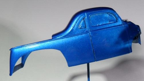

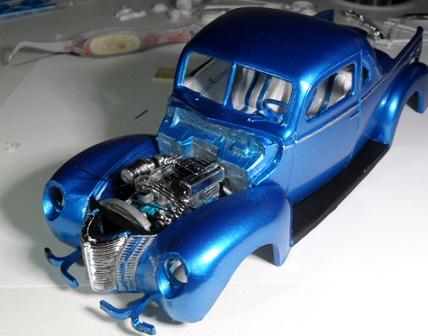

Finally, some color!  Duplicolor automotive Bahama Blue Metallic over a base of Testors Silver spray. Hopefully the next set of shots will look better than these.
SAM_0924.thumb.JPG.d4a46ff1fb4fdc306369a
Got those side windows opened back up. new styrene was added on the rear quarters for the chrome trim.
SAM_0922.thumb.JPG.40dcbe32d9cbd42dd4a64

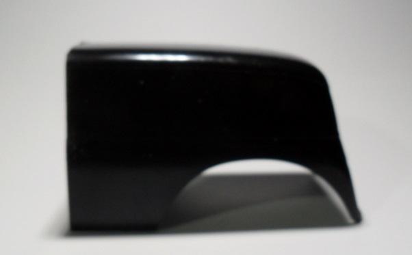

Those rear fenders came out better than the photo shows. Actually, they came out better then I expected, considering this may be first time I've ever attempted a fender stretch.
SAM_0926.thumb.JPG.0abaa619c05801fba3418

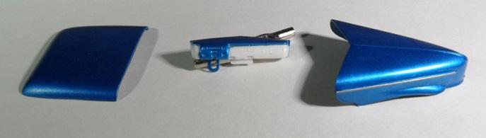

Tonneau, dash and bonnet. I ended up adding styrene for the hood chrome down the sides, the casting on the kit was so light it only really provided nice guidelines for placement.
SAM_0927.thumb.JPG.db2fd4717223aa781bbd1SAM_0928.thumb.JPG.c9c47ba10a0b5de1f75ff

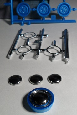

Not married to the wheels. May end up with stock dog diishes instead of what is pictured. May just lose the chrome ring.  May end up with 5 spokes. As I get the chassis in order I'll see what works better.
So, while the color is curing so I can get to the clear coat, off to finish up the interior, and get the mechanicals going.

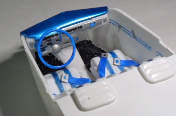

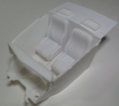

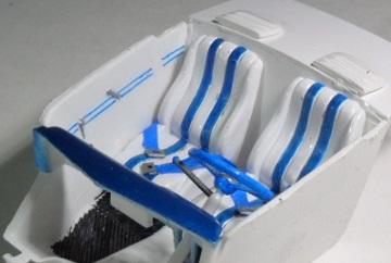

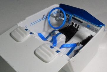

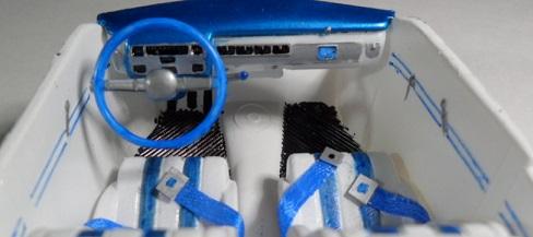

Interior shot with white, accented with body color and Blue Sharpie over Silver Sharpie.
SAM_0930.thumb.JPG.d34950b1c33dd09c05d27SAM_0934.thumb.JPG.948a4b81e6a1684d2b40fSAM_0931.thumb.JPG.12e8a33938b9af8035696SAM_0932.thumb.JPG.561bbb23480a2a67b9f3a
Seat belts are 1/8" white ribbon, colored with the Blue Sharpie, and bits of sheet styrene for the buckles. Off to work on the inside of the cab, give it a shot of white and get the acetate windows cut and installed so the interior bucket can be installed.

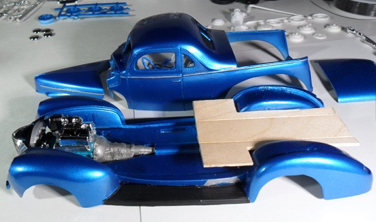

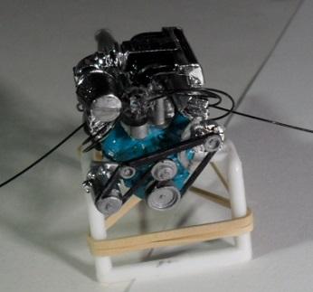

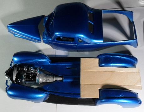

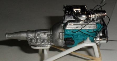

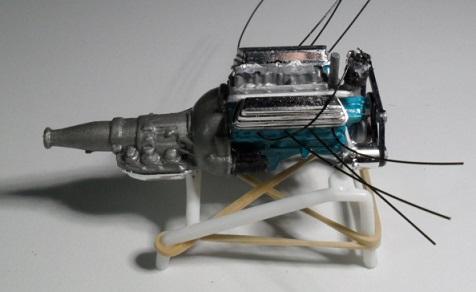

small update. Engine is coming together, donor from the speedwagon that gave up the seats. Ready for wiring and plumbing and fixing the floating components. Radiator and electric fan are also the speedwagon kit.  Will need to work out the exhaust system under the car as I setup the suspension.
SAM_0935.thumb.JPG.cac32b7217f0ec6905330SAM_0936.thumb.JPG.40817a72c6e997bbf4f01

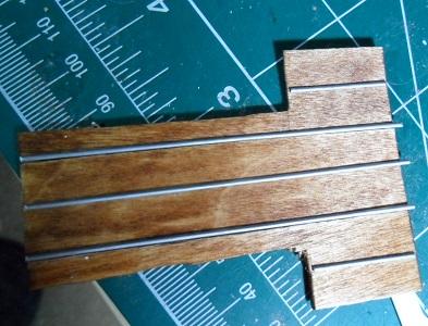

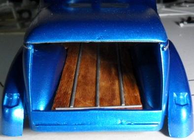

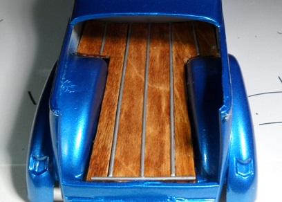

First cuts for the wood bed are going in. Will create the individual boards from the three pieces pictured, stained with furniture markers and clear-coated, then lay down some chrome strips made from styrene. Going to try and hide the tailgate hinge under the rear of the bed deck. then I can get the suspension under it and tie in a driveshaft.
Still need to get the acetate cut for the glass, finalize the suspension. Hope to have it up on its feet within the next few days.

SAM_0944.thumb.JPG.d5aac439fff2e7a291902SAM_0945.thumb.JPG.ef4ecb851a178bb7ce705SAM_0939.thumb.JPG.ad722435efff75b3c3ab8SAM_0947.thumb.JPG.c472ea968f02c07a6cecf
Engine nearly ready for mounting. Last shot is a dry fit, making sure the bonnet clearance is good, and it fits!

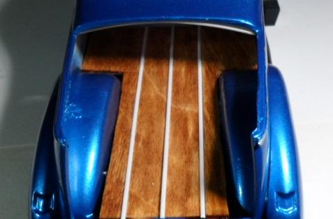

Bed construction also continues...First shot is the stained and cleared wood, with the trim pieces unfinished, followed by the finished pieces being attached to the deck.
SAM_0937.thumb.JPG.378207964ba15468155d7SAM_0941.thumb.JPG.d09874d0801897a7d1091
And a couple of shots of it dry fit into the body. Need to create a small bit of framework forward of the wheel wells so the deck sits level.
SAM_0942.thumb.JPG.552f9ab5c106bc5e948eeSAM_0943.thumb.JPG.c2747f9d09e24f714a7db
