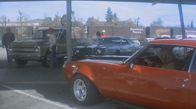

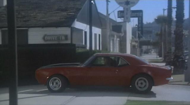

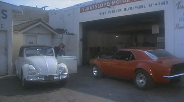

Blackkat13 Posted May 2, 2017 Posted May 2, 2017 (edited) I was thinking after I built my Graffiti cars about Aloha, Bobby and Rose Camaro. I know the car was a 1967 Camaro. I think they had a few 68 pieces added to the front end put on it. I'm trying to find a kit that is pretty similar to this car. I'm finding 1968 kits by AMT, but don't know which one to go with. Plus I know if I can pull this off I still have to fabricate the hood, and the flares above the wheels. So far haven't found to what degree fender flares are sticking out. Same with what kind of motor this car is running in the movie. I know from watching the movie the interior is going to be black, and have a roll cage in it. There's switches on the dash near the shifter. The dash itself looks pretty much stock. The rims might be stock, but not certain. The back tires are going to be wider than the front. Needing advice on this one everything from Colors, Motor, etc. Has anyone ever attempted this build? Edited October 26, 2017 by Blackkat13
espo Posted May 2, 2017 Posted May 2, 2017 I would suggest starting with the Revell '67 Camaro instead of any of the AMT kits. The reason being the AMT kits had body proportion issues. Since you're going to be doing body modifications anyway the '68 grill shouldn't be a problem, and the rear spoiler and rear valance area are all going to be fabricated also. The pictures you have should be a perfect guide for the rear. In a resent build on the forum the builder used pieces cut from a plastic spoon to create the fender flares and they looked perfect. I'll enjoy watching this build. I have owned several Camaros in the past including a '69 that I had for a total of 18 years, I was the second and forth owner.

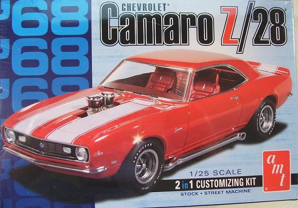

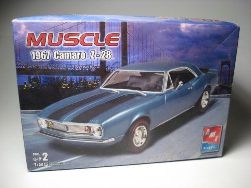

Snake45 Posted May 3, 2017 Posted May 3, 2017 I seen on Ebay a Amt 68 z28 2 in one kit. I watched a review/unboxing on youtube. I like how they give you more rims, hoods, and tires. I'm trying to find pictures of 67 Amt Z28 to see how the rear looks on the car. Mainly to see if they have the sunk in tail lights> I would be nice if the 2 in 2 kit has all these little goodies. Something tells me this is going to be a challenge kit. Plus I'm hoping the kits have a good 302 motor. Don't worry before I buy any kits Amt, Mpc, or Revell, I look into the good and the bad on each one. These were the ones I was thinking about. The AMT '67 does not have the sunk-in taillights. No kit does. That's a completely custom thing on that car. I can't quite tell if they extended the rear panel or just sank those taillights in about 6", but either way, you'll have to do all that yourself. And some plain red plastic will do for the taillights for this application so don't worry about getting '67 taillights. That rear spoiler is a nonstandard, completely custom item too. You'll have a lot of work to do on the rear end of this model. The AMT '68 has a decent '68 302, but it's pretty plain, as they were that year. It could pass for a common 283 or 327. Dunno what the actual engine in your subject car looks like, but I'm guessing if you want to match it, you'll have to do some parts-swapping/kitbashing. Post pics and I'm sure we can help. See if you can find my tutorial on improving/blueprinting the AMT '68 Camaro body. Those tricks, which are easy to do, greatly improve the looks of that body.
Blackkat13 Posted May 4, 2017 Author Posted May 4, 2017 The AMT '68 has a decent '68 302, but it's pretty plain, as they were that year. It could pass for a common 283 or 327. Dunno what the actual engine in your subject car looks like, but I'm guessing if you want to match it, you'll have to do some parts-swapping/kitbashing. Post pics and I'm sure we can help. See if you can find my tutorial on improving/blueprinting the AMT '68 Camaro body. Those tricks, which are easy to do, greatly improve the looks of that body. This one Snake? http://www.modelcarsmag.com/forums/topic/98126-amt-67-68-camaro-review-improvements/

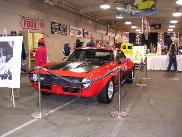

Blackkat13 Posted August 10, 2017 Author Posted August 10, 2017 (edited) Update on this project I have the 68 Camaro model, rims, tires, hood, 67 dash decals. I have been putting this on the back burner since I lost my grandpa last month. Dealing with a lot of family drama with estate of my grandpa, and a feud between my dad and aunt. I need to get back into building and away from the stress. How do I create the fenders on this kit? The real car flares come out a inches. If I heat the kit, I don't think that will give me the length I need. If I use the spoon trick What kind of glue do you use? What do you use as a filler on the spoon/car seam? What color red is this car? I can reference the photos from the movie, and hot rods dvd, but don't know the color. Has any seen this car in real life? Can anyone vouch on the red color? I heard it is Chevy Red, but not certain. What color red spray paint would come to this? Car in movie Car at a show Edited October 1, 2017 by Blackkat13
astroracer Posted August 10, 2017 Posted August 10, 2017 Update on this project I have the 68 Camaro model, rims, tires, hood, 67 dash decals. I have been putting this on the back burner since I lost my grandpa last month. Dealing with a lot of family drama with estate of my grandpa, and a feud between my dad and aunt. I need to get back into building and away from the stress. How do I create the fenders on this kit? The real car flares come out a inches. If I heat the kit, I don't think that will give me the length I need. If I use the spoon trick What kind of glue do you use? What do you use as a filler on the spoon/car seam? What color red is this car? I can reference the photos from the movie, and hot rods dvd, but don't know the color. Has any seen this car in real life? Can anyone vouch on the red color? I heard it is Chevy Red, but not certain. What color red spray paint would come to this? You are making this way to difficult. If there is no documentation to verify a detail, I.E., the engine, roll cage, rear end, etc. Simply use your best guess. If you can't see it in a photo no one can tell you it's wrong. If you make it look like it belongs then you will be good. For your body filler use a 2 part polyester filler. They do not shrink like the one part glazing putties do. I use USC's Icing but any 2 part in a tube or can will work well. The icing is very light and sands and feathers out well. For the color I see a lot of orange in there so look at Pontiacs' Carousel Red they used on the GTO's. Anything that is close will be fine. Like Snake said the whole back half of this car will be scratch built, you will not find it in a kit unless you get the resin piece.
Snake45 Posted August 10, 2017 Posted August 10, 2017 For the color I see a lot of orange in there so look at Pontiacs' Carousel Red they used on the GTO's. Anything that is close will be fine. Pontiac Carousel Red is actually exactly the same color as Chevy Hugger Orange. I'm not seeing that much orange in the pics, although no two of them really look alike.Chevy Engine Red is a bright, bright red-orange. But if you just want a nice bright red, hard to beat good old Testor #3 Red which is the same (AFAIK) as Model Master Guards Red.
