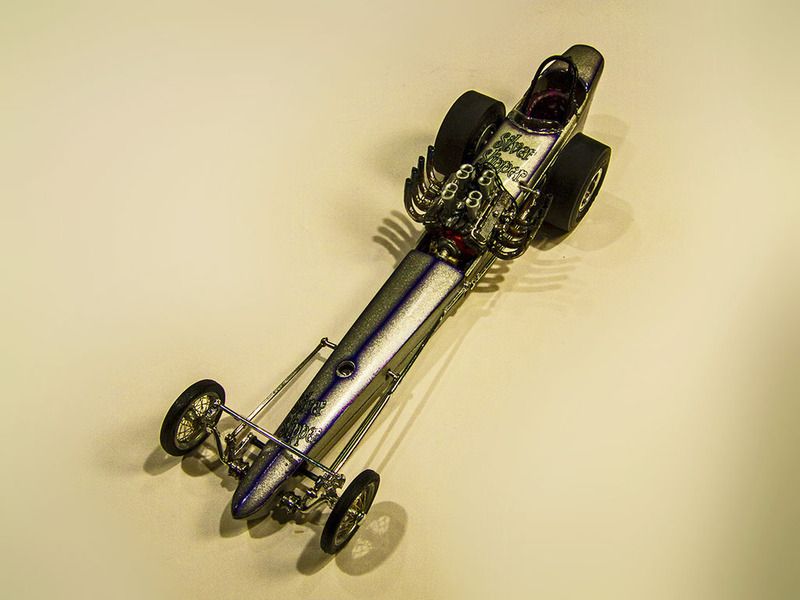

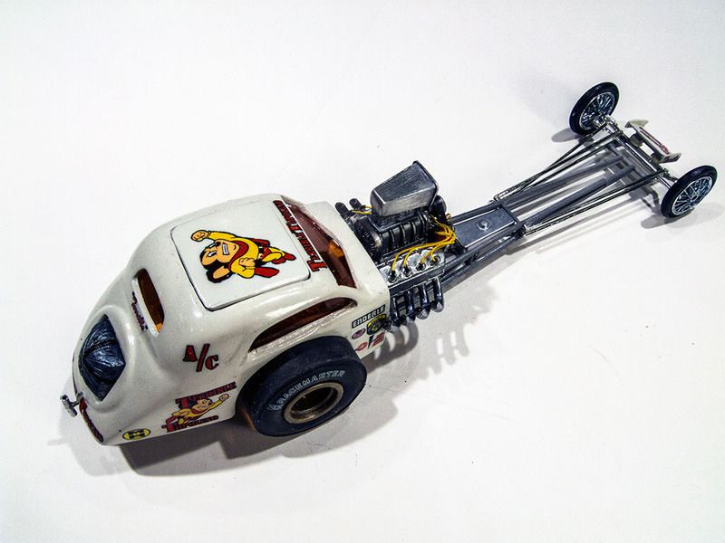

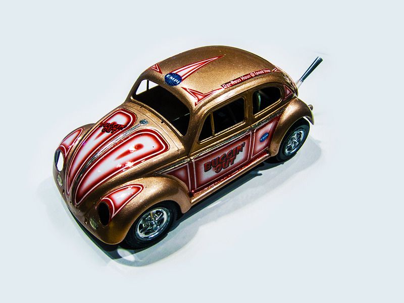

Tom Geiger Posted May 22, 2017 Posted May 22, 2017 (edited) Note that professionally printed decals first print a solid white underlay and then print the design on top of that. That's why you can use a kit decal over dark colors. As Bernard said, ALPS printers were popular because they could print white, gold and silver. There are no printers on the market today that can do that. There are some guys in the hobby that will print your decals on an ALPS printer for you. Printing decals on an inkjet is all about planning a project. If doing a fictional race car or light commercial vehicle, you can plan your paint job to either be a very light color, or a two tone where your decals will be on the lighter area. Using dark ink colors also helps a lot. Blue ink over silver paint worked fine on this one. For the taxi I used a mix of kit decals for the Checkers logo, the taxi stripe and the telephone. The number "32", the phone number, (which is my old phone in NJ), the word TAXI and the ad on the topper were all printed on Testors clear decal stock on my Canon inkjet. Edited May 22, 2017 by Tom Geiger

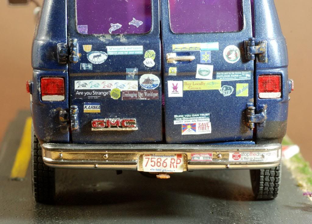

Foxer Posted May 22, 2017 Posted May 22, 2017 (edited) This is a dark blue van with a ton of bumper sticker decals I made. I had to use white decal paper but they can even be read! The problem with white is trimming them. Most of these were straight edged but you can see the curved ones I had to trim. It's like Benard said, plan ahead and you can get around the see through character of these. Edited May 22, 2017 by Foxer
