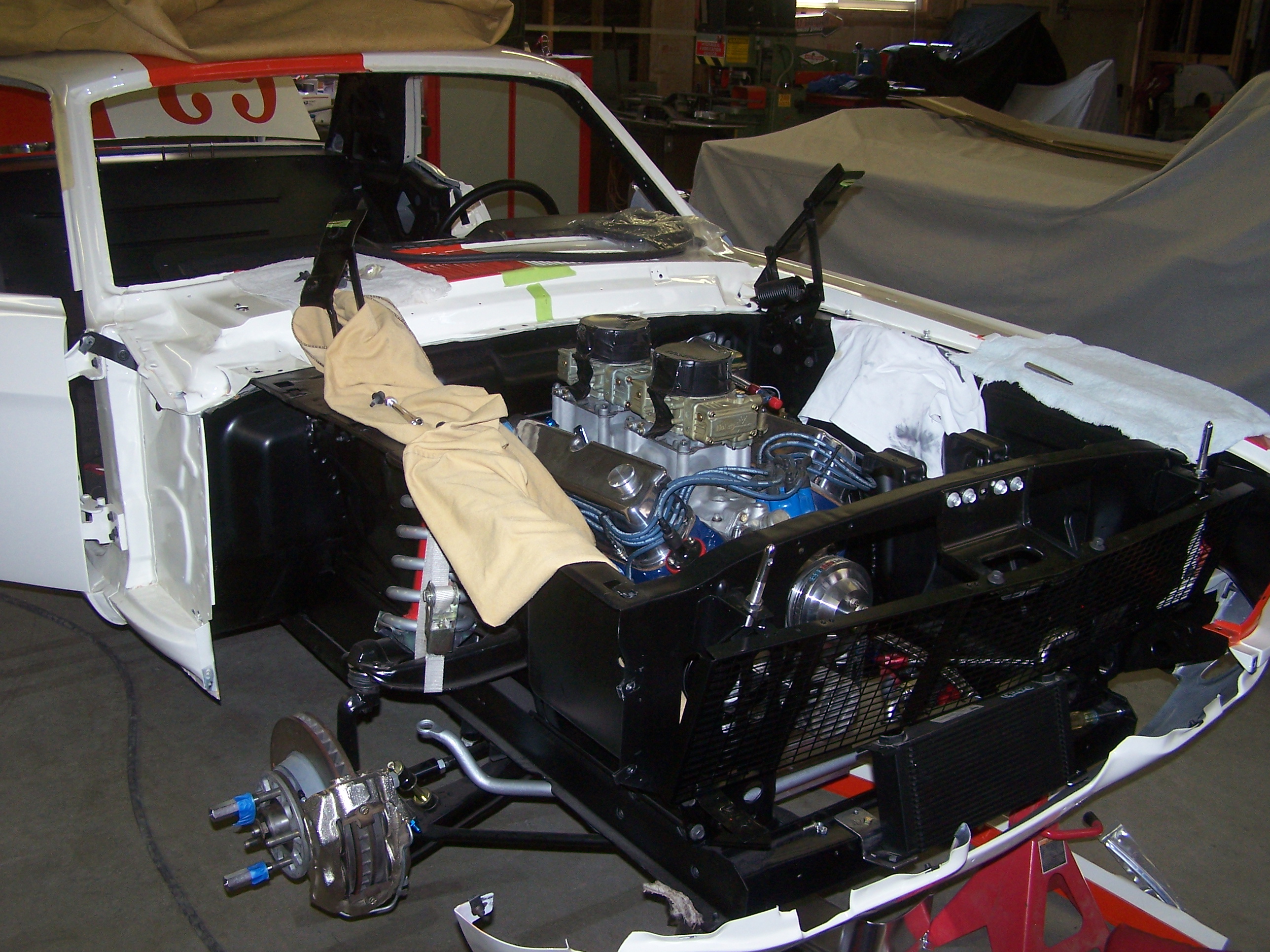

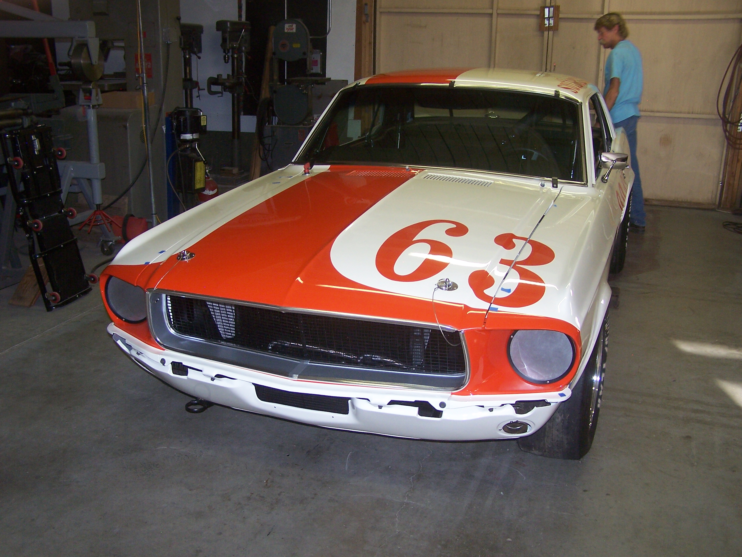

DustyMojave Posted August 17, 2017 Posted August 17, 2017 Good work Phil. Some time back I posted a thread in the 1:1 car photos section of pictures I took of one of the Shelby '67 TA Mustangs that I worked on restoring. Phototoilet killed those pictures. But I can post some in here as attachments. It only lets me do that 3 pictures at a time. But I'll do what I can. I was a Tech Inspector for SCCA races when this car was new. The Shelby Mustangs actually were NOT the 1st Trans Am racers to be acid dipped. Actually Shelby didn't dip any of them as they built them. I worked with John Timanus (SCCA Pro Series Tech Chief) and my dad (Jack Parcells - Cal Club [SCCA So Cal Region] Chief of Rules Enforcement) to inspect AND REJECT Smokey Yunick's 67 Camaro at Riverside. THAT car was ACID DIPPED!!!! I Tech inspected the one I later restored which was Fred Sutherland's. The rear leaf springs used on the race cars were narrower than stock, and were spaced toward the inboard side of the perches and shackles to allow tire room. It seems like the engine winds up rather far forward in the engine bay in that AMT '67 chassis. I'll have to look into that in my '67 build. The Shelby '67 Mustangs were all shipped from the San Jose Ford plant in Wimbledon white. In dismantling the Sutherland Mustang, I found Wimbledon white inside the car, under the dashboard, under the belly, inside the front and rear wheel wells, and under the semi-gloss black in the engine bay. It appears to me that Ford painted the entire car the same color. The engine bay and front of the core support were then painted black. My '61 Falcon is ALL Algiers Bronze, my '64 Falcon is ALL Wimbledon White. Bruce Springsteen's '69 Galaxie Convertible I did some restoration work on is ALL Gulfstream Aqua. There was none of the "primer over sprayed with finish color under the belly" type of paint application that is SO popular with "restorers". Seems more accurate for Mopars. I would say for the paint of your model to be totally right it should be Wimbledon white under the belly with maybe some "God-Awful Yellow" overspray near the edges. That would have made for less work cutting things apart for paint. That yellow, BTW, is a Corvette color. Shelby sent one of the shop employees down to the local paint supply shop they dealt with to pick up some paint for the Shelby Team race cars. They had some yellow that had not been picked up, so they sold it to him cheap. Shelby wasn't real happy, others liked it. But it wound up making for a pretty good looking and distinctive paint scheme. Jerry Titus was an interesting character. Fun personality and quite a good race car driver. Probably would have made a good car salesman if he had turned his attention that way. His son Rick worked with me on a race team (Ron Dykes Sunbeam Tiger) in 1968. For 1967, your model is correct to have a stock gas tank, as that was required in '67. In '68 fuel cells were allowed by the rules. 289 engine built by Shelby guy Dave Dralle whose shop is at Willow Springs Raceway - 487hp. But after initial track test, it got switched to single Holley for slightly less hp, but better tractability. This car held the A/Sedan track record at Willow in 1967-69. Note how the 289 sits in the engine bay compared to the AMT fit.

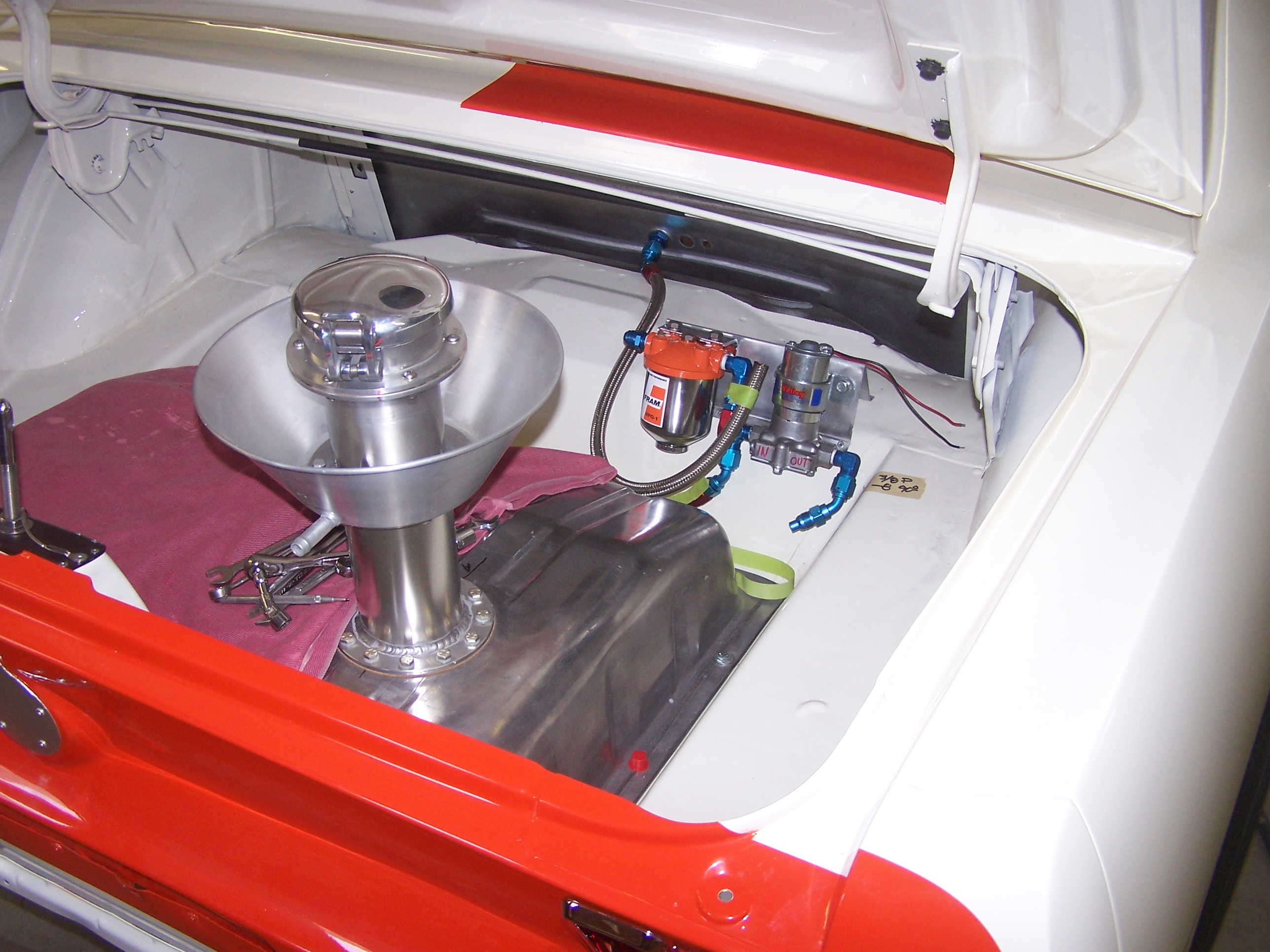

DustyMojave Posted August 17, 2017 Posted August 17, 2017 Shelby-Harrison Oil Cooler and through-the-trunk-lid fuel filler neck.

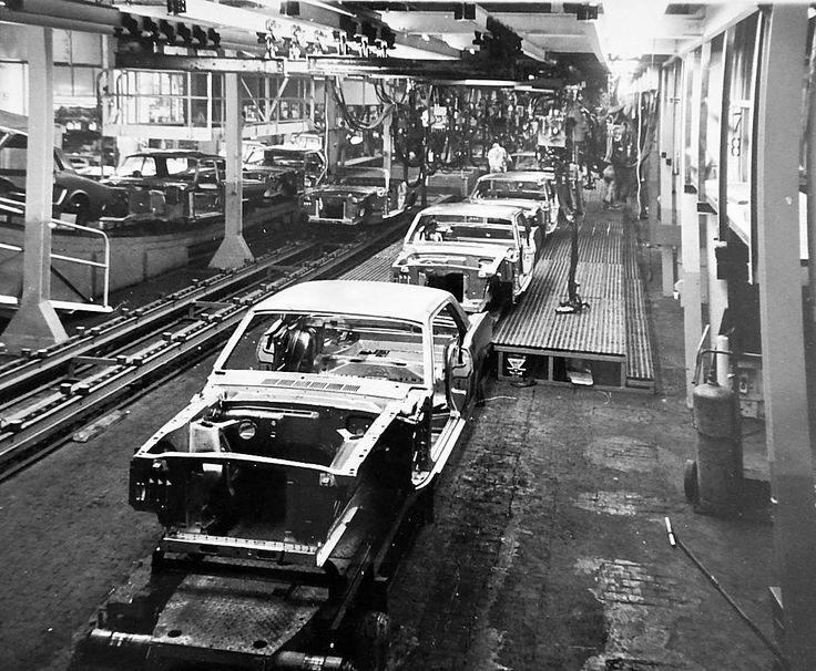

mk11 Posted August 21, 2017 Posted August 21, 2017 Thanks for posting the pics and interesting background info, Mr P. You must have had some unusually detailed cars to look at in your time with the extra paint and all, but your statement... There was none of the "primer over sprayed with finish color under the belly" type of paint application that is SO popular with "restorers"... .. doesn't exactly square with the reality of the assembly lines of the day then... or even now. Most factories had the bodies pulled along the line on a frame hooked up to a conveyor. After a dip in the primer tank and a bake, the bodies were painted. Now, unless the guys painting had the arms and flexibility of an orangutan, there were areas that simply could not be painted fully which is why the overspray you make out to be a myth exists on many survivor cars that are studied by the 'restorers' you diss. Memories are funny things; sometimes they're hard to count on. mike here's vintage pic to show what I mean...
Phildaupho Posted August 24, 2017 Author Posted August 24, 2017 After giving the body its first coat of primer I could not resist mounting it to the chassis to see how it looks. This must have been sort of how the 26 white Trans-Am notchbacks built by Shelby looked as they were being finished.
DustyMojave Posted August 26, 2017 Posted August 26, 2017 Thanks for posting the pics and interesting background info, Mr P. You must have had some unusually detailed cars to look at in your time with the extra paint and all, but your statement... .. doesn't exactly square with the reality of the assembly lines of the day then... or even now. Most factories had the bodies pulled along the line on a frame hooked up to a conveyor. After a dip in the primer tank and a bake, the bodies were painted. Now, unless the guys painting had the arms and flexibility of an orangutan, there were areas that simply could not be painted fully which is why the overspray you make out to be a myth exists on many survivor cars that are studied by the 'restorers' you diss. Memories are funny things; sometimes they're hard to count on. mike here's vintage pic to show what I mean... Yup. Been there, seen that photo before, Mike. Note that the body in the midground is on a hanging fixture . The bodies on left are heading upstairs. The body in the foreground still has more structure to be added before it gets painted. Note the quarter panel/roof seam has not been filled, and there is more to be added back by the trunk. Different manufacturers may well have used somewhat different methods. And I'm not working from "memory" on this issue. Nor judging based on restored cars, or re-pained cars. I'm basing my statements about Fords (and I see the Falcon in your avatar) on the original paint on the 2 Falcons in my back yard and the Mustang of the type this model build is about that I showed you pics of. Both of my Falcons were built in the same San Jose plant that Shelby's Mustangs were all built in. One of those Falcons was purchased new by my grandparents and still has original paint inside and underneath. The other is still in its original Wimbledon white. That Shelby Mustang I took entirely apart and removed rust damaged parts of the body structure. Yeah, my friend's 68 Roadrunner Hemi had blue metallic overspray on the primer under the rubberized undercoat dealer sprayed underneath. This isn't a Roadrunner or a Mopar at all. It isn't a GM product either. We can keep arguing. I have reported what I found. Not what somebody told me. Not based on memory. Or what's in a recent magazine or old black and white pictures that may be from a different plant.
mk11 Posted August 26, 2017 Posted August 26, 2017 That's fair commentary, reporting what you've seen; and I don't mean any offence. My statements are based on what I understand to be Ford's main objective: buck, paint and assemble car/truck bodies in the quickest, most efficient manner available to be sold in a competitive marketplace. Though practices were basically standardized at their factories, I have heard of some procedures and primer color differences unique to certain assembly points but have never personally seen any pics or even read credible reports of completely painted bodies, other than possibly show cars specially ordered. Ford, like GM and Chrysler, generally wasn't going to waste paint on areas proven to not need it. Sounds like you have some interesting specimens there. We should get back to the main attraction here, the fantastic job that Phil is doing on this Mustang... mike

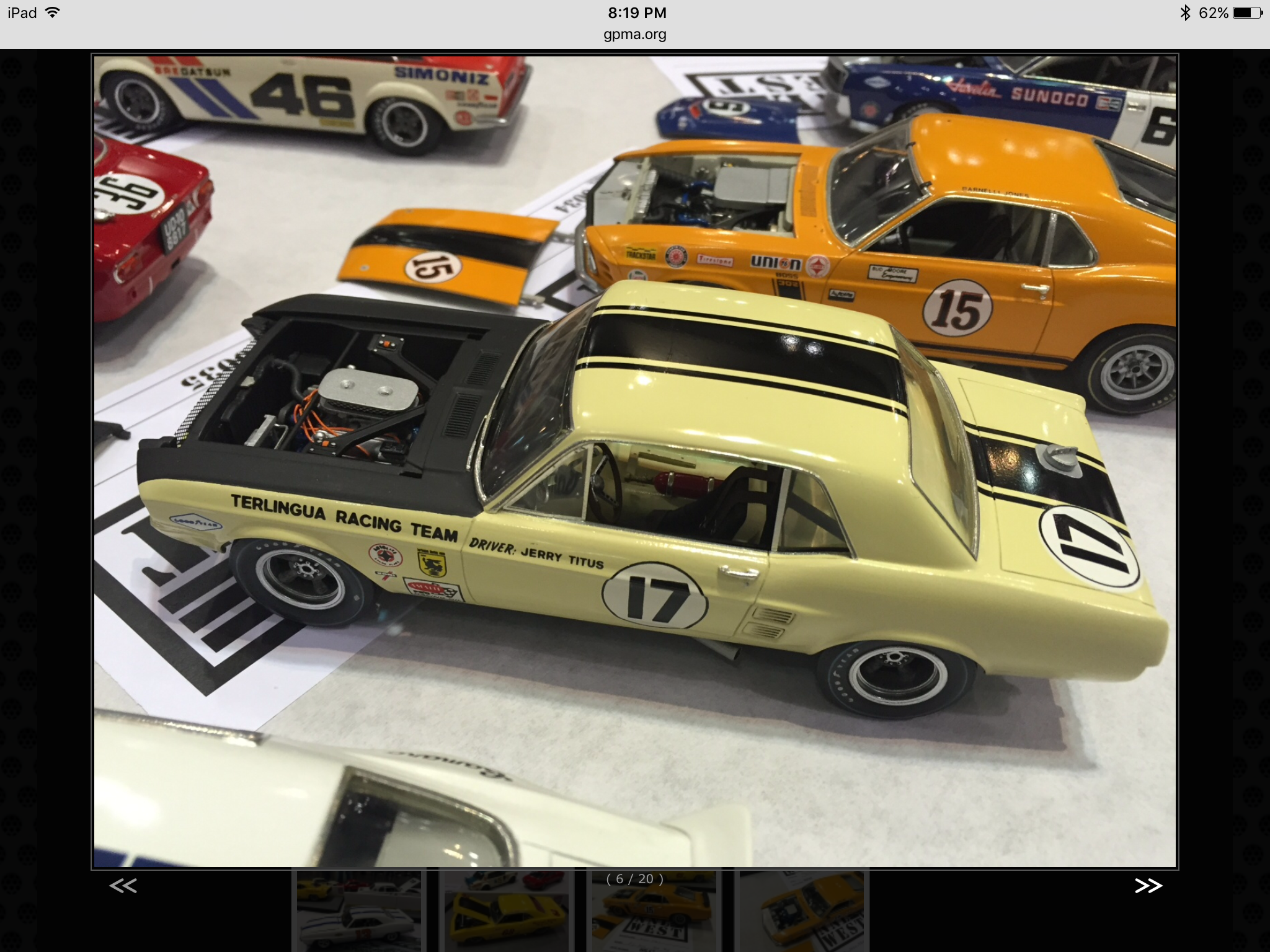

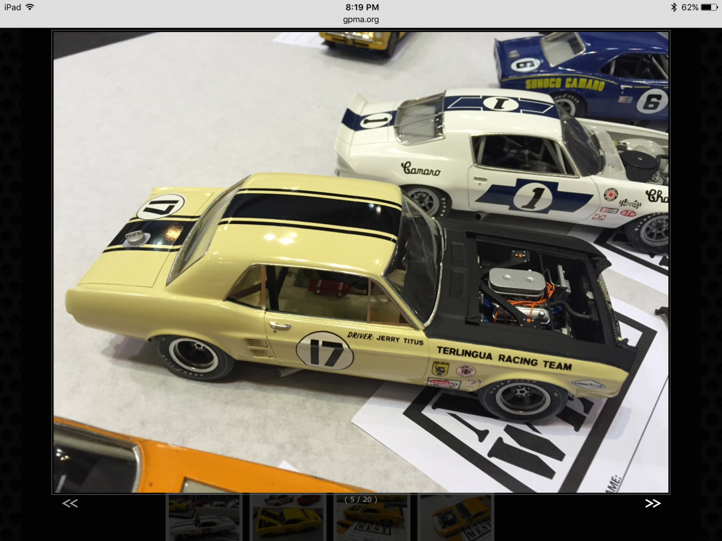

vamach1 Posted September 4, 2017 Posted September 4, 2017 (edited) I think this what we are all shooting for except for the rear window. Pics from West Coast NNL Edited September 4, 2017 by vamach1 qqq
AthOz Posted September 6, 2017 Posted September 6, 2017 Having myself worked for some years in assembly lines, I can safely say that some overspray is to be expected on the underbody close to the sill area. Painting the belly of the car would require a considerable amount of paint, and that is before the whole "how to apply it" gets into the equation. That ads CO$T$, and in mass produced cars that is a no no.

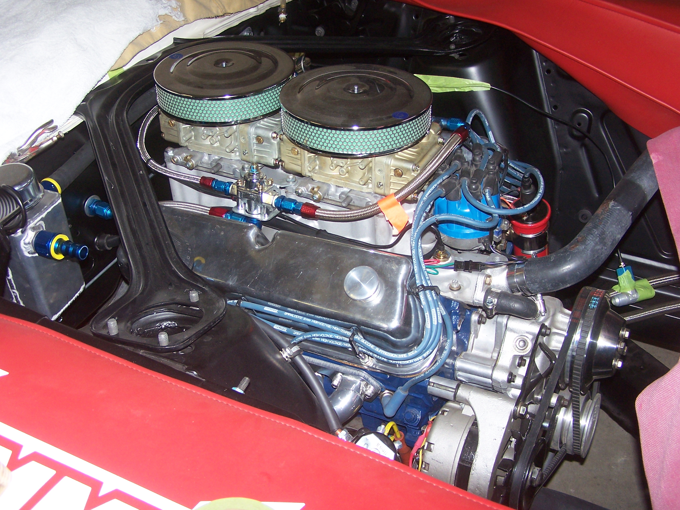

Dieselhead Posted September 6, 2017 Posted September 6, 2017 (edited) Looks great. With all these old T/A's popping up, we might need us a proper race. Could use a few bowties first though.... (great info here) 289 engine built by Shelby guy Dave Dralle whose shop is at Willow Springs Raceway - 487hp. But after initial track test, it got switched to single Holley for slightly less hp, but better tractability. This car held the A/Sedan track record at Willow in 1967-69. Note how the 289 sits in the engine bay compared to the AMT fit. Man, they really did shoehorn that dual-quad in there, didn't they! Edited September 6, 2017 by Dieselhead
DustyMojave Posted October 10, 2017 Posted October 10, 2017 Without wanting to extend an argument, I'd like to point out that the underside of a car needs to be protected by some means. That might be galvanizing, might be gloss paint, might be primer, though primer is nearly always porous and will collect water rather than shed it off. thus the belly would rust terribly badly if primer is all that is there. Whatever that means is, it will cost the car maker money. Aint nothin' free in this world.In the 1960s, American car makers offered rubberized tar spray undercoating on their cars. But that was a dealer applied option. Many cars did not get that additional cost option added on. So what protected them? Cars with body on frame construction, the frame was painted "chassis black". The underside of the body still needed protection. What do you "paint overspray" guys think was used for that? As I said above...Some cars got primer on the belly and some overspray. Some got dipped, some got sprayed with the same gloss finish as the upper surfaces. Some got a spray of chassis black.But then, lots of cars rusted away pretty quickly then.
