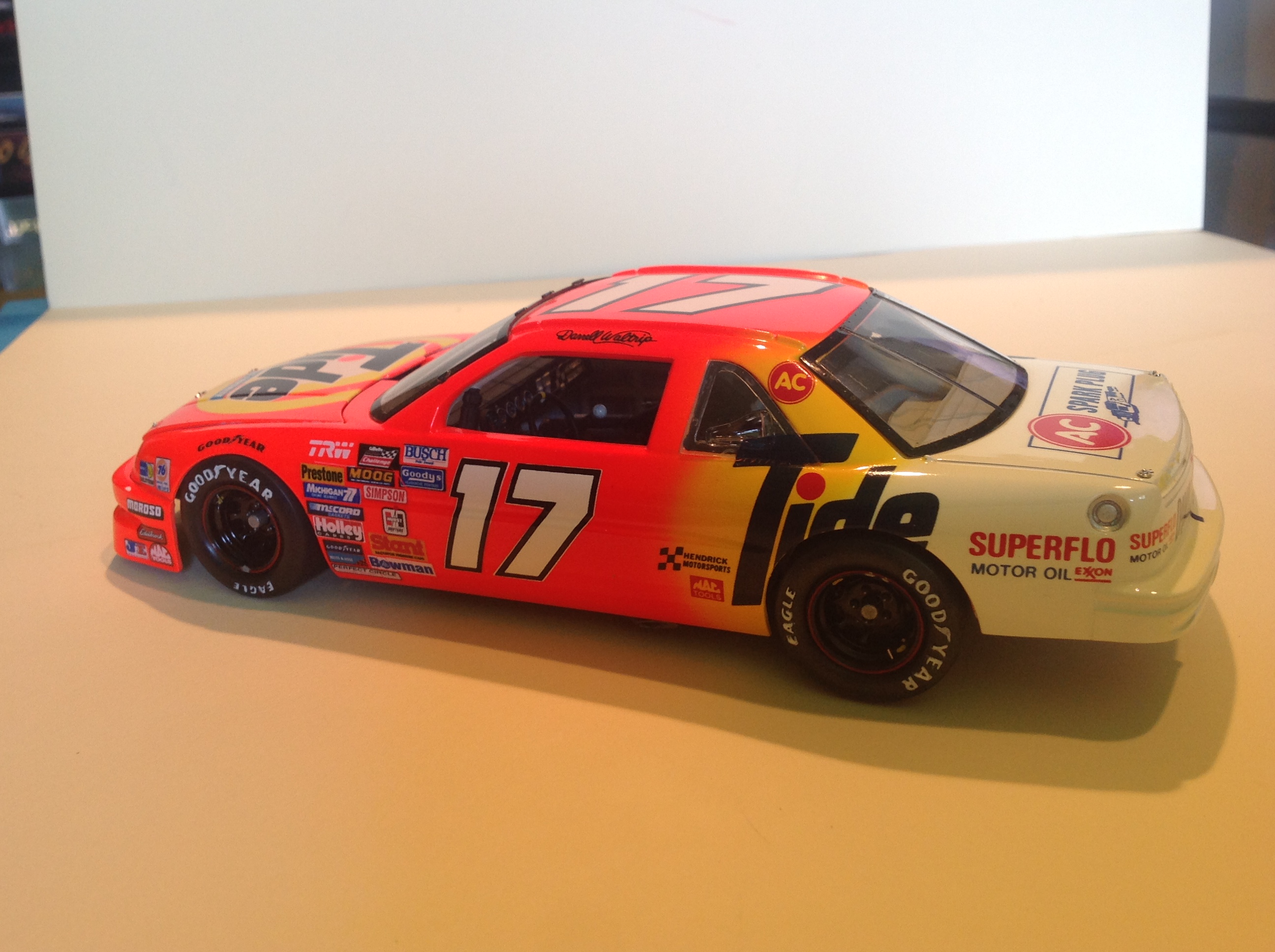

mikemopar70 Posted July 31, 2017 Posted July 31, 2017 (edited) Hi! Here is my latest Nascar project, it's the Monogram kit of course with Powerslide decals in the works!! First it's been painted with automitive basecoat white and orange, followed by fluorescent orange from Auto Air. I the shot a coat of PPG urethane clear and once dried i sanded it off with 2000 grit wet sandpaper. I then applied the white underdecals and shot another urethane clear to even the white decals with the paint, once dry, i will buff the clear and i will paintnthe yellow stripe on the rear quarter panel and will compltete the decals. Edited October 17, 2017 by mikemopar70 Syntax

mikemopar70 Posted August 7, 2017 Author Posted August 7, 2017 Here's a quick update on my Chevy! last posted update, i covered the white underdecals (large tide on hood and numbers in doors and top), with clearcoat to smooth the finish. After the clear dried, i polished with detail master kit, to get everything smooth. I then began applying the finishing decal, on the hood.. Next step i will do the yellow stripe on the quarter panel, in paint!! See ya!

mikemopar70 Posted September 28, 2017 Author Posted September 28, 2017 A little update on my Monte-Carlo... The decals are going on nicely, thank's to Mike's decals, those Powerslides works great and are very sharp.... It's coming along nicely!

mikemopar70 Posted October 17, 2017 Author Posted October 17, 2017 Hi everyone! Thank's for the comments, here is the completed beast! I now have my own example of this iconic race car on display!!! Pretty satisfied with it!
