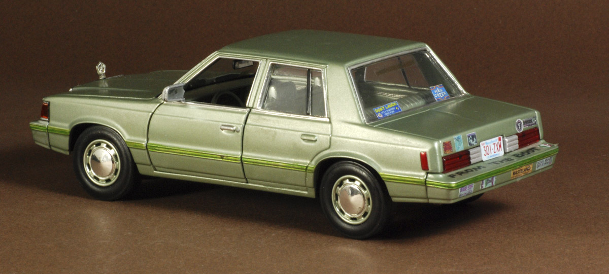

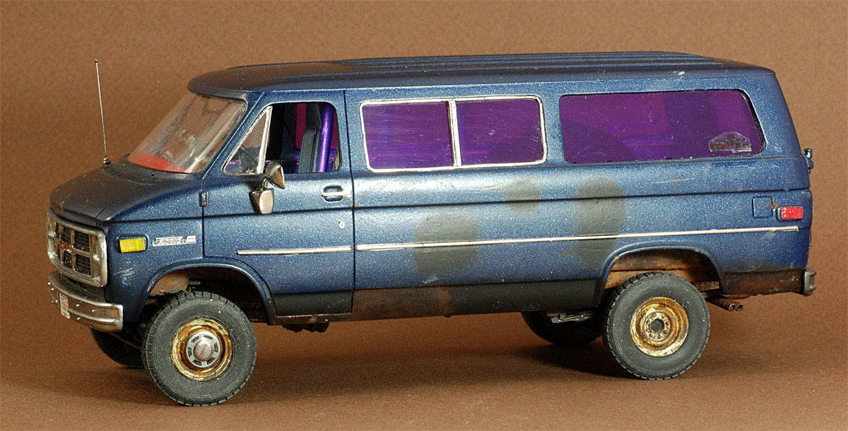

Foxer Posted August 5, 2017 Posted August 5, 2017 (edited) I don't have any shiny photos as the ones I have are of my daughter's cars which were pretty rough and the paint was done so. I was trying to make the paint look old, so don't take that as a good example of the paint itself. The green reliant is a metal die cast. The colors were spot-on matching the factory colors. Neither paint job was polished or clear-coated to keep it rough. Edited August 5, 2017 by Foxer
crowe-t Posted August 5, 2017 Author Posted August 5, 2017 Thanks for posting the pictures! I remember following the blue van build. That was a fun build to watch.
