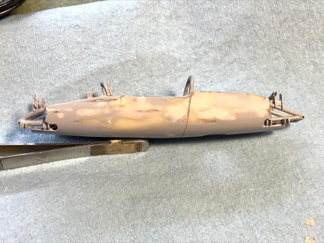

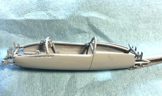

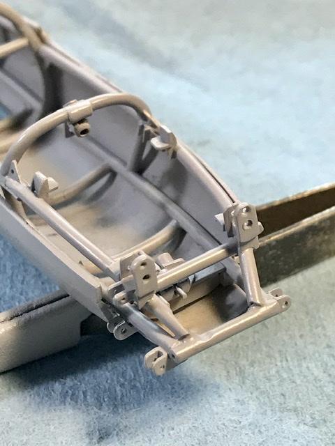

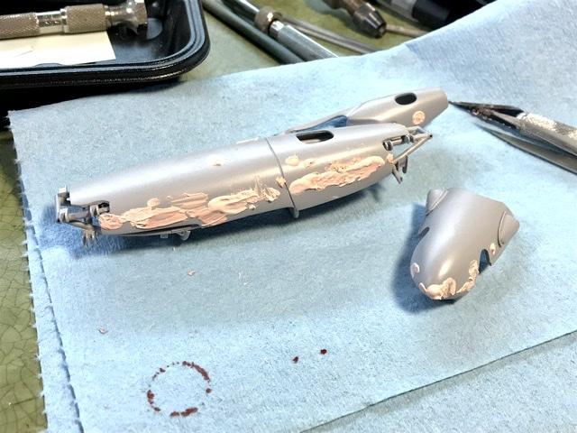

It’s primer nite
some pinholes here and there
no big deal ...
bondo tomorrow ...

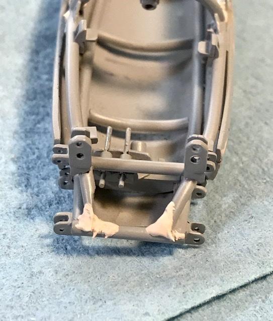

the chassis will remain primer gray -‘Tamiya -
I’ll brush paint the interior aluminum finish on the body panels

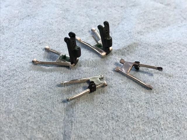

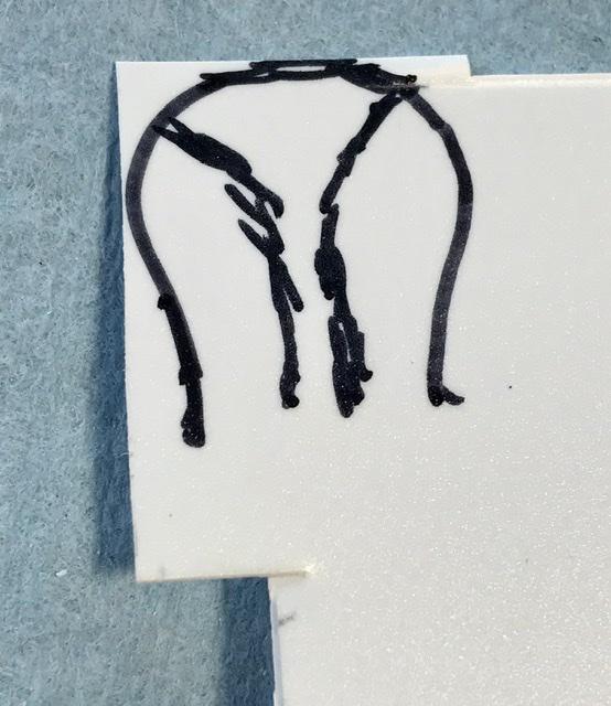

Tried some oil based Sharpie black on the sway bar - looks ok - shiny - needs a short while to dry
the suspension uprights were brush painted with some floquil - brushes on nicely - wish I had a bigger stash of these paints ...

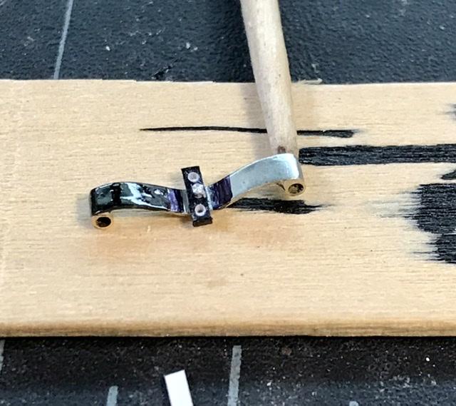

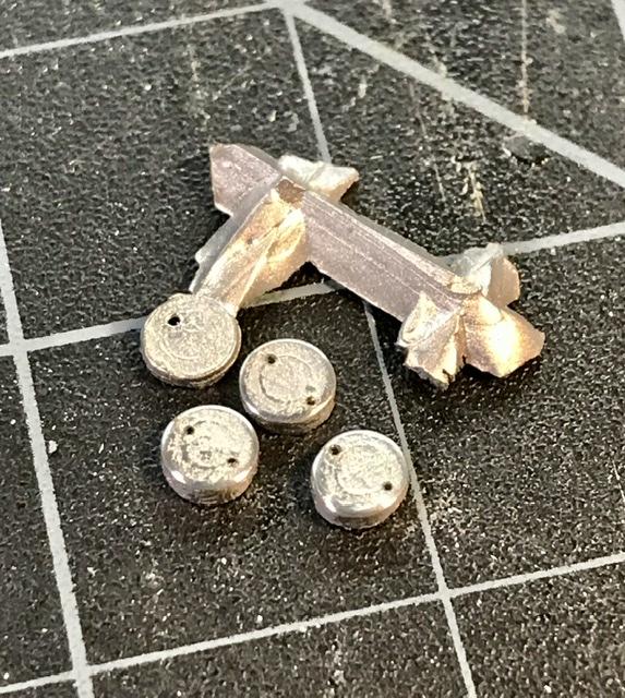

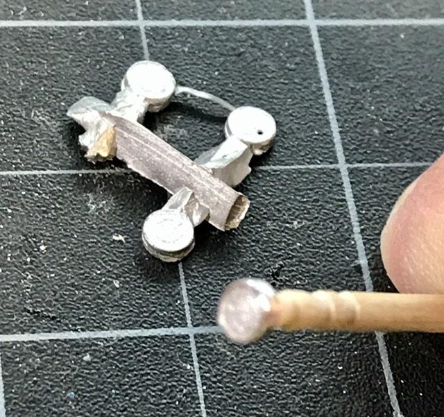

Herb Deeks’ kit came with these white metal spinners for the wheels - temporarily glued to the end of a toothpick and sanded/finished with the Foredom drill and drilled for rivets ...

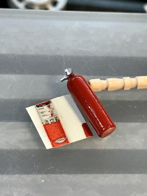

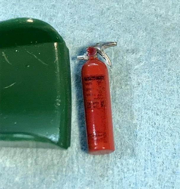

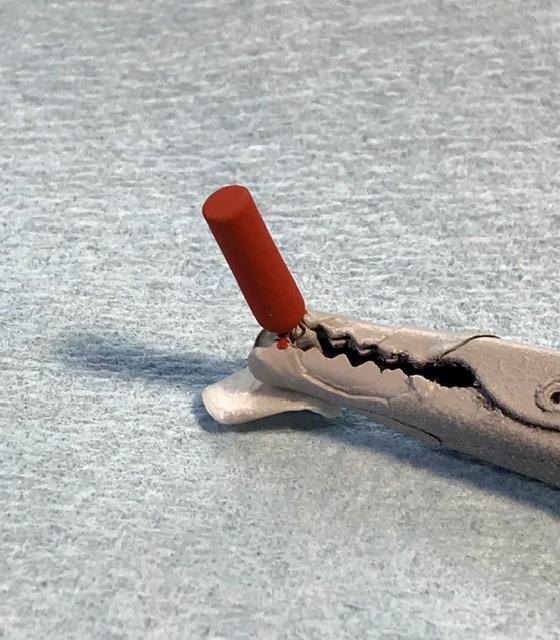

Fire extinguisher
found another stash of floquil in one the deepest recesses of the workshop - nice surprise - including a jar of red unopened from maybe ???? 25 yrs ago ????  Very flat -
so topped with some Tamiya clear and the decal made on my printer

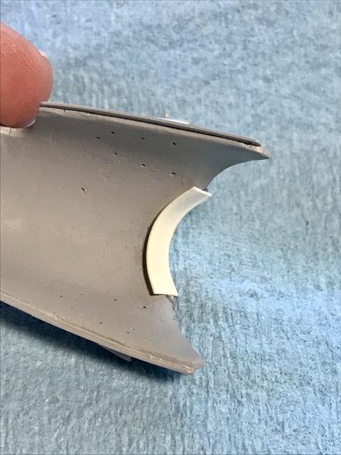

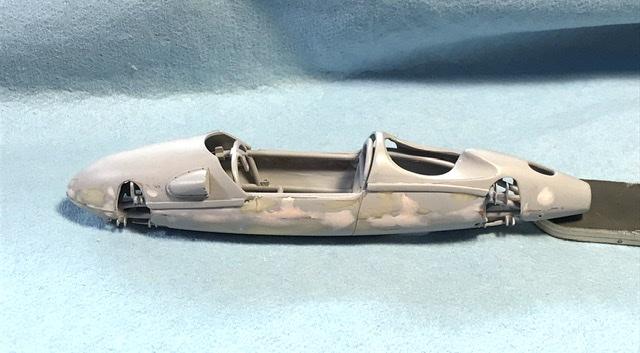

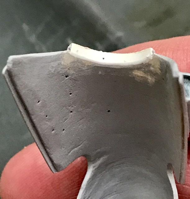

Beaches still closed. But there is lots of sanding to do...

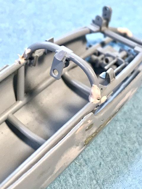

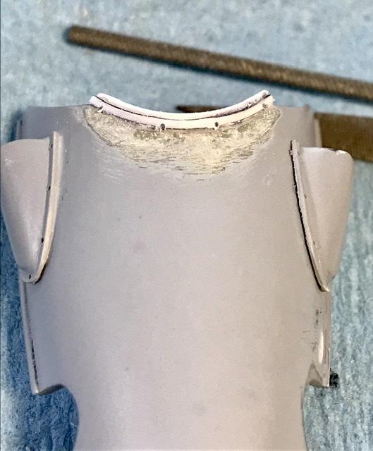

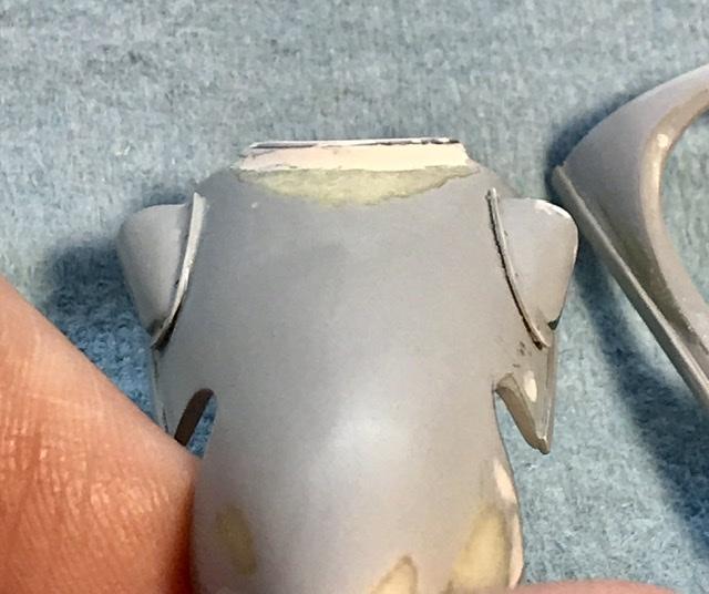

2 part bondo finishing putty. I think #108.  Just the stuff on the shelves at your local hardware store.  Pinholes be gone (?!?). Also adding the lip for the windscreen...
Thanks  but I always worry about what’s round that corner ....

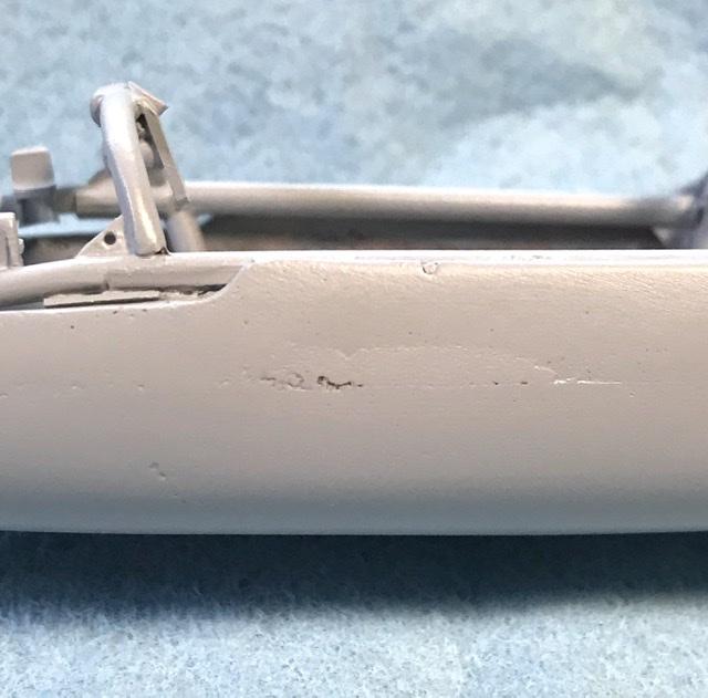

bondo morning ....
blending the lip for the windscreen and correcting some flaws on the engine cover

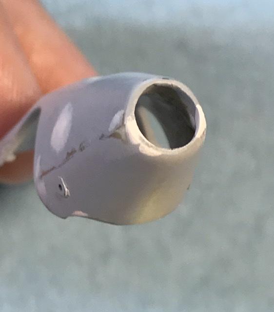

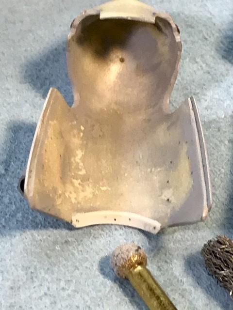

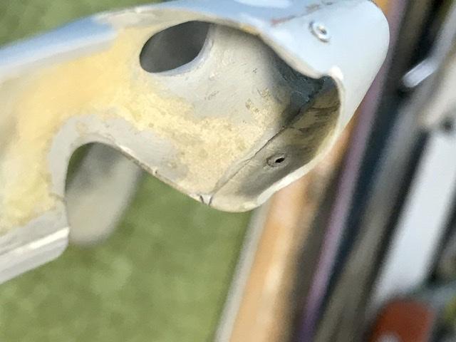

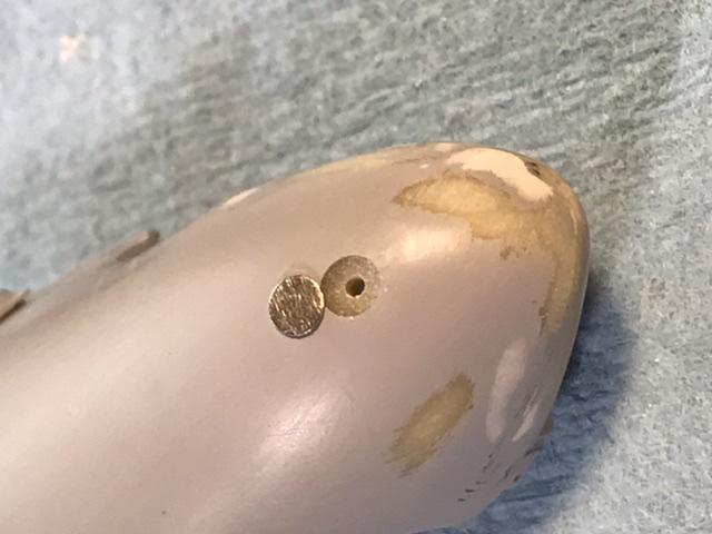

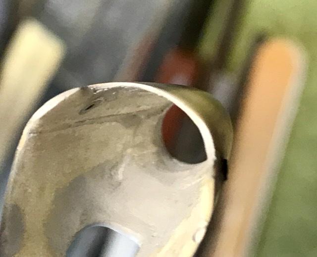

Drilled and ground a recess into the nose for the badge which will be an 096 disc  -  either the nickel that is pictured or perhaps an aluminum disc - using a hand punch
the other shots show some grinding and finishing for inside surface of the eng cover and the nose - trying to remove most of the tool marks and divots from thinning the panels

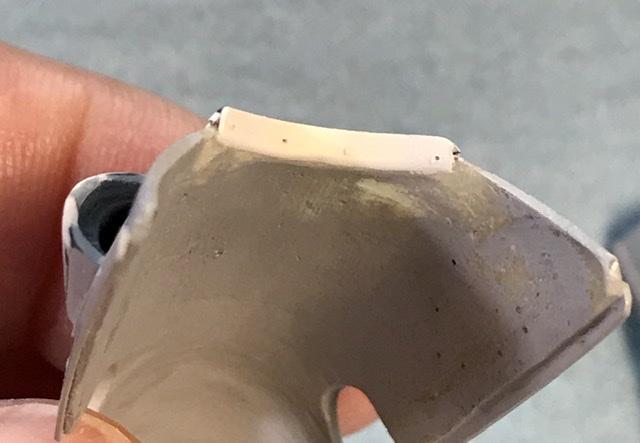

and I’m smoothing the interior seems a little.   Judges rant...  judges don’t know much  -  but they can spot a seem from the other side of the contest hall - so  here ya go, judges - best I could do.  There. I feel better now ../.
Why does it seem
like it takes more time to correct
things than to make
things ?  Puttied some of the joints to clean them up ....

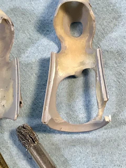

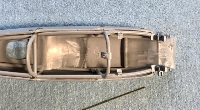

So the body panels are aluminum  - the undersides  are probably unpainted  -  so I’m thinking that I should paint the underside a shade of Alcad aluminum and then spray the paint finish on the surface with no masking and just allow a little overspray on the underside alu finish -
thoughts ?

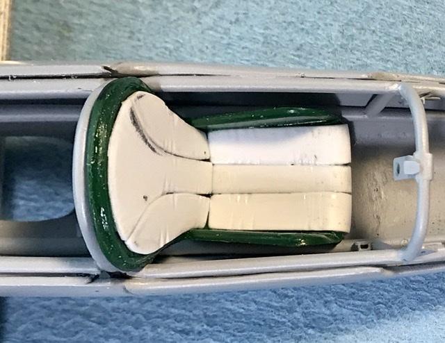

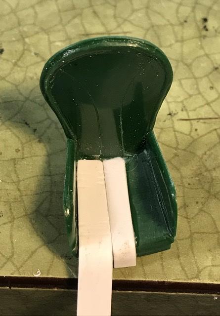

Seat time ...

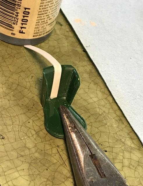

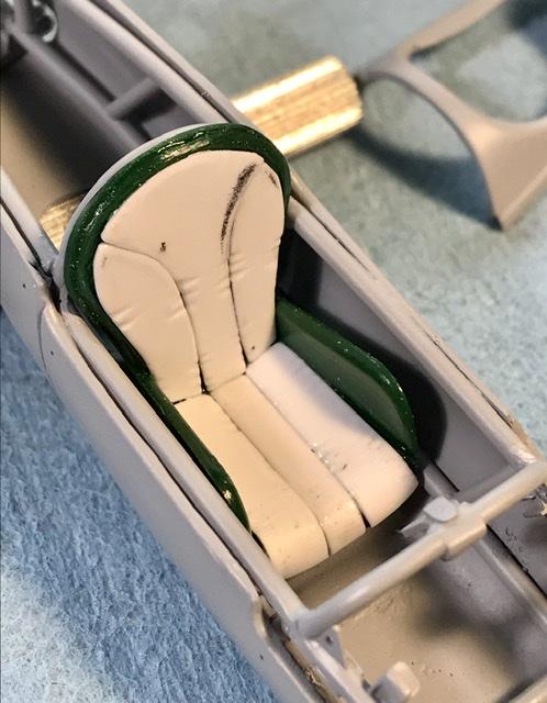

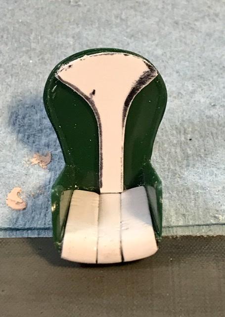

the merit kit seat has the correct shape but has nothing resembling seat cushions - so these were made from sheets and evergreen bar stock - .020 thick. Shaped with sanding sticks , an xacto blade, sanding drums , files etc. the evergreen was glued to the seat with liquid glue ...

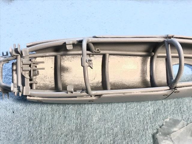

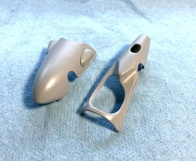

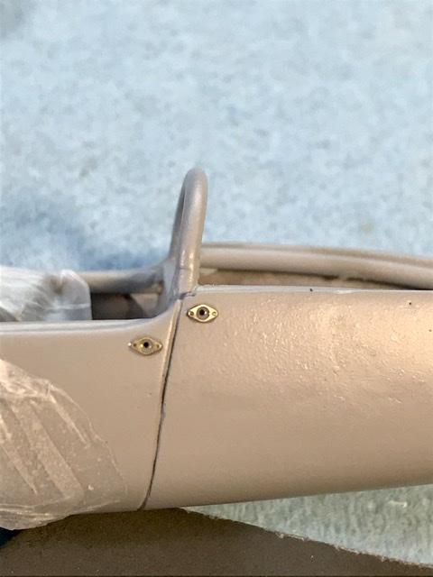

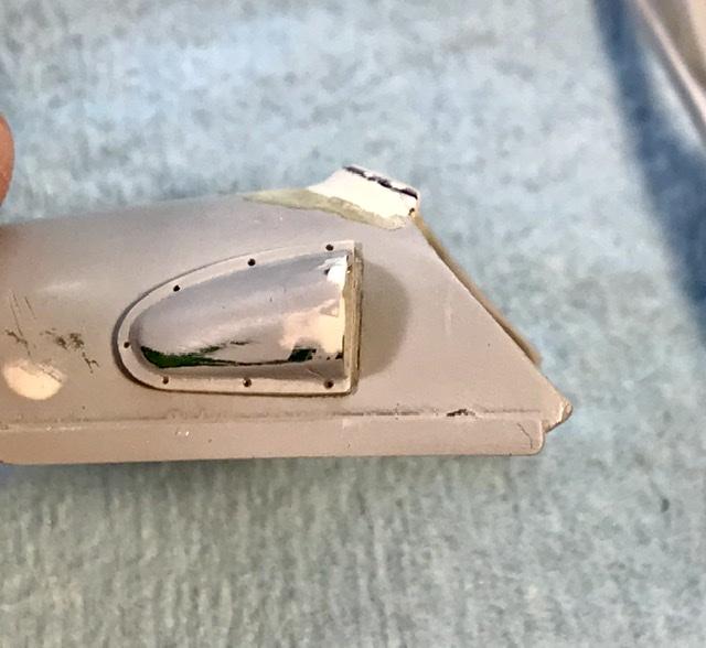

The second coaT of primer is on

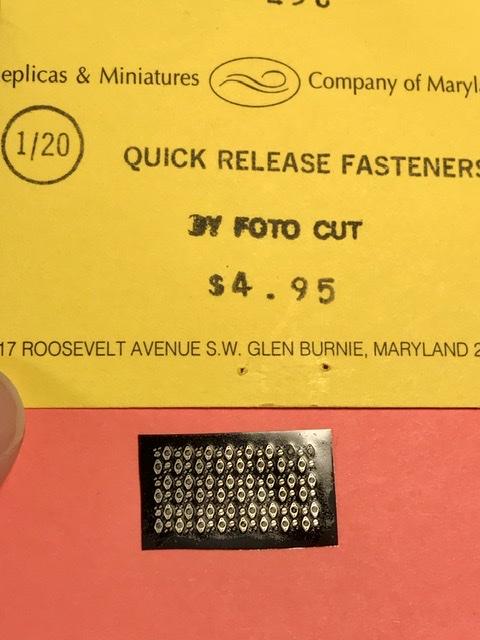

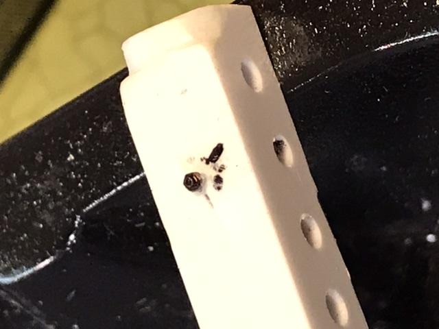

got rid of most of the pinholes - glued on some body fasteners - will scrape the finish paint coat off them - but this should be cleaner than gluing them on after the color coat -  have always been a fan of Veber’s photo-etch fasteners. He had them done years ago by Fred Holtzberg (?) in New York - he was best ....  using the 20th scale finishers - seem like the correct size -  ten total.  Some light sanding and I’ll be ready for the color coat. Once I figure out what’s wrong with the airbrush - it’s either the water trap or the compressor - dunno ...

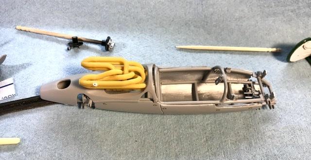

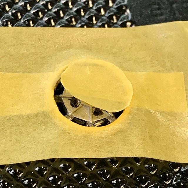

Whilst I ponder the airbrush mystery- I’m brush painting some tamiya flat aluminum onto the interior of the body shell - sneaking around the chassis tubes by covering them with strips of 3M parafilm. Working so far ...

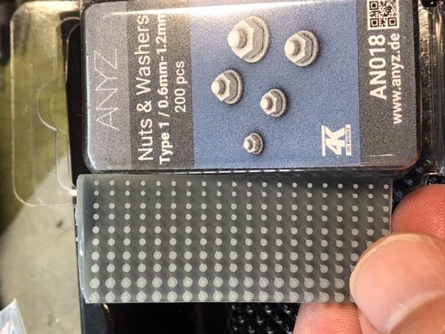

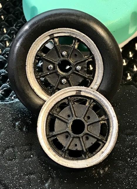

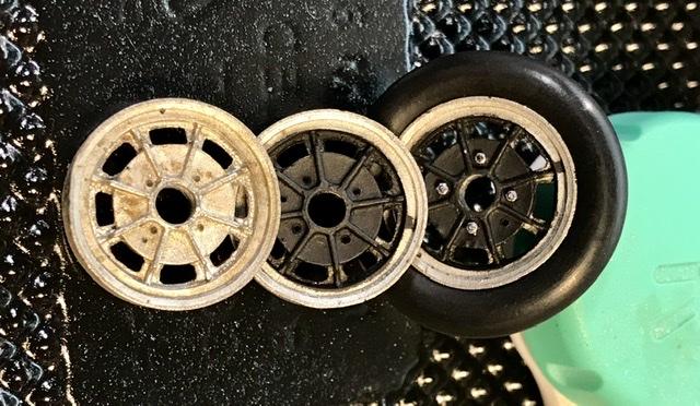

The white metal wheel castings came in Herb Deeks’ super rare Cooper kit which was a recast of the Merit kit with some wh metal castings ... And whilst I was toiling away making lug nuts  for the Lotus 32B - it occurred to me that I needed 8 more for the back wheels on the Cooper .  So....
Thoughts on tire sidewall markings.  The Deeks kit uses rubber O rings that I sanded for the tire patch. Sorry. - no tread pattern...  would like too use / apply Dunlop markings. Dry transfers would work better than decals.
