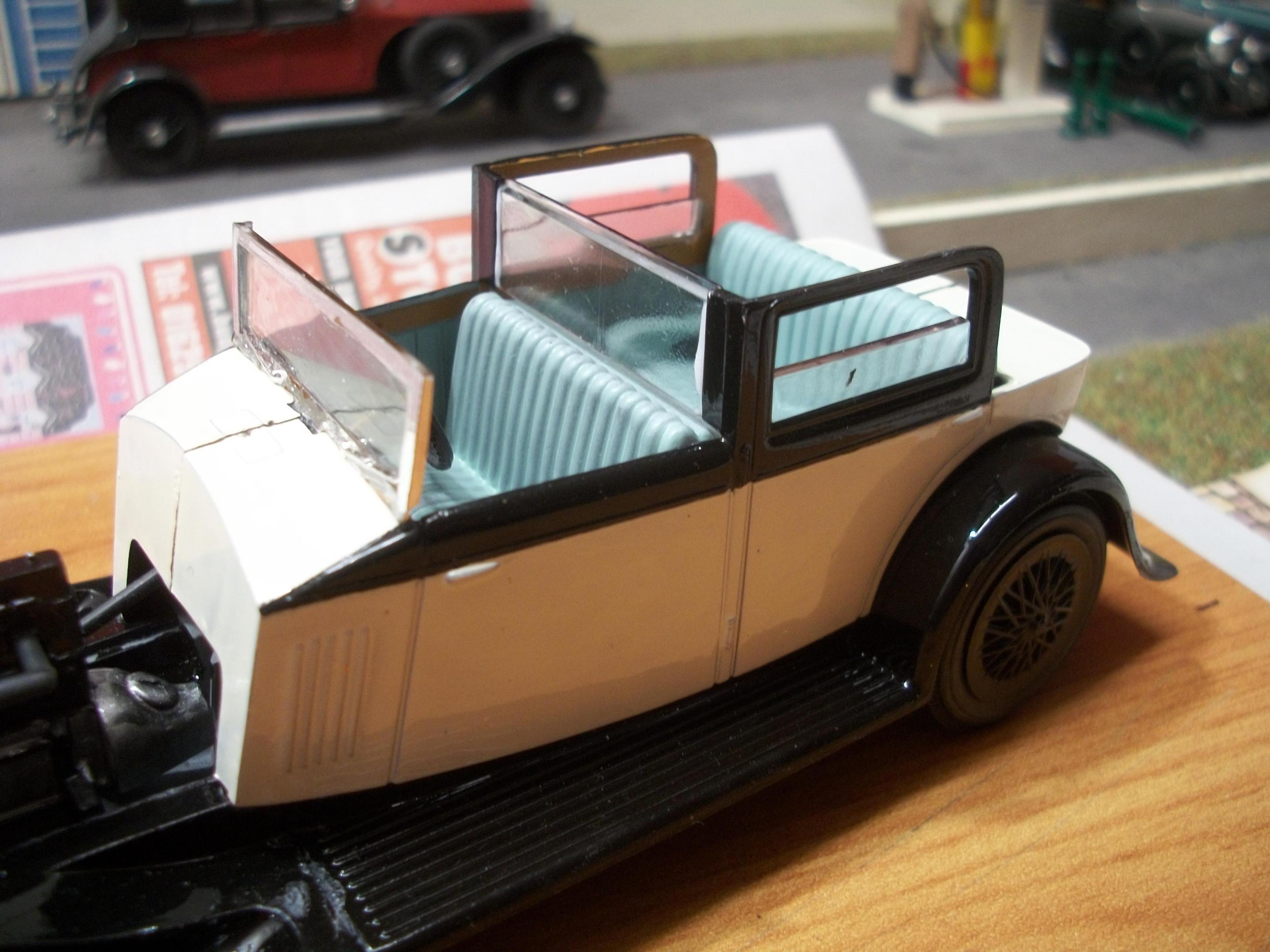

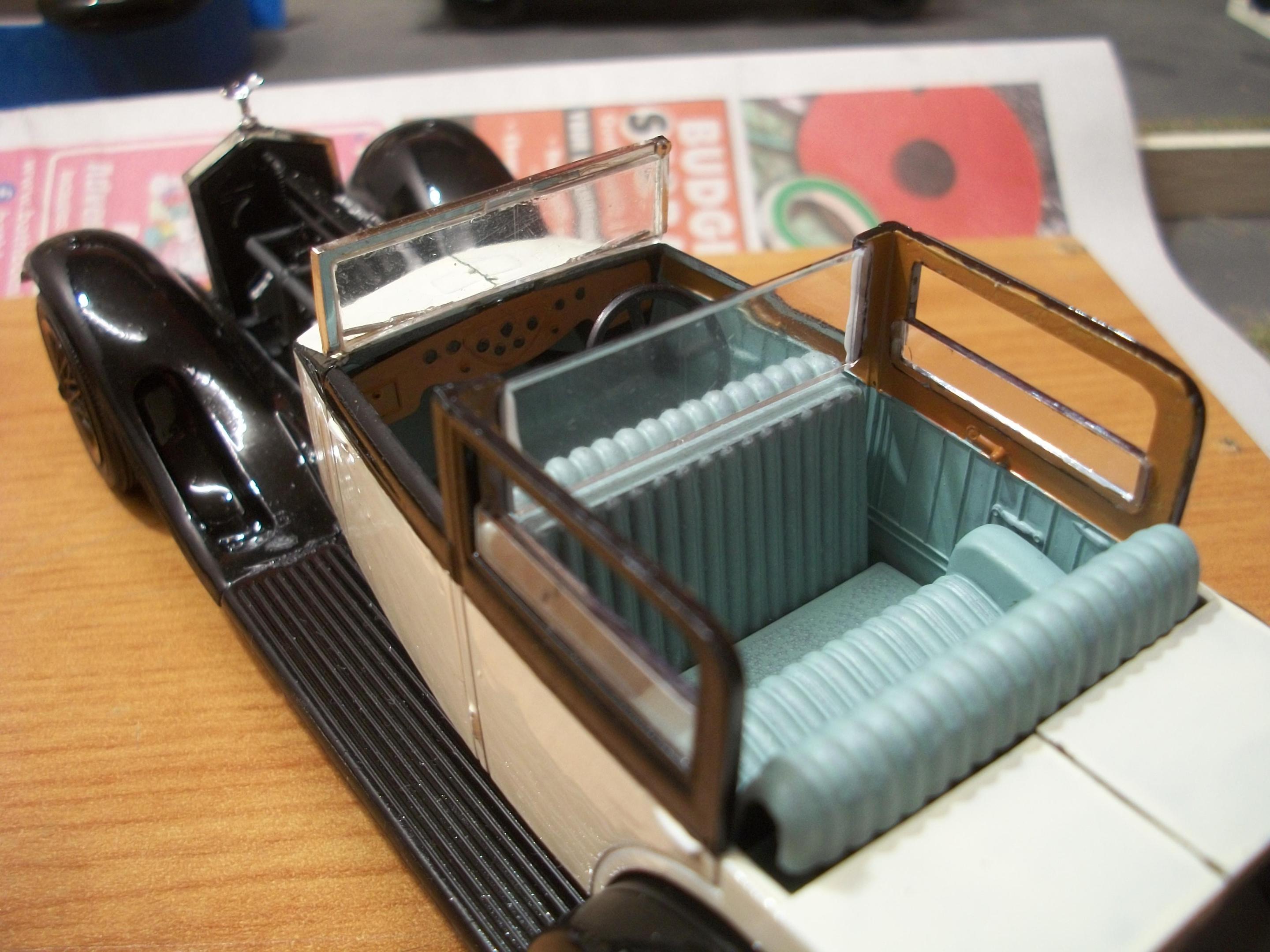

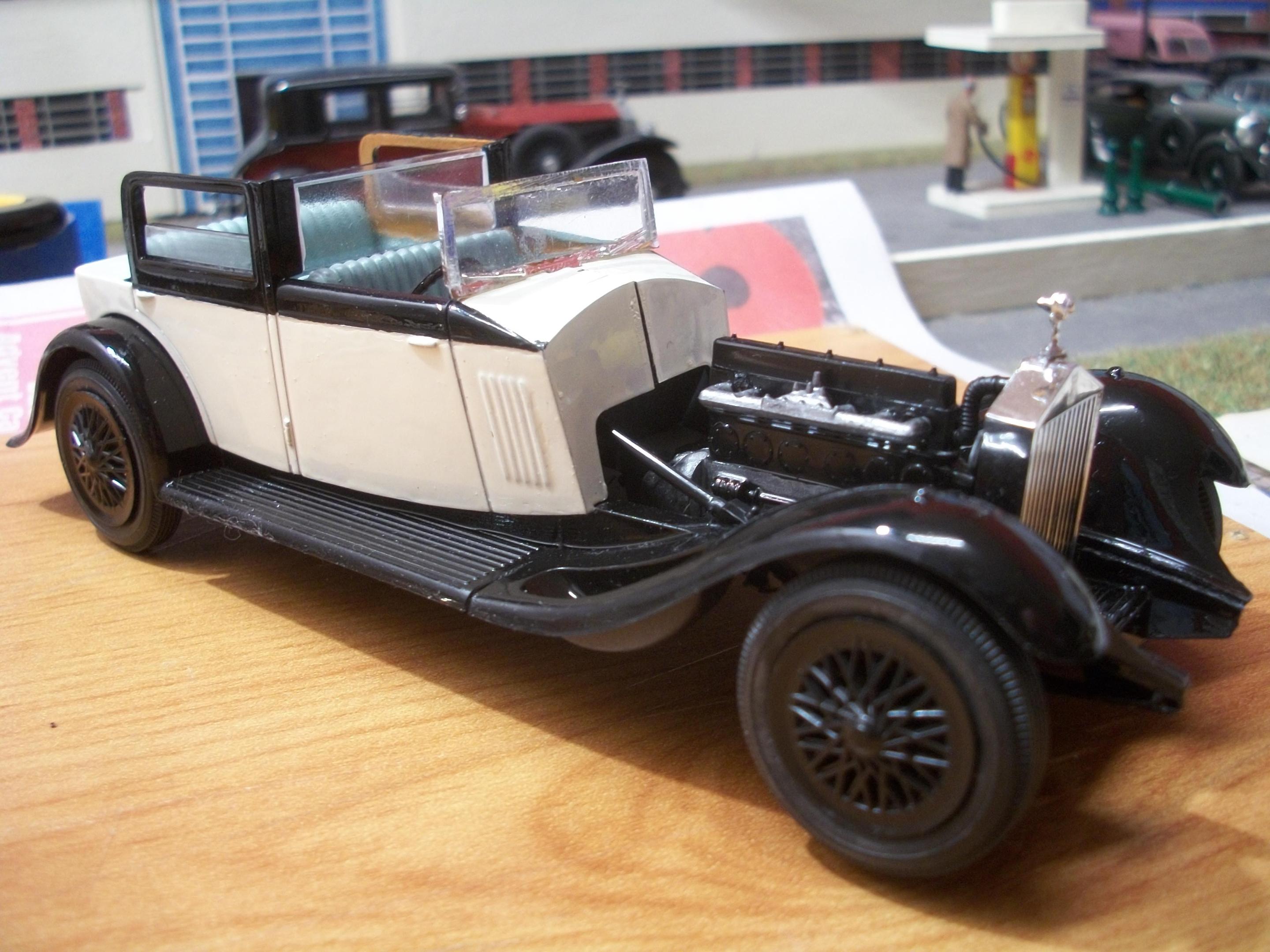

The 1:32 scale Pyro kit of the 1933 Rolls-Royce Phantom II ' Towne ' Car is nearing completion. Within the next day or so this model should be ready for the European Tram Car diorama. There are some finishing touches needed for the MiniArt tram car kit in 1:35 scale, and I am very much aware that these excellent MiniArt kits are designed and manufactured in Ukraine.
The Pyro Rolls-Royce does have a partition window between the passenger compartment and the driver's compartment, which is a nice touch, and you don't get this partition window in the 1:24 scale Italeri Phantom II that I built.
David

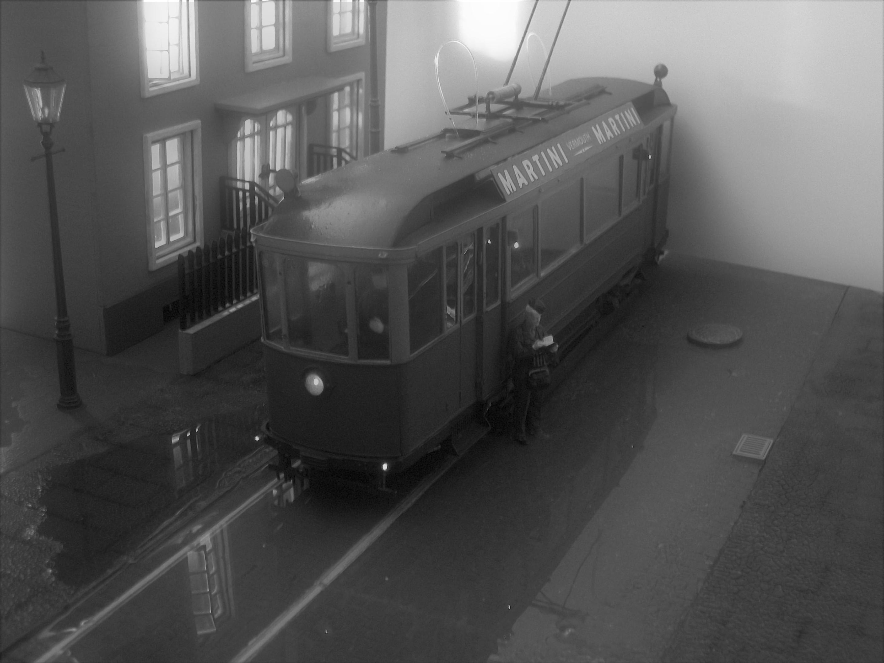

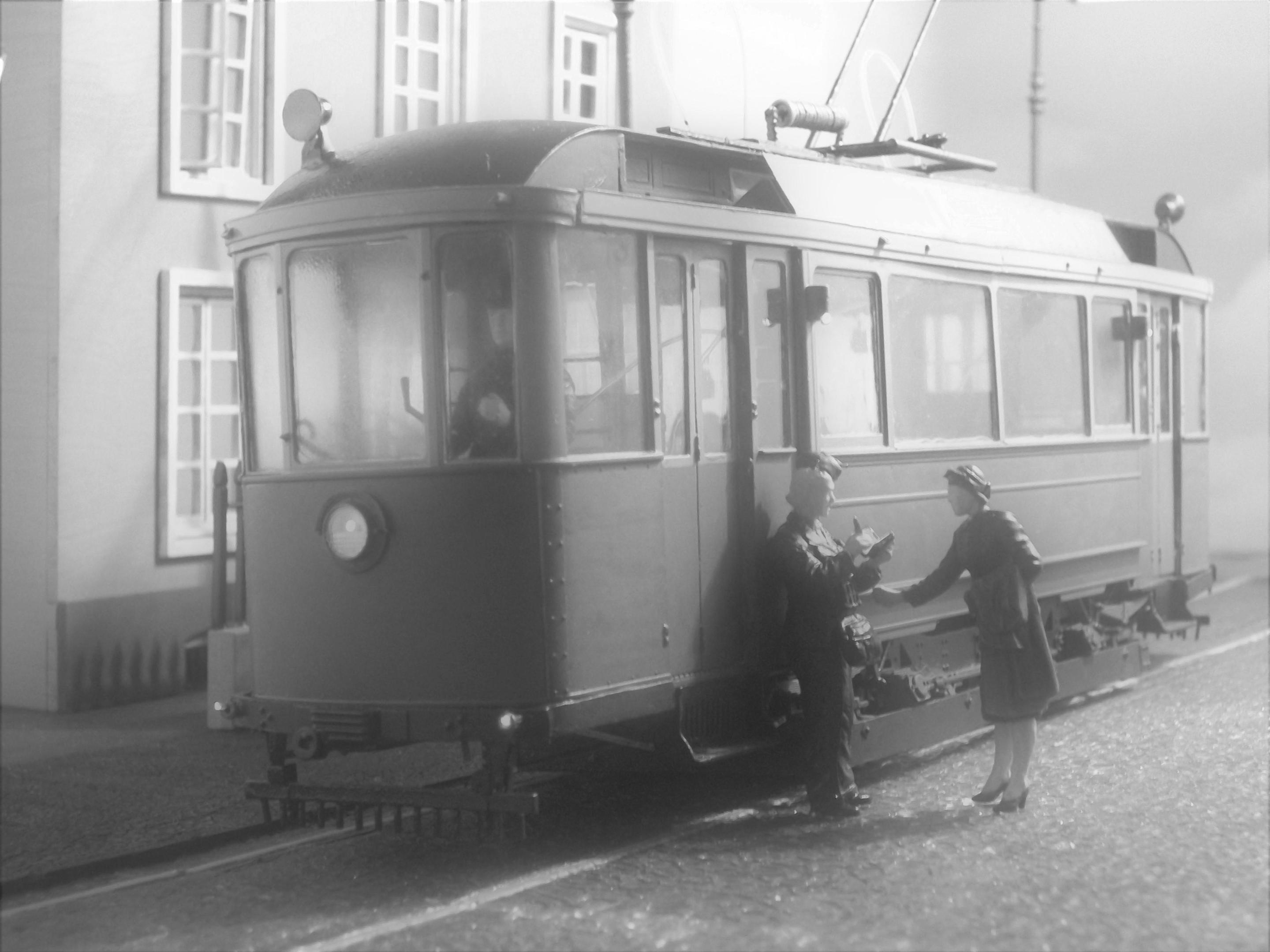

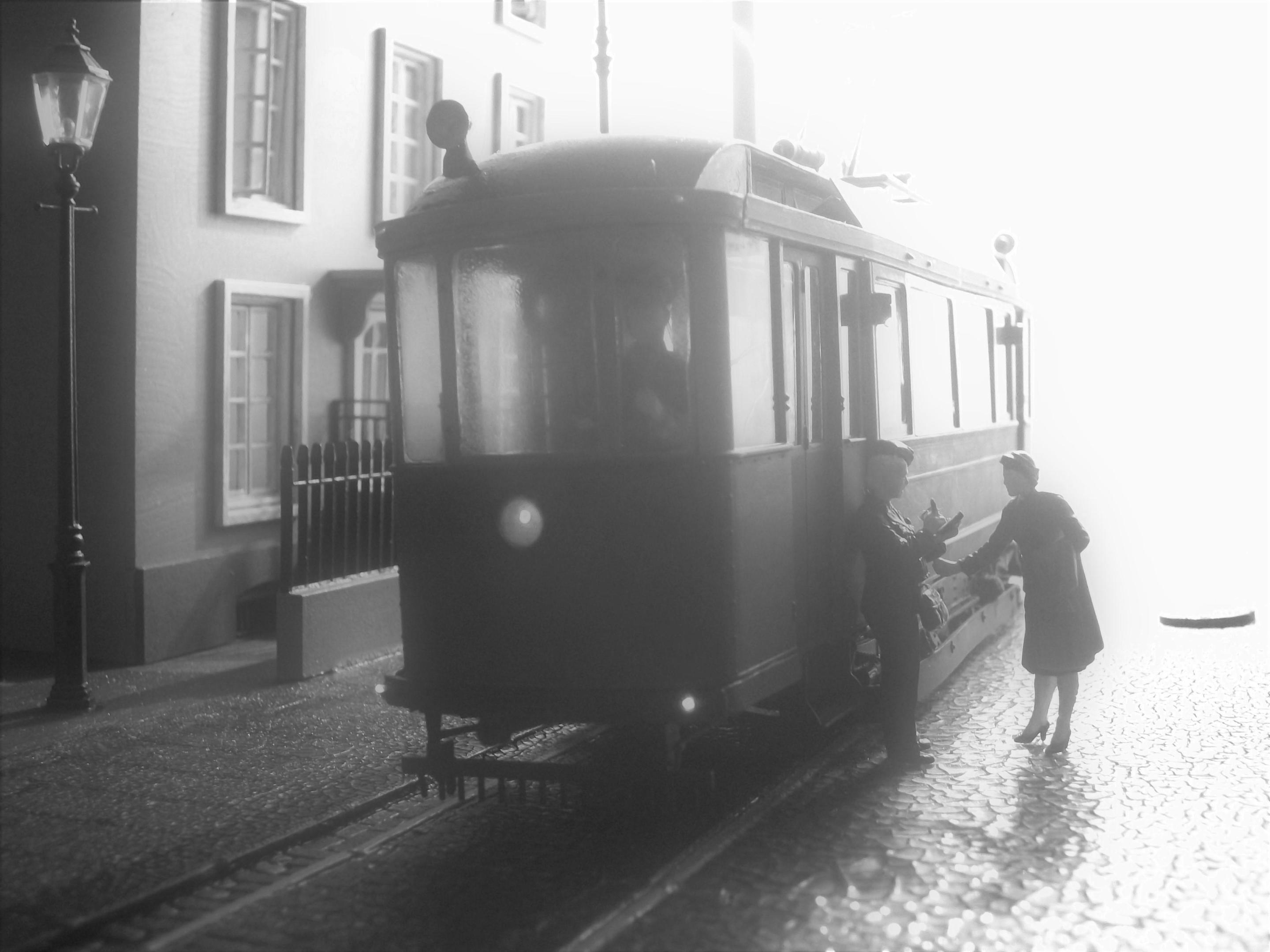

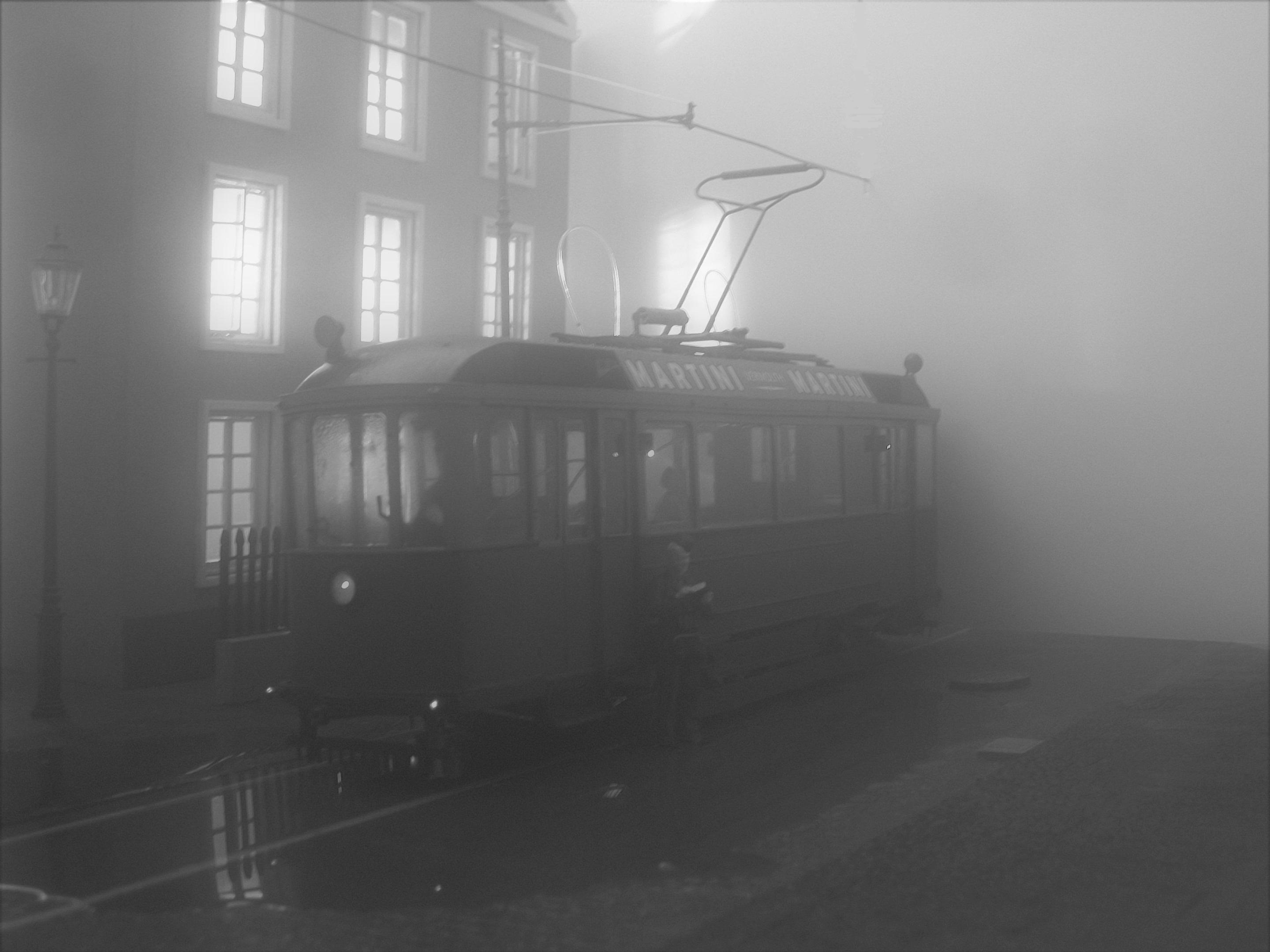

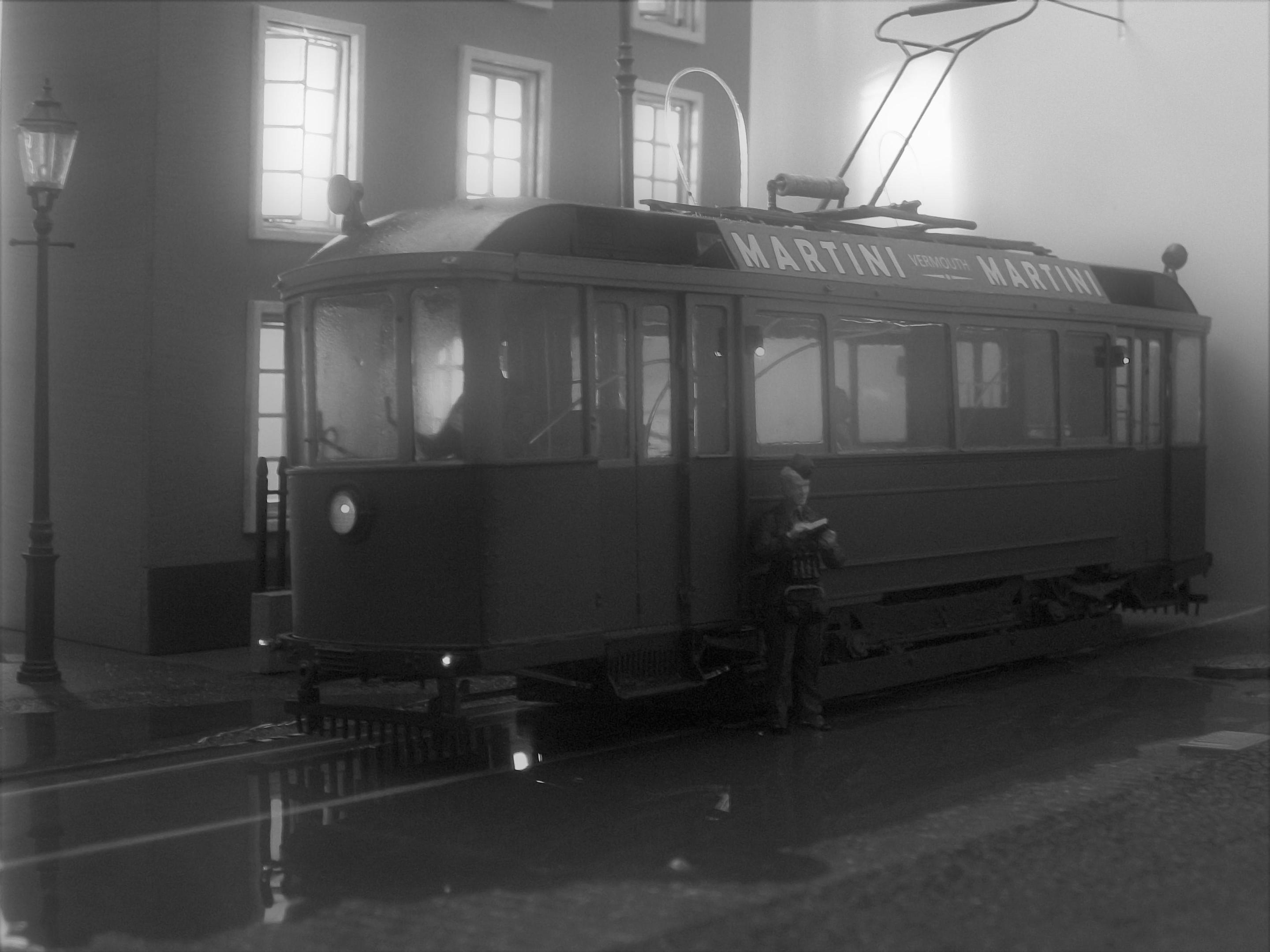

Here are three early experimental photos of the tram car diorama . . . These are B&W shots, with no still water effect or fog effect added yet.
Thanks for looking guys !
David
2 hours ago, landman said:
That is very realistic, especially the middle one.
Thank you Pat . . . .  I am quite pleased with these early shots, and I am confident that I can create the wet cobbled street effect, such as immediately after a rainfall shower has occurred. The fog in a can is more difficult, and I was struggling a bit with the lighting source and angles last night.
David

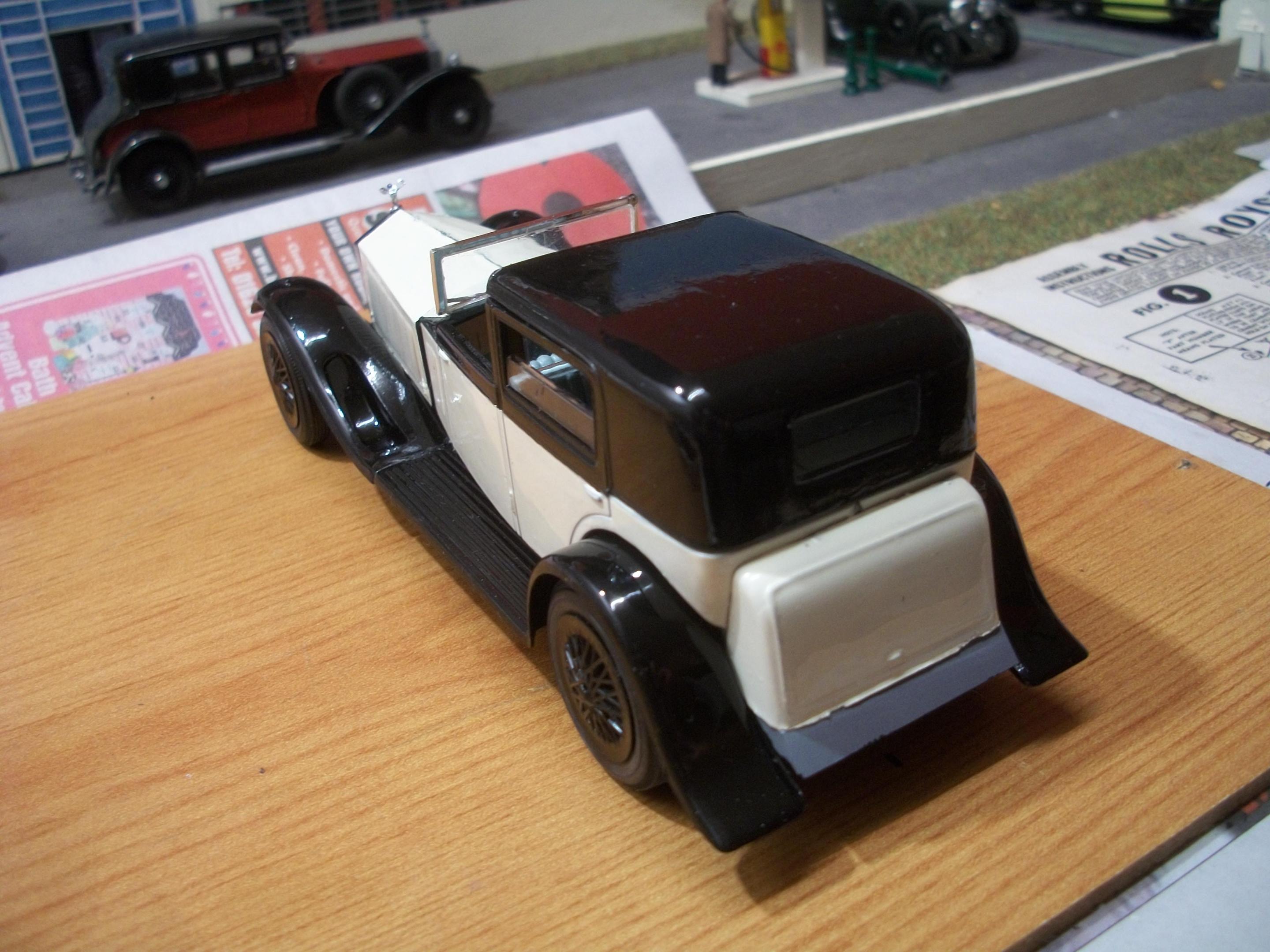

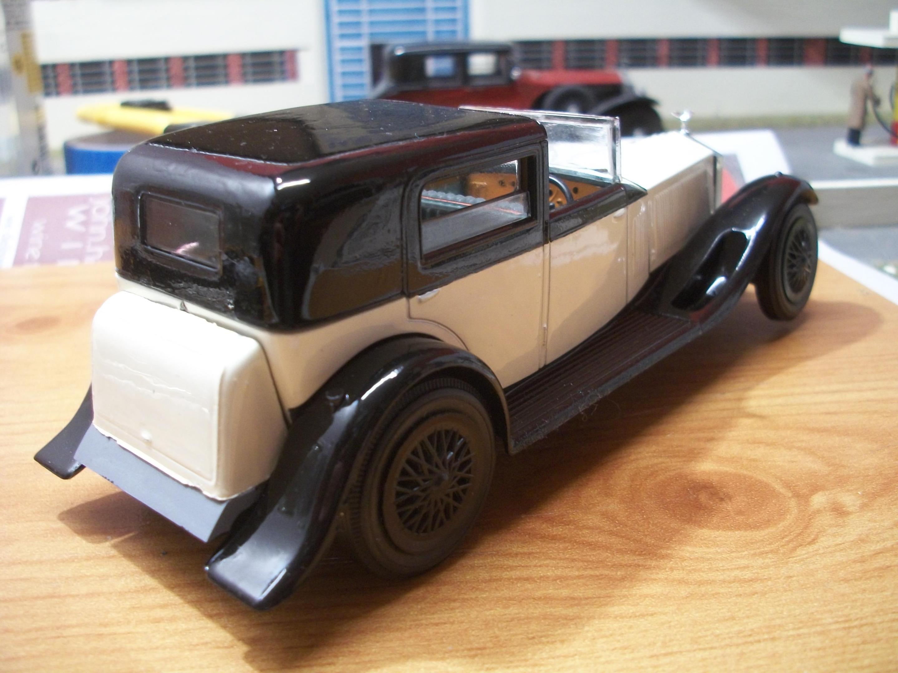

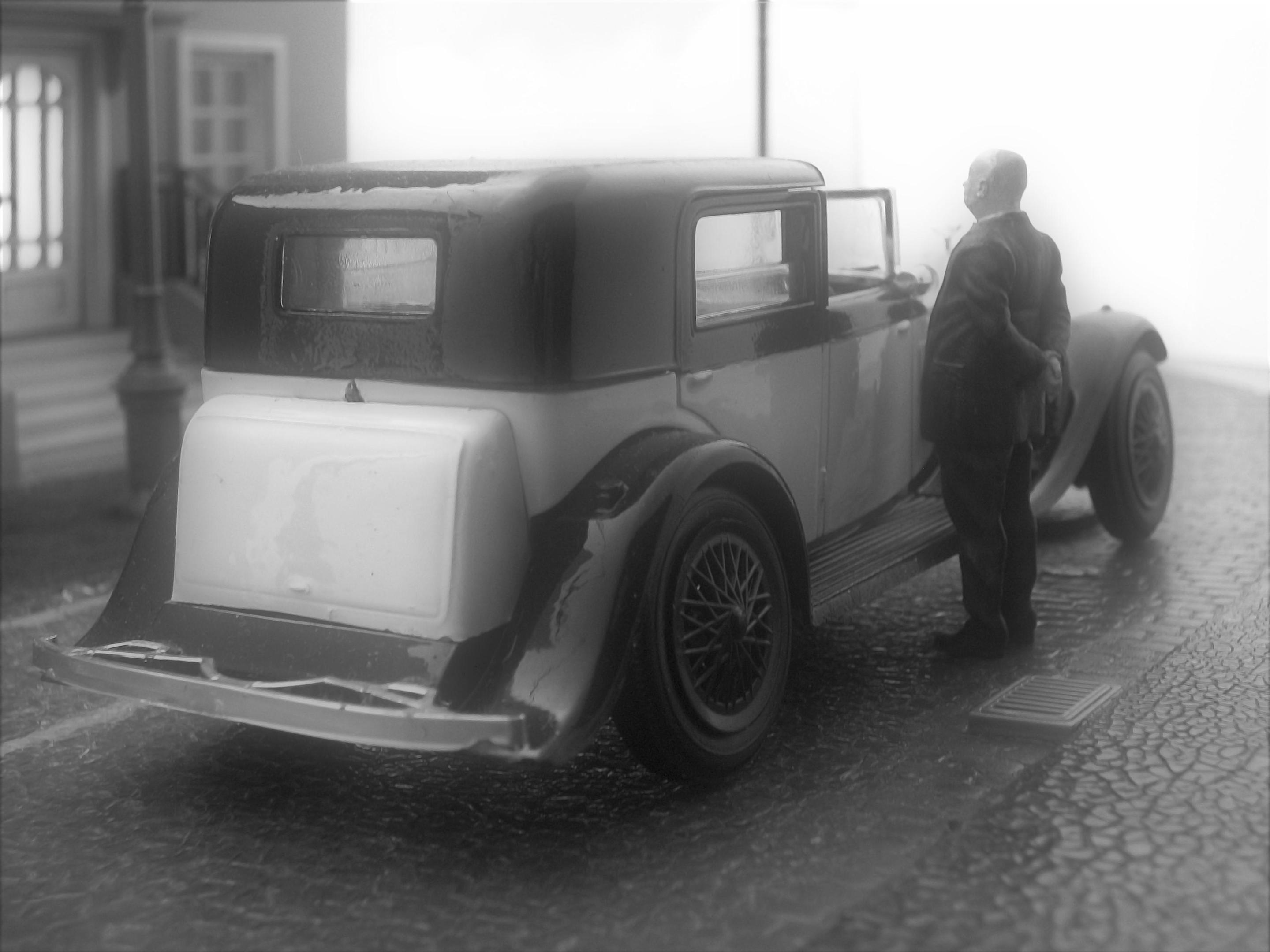

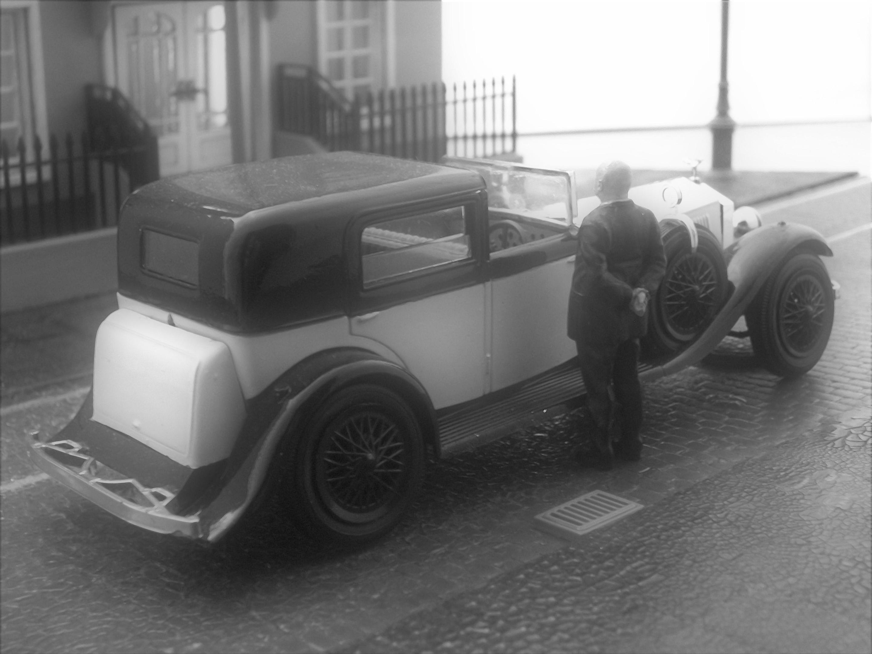

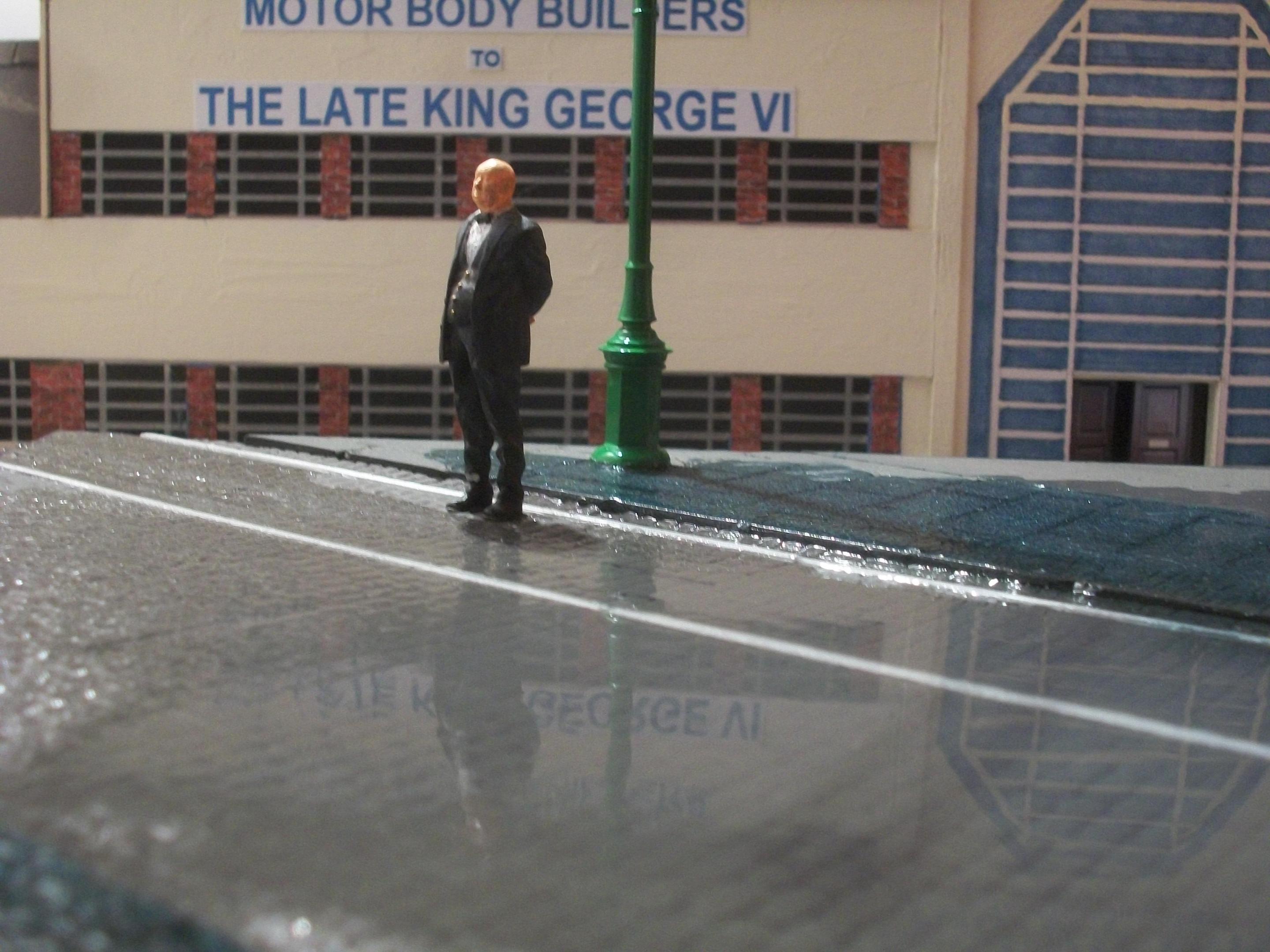

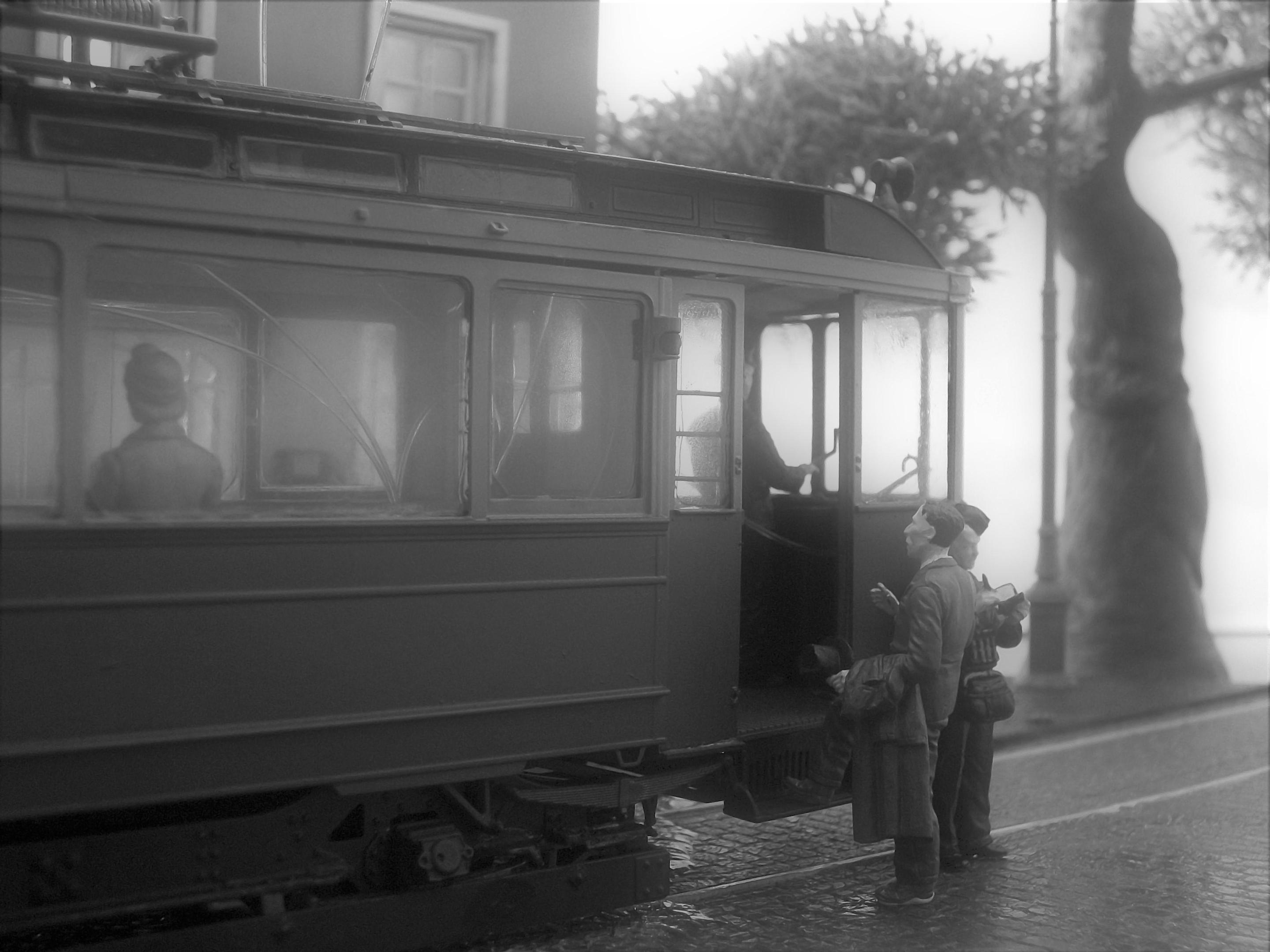

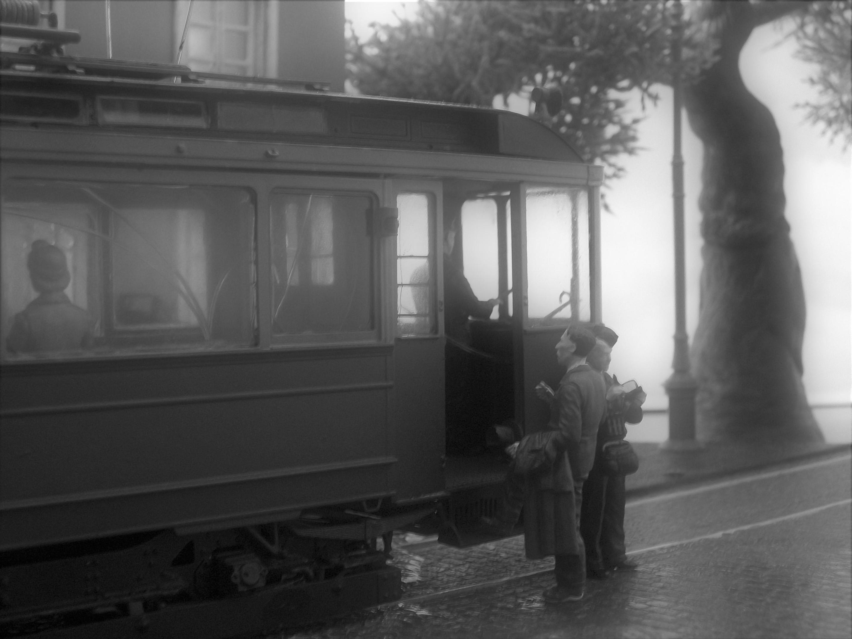

These two photograohs show the 1933 Rolls-Royce Phantom II parked on the wet cobblestone road outside the town house in Geneva, Switzerland.
This motor car model has been built from the 1:32 scale Pyro kit of 1967, and the Alfred Hitchcock figure is a 1:32 scale 3D printed figure by Shapeways.
David

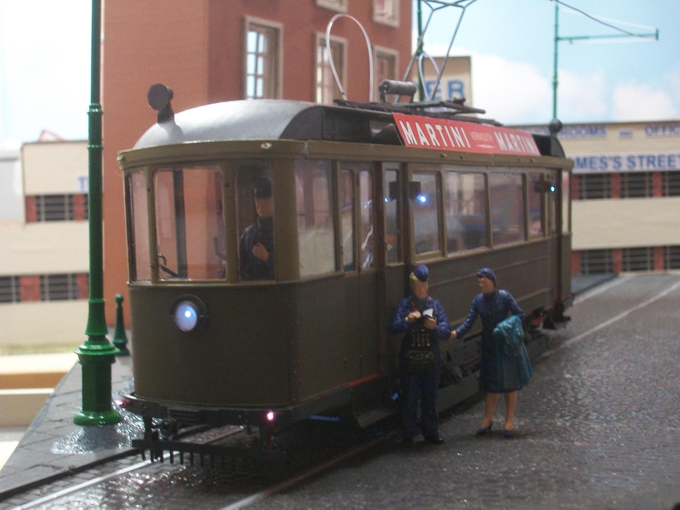

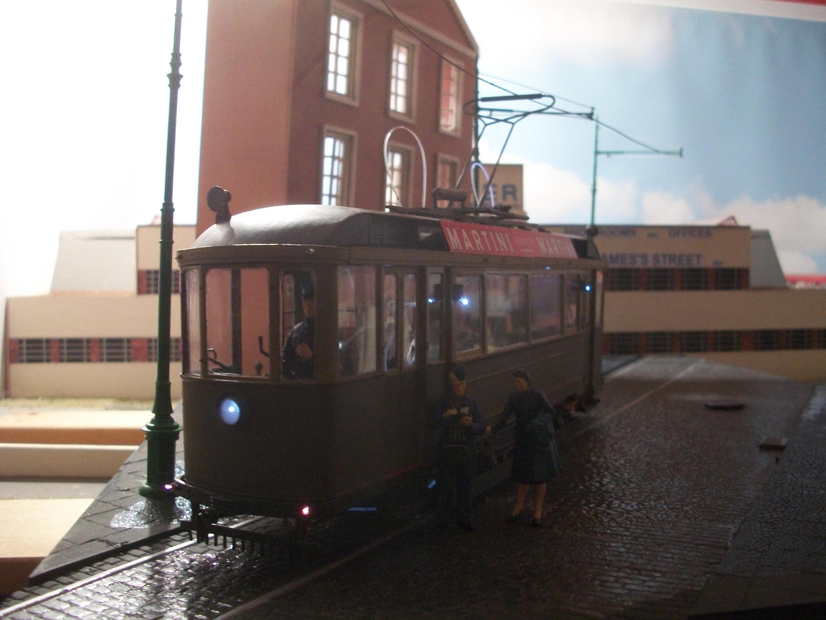

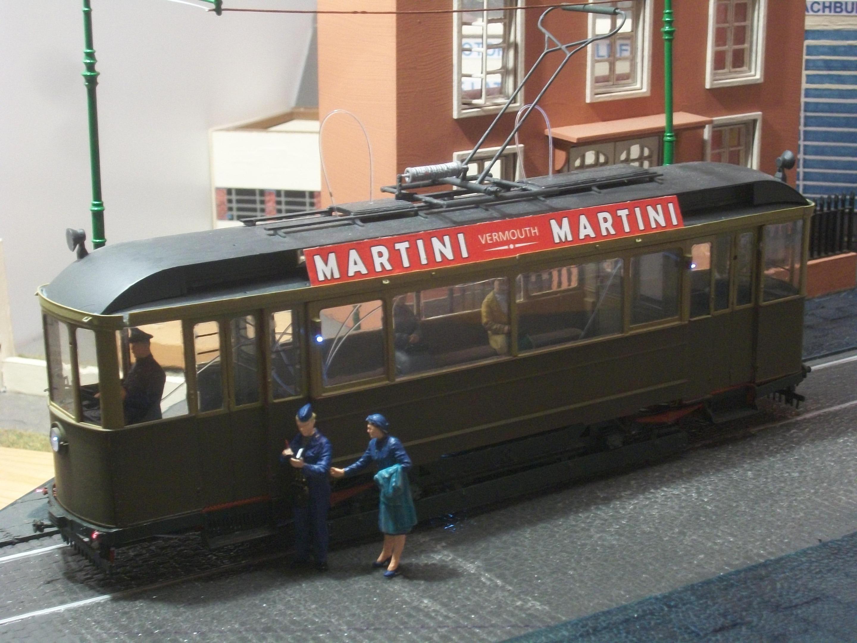

These are very artistic photos, but with all the working lights I'm wondering why the streetlight is not illuminated?
I'm also curious as to what is the loop of what seems like fishing line on the roof of the trolley?
Very observant Peter, and you have picked up on two issues in particular . . . . Please allow me to explain.
First of all, the 1:35 scale street lamps by MiniArt do not have a hollow centre to the post, whereas the 1:43 street lamps by Pico do have a hollow centre. I wanted to run a fibre optic strand up the post to the lamp at the top, but the MiniArt street lamp won't allow me to do this.
Well spotted with the ' fishing line ' objects on the roof of the tram car. Those are the fibre optic strands that are linked to an LED bulb, which is strapped to the underside of the tram car chassis. Unfortunately, those fibre optics have to be routed through the passenger area, then up through the roof, and then back down through the roof to the interior lamps. I thought about how I might disguise those fibre optic strands, such as having a standing figure inside the tram. In some of the photo shots the fibre optics are not so visible, and they can sometimes blend into their surroundings.
Thanks for pointing out these errors Peter, and I am aware that there are other errors too. This diorama is a work in progress, so there will be ongoing progress hopefully.

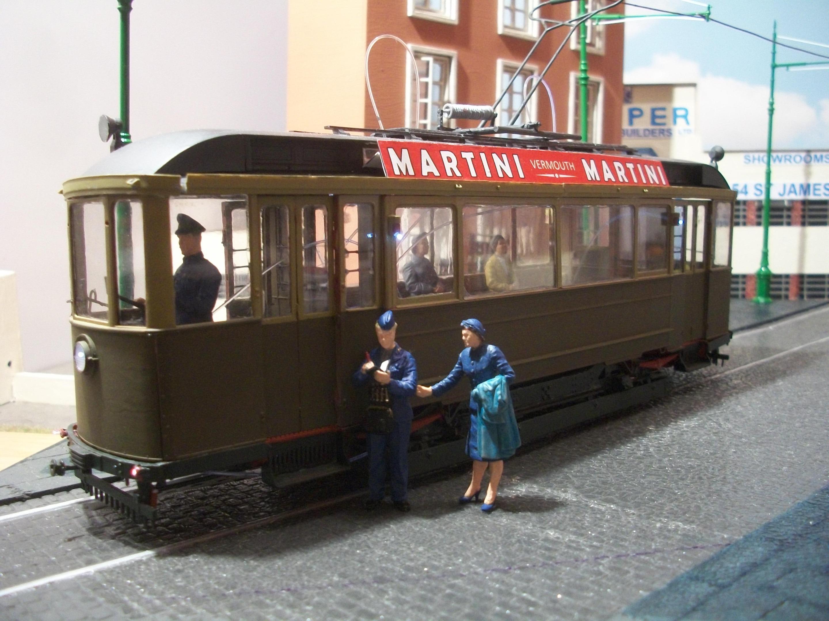

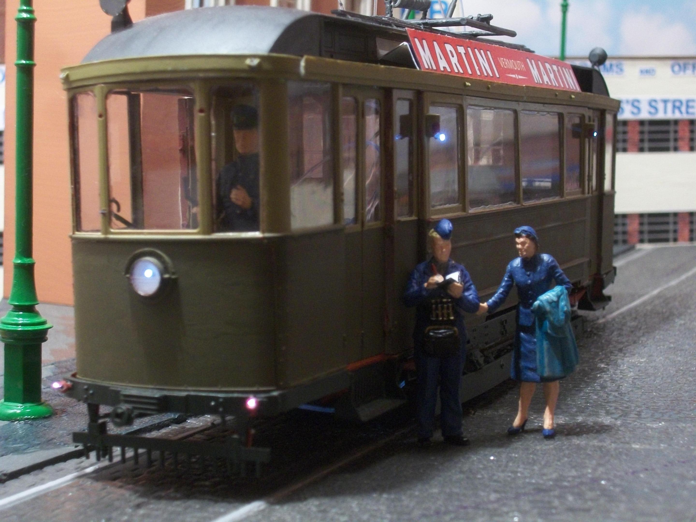

Having added a mature oak tree to the diorama composition, and also the figure of a gentleman who is boarding the tram car, here are just a couple of photos to show the other side of the tram car.
David

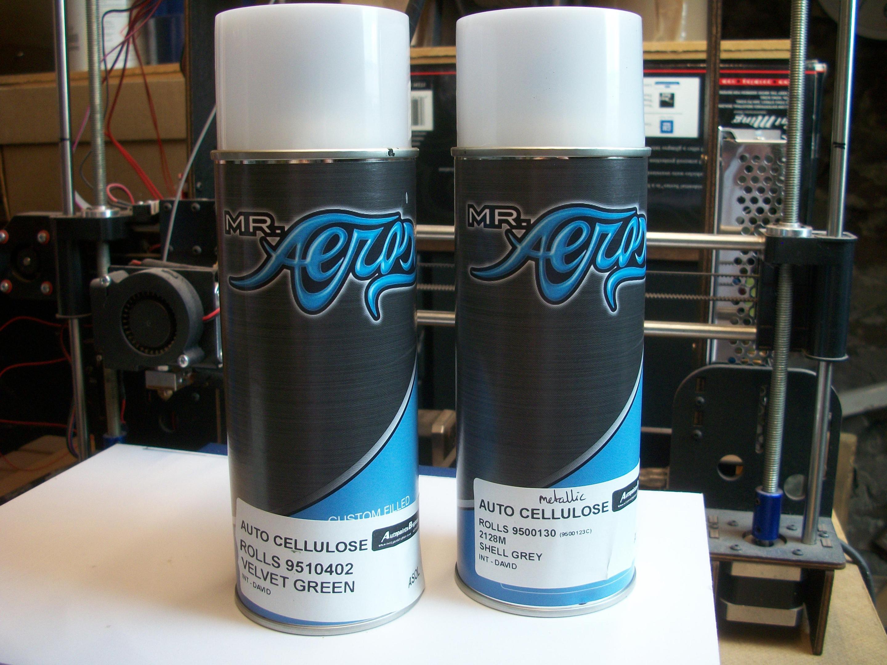

Already I have taken delivery of the two 400 ml aerosol cans of the custom mixed cellulose paints that are the chosen colours specific to this car, which is a 1958 Silver Cloud registration number VWX 1, and finished in Shell Grey (metallic) over Velvet Green . . . Currently, three different primers are undergoing tests, and these are white primer, grey primer and black primer. The kit that I am using is the 1:24 scale Revell Rolls-Royce Silver Cloud II in black styrene. This model car will have pride of place in the Hooper & Co. showroom when it is completed.

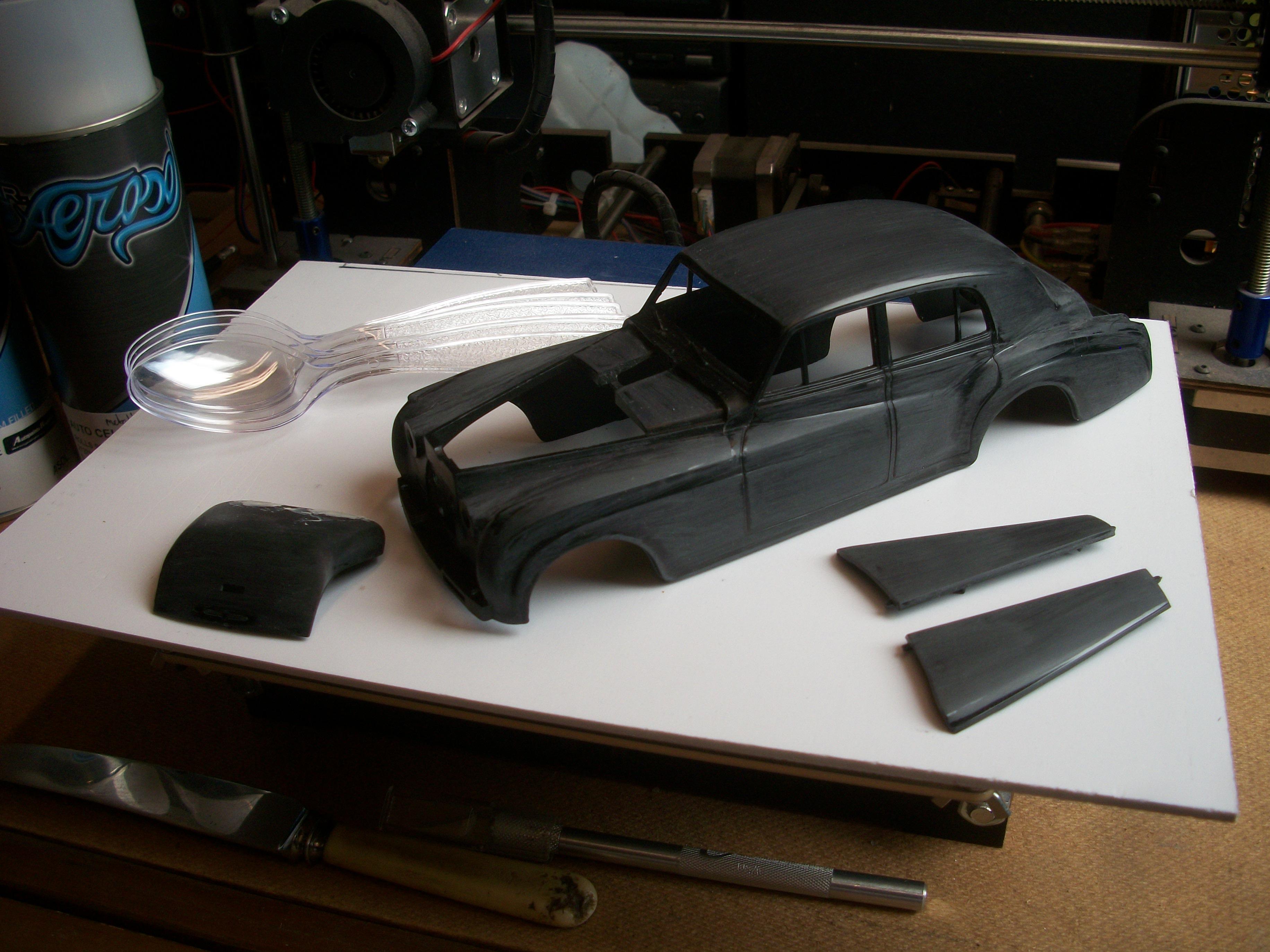

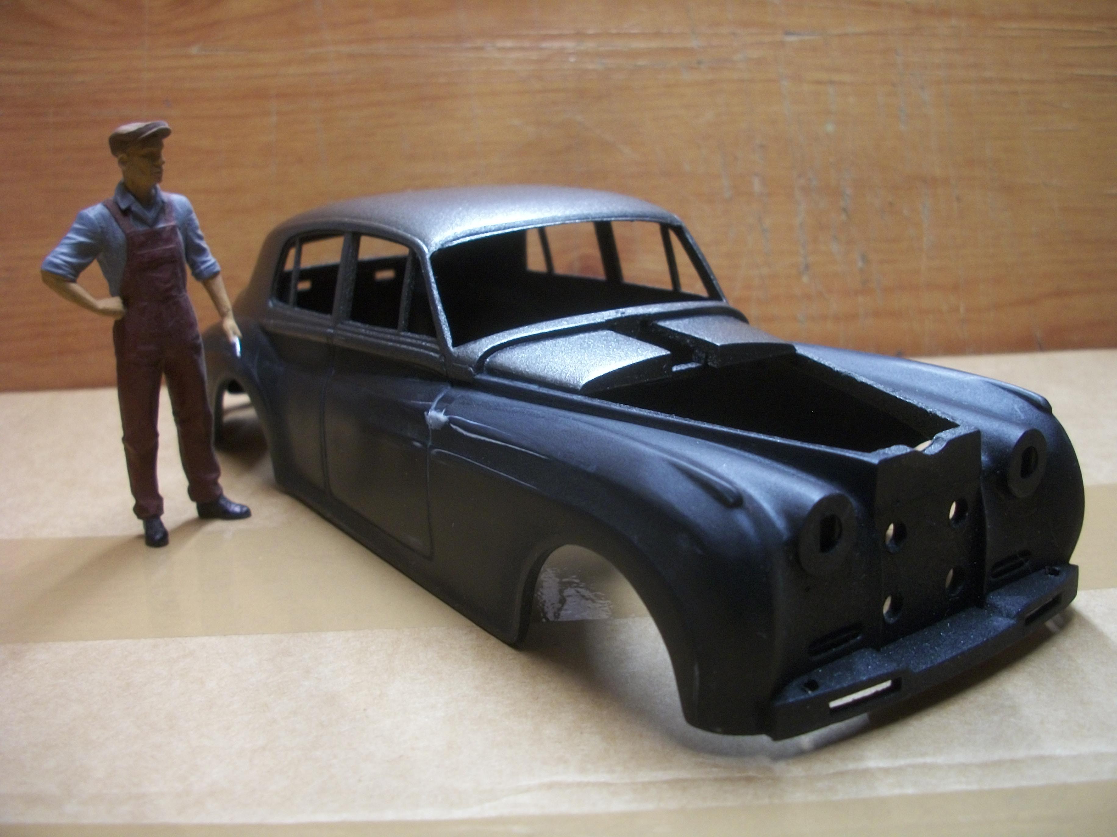

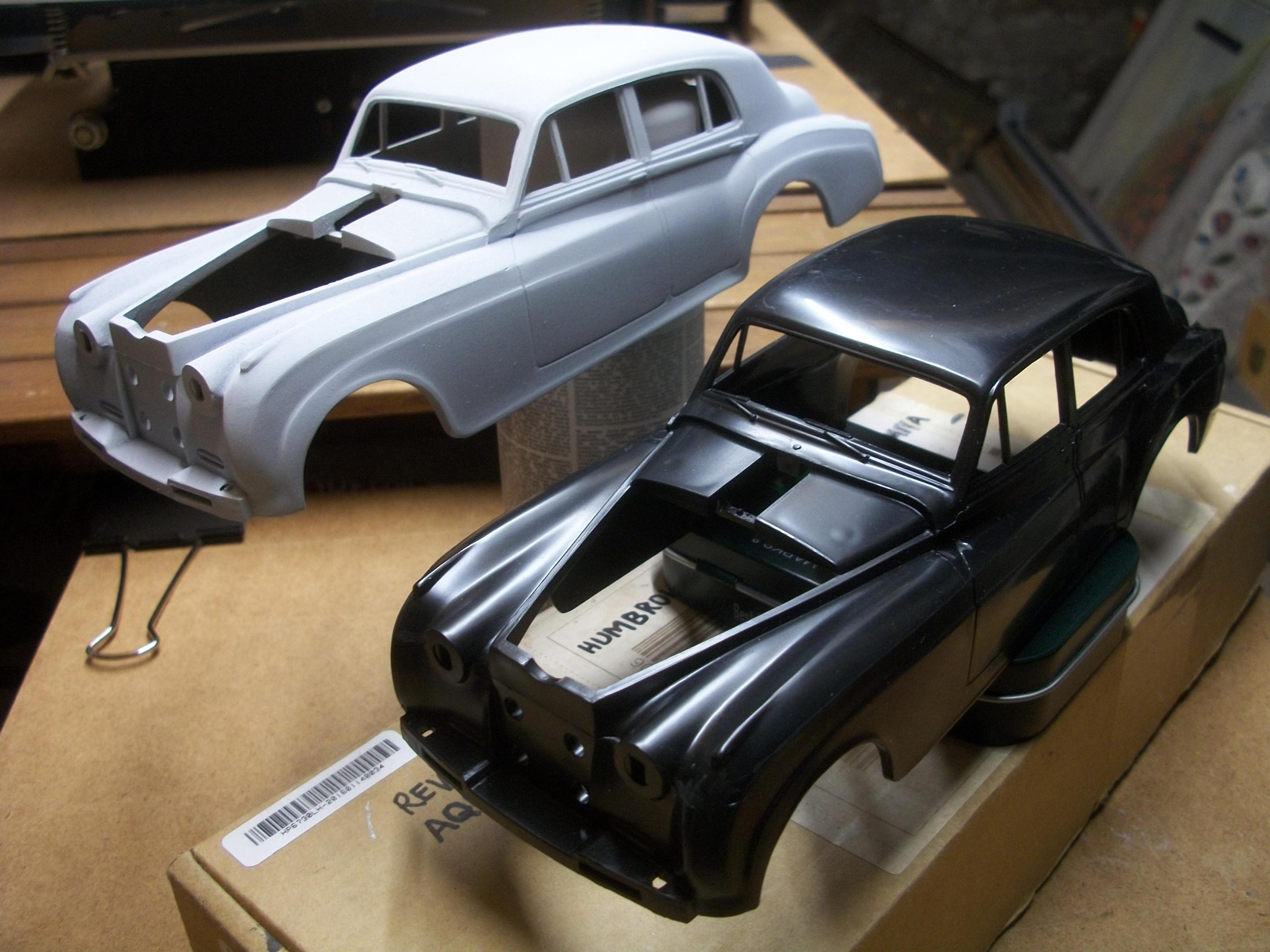

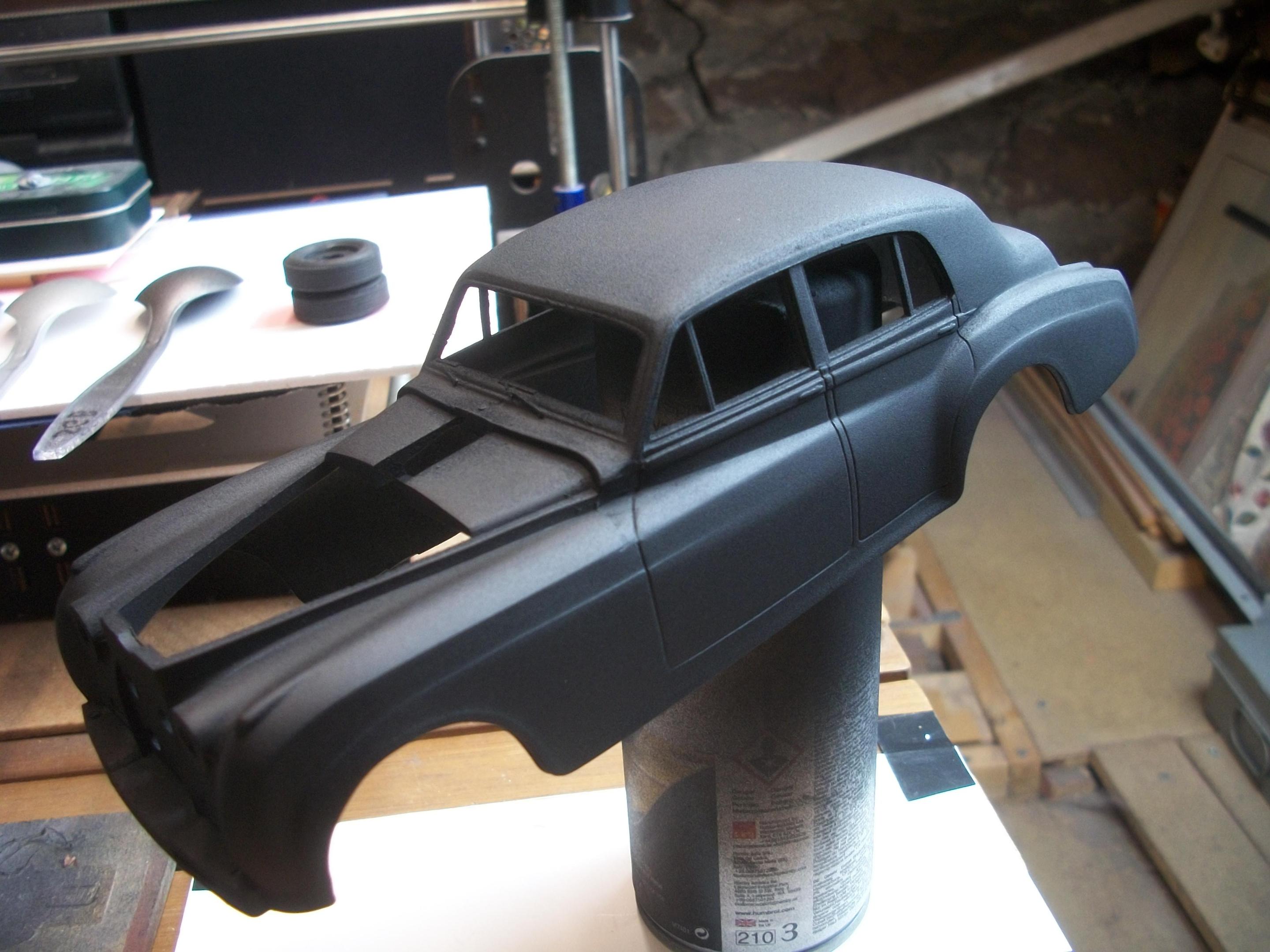

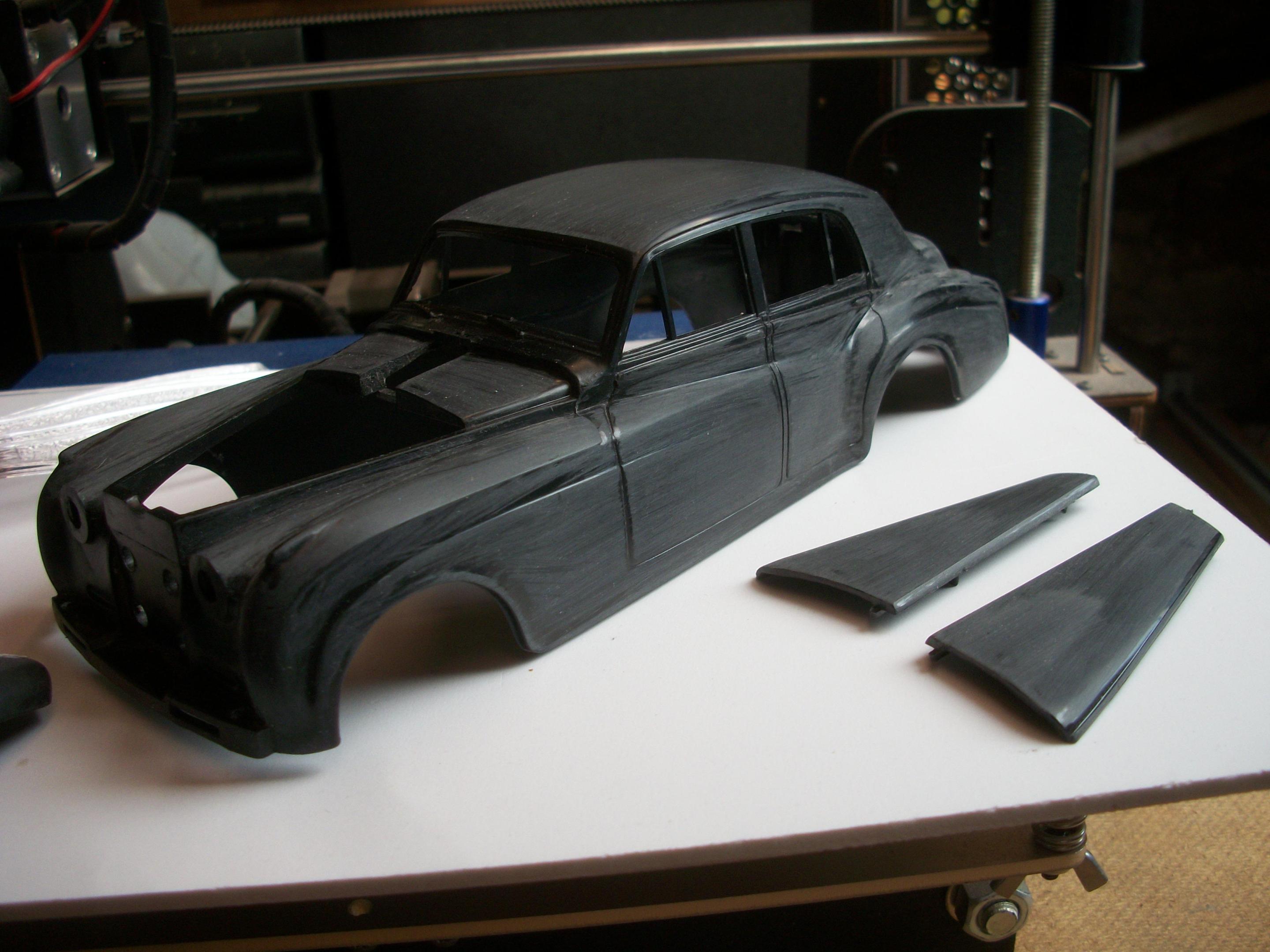

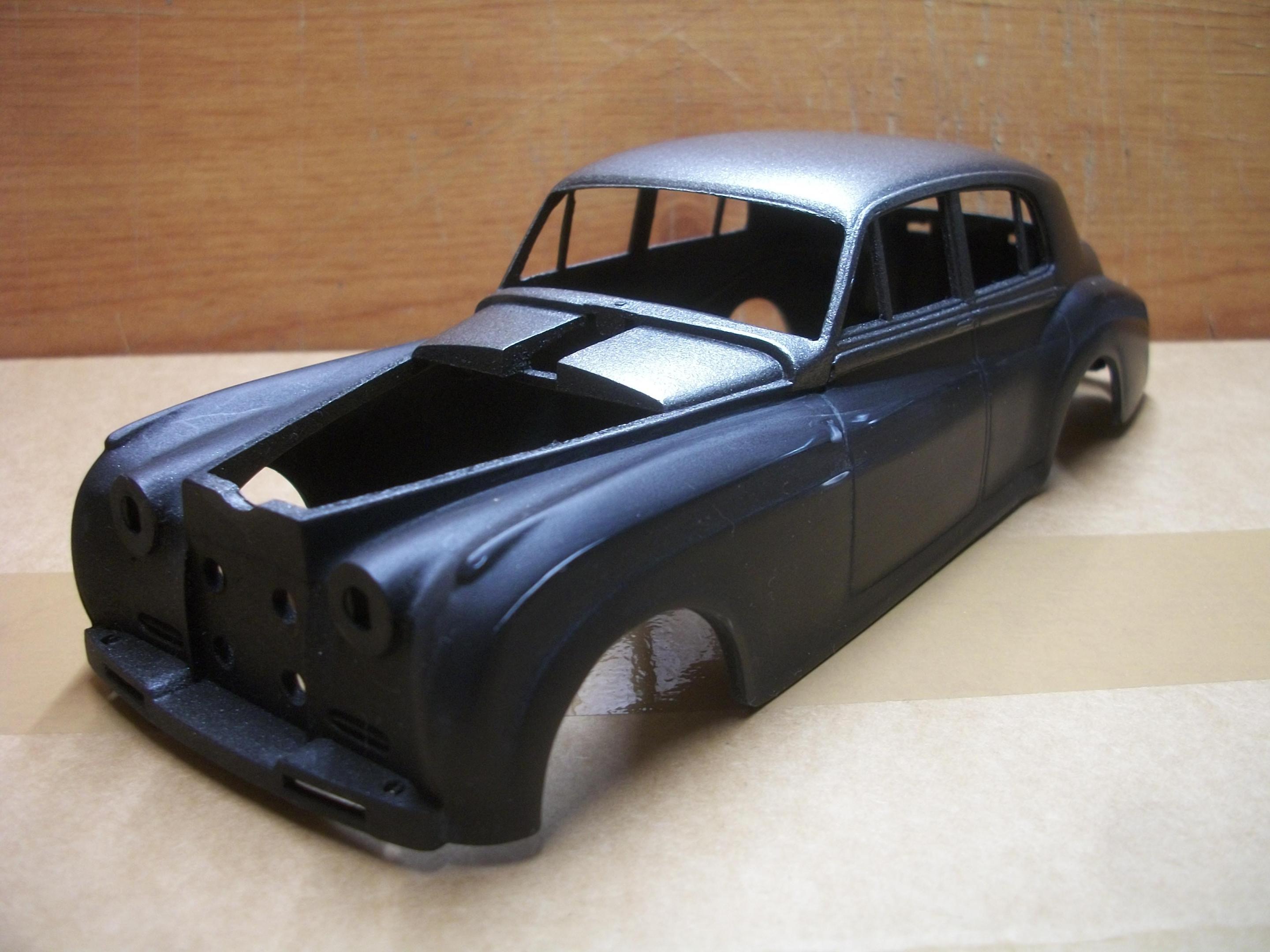

After dry sanding the body of the Rolls-Royce Silver Cloud with 600 grit, there was a single coat of Halfords white primer applied, followed by wet sanding with 1200 grit. . . I have decided to go with Plastikote black primer from this point onwards, but at this stage it was important to fit the windscreen, which will only be glued in place once all the sanding, masking and painting is completed.
The windscreen part is not the one supplied in the Minicraft kit, or the Revell kit. I am using the windscreen from a 1:24 Franklin Mint 1955 Rolls-Royce Silver Cloud I diecast model car. This seems to be the most accurately proportioned windscreen at my disposal. Several lengthy sessions of filing by hand were necessary to enlarge the opening of the body to allow the Franklin Mint screen to fit properly. While Minicraft and Revell expect you to insert the windscreen from the inside of the body, I am of the opinion that the screen should be inserted from outside the body, just as it would be on the real full size car.
Over the next few days there will be further wet sanding of the body parts, including the boot lid and bonnet (hood) panels, and continued application of the Plastikote black primer, with more wet sanding with 2000 grit. The grey styrene parts in the Revell kit that need to be chromed will have a coat of black primer, followed by a coat of yacht varnish brushed on, and then Molotow Liquid Chrome will be airbrushed over the varnish from a 30 ml refill. The liquid chrome pen tends to leave the odd streak here and there, so I shall try airbrushing this time around.
David

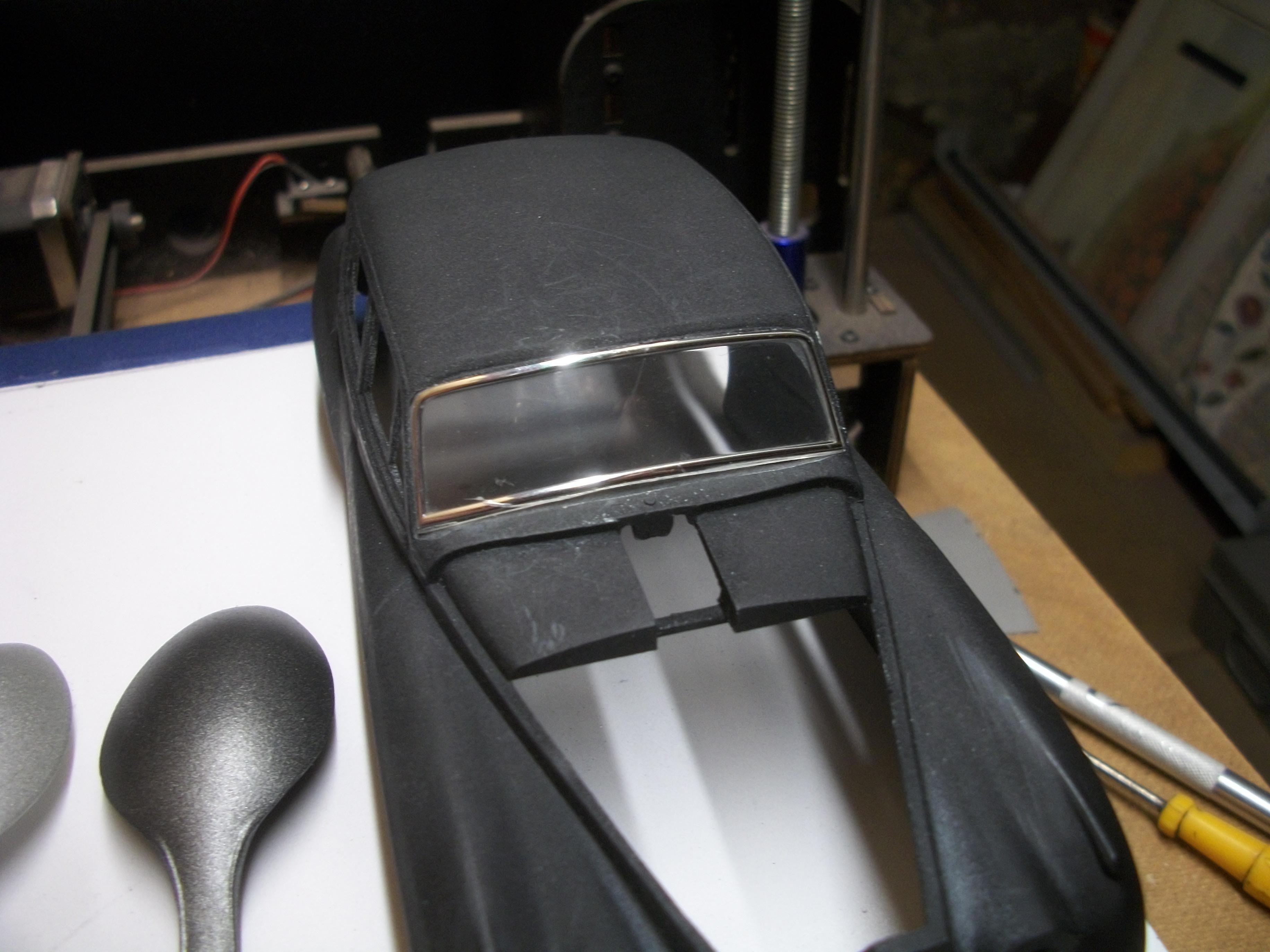

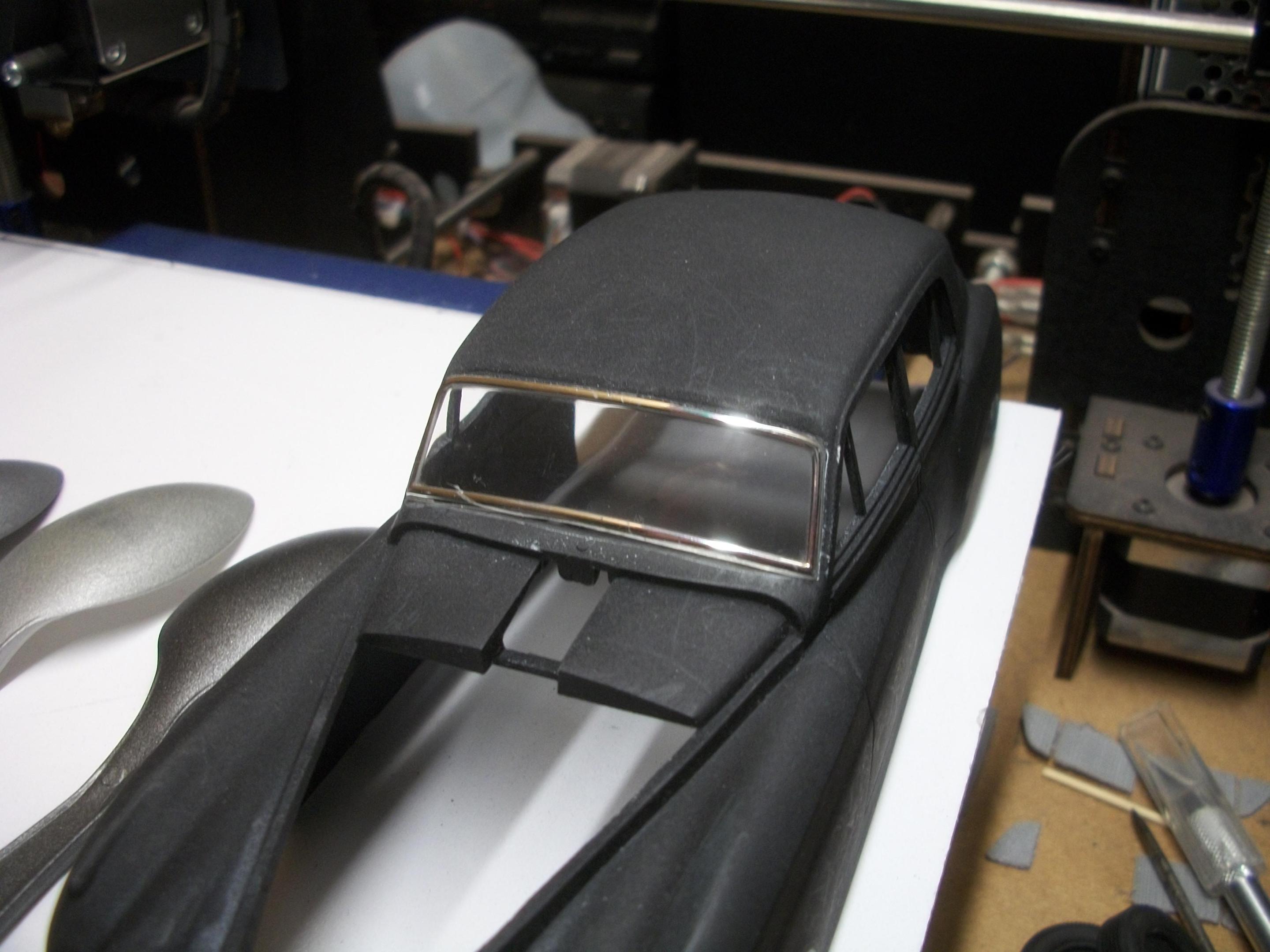

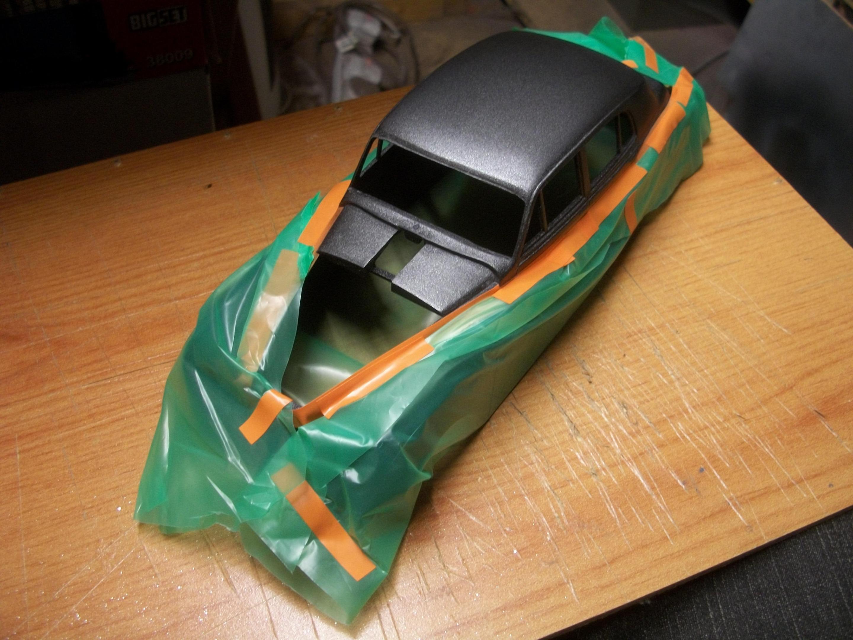

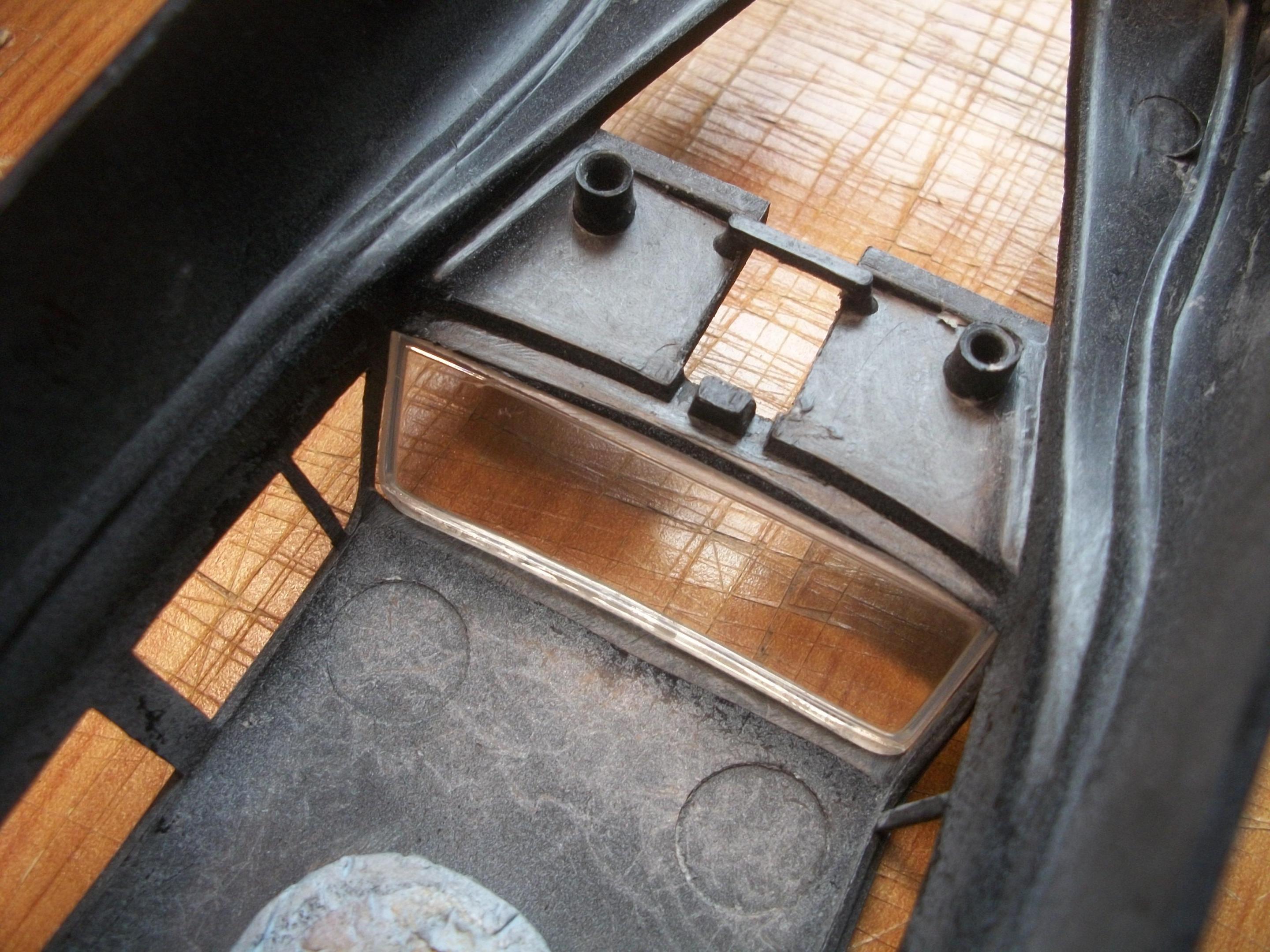

One of the following photos shows the windscreen of the Rolls-Royce Silver Cloud from the inside of the body, and this has turned out to be quite a nice fit.

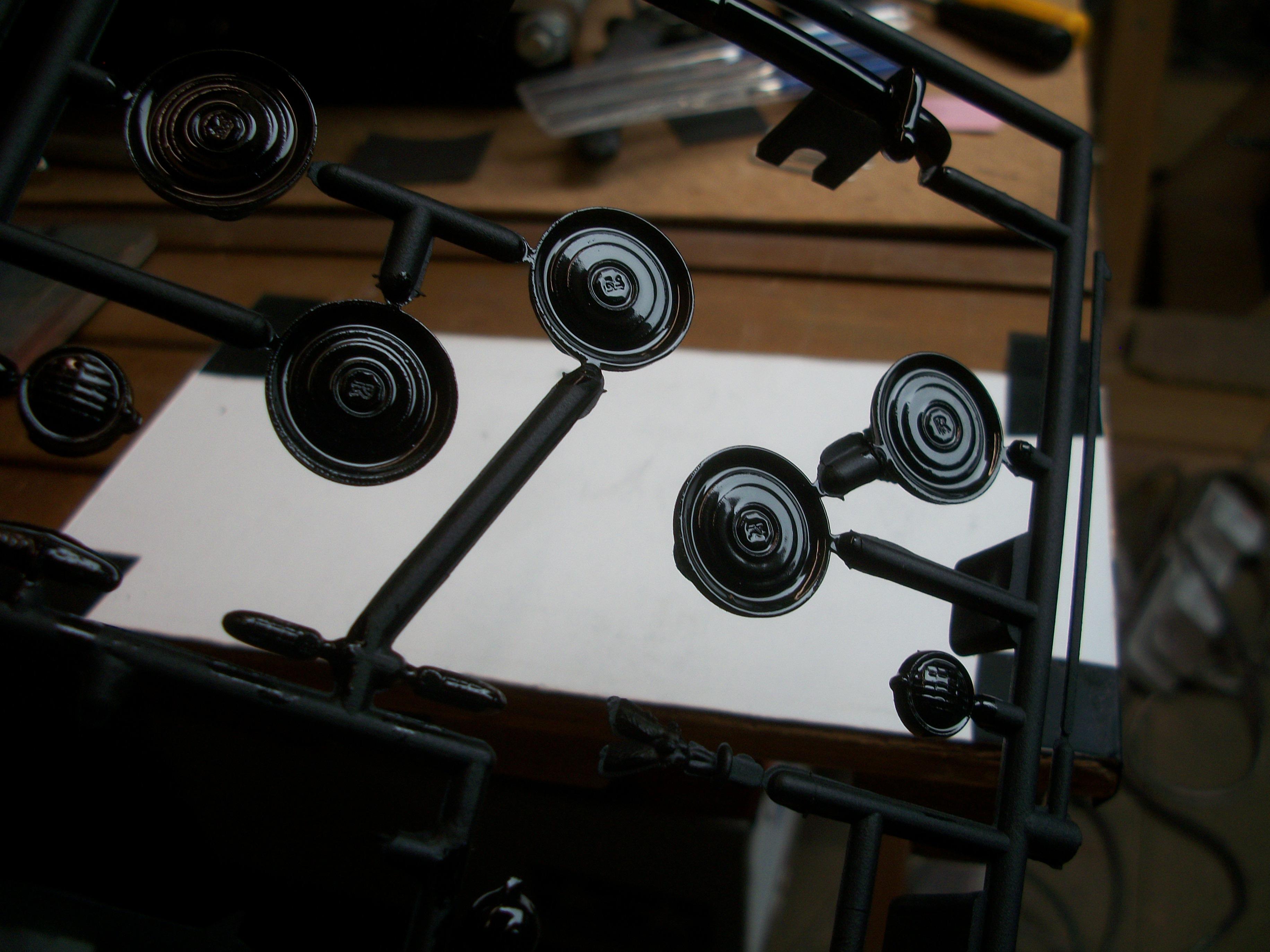

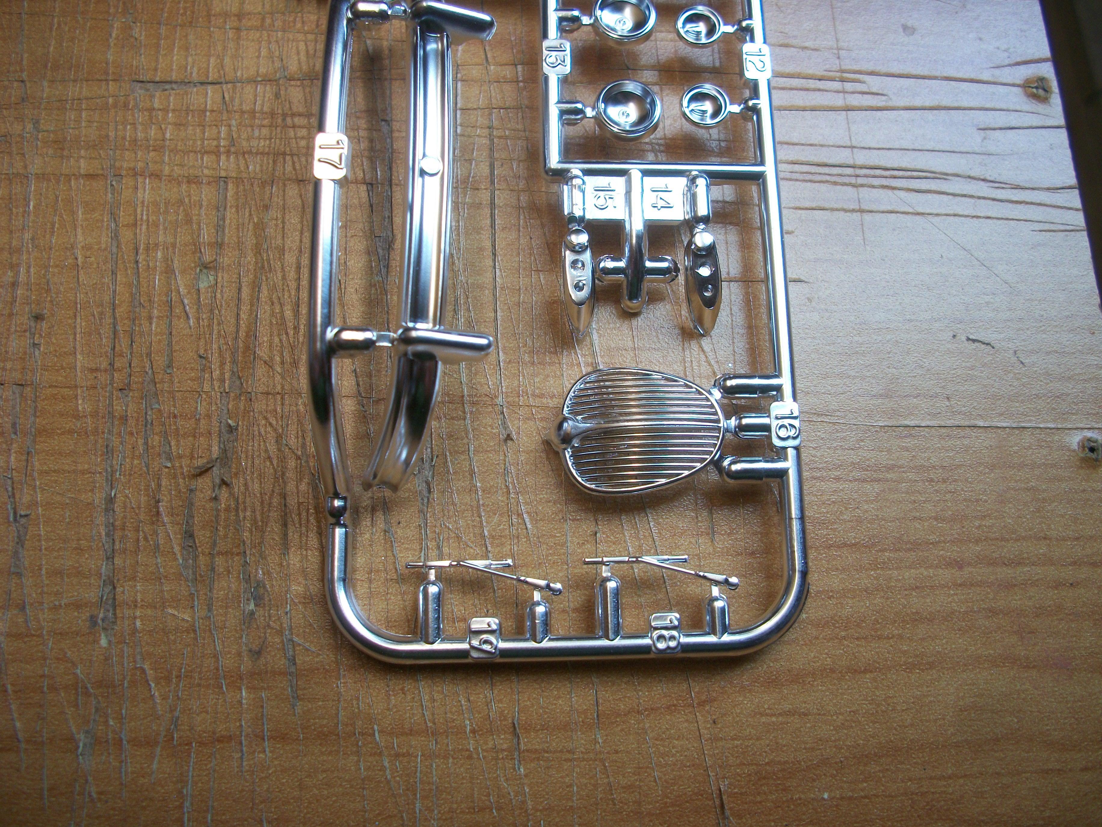

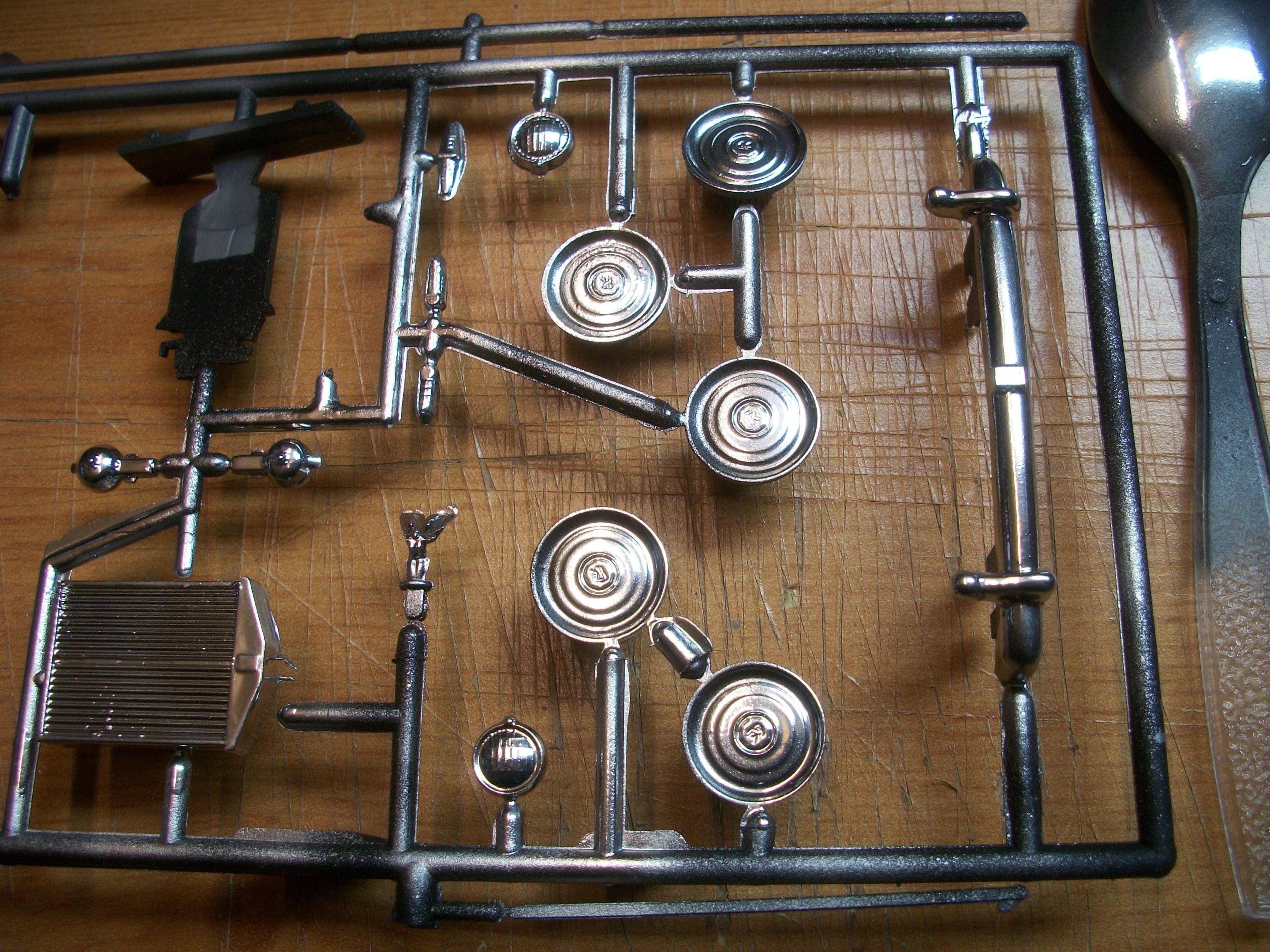

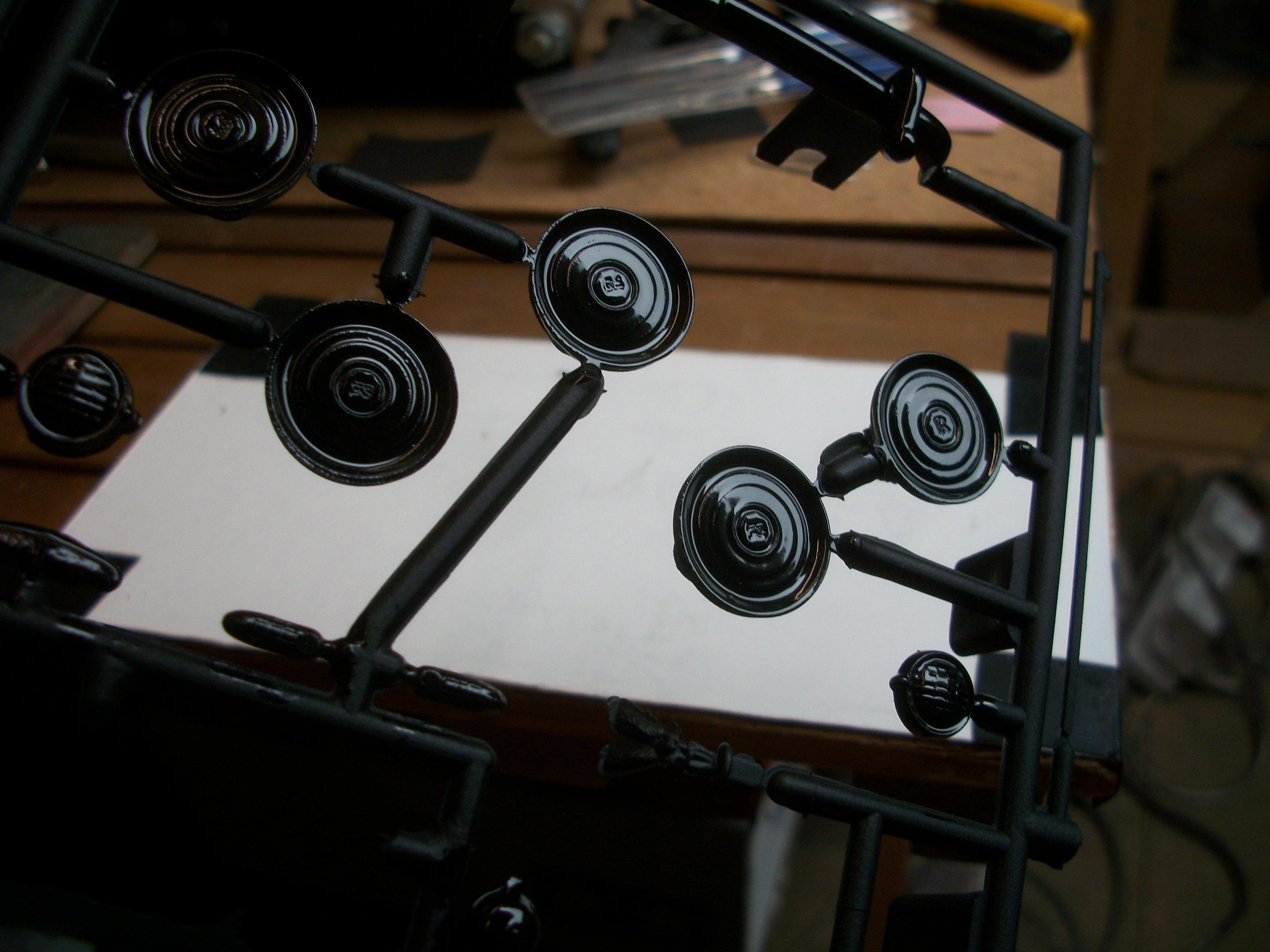

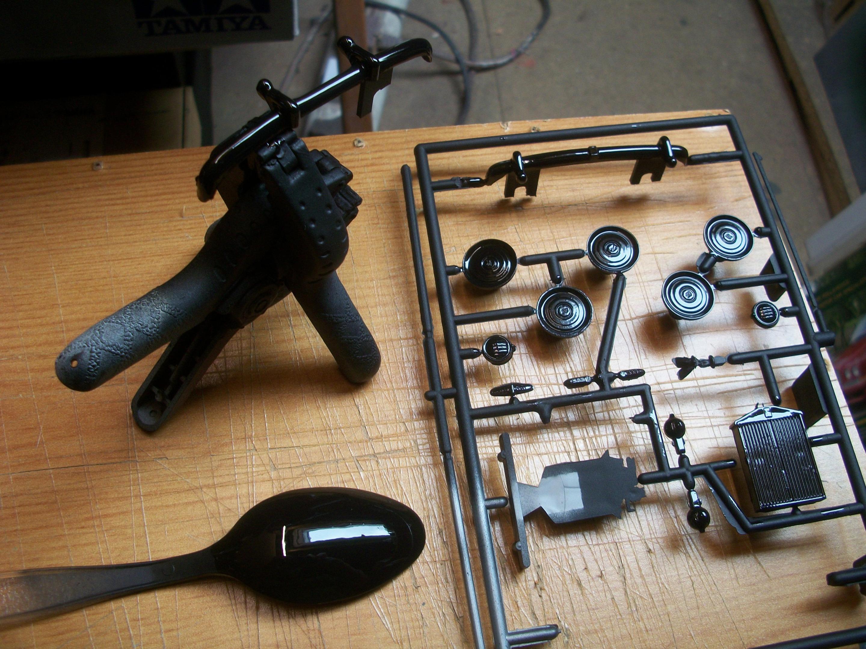

All of the grey styrene parts that need to be chromed, now have a coat of Plastikote Black Primer, as well as a coat of Yacht Varnish.
The Molotow Liquid Chrome from a 30 ml refill will be applied by airbrush, over the high gloss black surface of the parts.
Picked up some Tamiya Polishing Compound on Ebay, which is three 22 ml packs of Coarse, Fine and Finish grades.
The polishing compound will be used over the top coats of cellulose paint, which is two-tone Shell Grey (metallic) over Velvet Green.
Thanks for reading my posts on this topic guys . . . slow and steady is the way to go here !
David

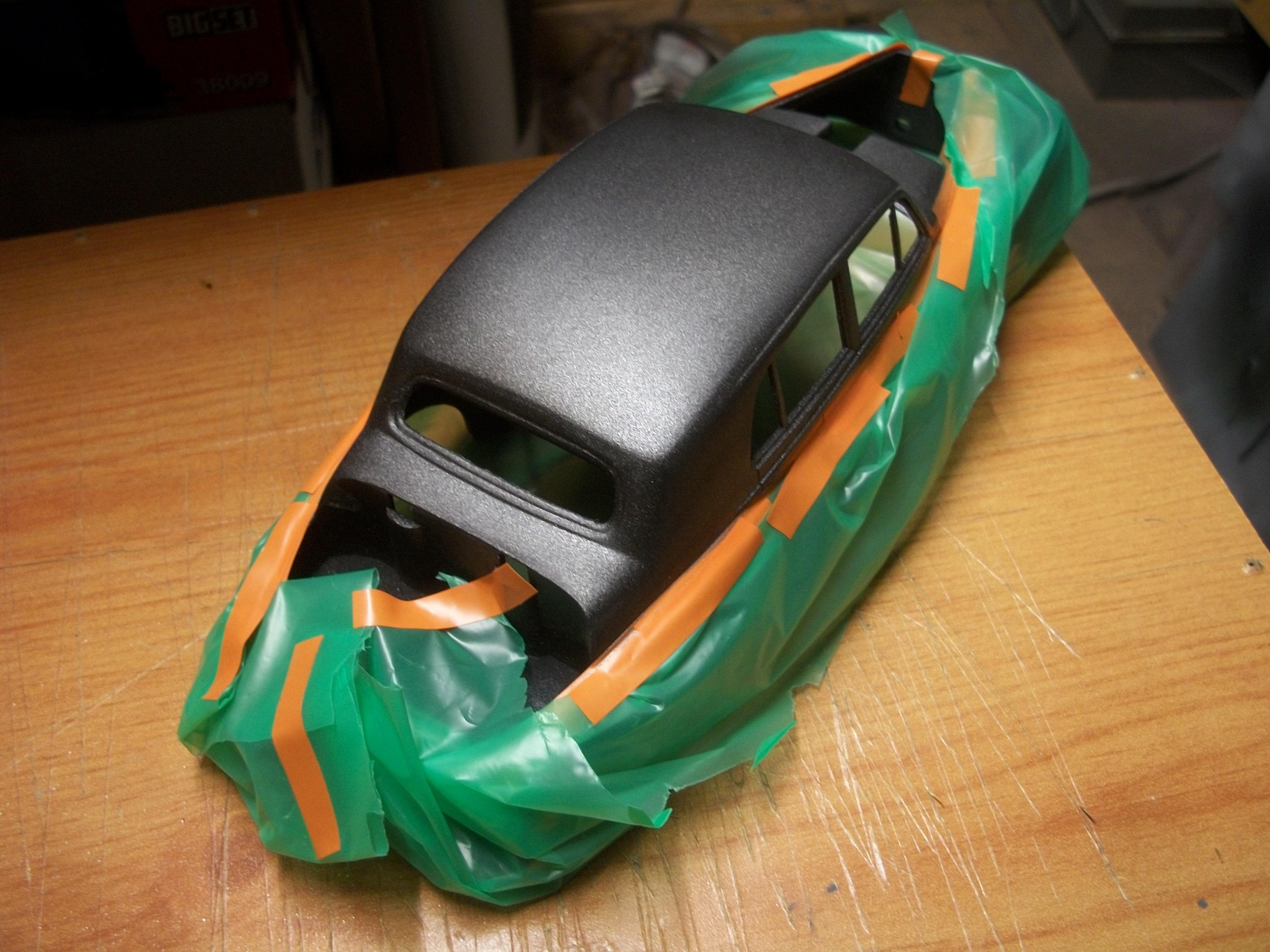

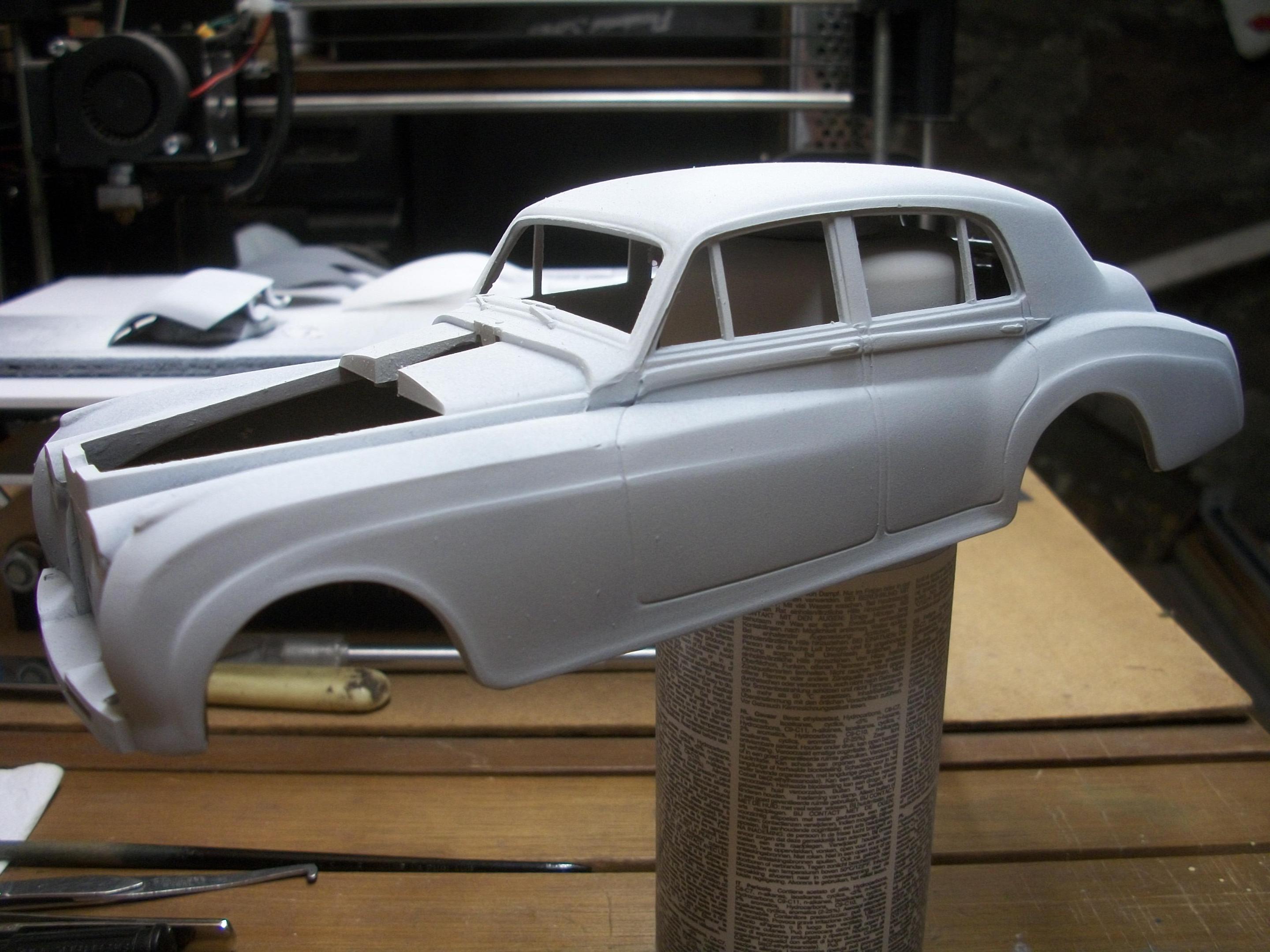

I have been quite busy with all sorts of things over the past week, but I am pleased to say that the progress with the Rolls-Royce build is nice and steady.
The chrome parts that were airbrushed look really good, and I shall leave these untouched for the full two weeks. I have painted the dashboard in a ' burr walnut ' mix over black primer, and this will be coated with yacht varnish later. The body parts had a final wet sanding with 2000 grit before applying one coat of the Rolls-Royce Shell Grey on the upper body, boot lid and bonnet panels, with the lower body masked off.
Following 48 hours drying, the Shell Grey has been wet sanded with 2000 grit, and is now ready for a second coat of Shell Grey . . . This procedure will be repeated for the lower half of the body, in Velvet Green.
Probably after around 5 days the body parts will have Tamiya Polishing Compound applied, following the three stage process of Coarse, Fine and Finish grades.
I intend to use the wiper arms and blades from a Tamiya kit of the Jaguar MK 2 for the Silver Cloud windscreen. These are nice quality chrome, and appear identical to the Rolls-Royce wipers. Certainly this will be a big improvement on the moulded wipers that were on the Revell body.
The Autopaints of Brighton Shell Grey is clearly more accurate than the Zero Paints from Hiroboy, but then I am using an entirely different procedure for applying the paint this time.

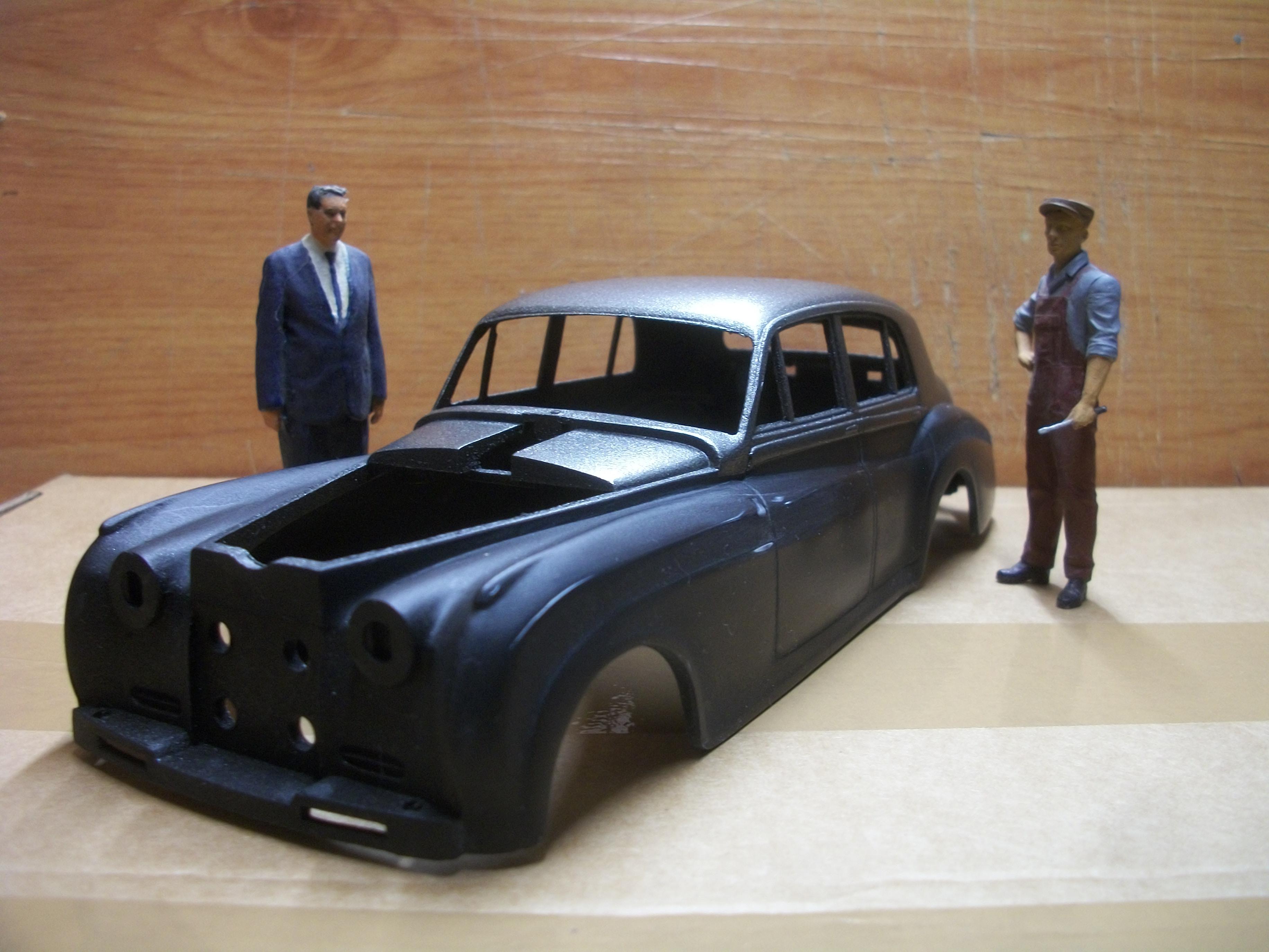

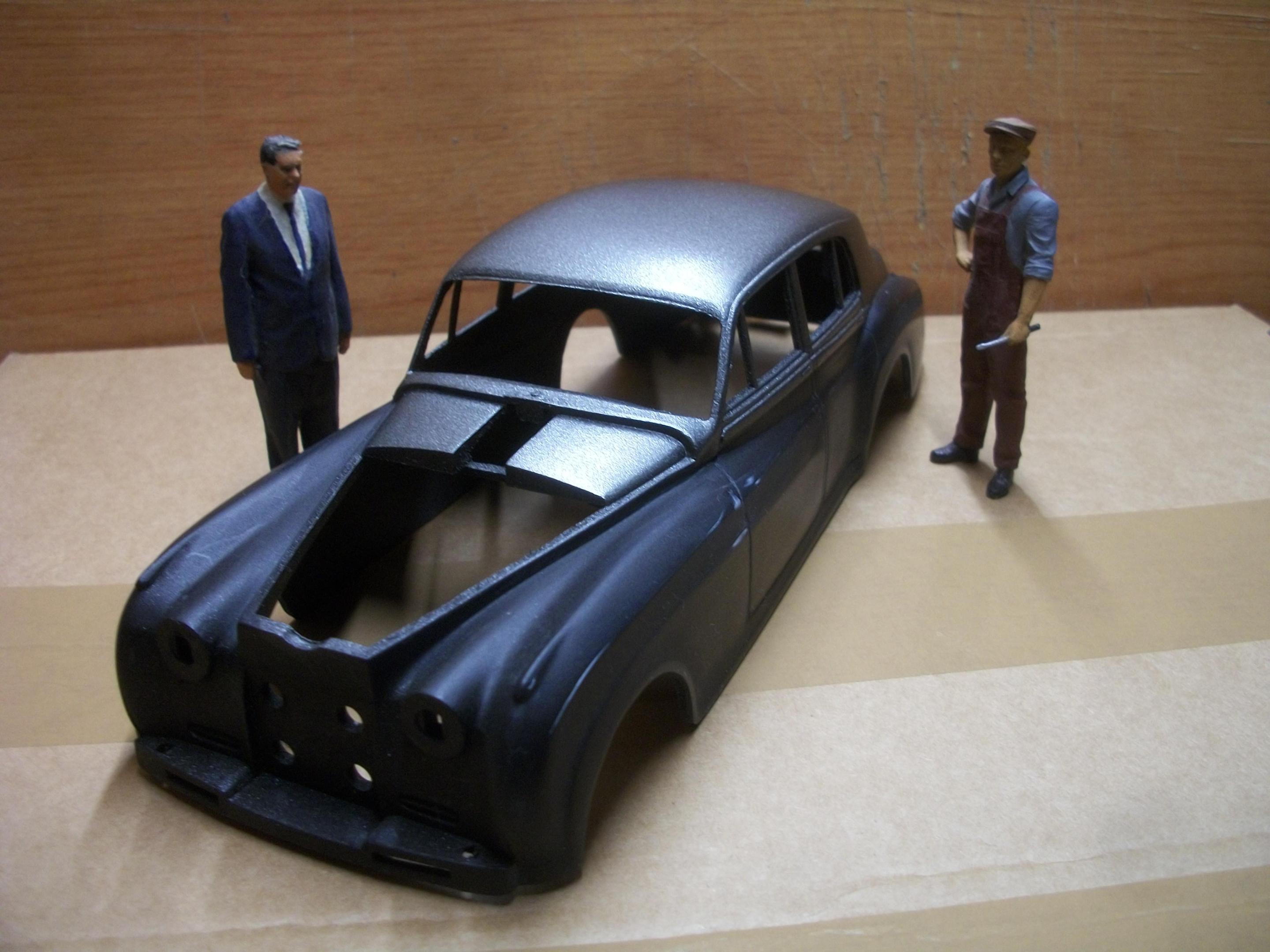

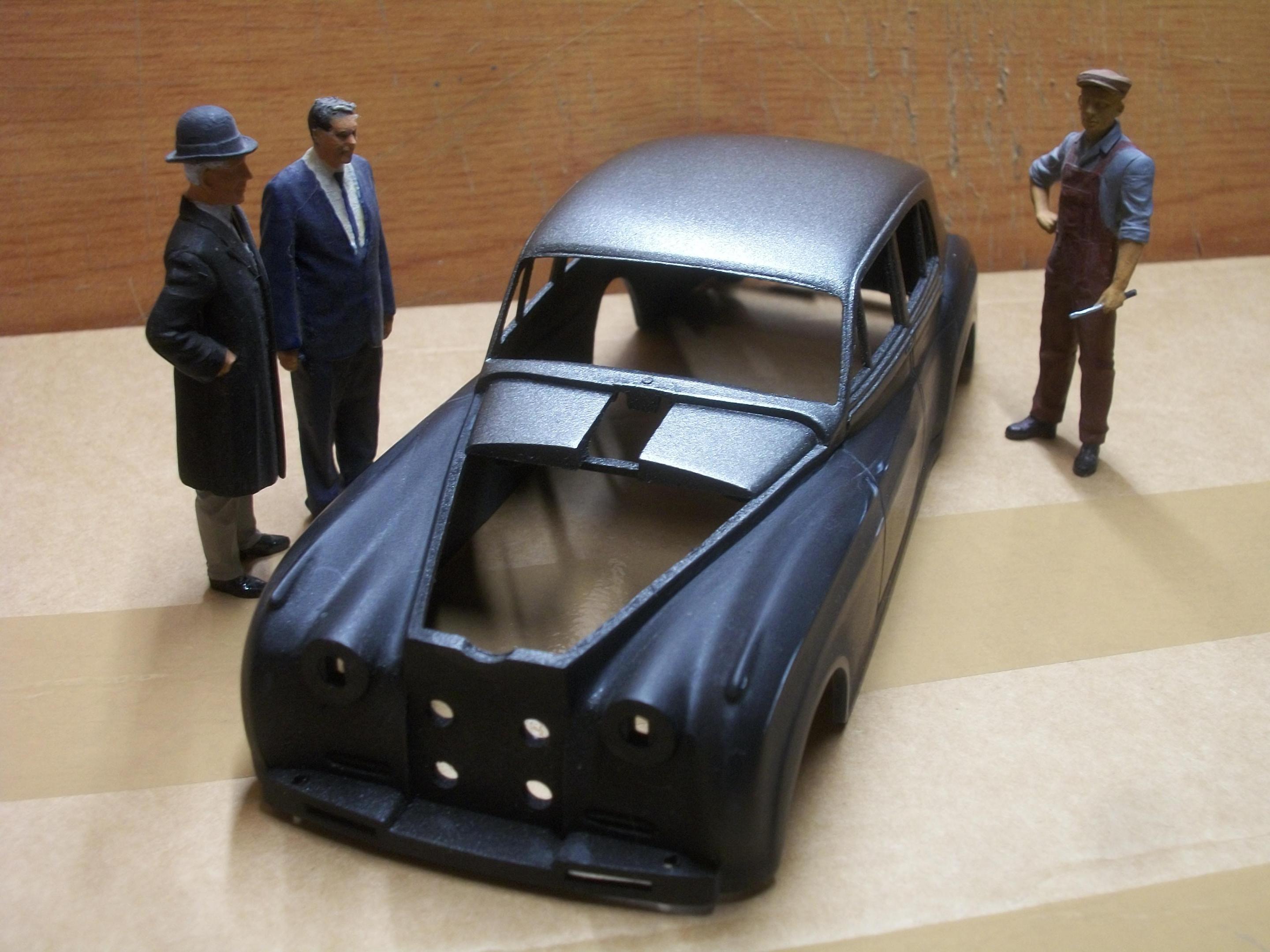

Over in the bodyshop at Hooper & Co., the second coat of Rolls-Royce Shell Grey has been applied to the upper body of the Silver Cloud.
One of the bodyshop workmen and two of the managers are checking on the progress of the building of this fine motor car.
The paint finish at this stage will be allowed to dry and cure for a further five days, before the polishing stage begins.
Presently, the lower body is still in black primer, and ready for the top coats of Velvet Green.
