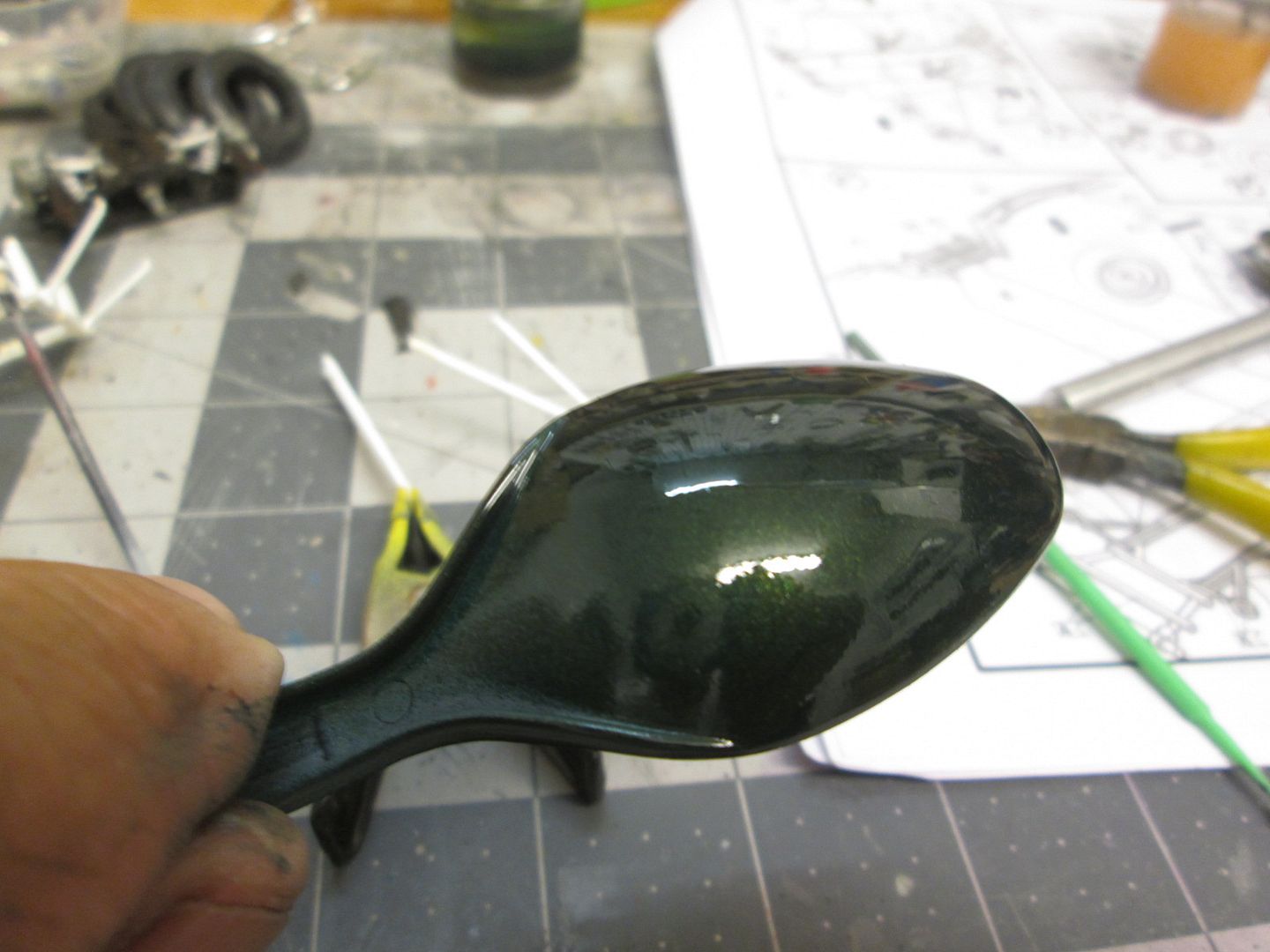

Dave Ambrose Posted October 4, 2017 Posted October 4, 2017 Unfortunately,the closest bottle is 500 miles away. I should have ordered some along with it. I do have some of the Metalizer thinner though. Probably a different formulation. What about mineral spirits?You must be way north. Good quality mineral spirits are a decent second choice. The ModelMaster thinner is high-quality mineral spirits. We have higher temperatures and lower humidity, so the slower drying time helps me a lot. Metalizer is a lacquer. You can also use lacquer thinner, or better yet, Xylene. Both are available at your local hardware store. Given your location, something that evaporates faster is probably better, so I would certainly try lacquer thinner. Whatever you do, test it on a plastic spoon first.
