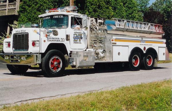

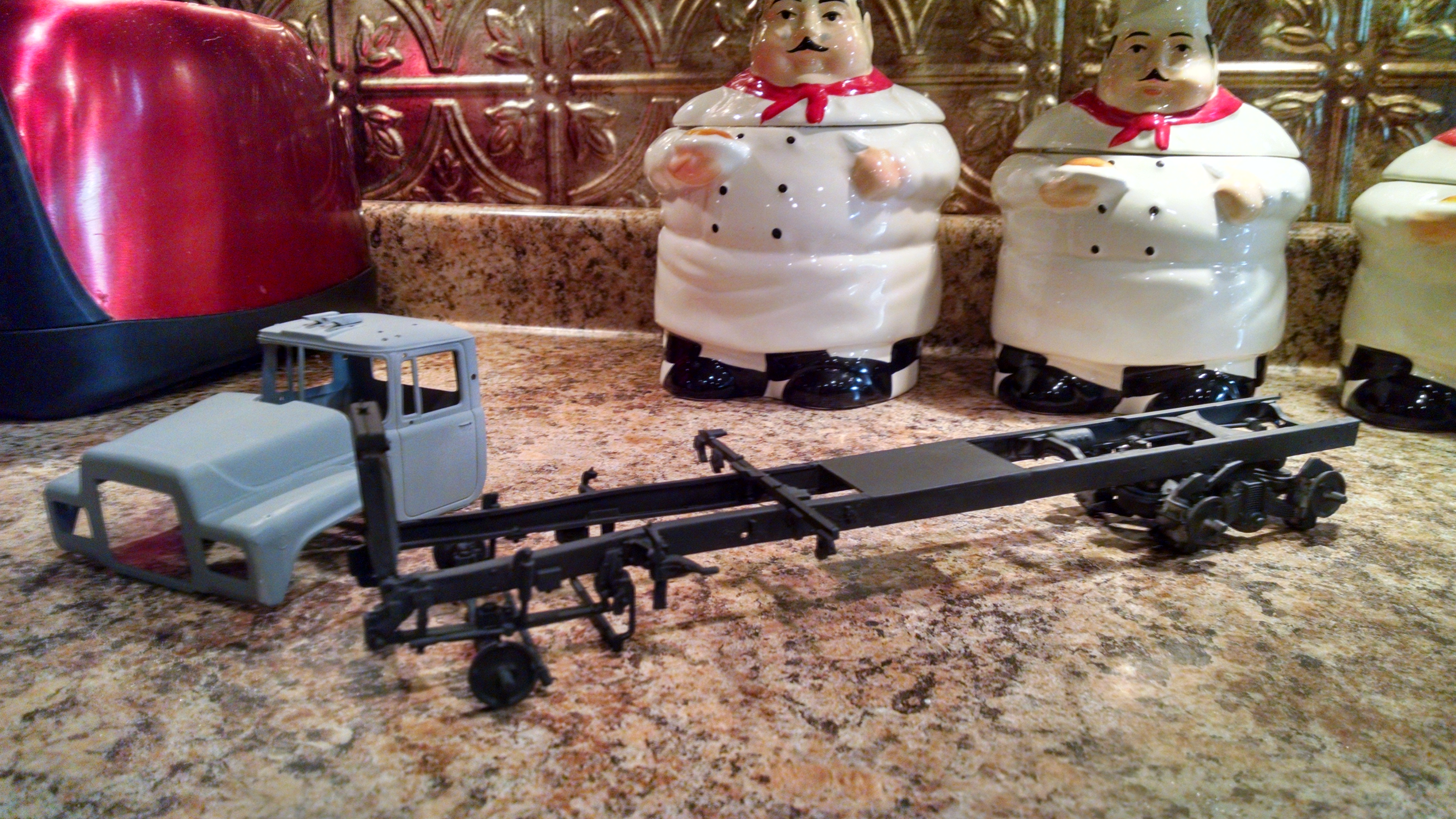

towman1271 Posted October 15, 2017 Posted October 15, 2017 (edited) With the rerelease of the R-Model Mack, I've decided to replicate the Engine Tanker of our fire co. Starting of course with the Mack R685st.. Will scratchbuild rear body. Not sure what i'm doing with the tank yet! The frame is stretched by 2 inches and have the suspension done.. Long way to go!!! Edited April 7, 2018 by towman1271

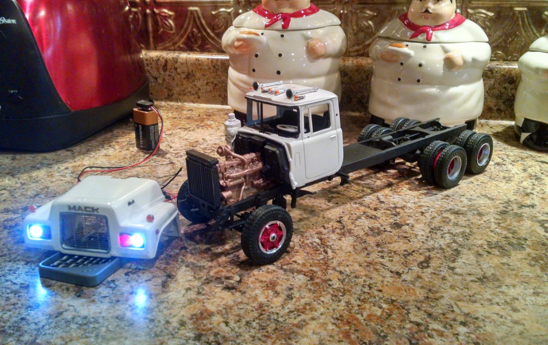

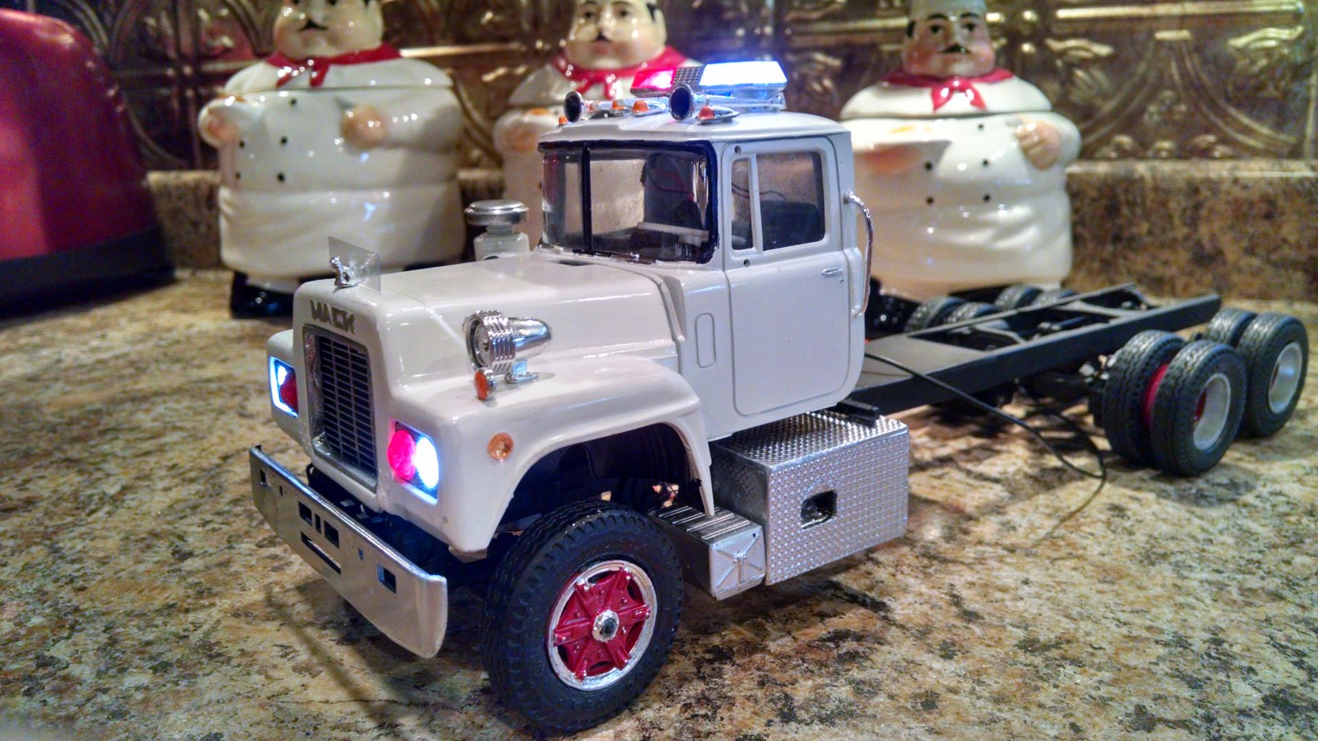

towman1271 Posted October 26, 2017 Author Posted October 26, 2017 Made a little progress last night.. Spokes and tires painted and installed. Interior done without any real details, since it's not easily seen. Some work on the cab and hood, including cutting out the kit grill & making the newer style that's on our tanker!
Chariots of Fire Posted October 26, 2017 Posted October 26, 2017 Coming along nicely. Those LED's are really bright! Where did the new grill come from?
towman1271 Posted October 26, 2017 Author Posted October 26, 2017 Coming along nicely. Those LED's are really bright! Where did the new grill come from? Thanks Charlie.. The grill is part of a phot etch set from detail master

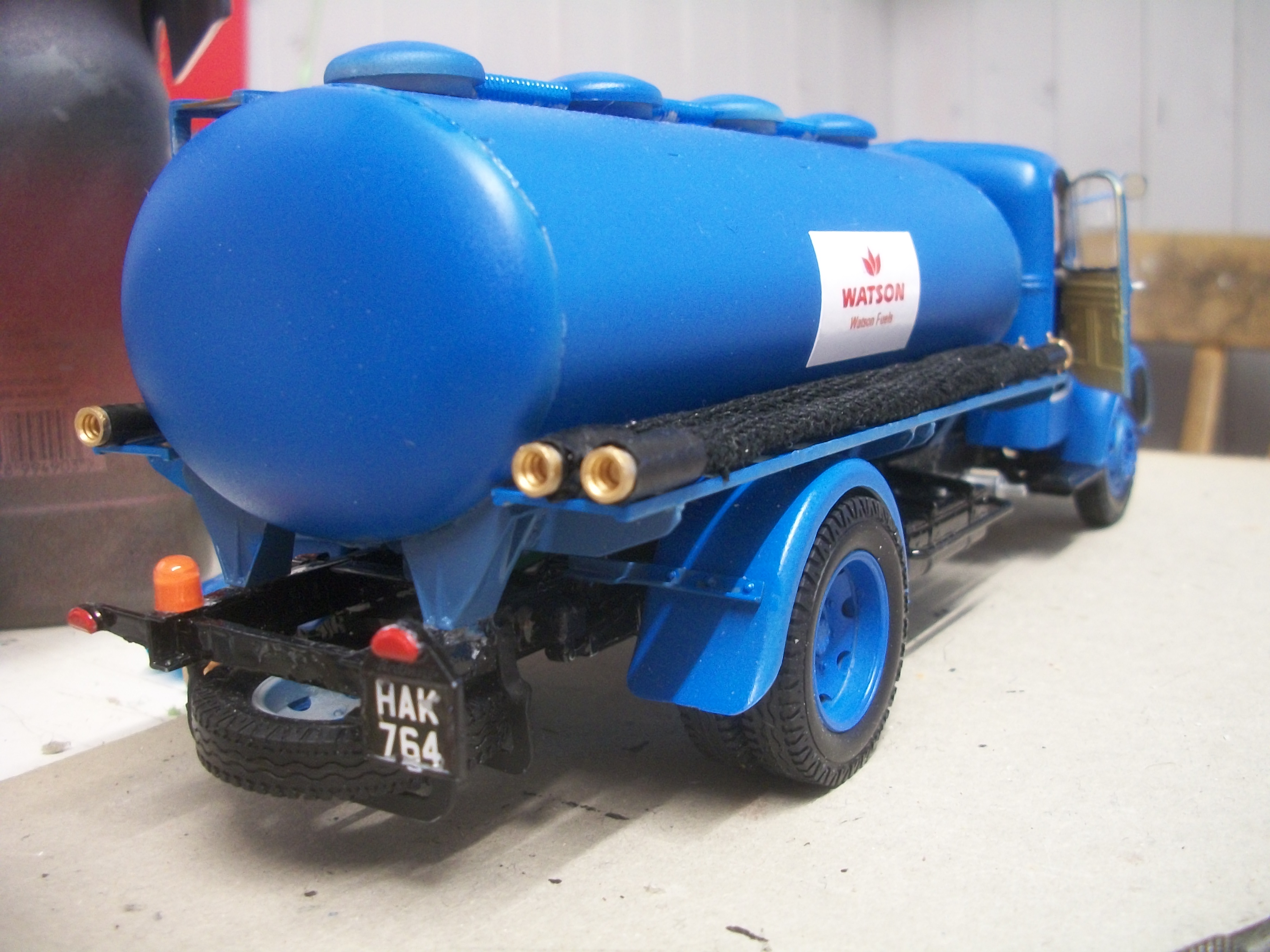

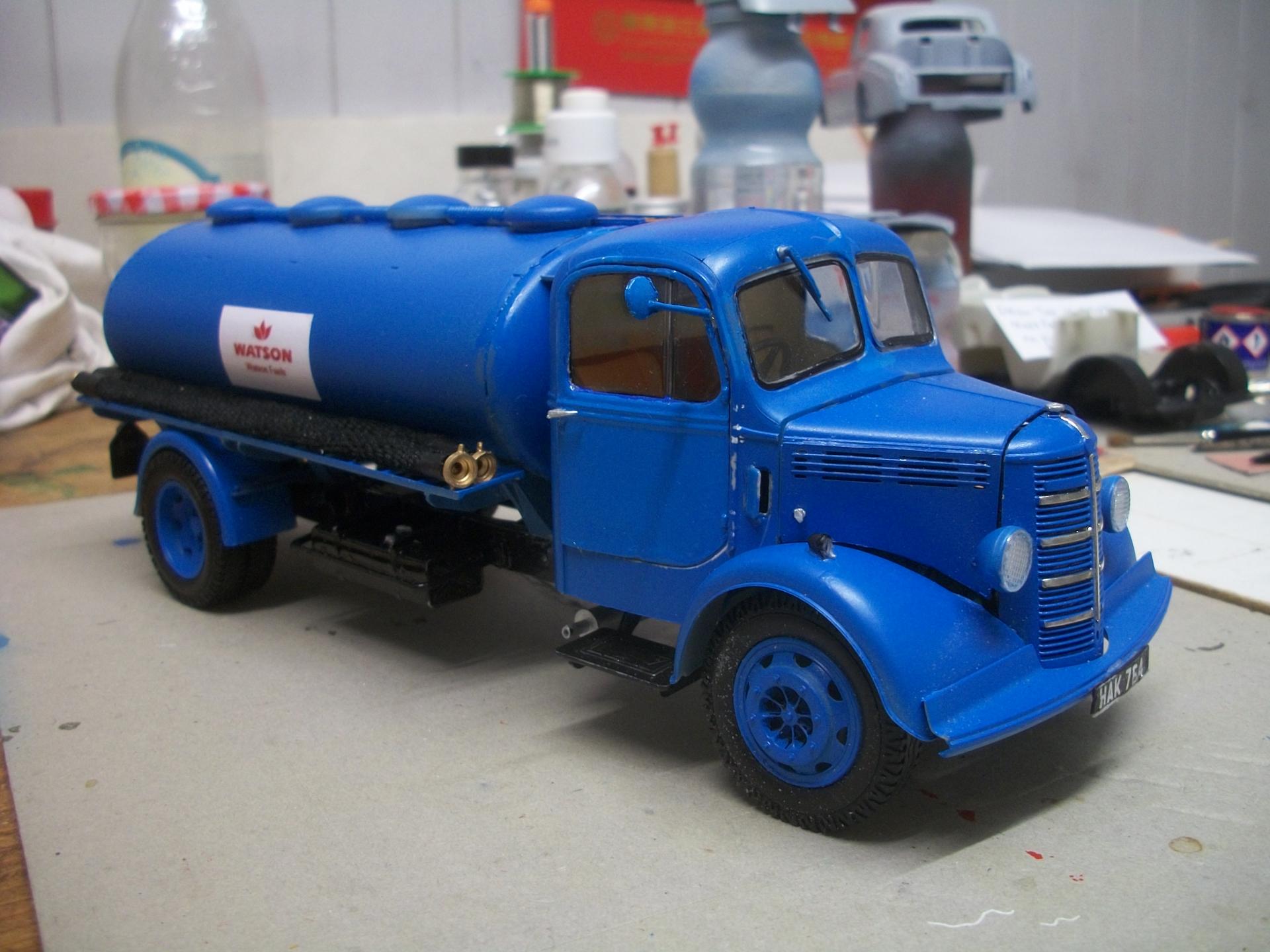

Anglia105E Posted October 26, 2017 Posted October 26, 2017 Nice looking build so far Dave, and your truck is quite a bit larger than my Emhar Bedford O-Type Tanker ! Couple of photos attached for you. The tank on the Bedford is elliptical too. David

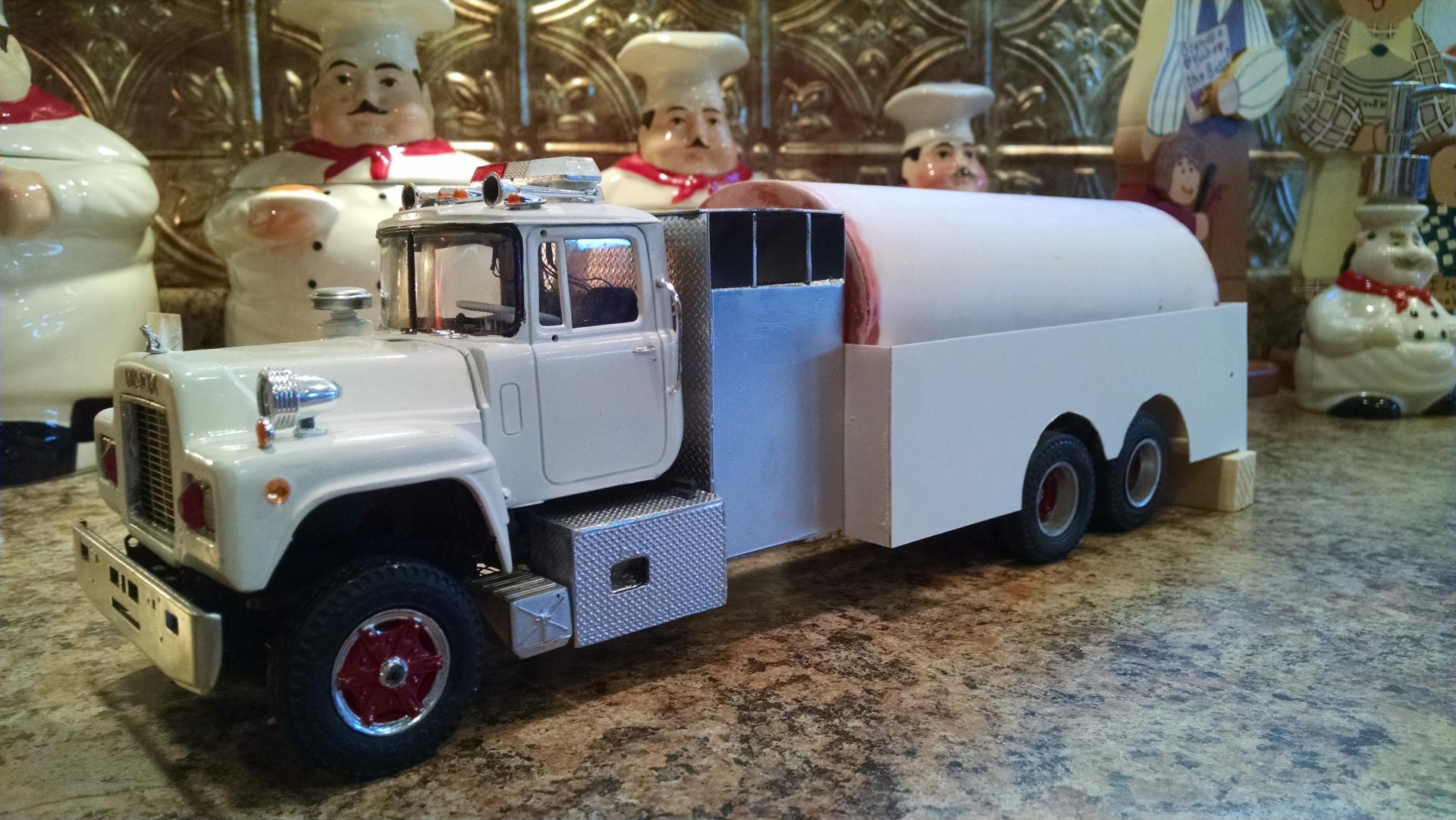

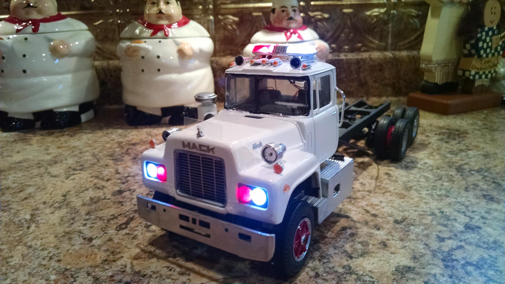

towman1271 Posted November 12, 2017 Author Posted November 12, 2017 (edited) The cab is pretty finished.. Just have mirrors & bumper poles to do, but they will be last ( so they don't get knocked off). Waiting for Joe at Dicast & Decals to finish his vacation to make decals for it.. Now to start scratchbuilding the bed. Edited November 12, 2017 by towman1271

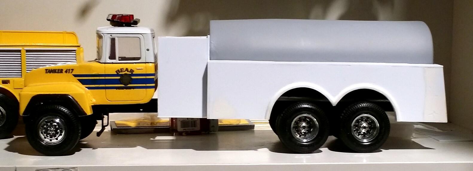

hooknladderno1 Posted November 14, 2017 Posted November 14, 2017 (edited) Hi Dave, Excellent start! Another option for the elliptical tank is a 1/32 scale New Ray tank. They make several elliptical tankers that work well in 1/25 scale. Because they are narrower than say the expensive OOP Revell Beall tanker, they can accommodate the addition of portable tank holders, compartments, ladders, hard suction, etc. Unfortunately, with the recent Photobucket issues, I can't post photos of how well they work. This is an early photo of a WIP that has come a long way. Look forward to following along! David Edited November 14, 2017 by hooknladderno1

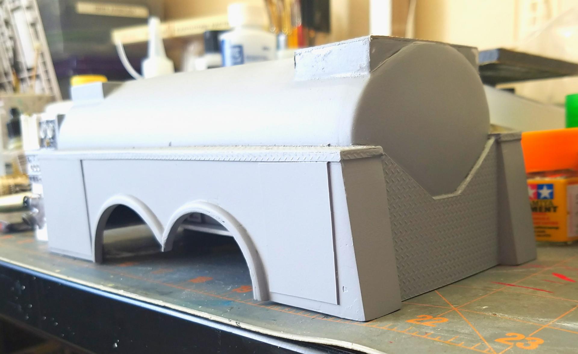

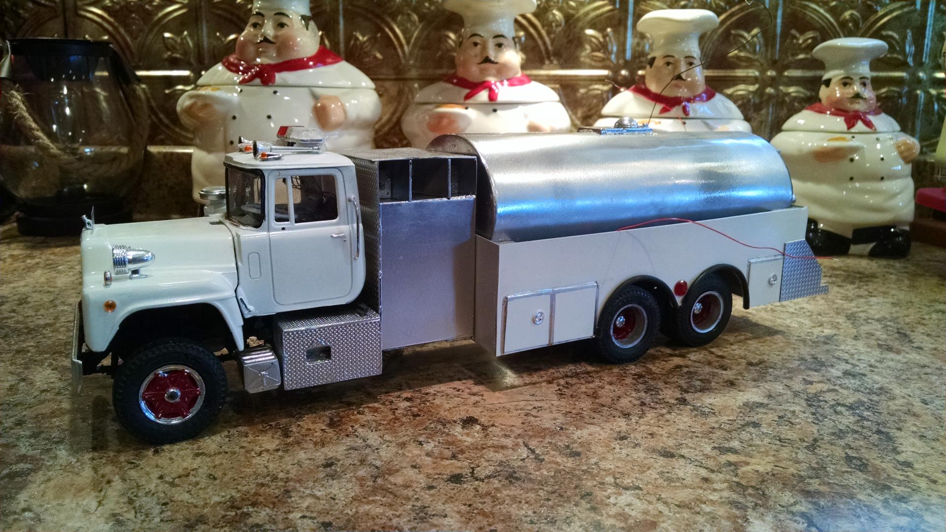

towman1271 Posted March 4, 2018 Author Posted March 4, 2018 Walked away from this build for a few months. Now the weather is finally getting better here in PA, i thought it was time to start the bed. Used a 3" mailing tube and shaped it to the elliptical shape, then wrapped it in styrene. Cut out the side & rear panels!
towman1271 Posted March 26, 2018 Author Posted March 26, 2018 Made a little progress this weekend.. got some paint on the body and tank. Made compartment doors and rubber wheel flares.. started to build the rear step bumper as well.. considering redoing the tank though.. I think the cardboard tube I used is twisting, live and learn.. I should have used the PVC Charles suggested.. always listen to the master?
