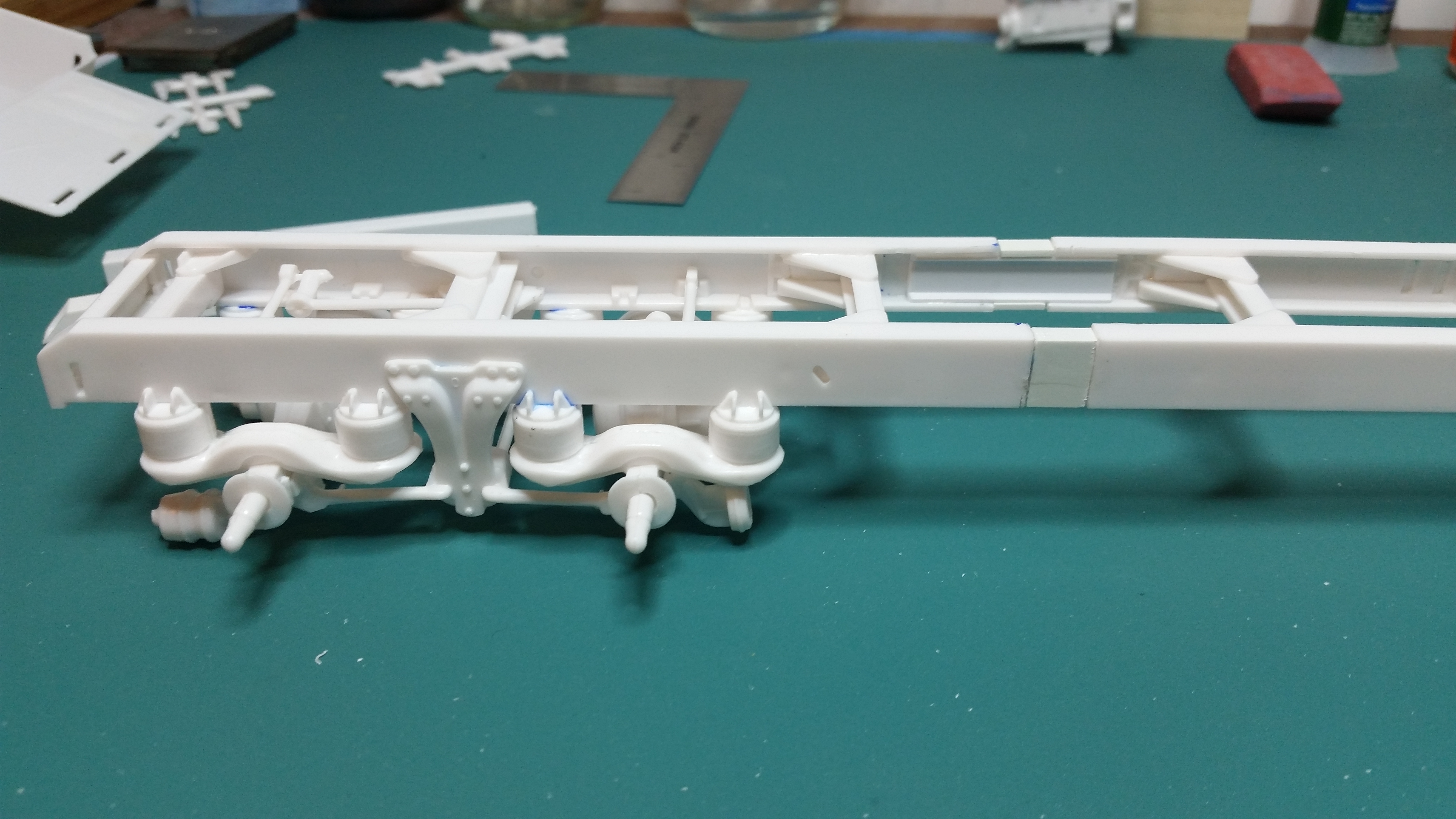

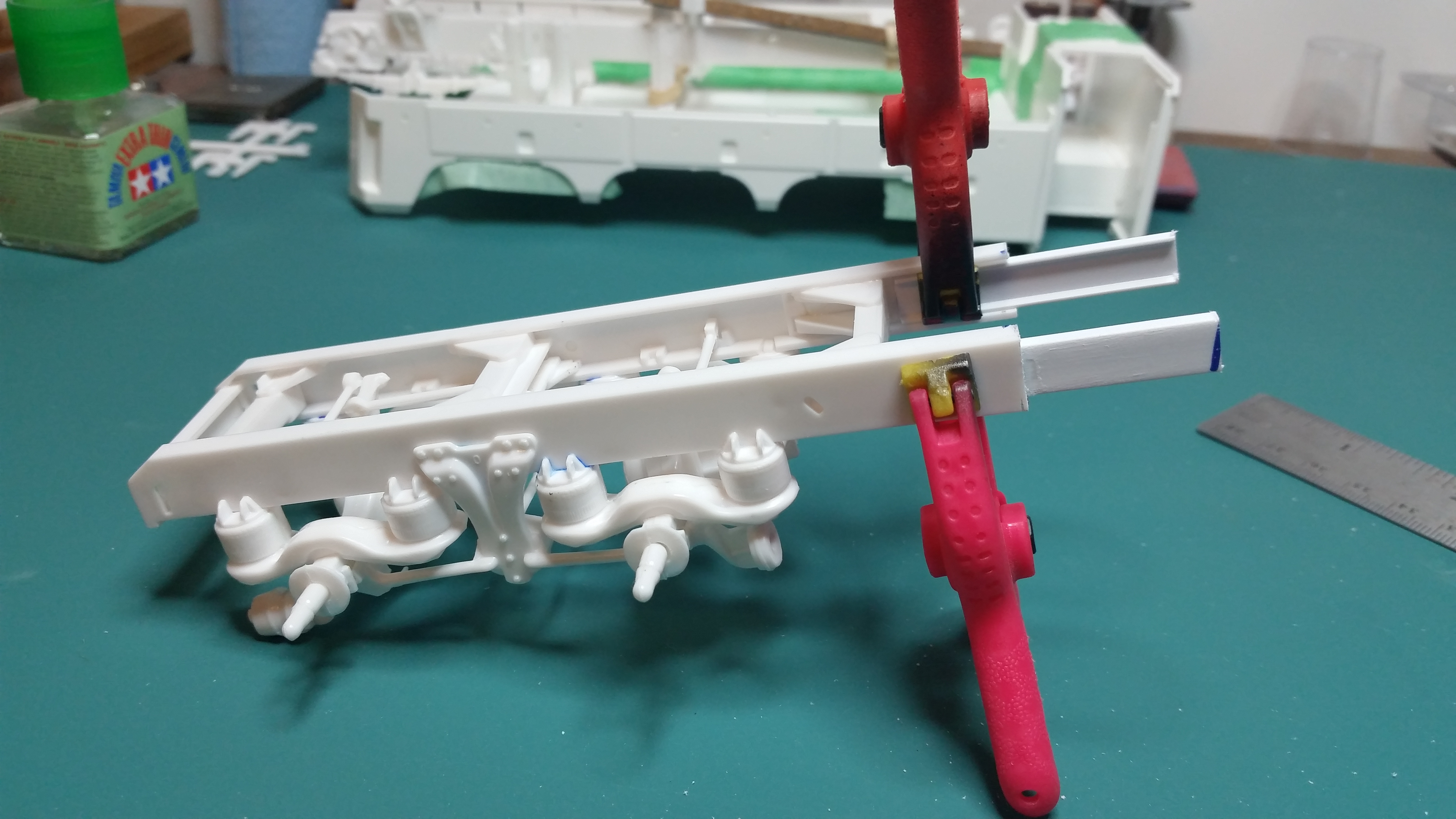

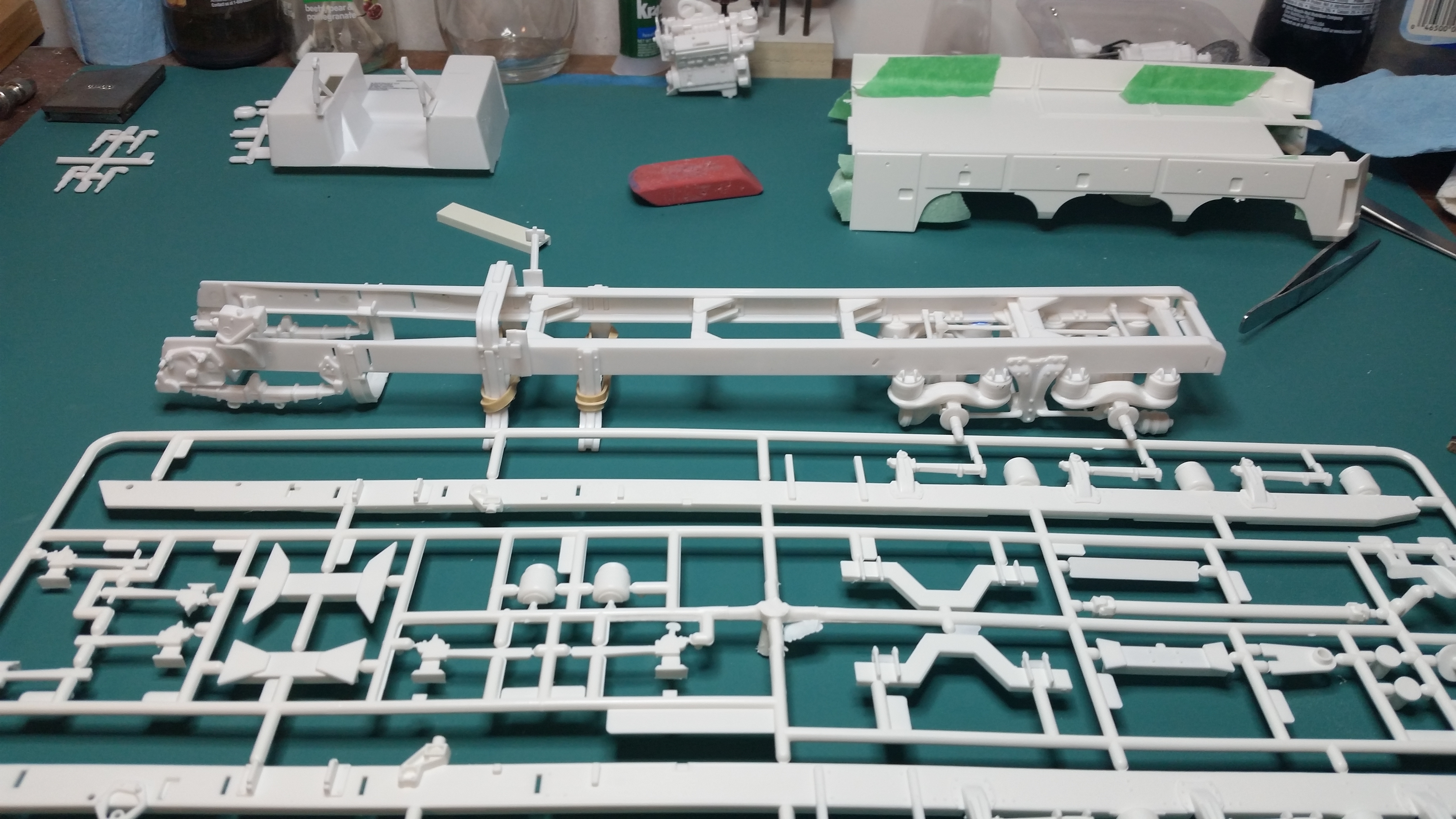

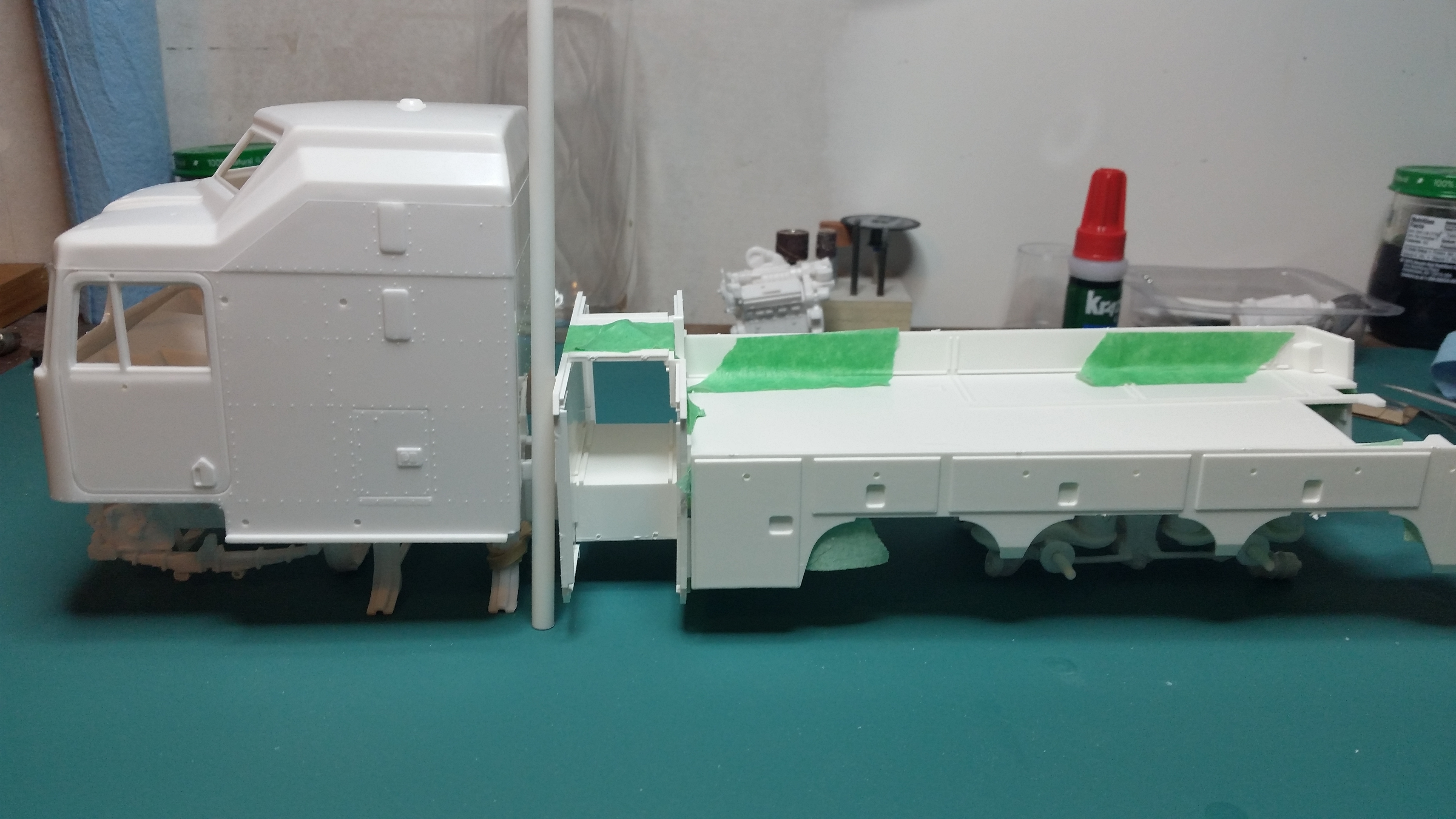

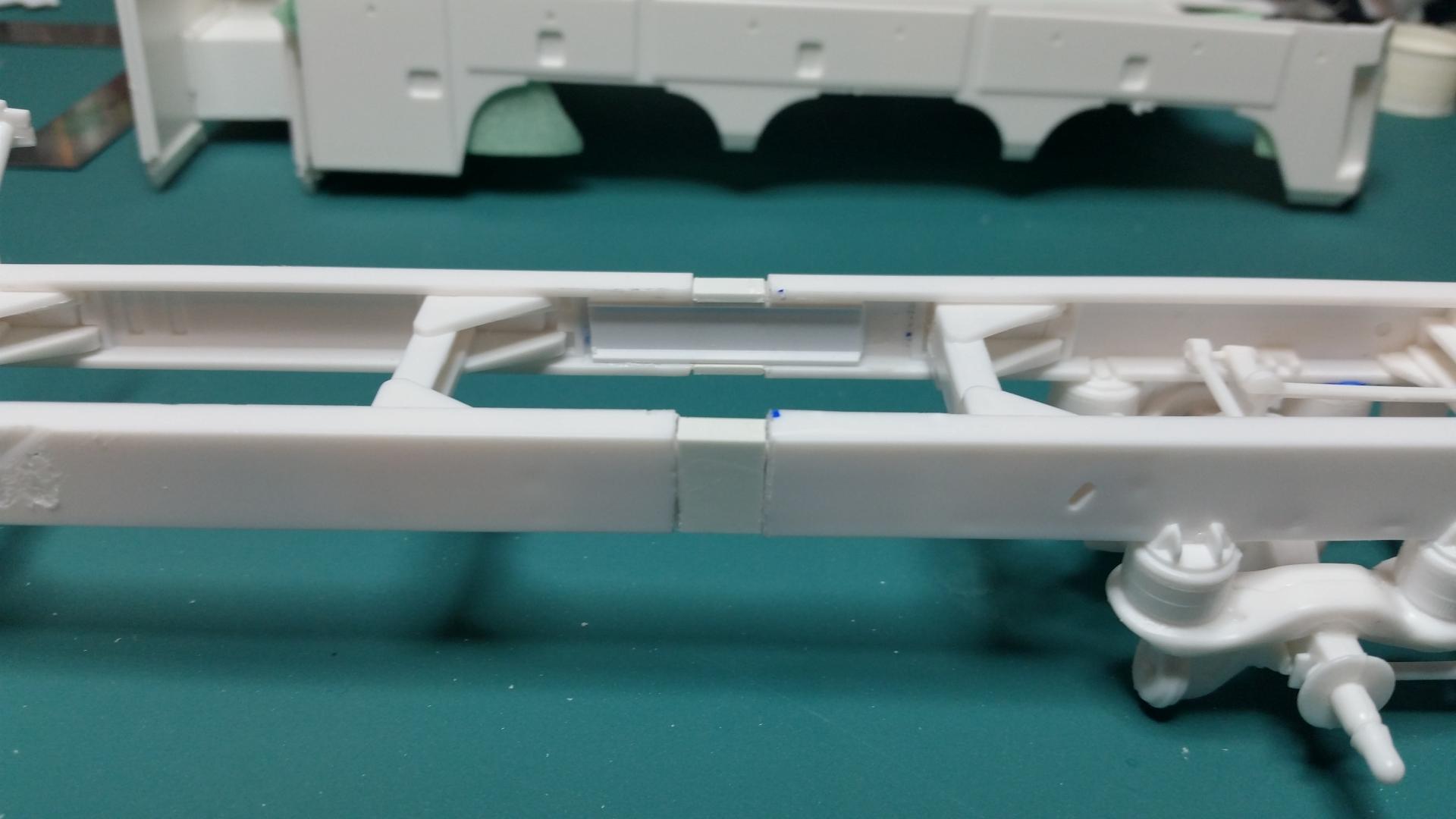

gotnitro? Posted October 31, 2017 Author Posted October 31, 2017 Last night I started laying out the major parts, planning ahead that I'd need to stretch the frame . Here's the mockup of the cab and bed found a good spot to add the stretch keeping the strength. I epoxies some channel inside the rails where I'm adding about 1/2 inch. My lonester wrecker always feels flimsy so I'll add more strips along the frame on this one . Here's the frame cut and reinforcing strips installed that's it for now

gotnitro? Posted October 31, 2017 Author Posted October 31, 2017 Kerry I was shocked it wasn't long enough..but the stretch is out patient surgery anymore lol no pain meds needed Here's the pete frame next to the kw..for size comparison not adding all the length. .1/2 inch sets the wheels nicely in the wells

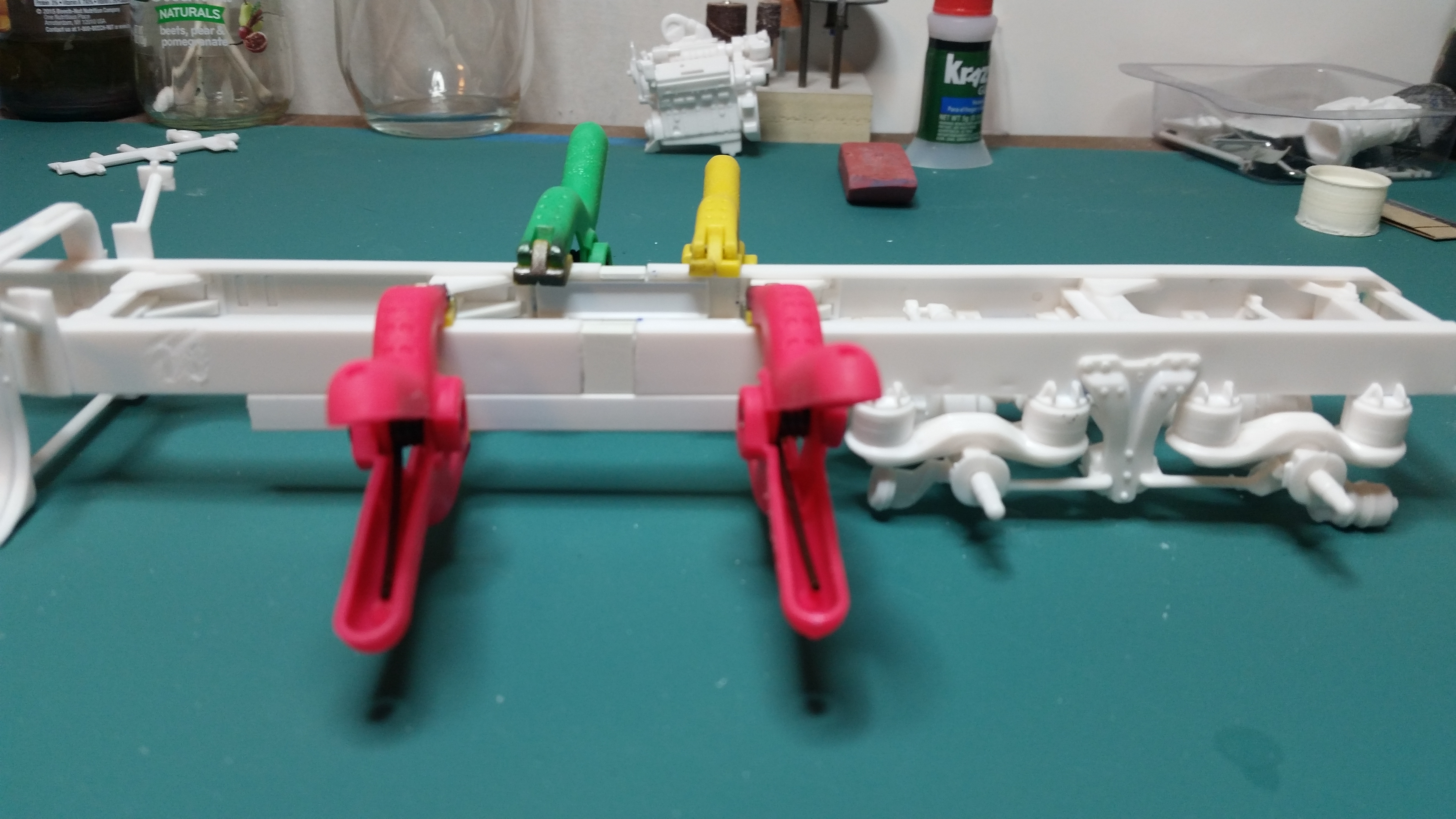

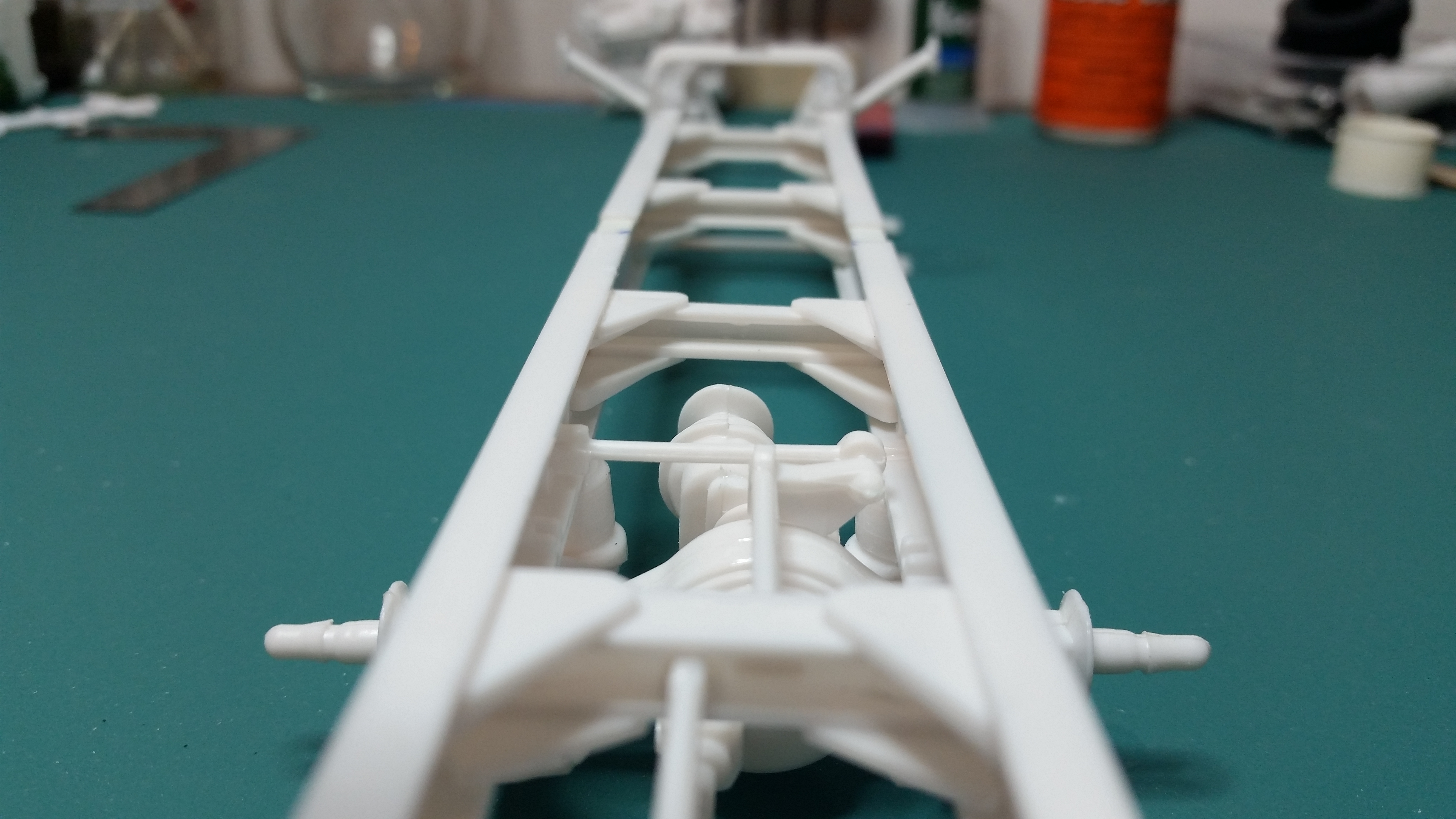

gotnitro? Posted November 2, 2017 Author Posted November 2, 2017 Lol no anesthesia here..stick a tongue depresser in its mouth and suck it up soldier! !The 1st Cav way lol Minor update..frames all patched together, my original 1/2 spacer was too extreme..ended up a modest 3/8 for the win. I used cnc cut channel from gw trucks for the surgery..and will graft in some sheet later to hide the scar. I used square tube underneath to assure the frame didn't hump up while curing over the patch

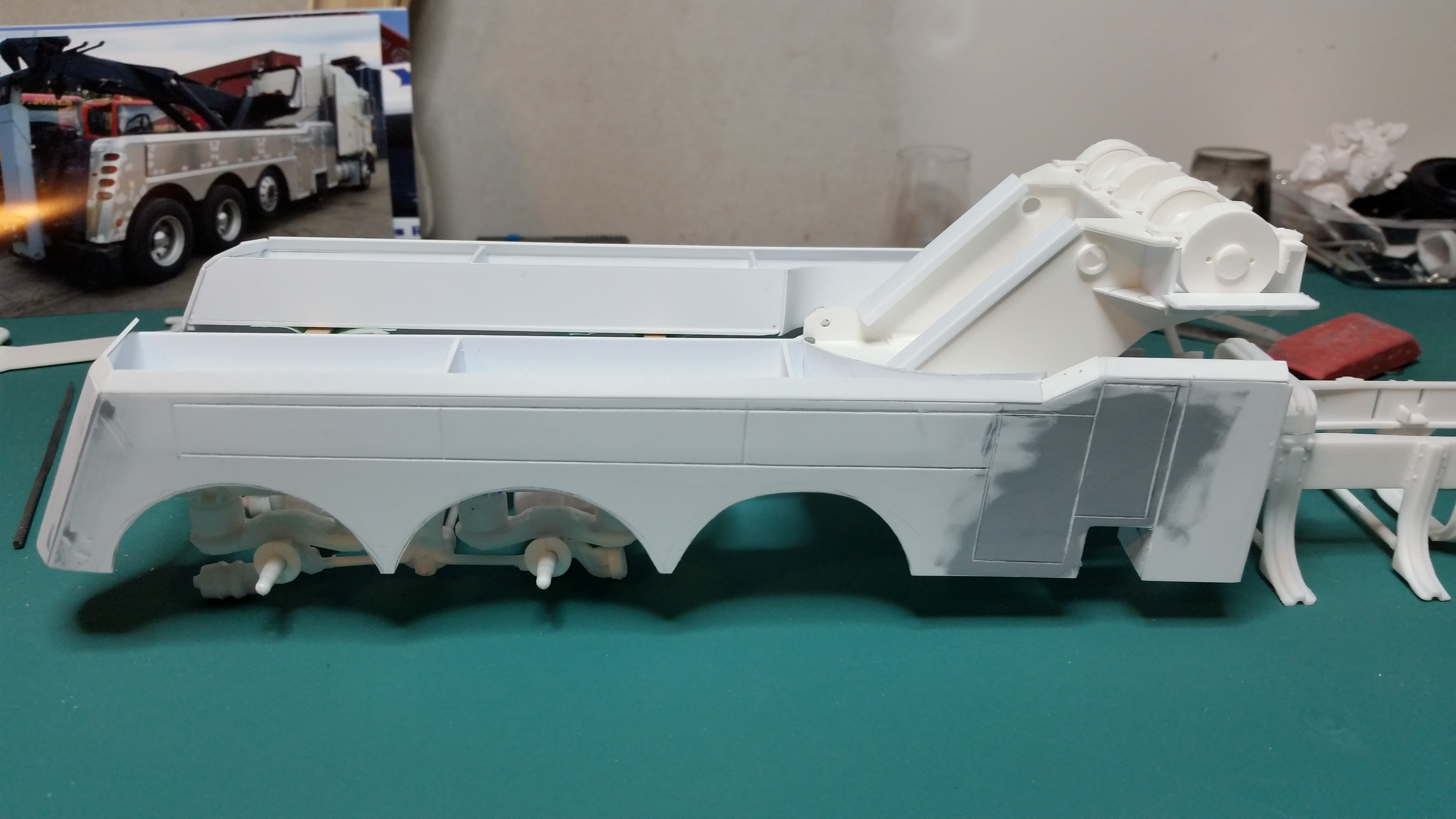

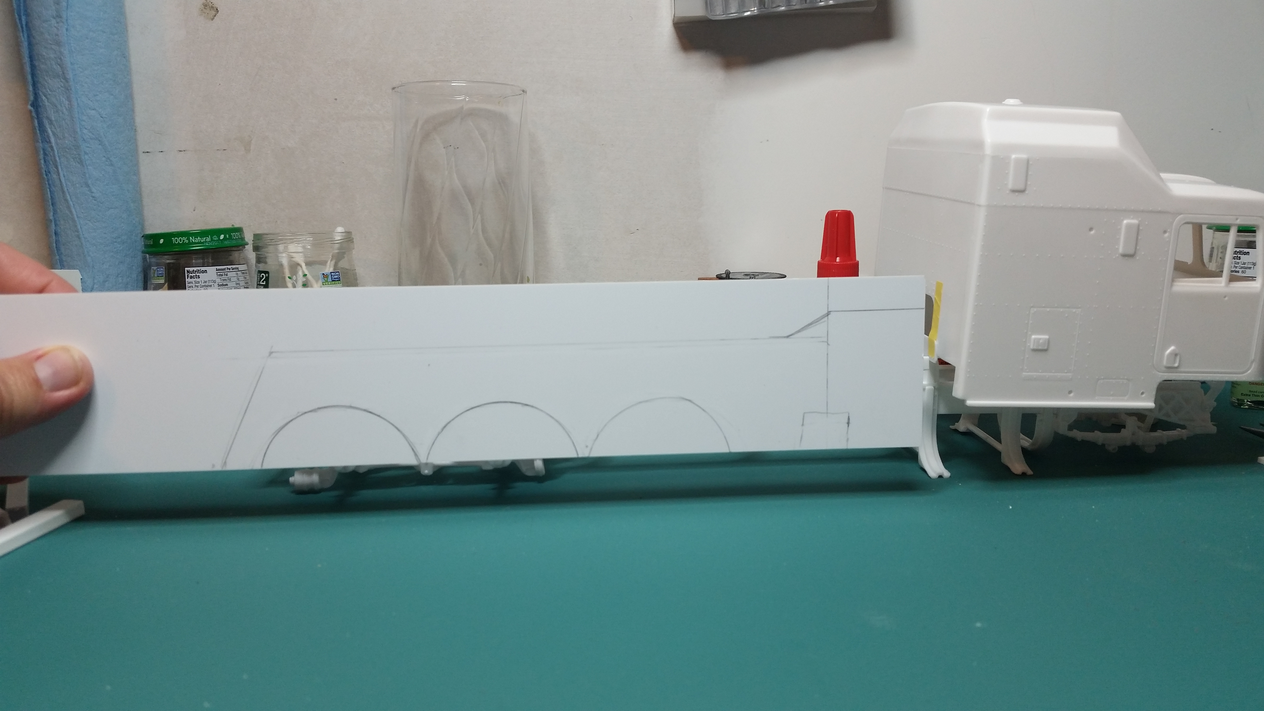

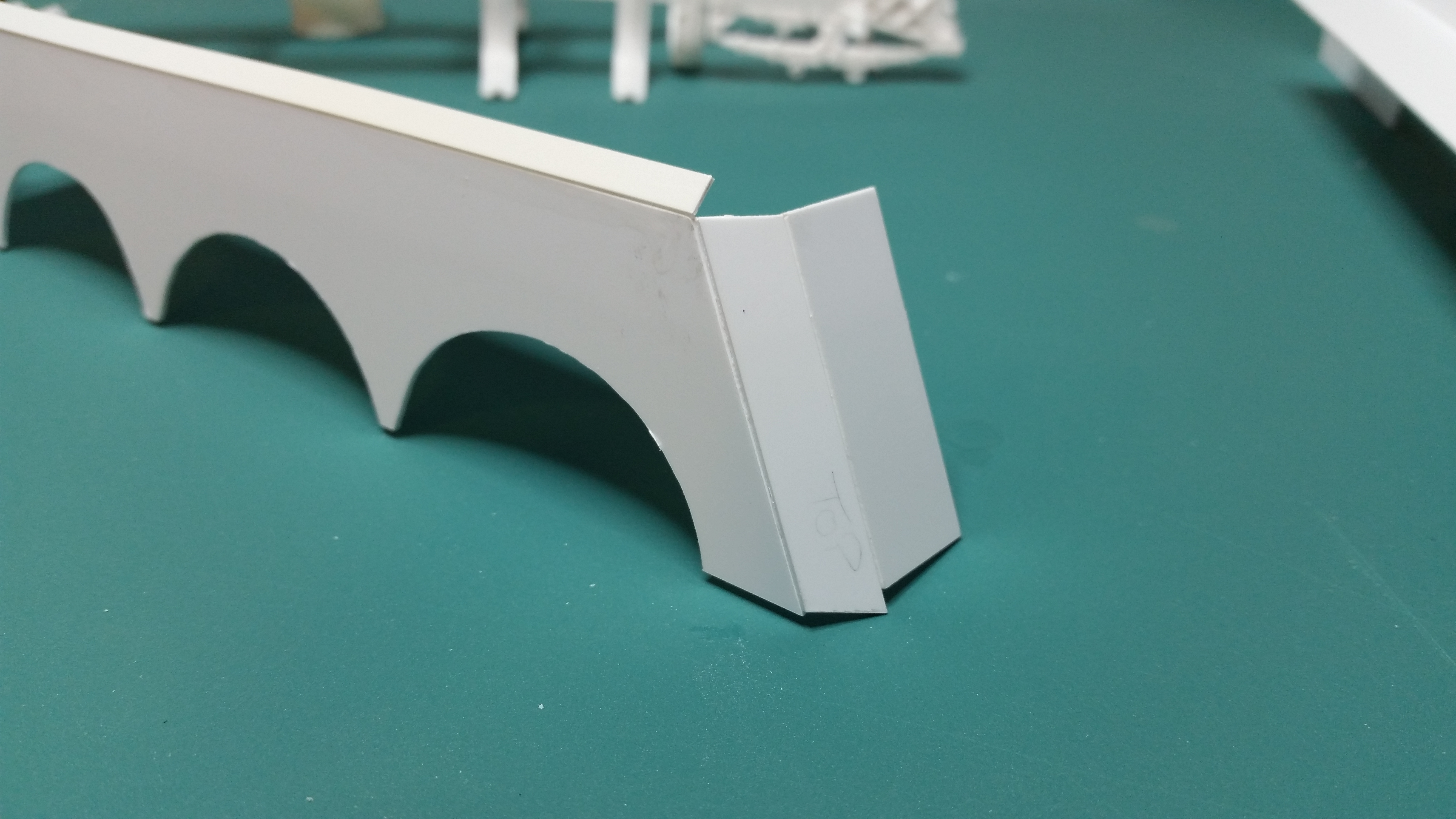

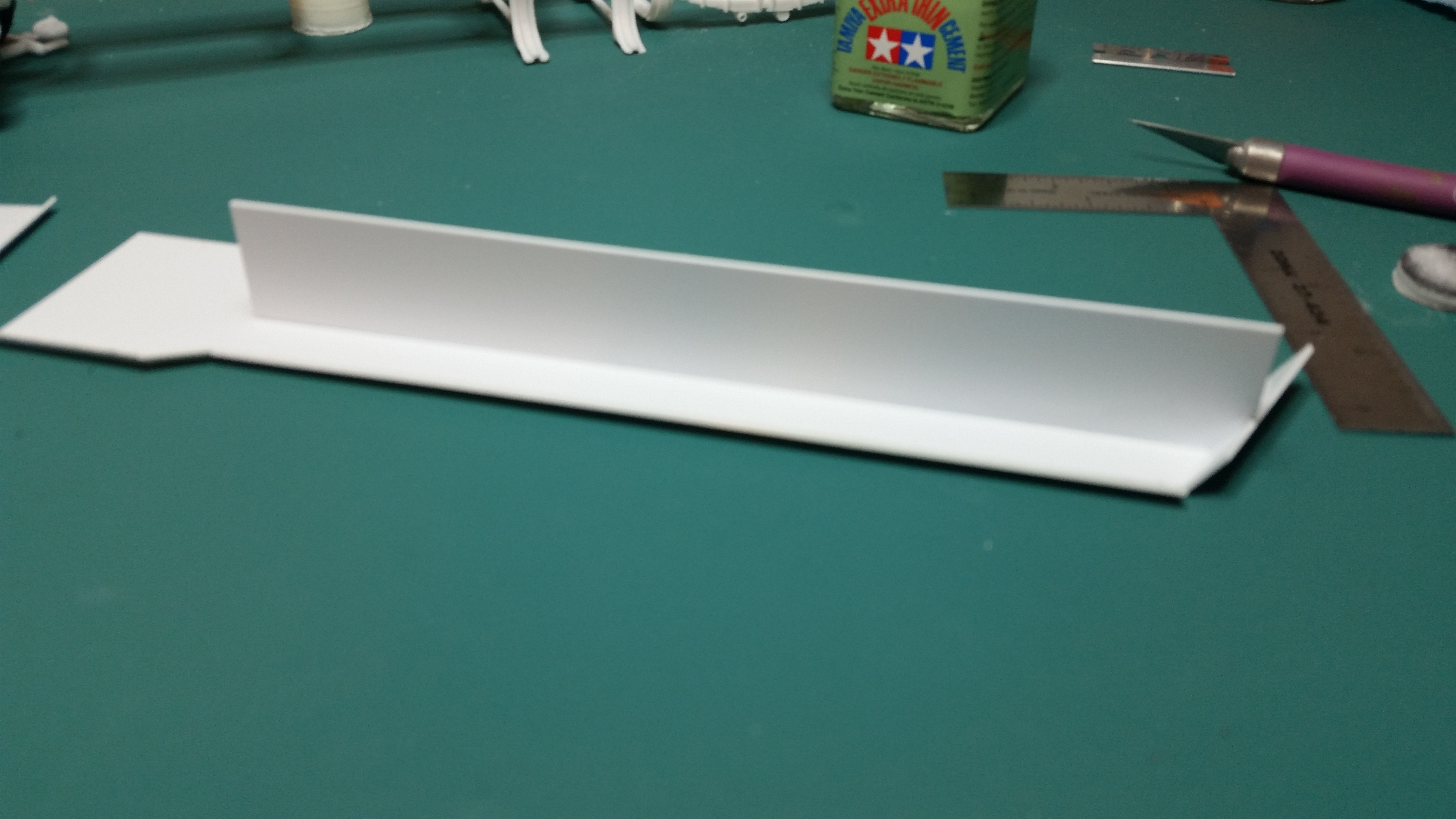

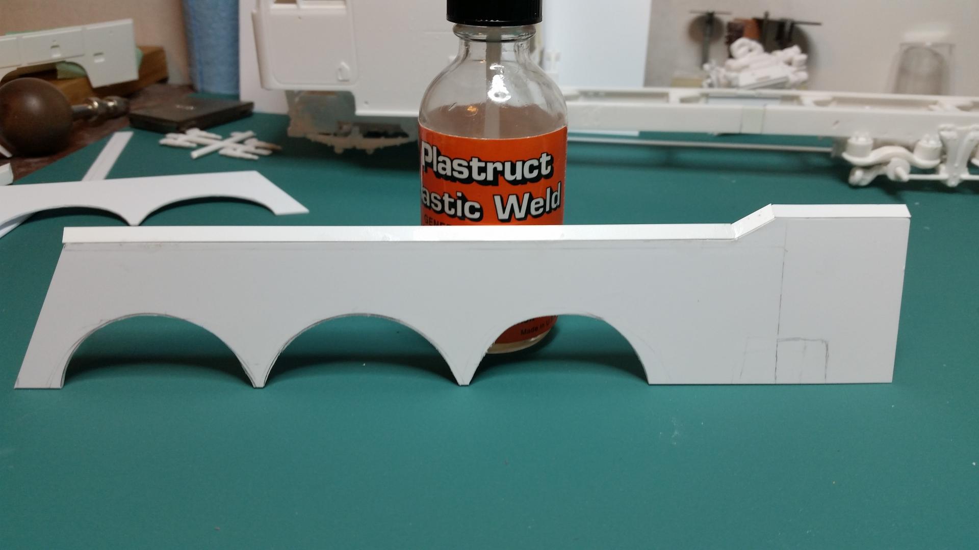

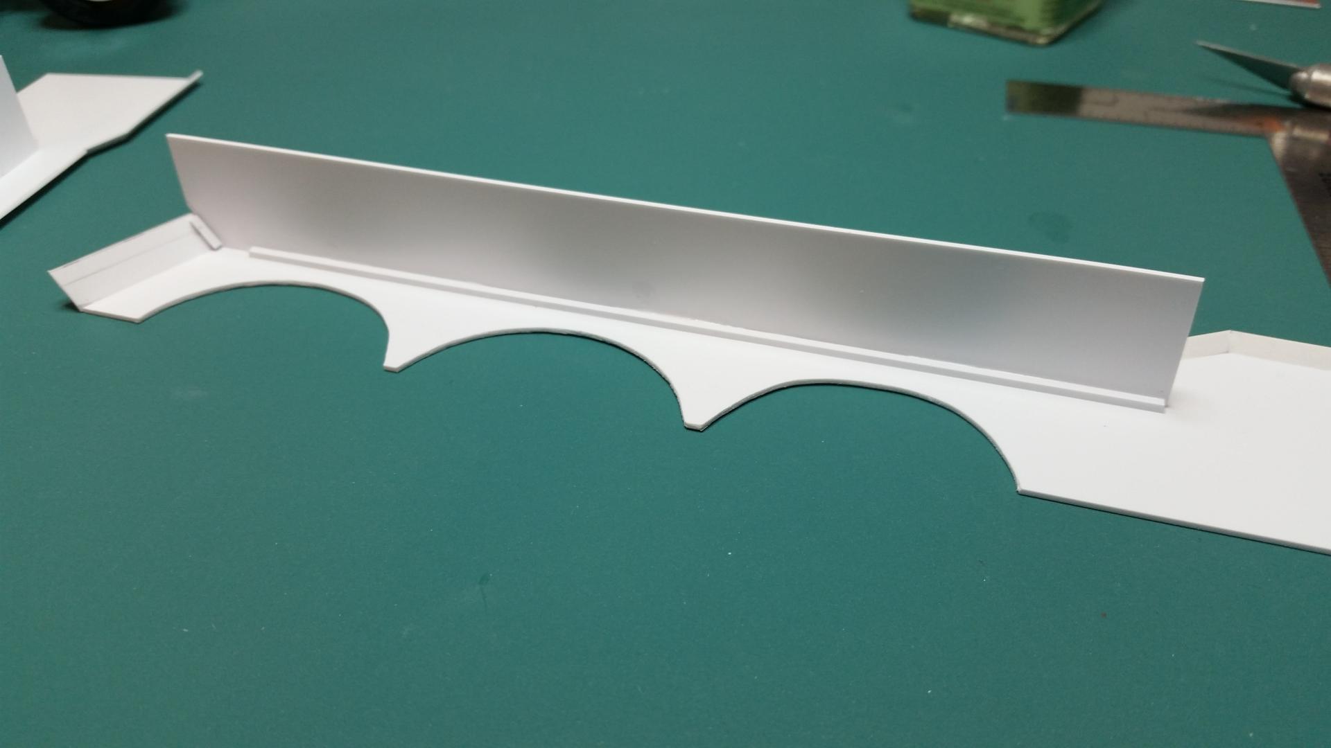

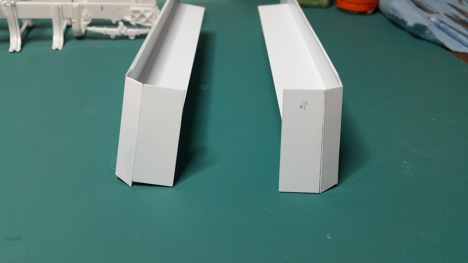

gotnitro? Posted November 4, 2017 Author Posted November 4, 2017 I used the pete slabs and dumb luck to line up the wheel wells. I probably drive others nuts using a doodle for making parts but works for me . after the slabs were shaped I started adding the structure behind..just a simple long box that'll eventually get diamond plate tops.. reinforcing the floor w 060 strip keeps floor flat and more gluing surface , plus makes it appear I know what I'm doing lol. waste not..I used the scraps for the angled corners..very rough fit right now. A quick swipe w sanding sticks later will hide my shoddy work. Another set of 060 rails hold the strips from behind . Therell be lights cut into these panels later along. any questions or comments welcome ! Till later

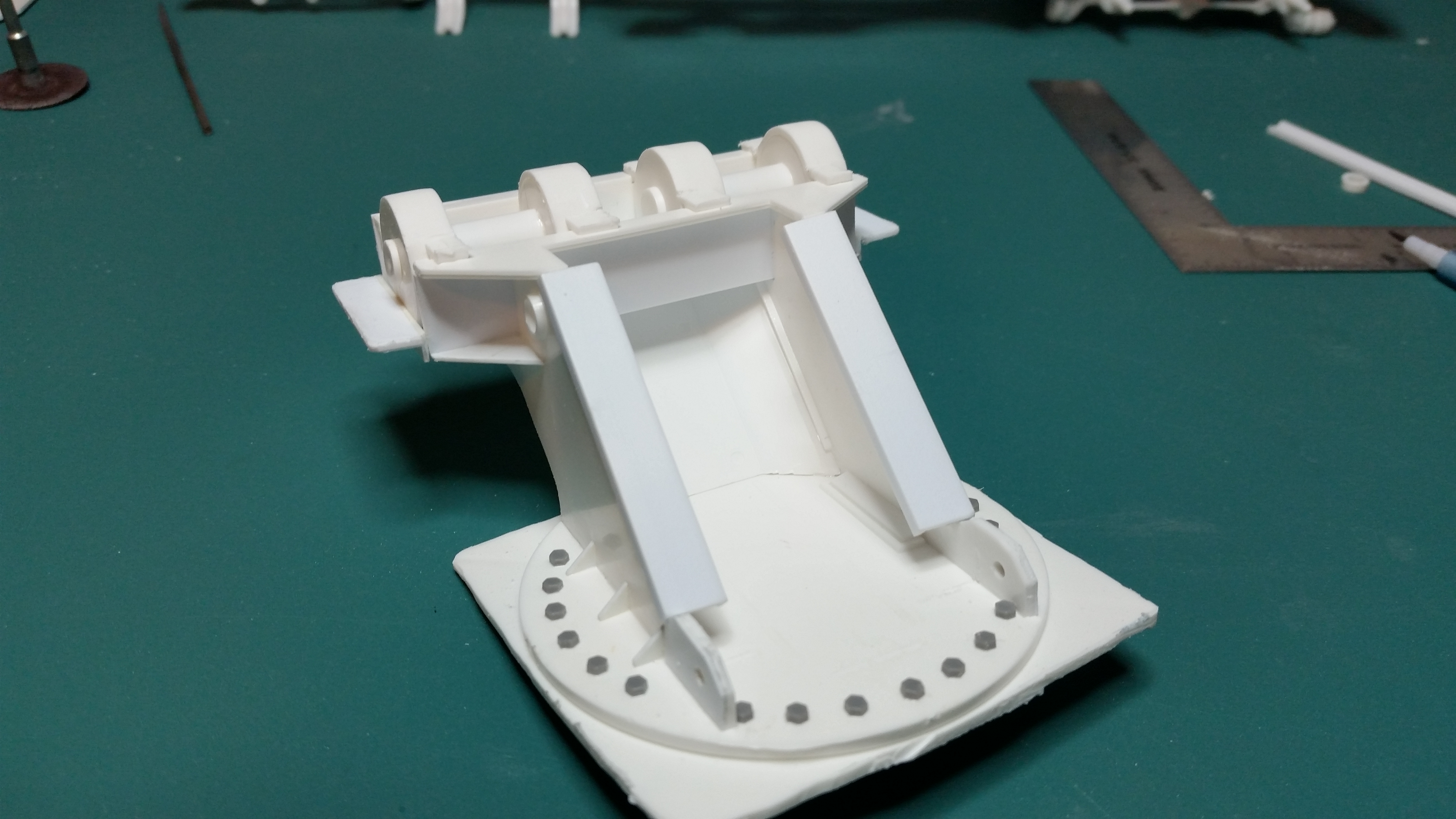

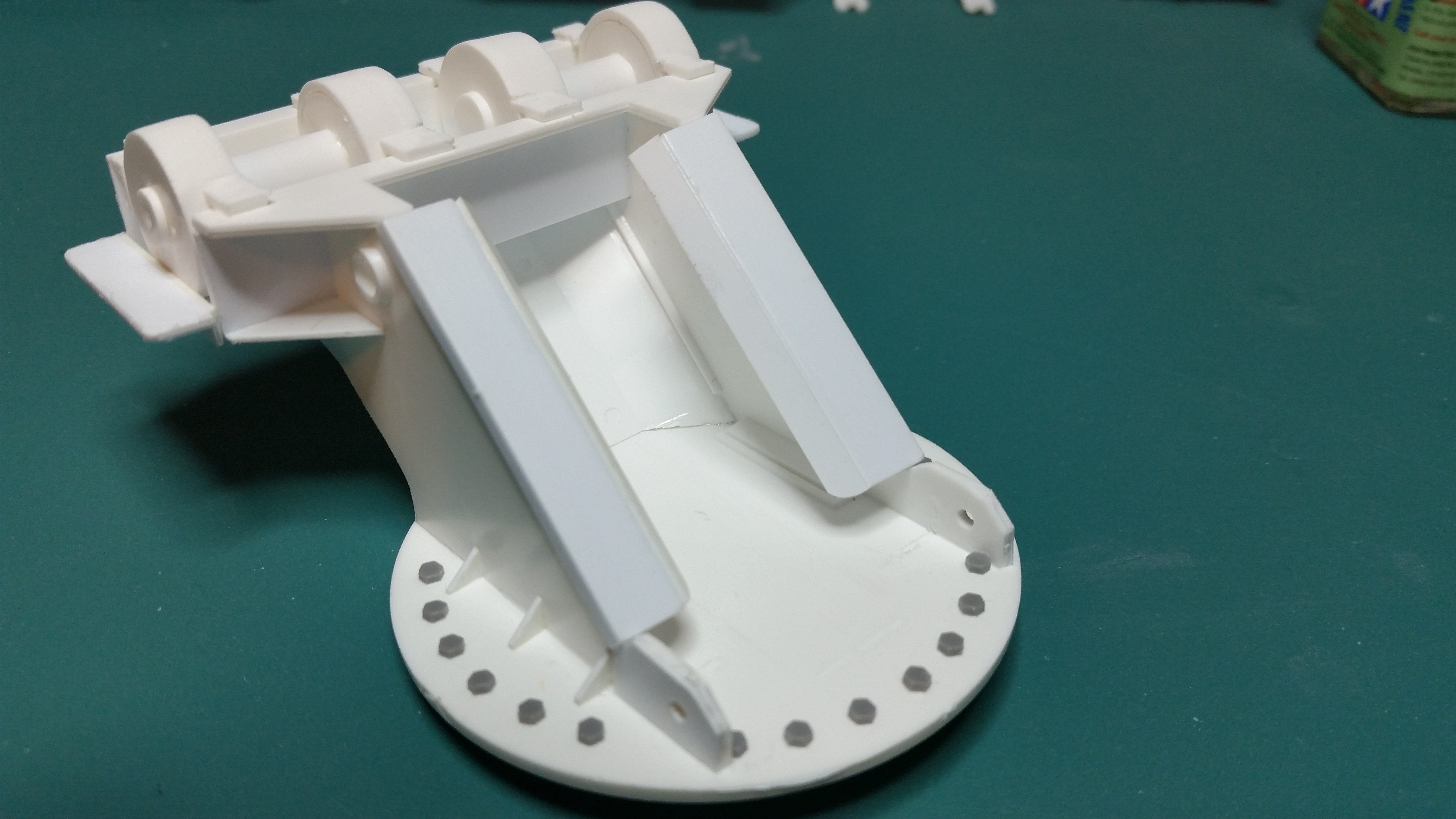

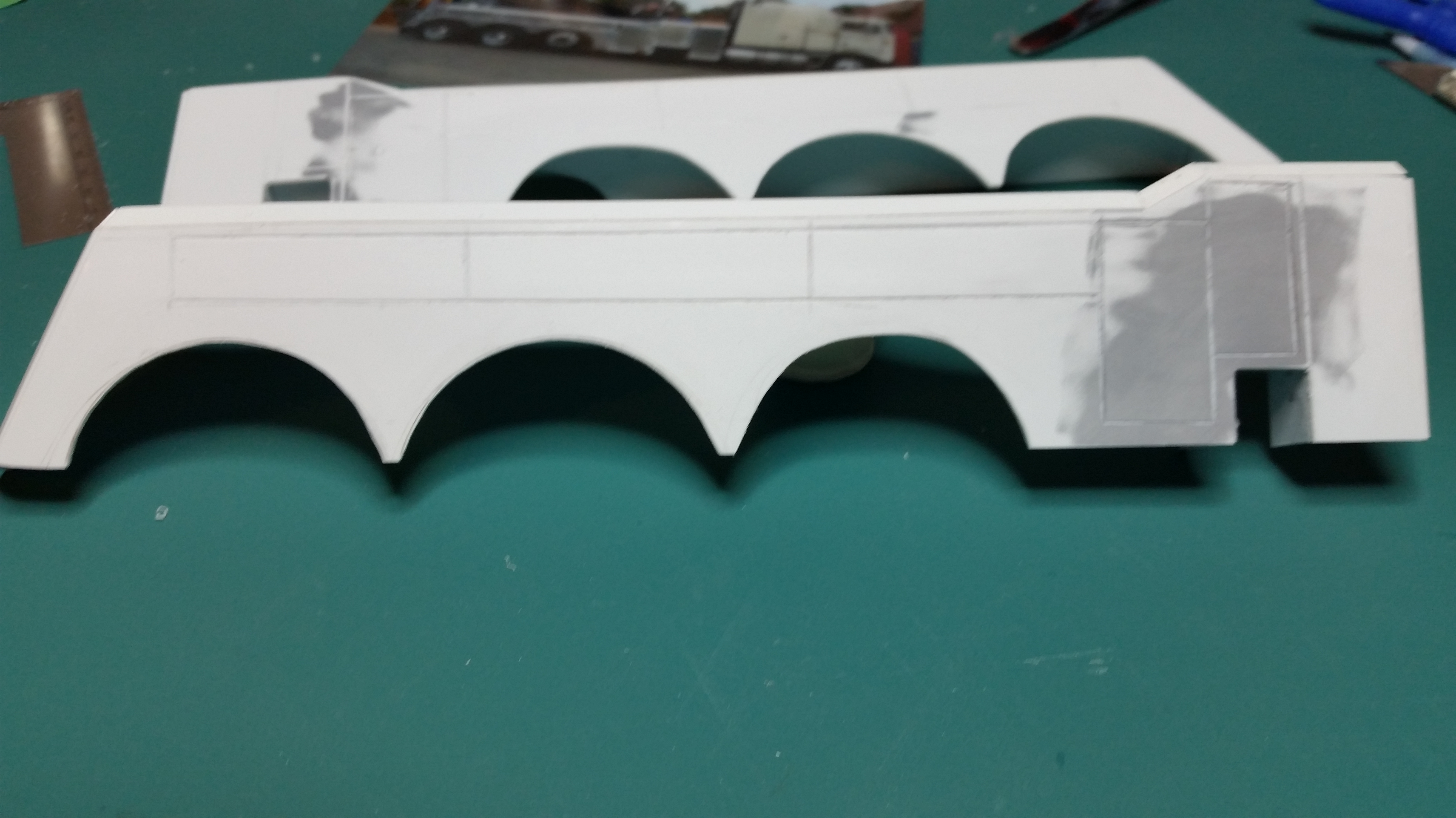

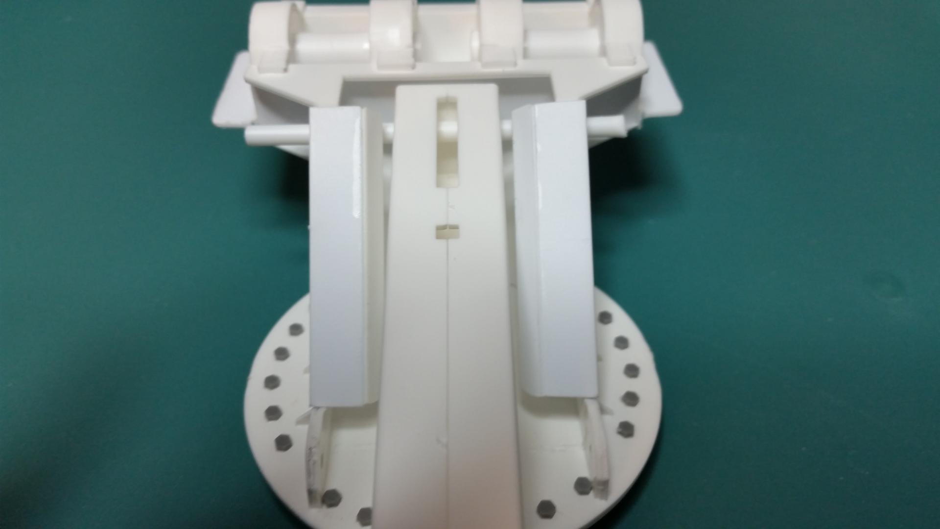

gotnitro? Posted November 15, 2017 Author Posted November 15, 2017 Thanks everyone I appreciate the comments it's definitely keeps me motivated !! I've been making progress on the side panels, scribing the numerous doors took so much patience to keep straight. .yet I still buggered up a few requiring putty . I used the back of a number 11 blade , then drew a small jeweler file along the lines to widen them. Should look good after a primer coat ! mock up !!!! I've modified several kit parts on the wrecker turn table . first to go...those odd gumball bolts. Meng 2mm hex bolts give a convincing look. The strips between the cradle will fill the space where the boom calls home. The outer plates will eventually become the light bar base Now...I've been struggling coming up with pics of how the cable winch drives should look. Does anyone know how these should actually look ? I'm referring to the motor or pump I guess that mounts outside the reels ? I'm seriously bumming here any help welcome !! Ok last pic for now..I stuck the boom section on for a treat thanks for following along
