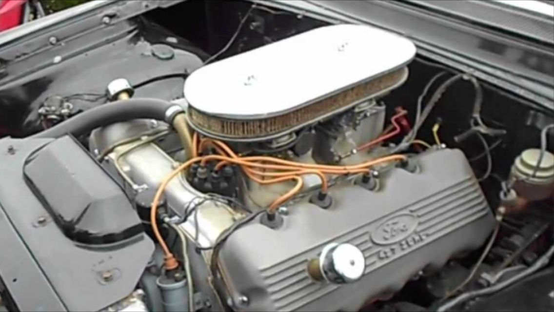

Ace-Garageguy Posted December 8, 2017 Posted December 8, 2017 On 12/8/2017 at 3:15 AM, 1972coronet said: Oldsmobile 455 Hemi , exp... Expand I never knew about that one. Cool.

426 pack Posted December 8, 2017 Posted December 8, 2017 What about the ford 427 DOHC with the spark plugs on the top of the valve cover or the dual spark plug HEMI with 2 distributors

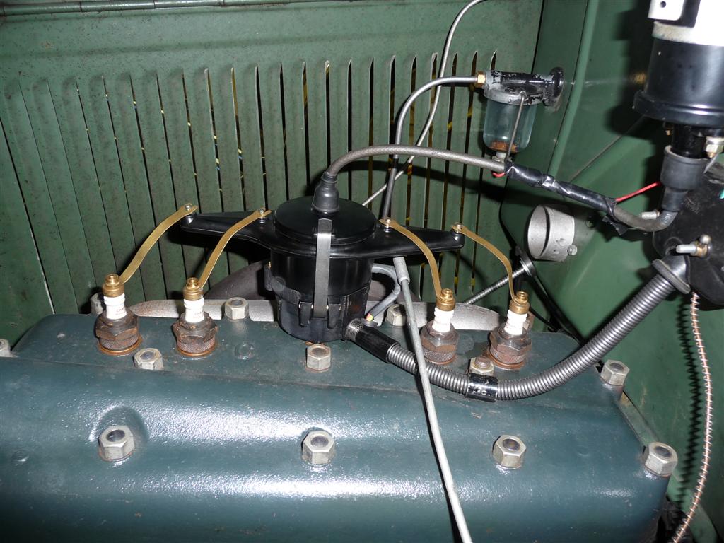

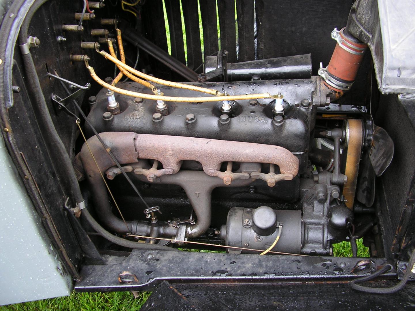

Greg Myers Posted December 8, 2017 Posted December 8, 2017 (edited) Ford had a better idea , Model T, Model A Edited December 11, 2017 by Greg Myers
