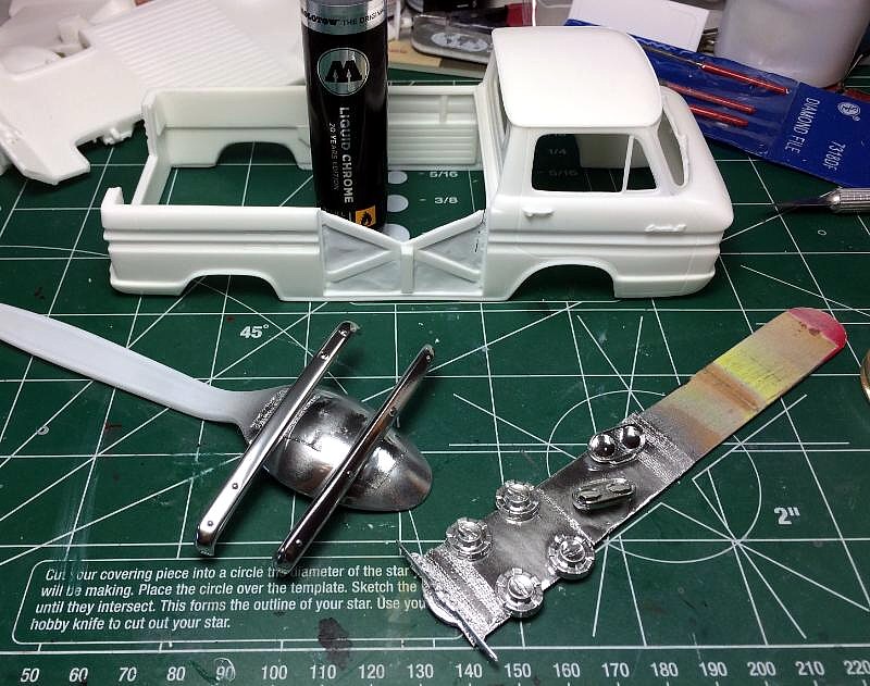

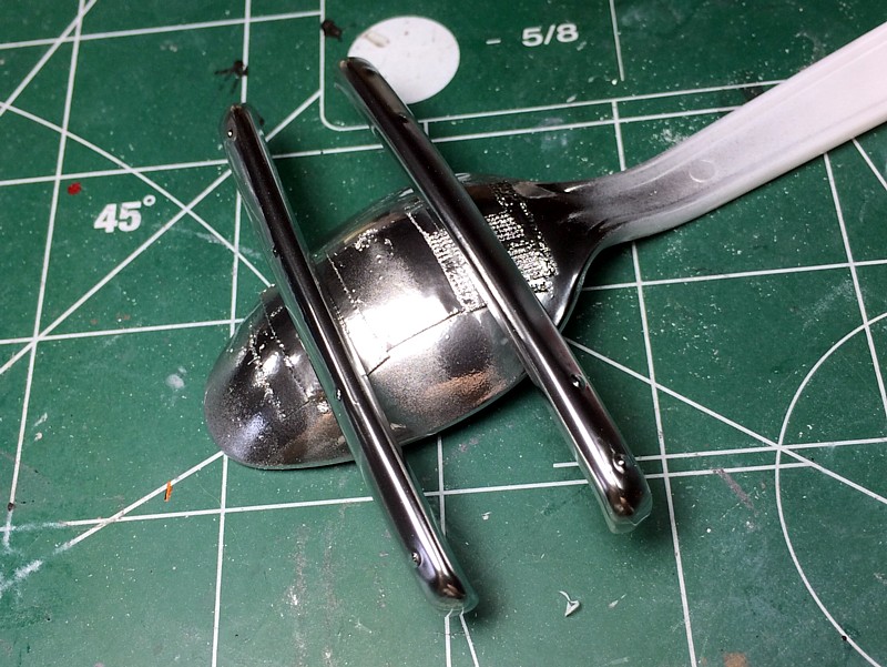

Zoom Zoom Posted January 2, 2018 Posted January 2, 2018 I've been testing it since summertime, have a comprehensive article submitted to Scale Auto for (I think) April issue. It's great stuff. Forget everything you learned about Alclad/Spaz Stix chromes...this is far more user-friendly and looks much better. If you demand perfection, continue using professional services that do vacuum plating. In general: 20 psi is good (no thinning required), it covers anything and everything as it's very pigment-dense and sprays just like real paint; you want smooth? Make sure you spray it on a smooth surface. Spray it WET. Let it dry a minimum of 24 hours, 48 is even better, before handling, putting in a dehydrator, whatever. Recently bought the Best Model Car Parts Corvair Rampside that someone here posted, have been working on it now for a couple weeks. It's about ready for paint, here is the chrome I shot this weekend: [/img] [/img] [/img] The spoon above is Molotow w/airbrushed overcoat of Spaz Stix Ultimate Clear. Try that with Alclad or Spaz Stix!

Zoom Zoom Posted January 8, 2018 Posted January 8, 2018 On 1/7/2018 at 4:11 PM, DiscoRover007 said: Can you mask the molotow without a clear coat or is it too delicate? Seems like it could be great for exhaust parts and headers. Expand I tried it on a spoon test with some Tamiya yellow masking tape. Even though sprayed months ago, it pulled up some of the chrome effect. On a spoon that I clearcoated with Spaz Stix Ultimate Clear (which hardly touched the reflection of the Molotow), no problem.
