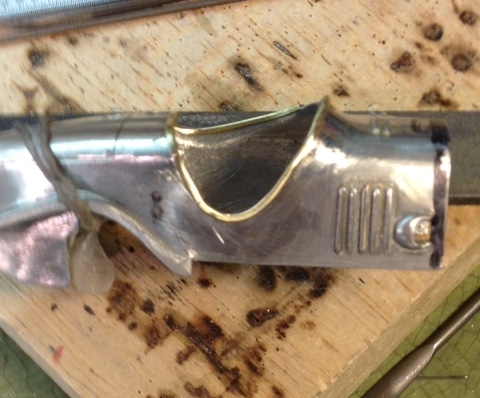

absmiami Posted January 26, 2018 Author Posted January 26, 2018 So, the lab-metal paste dried well and is sandable - but it was not fine enough to grip the small surface imperfections I ended up sanding most of it off and applied some more soft solder to the surface to fill in the larger surface pitting ... working - just have to be careful not to apply too much heat to the metal
absmiami Posted January 26, 2018 Author Posted January 26, 2018 some more solder and some more filing and sanding
absmiami Posted January 26, 2018 Author Posted January 26, 2018 pix still loading wrong - oh well the car has rows of copper rivets - like everywhere working here on the rivets that attach the hinge on either side of the fuel tank cover rivet rows lined up with scribed lines and a brass gadget that is bent from rod to locate the holes properly holes are .021 with corresponding copper wire clipped in and sanded rivets are close to scale and are just visible once all the sanding is done

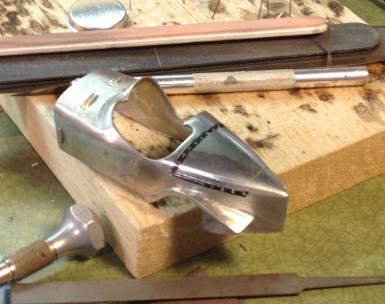

absmiami Posted January 28, 2018 Author Posted January 28, 2018 okay - the pix are now saved properly and loading right side up - aren't computers great ! the patterns for the rivets are marked in hi-liter makes it easier to mark the rows and patterns and easier to photograph ...

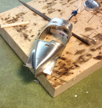

absmiami Posted January 28, 2018 Author Posted January 28, 2018 working my way around the fuel tank cover with the rivets - just glue the copper wire in and clip close - but not too close - to the surface of the body with the rivets in place in pic 3 - but not yet filed - has a sort of steam punk look - maybe try this on another project in pic 4 the copper wire protrusions are filed and then sanded flush with the surface got lots more of these to make - already broke one #75 drill bit ...

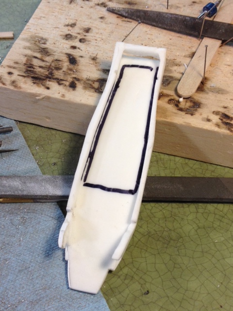

absmiami Posted February 5, 2018 Author Posted February 5, 2018 with the rivet holes drilled it's time to make and attach the lip along the bulkhead line that retains the bonnet re-profiled the under-side of the cowling with a steel cutting tool cut some .015 evergreen plastic strip to glue - epoxy - to the underside of the cowling the tape along the edge of the strip is temporary - just there to help align the strip while gluing ...
absmiami Posted February 5, 2018 Author Posted February 5, 2018 with the strip glued in place I have to re-drill the rivet holes and glue in the wire for the rivets most of the stems on the underside will stay there they will help locate the bulkhead - which will probably be plastic with thin sheet aluminum glued to the front busted a couple more drills this weekend - even with the drill lubricant ... next is the rivets for the instrument panel frame - gotta do this together with the frame support so that everything is aligned ....

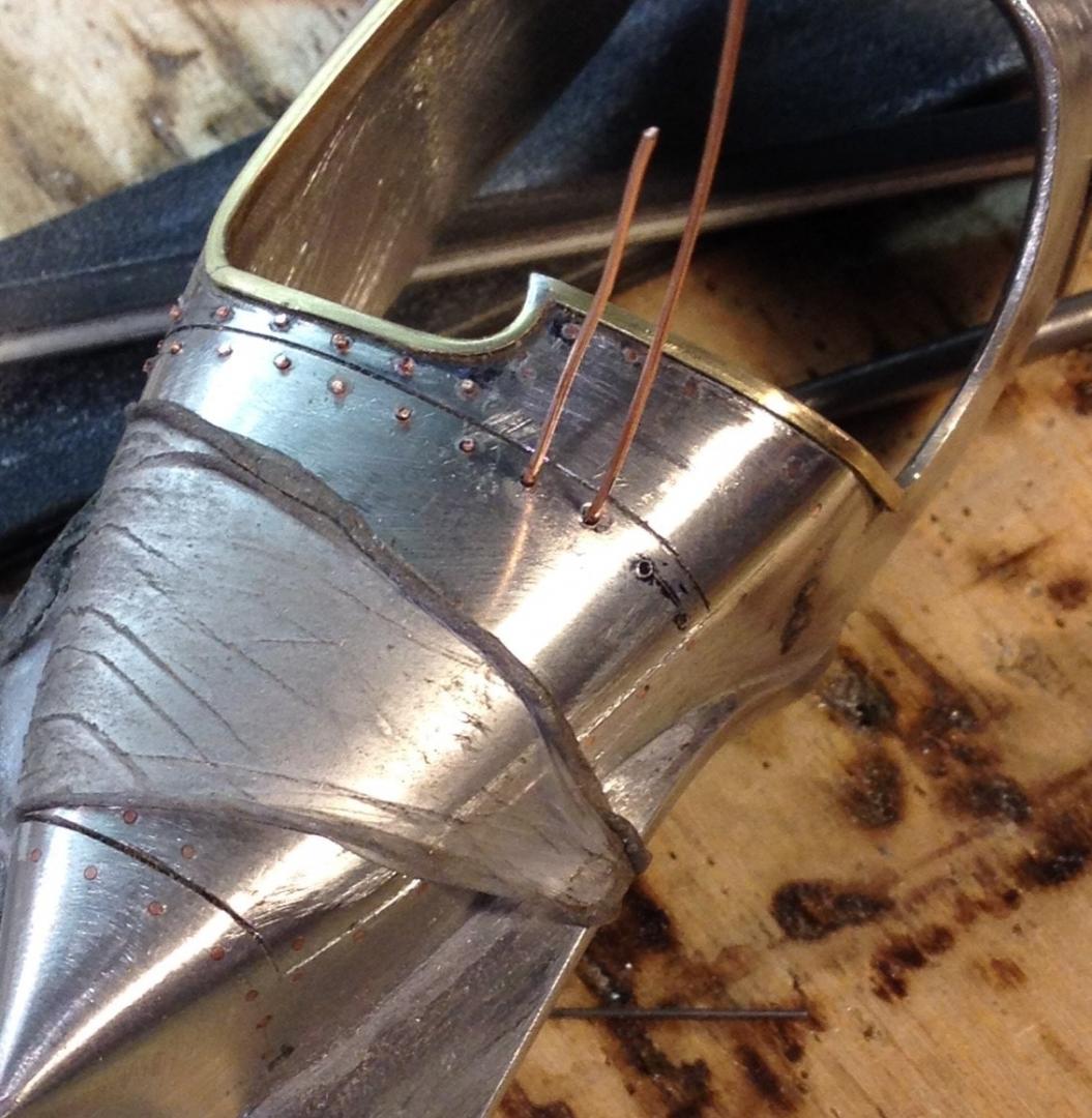

absmiami Posted February 15, 2018 Author Posted February 15, 2018 small update with the instr panel located I mocked up a support post inside the body - L shaped evergreen - to locate the run of the rivets over the cowl and of course broke another #76 - got three left ..... still a couple more rows of rivets on the body and then back to the bonnet for more .... rivets
absmiami Posted March 7, 2018 Author Posted March 7, 2018 March update more - lots more - rivet holes and rivets - following the outline of the cockpit cowling and the frame two more # 76 drills have bit the dust ...next - gotta enclose the under-side of the tail and make some frame/fit adjstments and make the perforated aluminum trim pieces that brace both sides of the cockpit the Indycal tachs are a bit too big for the dash - they were designed for a Bugatti and probably larger in 1/1 but I will order some 1/32 gauges that mite do the trick ... off to the Philly NNL .....
