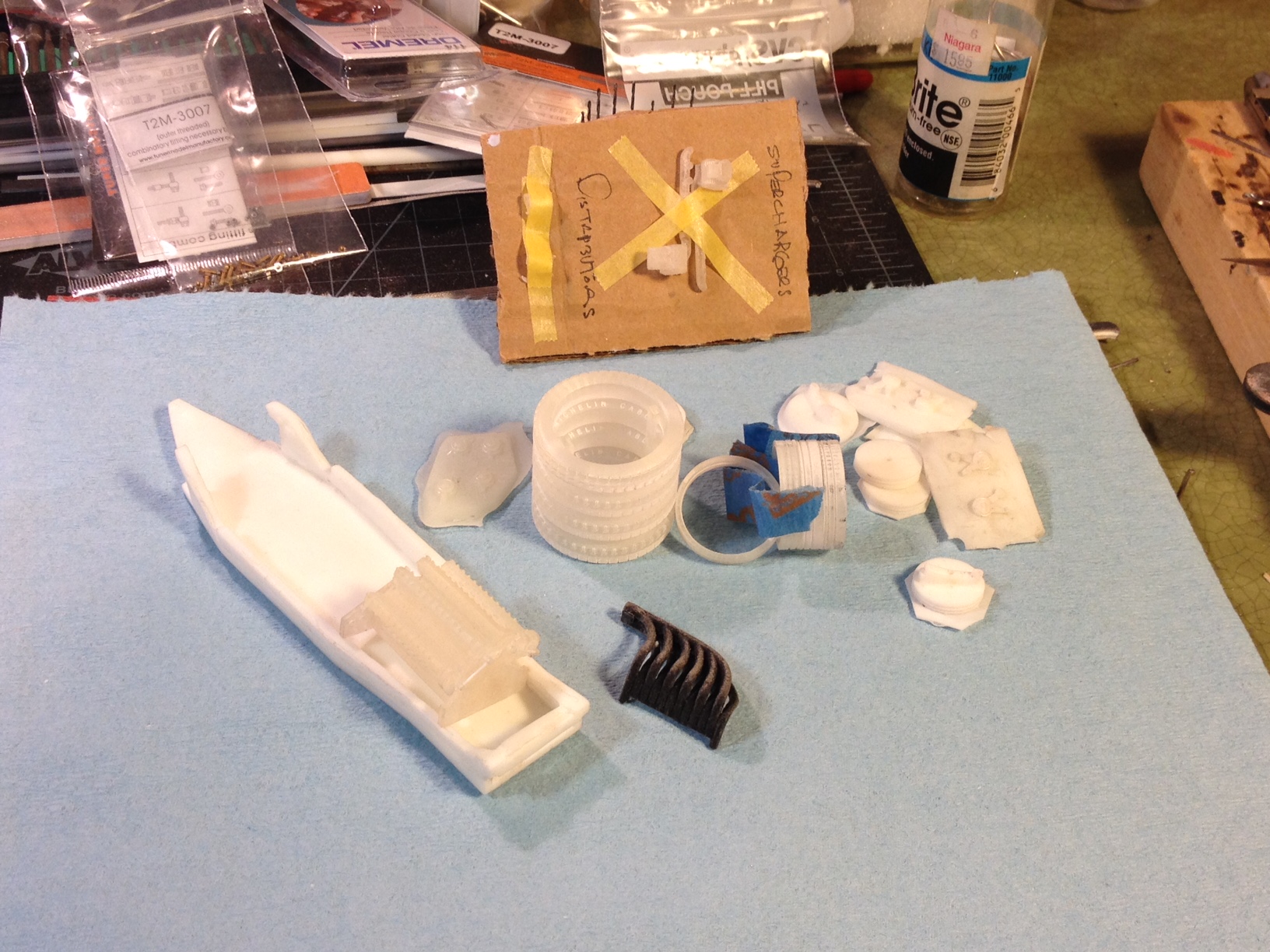

couple more shots - the translucent parts are 3D printed by Shapeways
these include the engine, exhausts, tires and wheel rims
other parts are resin casted
the body parts are white metal casted - partly because they look cool
- and partly because the car was finished with a turned metal pattern - EVERYWHERE -
I'll be scratch-building the other stuff
think I forgot to mention that this is 1/24 scale
try scratch-building that engine and exhaust manifold in 1/24th - lots a luck ...

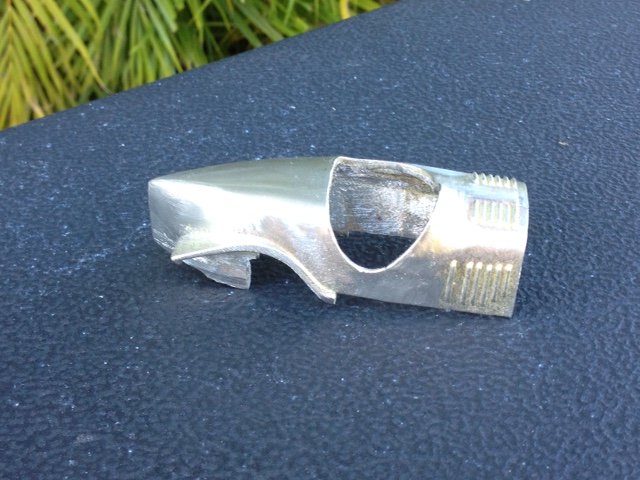

first prep work on body before making changes to build the restored car.
the opening for the cockpit was covered in a "film" of white metal - removed with steel cutting burs and metal files
removed the thick metal engine bulkhead and did some surface prep
and removed quite  a lot of metal flashing from the inside

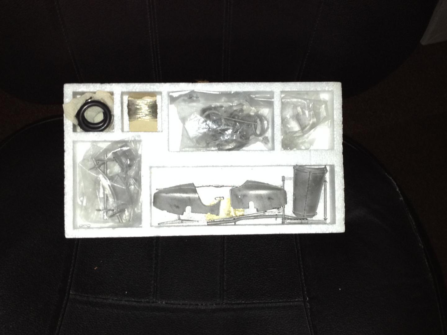

per the attached
good kits - similar to the 12 cylinder cars of '24 and '25
it's a curbside kit - but a good start
it was inching higher on my to-build list - until I got my hands on Pico's castings/printings
has a straight 8 cyl engine - the cylinder head looked a lot like the heads on the earlier car and shared a lot of design features
  • Like 1

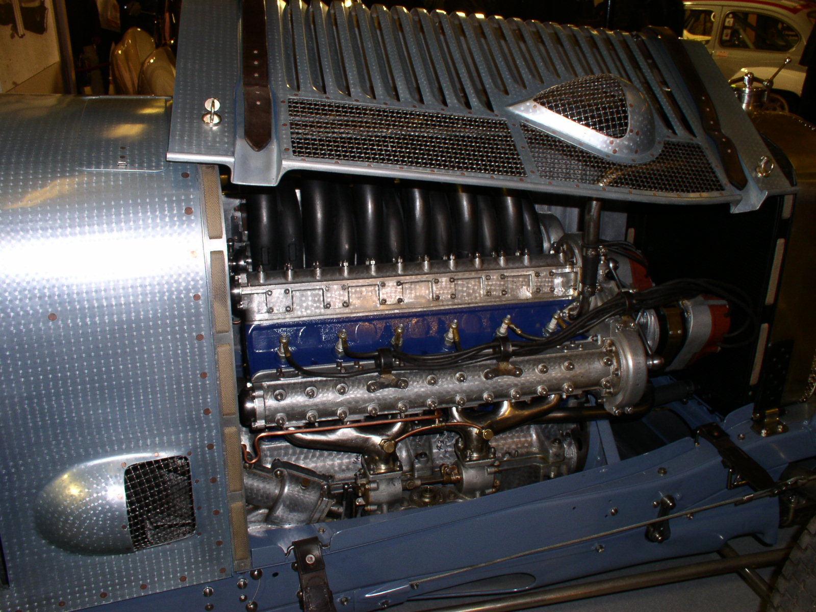

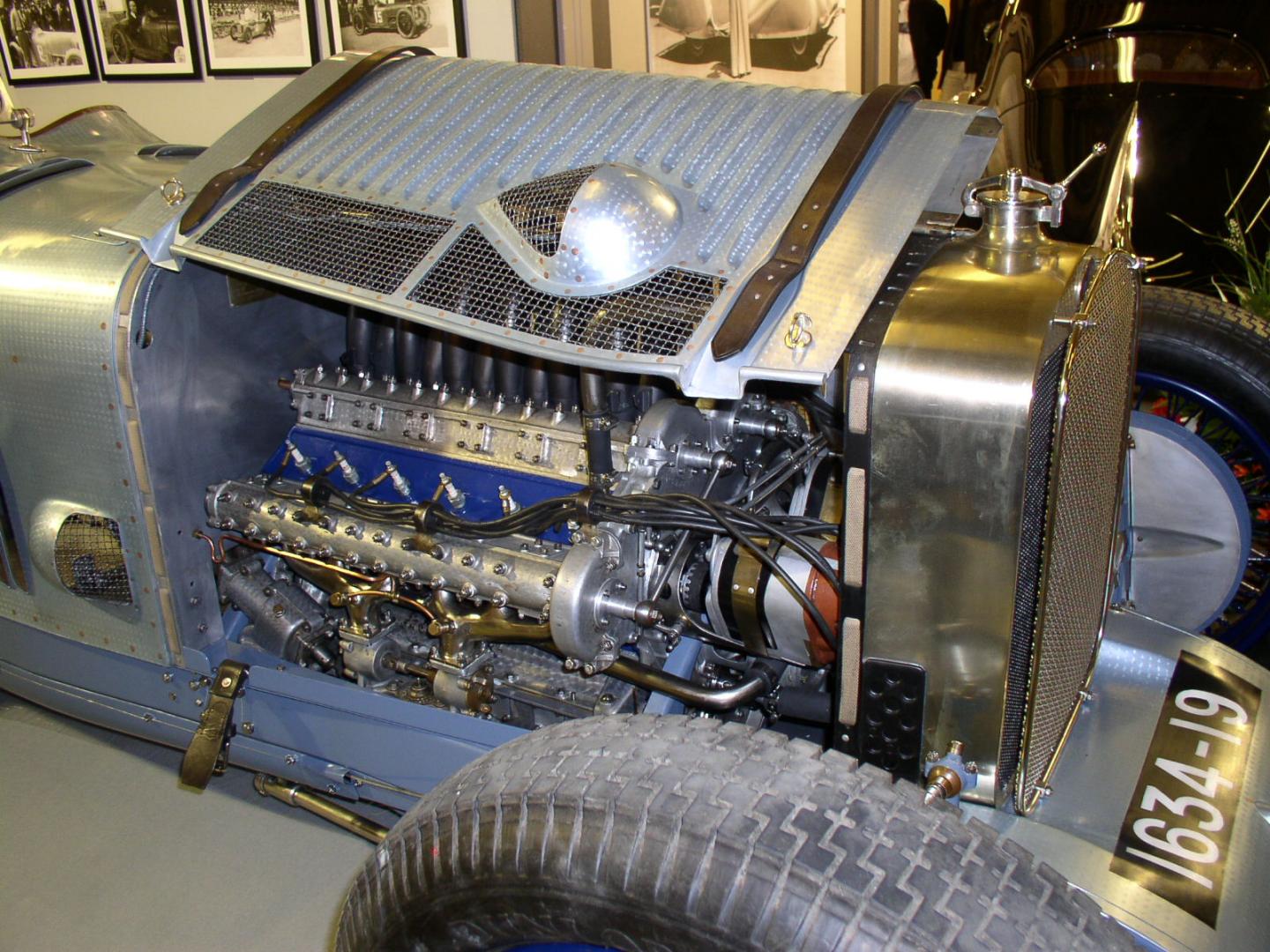

Wow, the famous Delage 2LCV in 1/24 .... where can I found the parts ? .... :wub:
I know the real car because I see it some times in different events in France. After its restoration, the owner show us this marvelous beast in the hillclimb race of Chanteloup-Les-Vignes in 2004 (oldest hillclim race in the world ... 1898) where I was the flagman and secretary during 10 years (1998 to 2008) and the President was my friend Patrick Delâge (great grandson of Louis Delâge). The sound of this car is one of my 7 preferates (12Cyl Delage 2LCV 1925, 8Cyl Delage 1500GP 1927, 8 Cyl Bugatti T59, 8Cyl Alfa P3, V12 Ferrari 250GTO, V12 Matra, V8 Ford 427,  ...etc).
5a5747834aba7_CC2004-(101).JPG.b73b7e27d972483b8240ad0b2f7e0df9.JPG here, you can see P. Delâge with the driver in 2004...
This car was in Retromobile (Paris motor show) two times in 2003 and 2012.

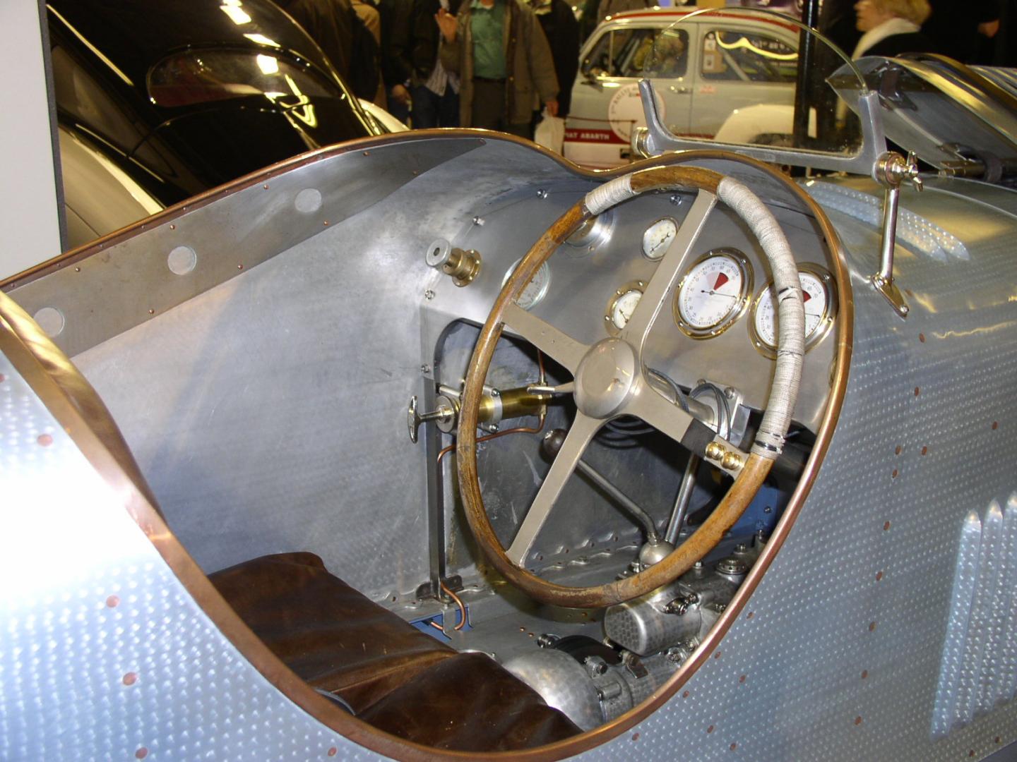

If you need detailled photos of this car, just send me your Email in PM and I'll send them to you ... like these ...
For information, note that the body has the same aspect as the dashbord of a Bugatti T35, T51 or T59 ... you can find decals to do it ...

well - now the plot thickens ...
Frederick:
very good pictures - I've d/loaded what is generally available on the web
- starting years ago when the car was first shown after it's extensive resto
but any of your shots can be posted as you have time - and they will all be helpful / instructive etc
Do you think the body rivets are copper ?  they appear to be in the photos
And how about the cockpit opening trim ? appears to be brass ??
regarding the parts:  they were "sourced" from Pico Elgin who lives in Atlanta - I will make sure that he sees your post
some or all of the parts could be available  - if he is able - his terms, obviously
dash:  I think that Indycals produces very good Bugatti dash gauges - they mite be the answer
Please ask Patrick Delage it the car will be back in the US any time in the next few years
perhaps at the Amelia Island event - my favorite concourse ...
  • Like 1
Link to comment
Andrew,

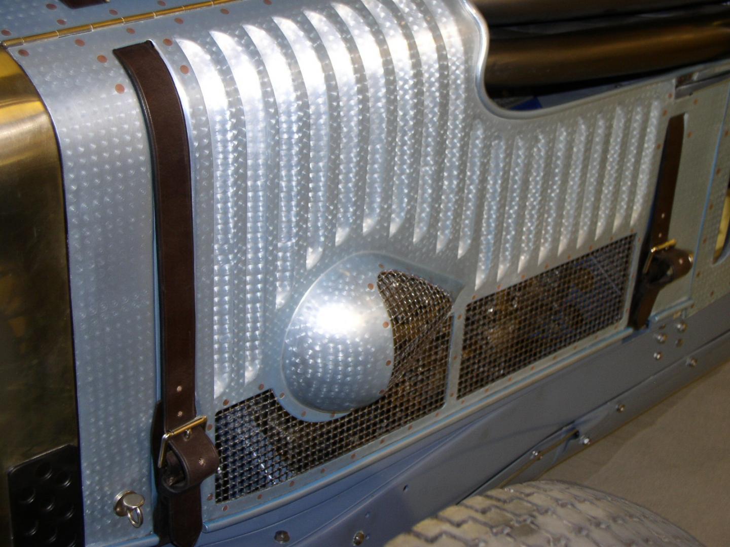

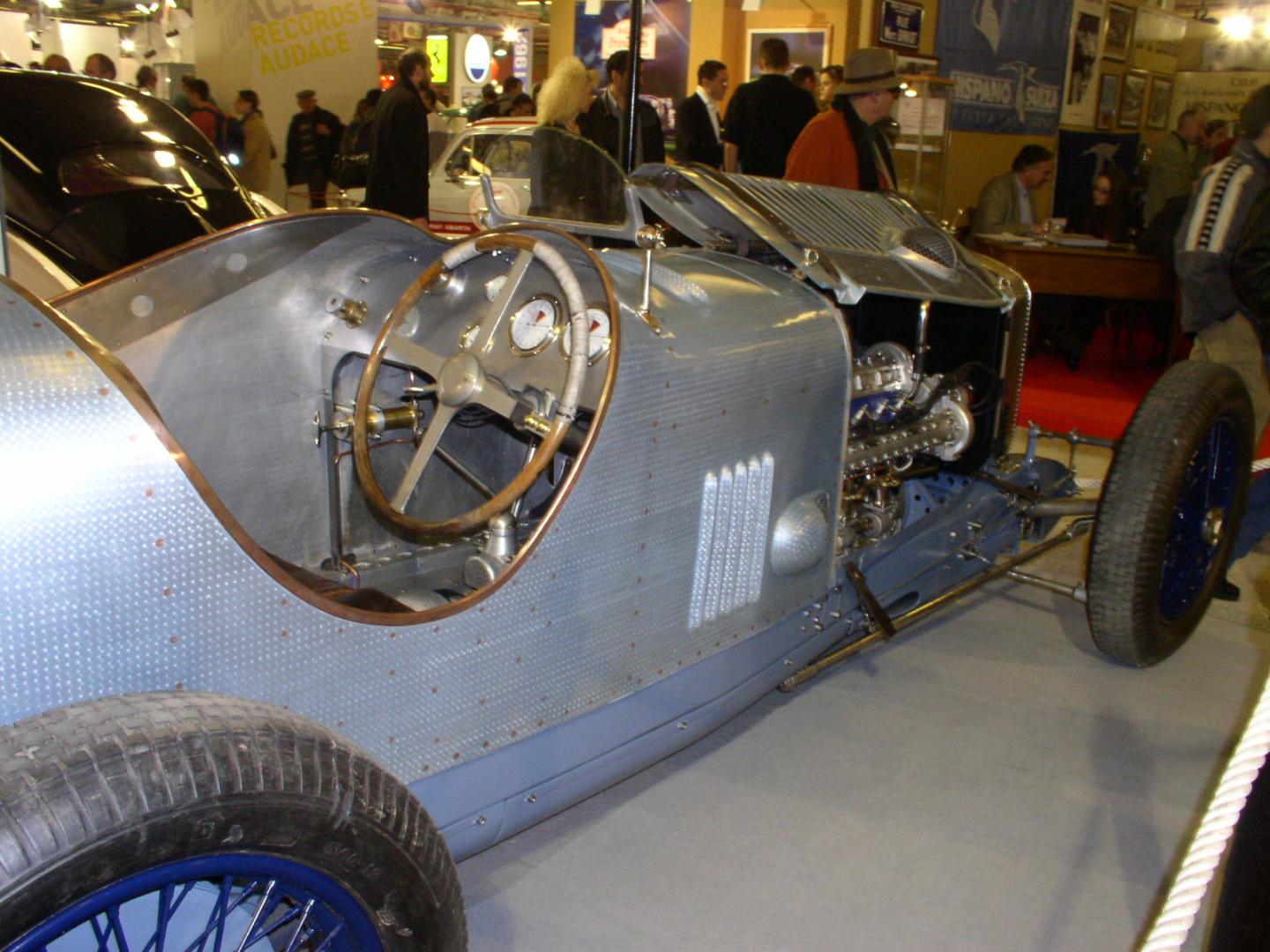

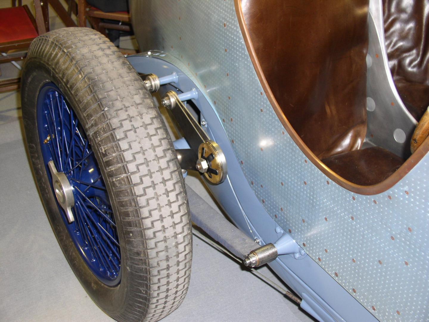

Yes, the restoration of this car was very expensive but I think that we can speak of a restoration/reconstruction for this car ... the story of this chassis is not so clear as the journalists say ...
You're right for the body rivets and the cockpit opening trim.
For the body, I speak about the aspect. It's hard to explain it in US language for me but i say that the texture of the aluminium body of the Dealge 2LCV is identical as the texture of a dashboard of a Bugatti T35 ...
You can find the decals to do it on Ebay ... http://www.ebay.fr/itm/FFSMC-Productions-Decals-1-24-Aluminium-Bouchonne-Petite-Planche/300643347270?hash=item45ffbd6b46:m:mCelEJWk7eb8_tajKcXMffA
Now, I hope that you see what I mean ...

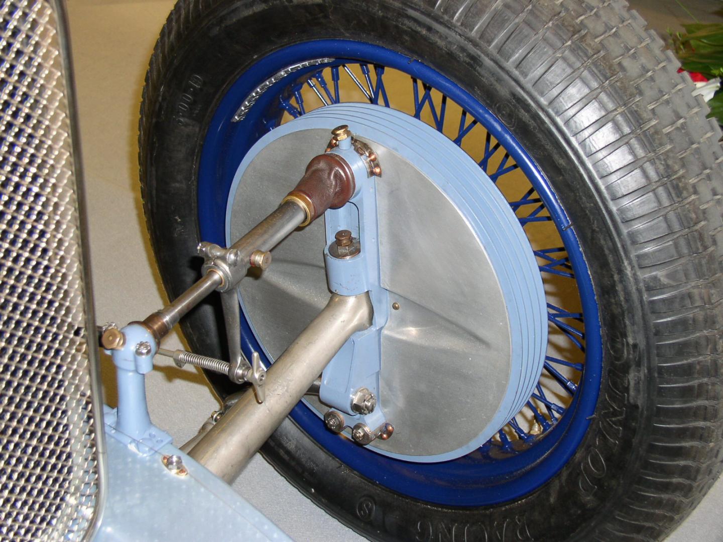

Some other photos ...
5a58ae7cf40ba_DelageV122L1924P2080045.thumb.JPG.55cd2d011b5d3822f83fee71e29d601c.JPG5a58ae7f58944_DelageV122L1924P2080058.thumb.JPG.afb0b2c52cee975644230f3b68127fa1.JPG5a58ae8198497_DelageV122L1924P2080061.thumb.JPG.73c0c1f4250549c784af5c5c5e528987.JPG
5a58aee8b7596_DelageV122L1924P2080048.thumb.JPG.abe2dd92e519185c6c623dc4ed2613e1.JPG5a58aeebb12c3_DelageV122L1924P2080049.thumb.JPG.a9082e7899fd75f9ed9c932da57748d9.JPG

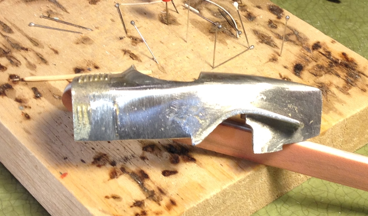

thing 1
the '24 car had a raised lip on the cowling in front of the riding mechanic - the '25 car did not, so neither did the casting
I melted a bunch of low temp - "tix" solder onto the lip - a small pile
then sanded and filed into shape per the above photos
next I am removing some louvers and reshaping the cockpit opening
  • Like 1

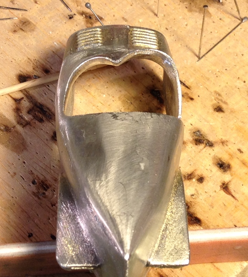

the '24 car had a recess in the body work so that the riding mechanic sat slightly behind the driver
so with more files and steel cutting burs I have made the recess
and I removed some of the louvers - the casting is accurate for the 25 car  - which ran with added louvers
the last shot has some taped guidelines as I began to cut narrow lines to simulate the shape of the fuel tank cover
  • Like 1
