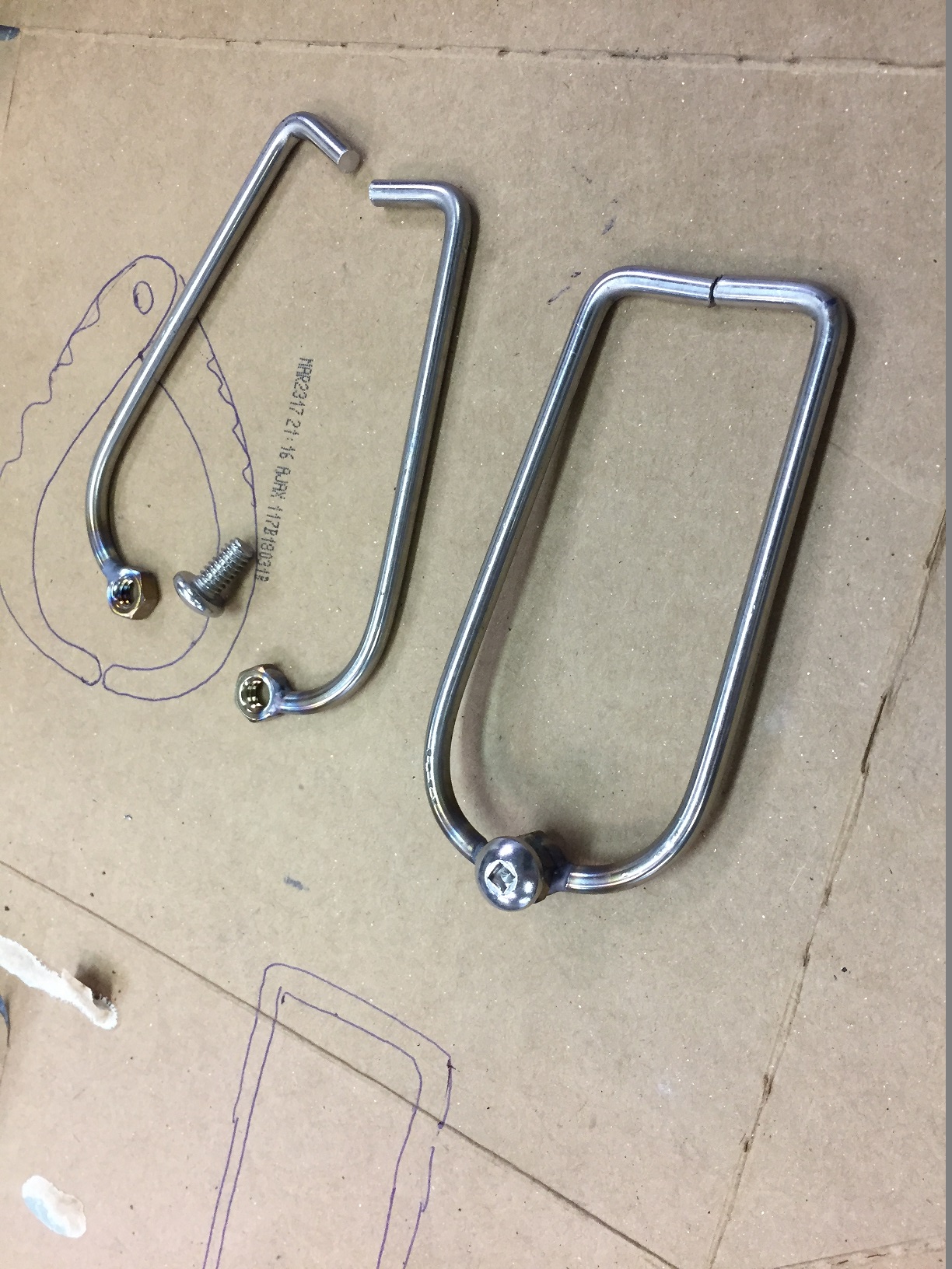

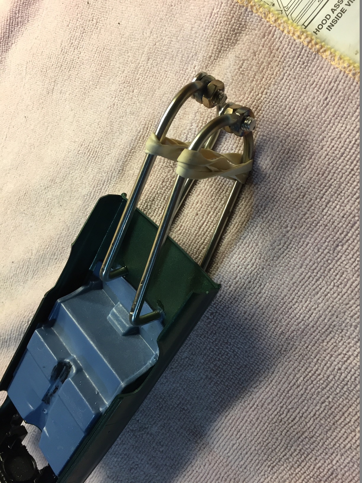

NOBLNG Posted January 7, 2018 Posted January 7, 2018 (edited) Here are a couple of long reach clamps I made to help glue the interior into this GTX. They are pretty handy and the clamping force can be varied by how many times the rubber band is wrapped around. I put some self adhesive gasket on one leg to protect the paint. Edited January 7, 2018 by NOBLNG picture change

NOBLNG Posted January 12, 2018 Author Posted January 12, 2018 (edited) Yes, I made them myself. they are 3/16 stainless steel rod tig-welded to 1/4" s/s nuts. The inner nut is drilled through so the bolt only threads into the second one so it doesn't bind. They would not have to be stainless, I just had it on hand. At the top of the first picture you can see my sketch of my original idea. I was going to cut them from 1/8" aluminum with a jigsaw. They would not require any welding. Edited May 12, 2018 by NOBLNG
