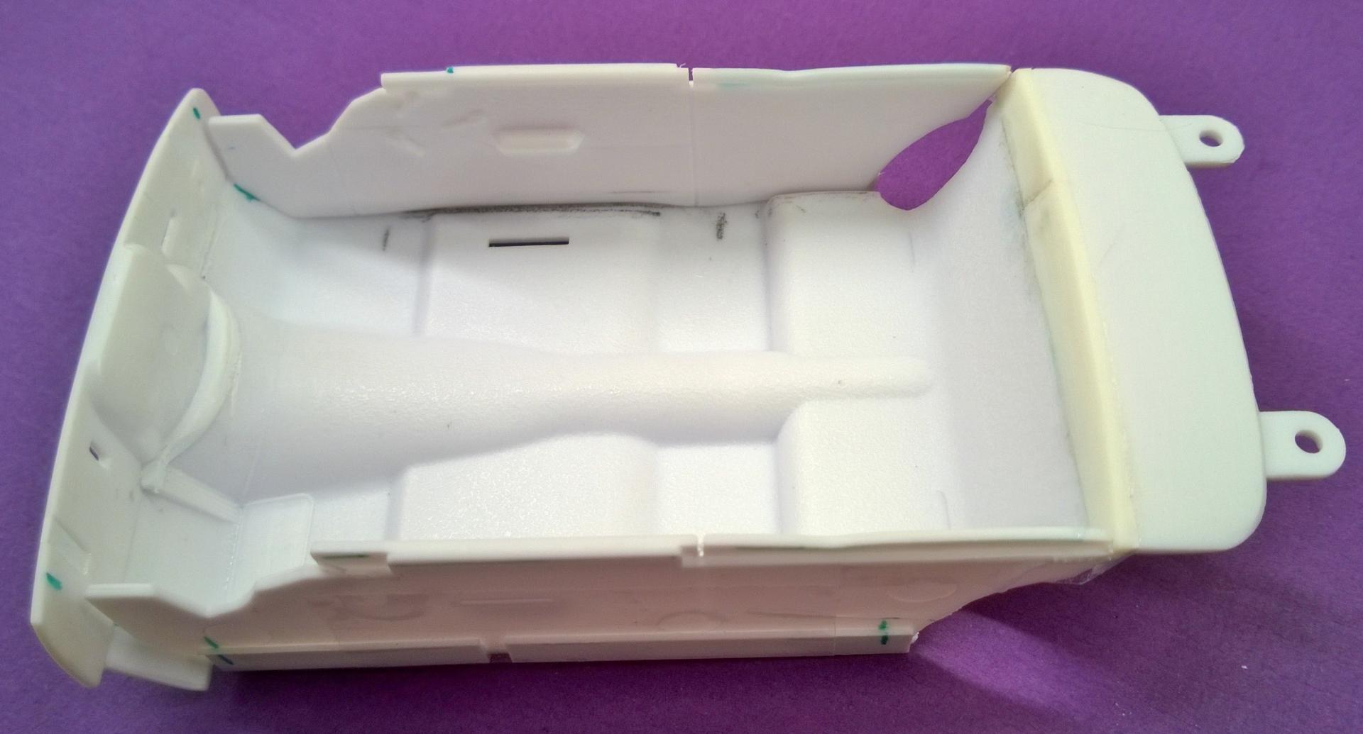

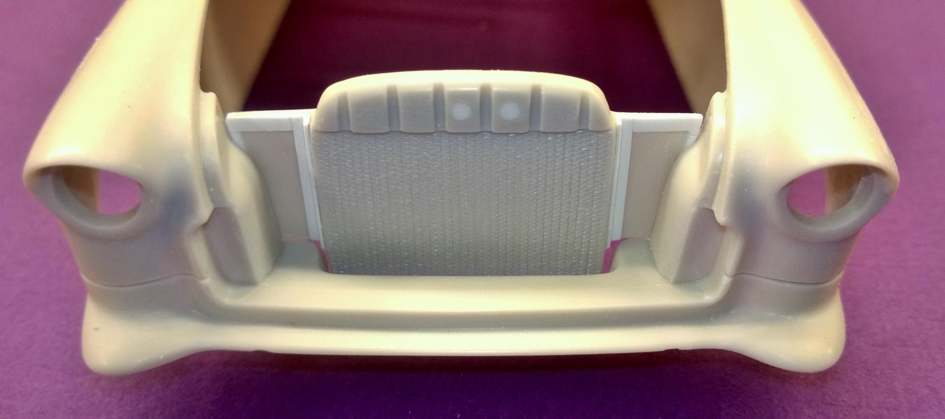

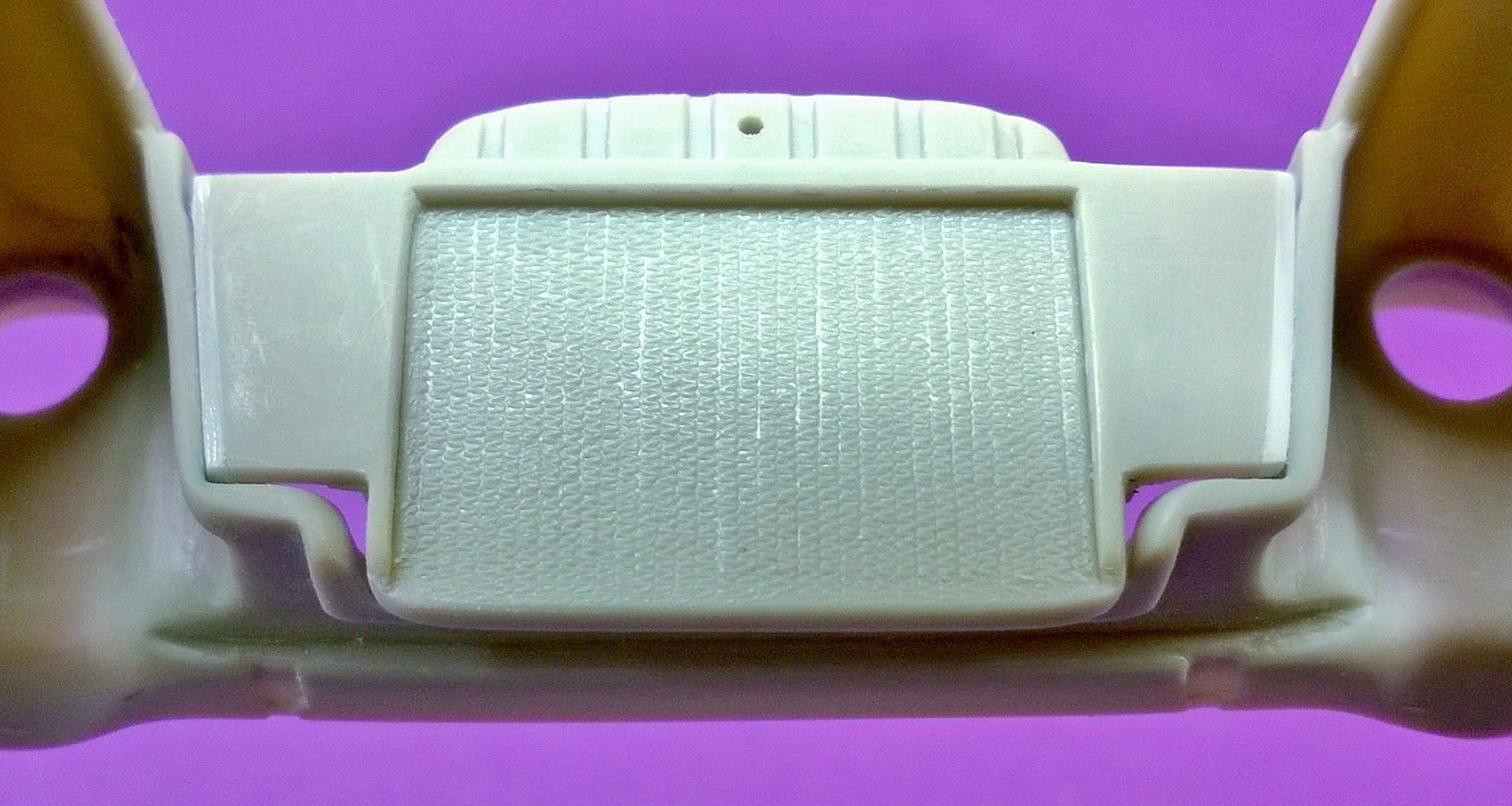

Casey Posted February 28, 2018 Author Posted February 28, 2018 On 2/22/2018 at 10:58 PM, ChrisBcritter said: Just checked my stash - these tires are from early MPC kits (my set came from an original-issue '60 Vette gluebomb). Thanks, Chris. I've been slowly pecking away at the interior, repeatedly trimming, sanding, and test fitting the door/quarter panel pieces and floor in the body shell until the fit is just right. I added some right angle tabs to the edges of the floor to more positively retain the side panels, and that helped immensely, so the fit of those three pieces is very good now. I had to add some material to the edge of the AMT dashboard, but it looks like it should work just fine with the Revell '57 side panels after I add some additional filler pieces. Test fit progress: I widened the radiator support a bit to get a more positive fit, but lost some detail in the process. I'll add some right angle pieces or similar, to replicate what someone might've done when moving the radiator ahead of the support for engine clearance. In the below two images you can see where the upper radiator hose bung was plugged (I can't recall why there were two holes?) and the mold seams removed. I think I'll add some tank detail to the bottom of the radiator, too, as that area is highly visible now that part of the splash pan has been removed: I received a set of bucket seats from the MPC Jeep CJ-2A kit (thanks again to Paul Gardner ) and cleaned up and re-shaped one of them, though I still need to make some additional brackets to raise them up a bit. They are a very basic, lightweight seat which I reasoned could have been easily found in a salvage yard back in the day, and they'd be much lighter than the stock bench seat anyway. Not sure how I'll finish them, yet:
Muncie Posted February 28, 2018 Posted February 28, 2018 looking good! Actually, your core support is pretty close as it is - Stock, V-8's had the radiator mounted aft of the core support and inline 6's had the radiator mounted ahead of the core support. It's a simple swap to change the core support and radiator for more engine clearance.
Casey Posted February 28, 2018 Author Posted February 28, 2018 Thanks, Steve. I guess I lucked out this time. I had seen a bunch "flipped" like this on various Tri-Five.com projects, but never read what you mentioned.
