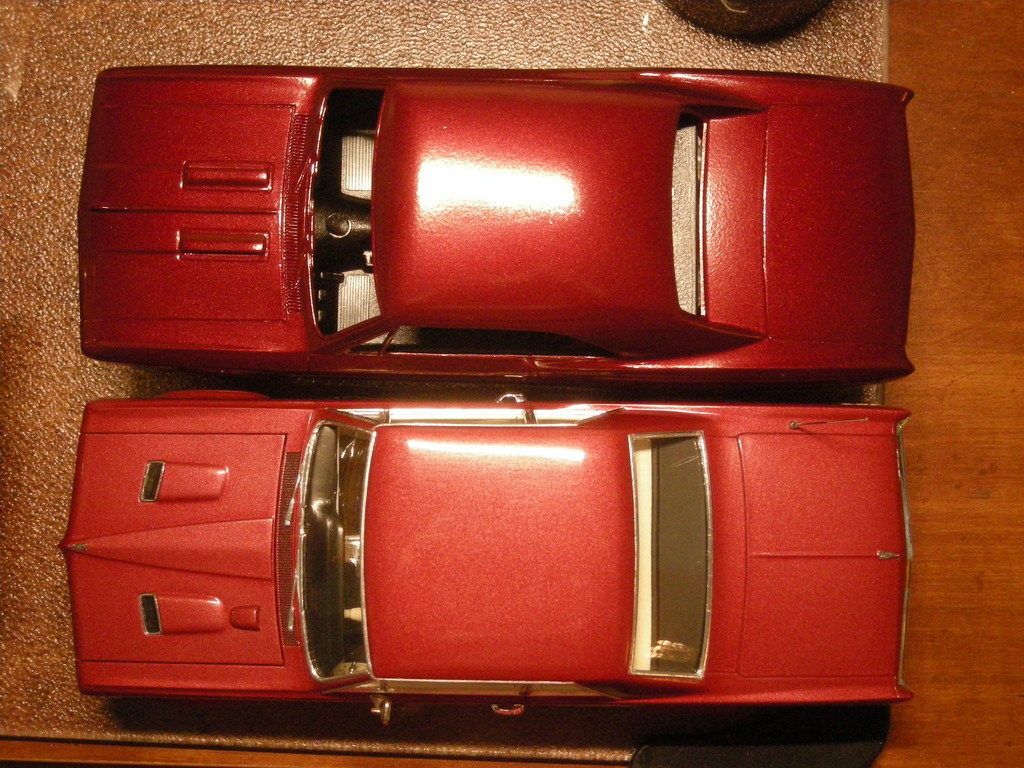

Geno Posted April 11, 2018 Posted April 11, 2018 (edited) I picked mine up at a model show in Toledo for $12.00. It was the black version. This is the route I went using the '64 GTO chassis. I wanted a stock '66 to add to my 1/24 diecast collection. I'm going to use the chassis and other parts plus the parts from the '64 GTO and do a GTO street machine. I heard all the horror stories about this one but I wanted to show folks it can be made into a nice model given a little work. This is how it compares size wise to the Monogram 1/24 '64 GTO. Edited April 11, 2018 by Geno

Fat Brian Posted April 12, 2018 Posted April 12, 2018 1 hour ago, Geno said: I picked mine up at a model show in Toledo for $12.00. It was the black version. This is the route I went using the '64 GTO chassis. I wanted a stock '66 to add to my 1/24 diecast collection. I'm going to use the chassis and other parts plus the parts from the '64 GTO and do a GTO street machine. I heard all the horror stories about this one but I wanted to show folks it can be made into a nice model given a little work. This is how it compares size wise to the Monogram 1/24 '64 GTO. That looks great, I've wanted to do a similar conversion and didn't think about using the GTO chassis. Where did you get the stock hood from?
Geno Posted April 12, 2018 Posted April 12, 2018 (edited) Hi Brian, I cut out the section where the hood scoop went and grafted in the section from a Lindberg '66 Chevelle hood then scribed the hood lines in as I built this as a curbside. I never liked the grille, so I cut it out and used a photo-etch grille as well as the rest of the PE set from Model Car Garage. The wheels came from a Monogram '70 Chevelle kit. The GTO chassis worked great, if I remember correctly all I had to do was some minor filing at the front of the chassis to fit the shape of the Chevelle front end and a little surgery for the shape of the rear seat fitment. The separate outside door handles, wipers, mirror and antenna were just spare parts box items. Edited April 12, 2018 by Geno
Fat Brian Posted April 12, 2018 Posted April 12, 2018 1 hour ago, Geno said: Hi Brian, I cut out the section where the hood scoop went and grafted in the section from a Lindberg '66 Chevelle hood then scribed the hood lines in as I built this as a curbside. I never liked the grille, so I cut it out and used a photo-etch grille as well as the rest of the PE set from Model Car Garage. The wheels came from a Monogram '70 Chevelle kit. The GTO chassis worked great, if I remember correctly all I had to do was some minor filing at the front of the chassis to fit the shape of the Chevelle front end and a little surgery for the shape of the rear seat fitment. The separate outside door handles, wipers, mirror and antenna were just spare parts box items. Thanks for the info, this made my job a lot easier.
