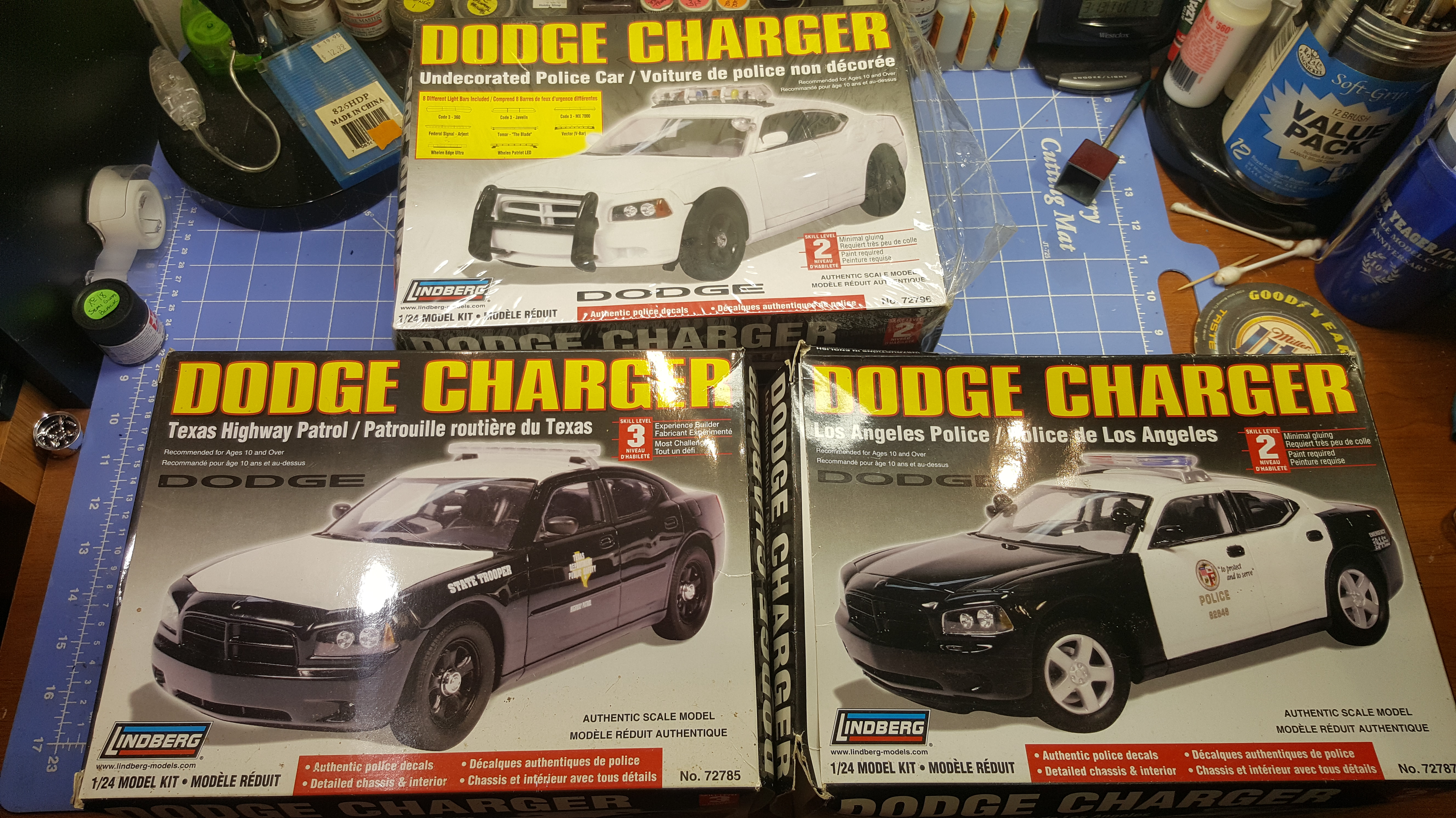

On 3/11/2018 at 7:39 PM, Renegade said:
I would like to see a parts pack of emergency light bars. Could be used on police, ambulance, wreckers, service trucks, and I'm sure a few other applications.
On 3/11/2018 at 7:46 PM, martinfan5 said:
No need for that in the parts pack, light bars are very easy to get right now.
Yes, especially if you get any of the Lindberg Dodge Charger police cars from maybe around 2010 or in that general timeframe. Every kit, though the "plain" car was the only one to actually advertise it, they all come with 8 different lightbars.
No kidding, I probably bought close to a 12 of them, I have a life time supply of lightbars lol
