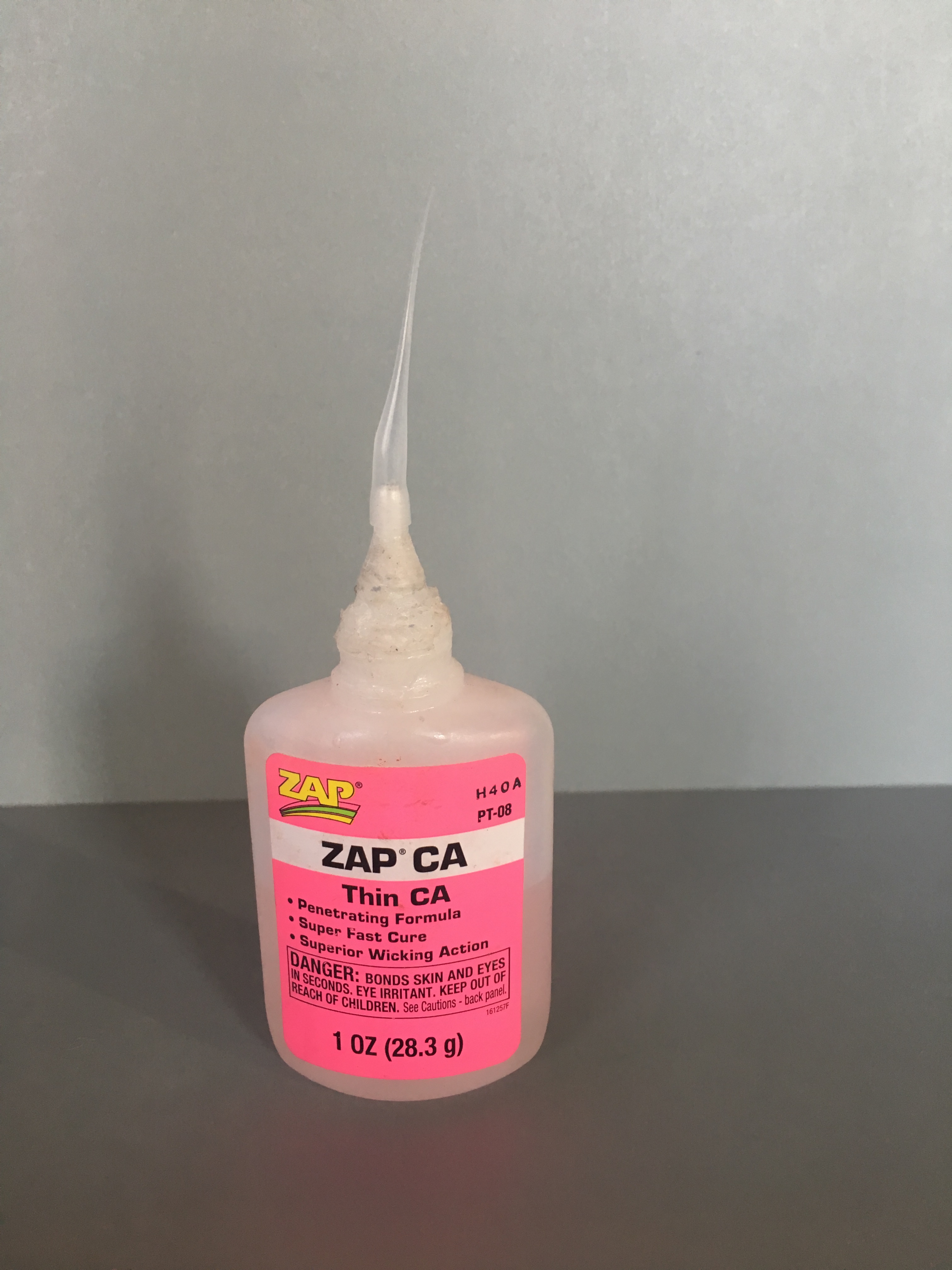

aurfalien Posted March 14, 2018 Posted March 14, 2018 Hi, I love my ZapAGap but the container sucks. I apply just a tad to very small pitch fork looking tool which works wonderfully in precise application. But in doing so, drops run down the side of the bottle and eventually sort of ruin it. Also the little needle sized tip they provide is not easily capped shut. Does any one have a source on better containers or simply how to better manage this?

aurfalien Posted March 23, 2018 Author Posted March 23, 2018 Hi, So the Zap Flexi Tips are working really well. They should include a few with the product itself. But they are pretty darn cheap on there own. The tip is tiny with an O.D. of .5mm.
