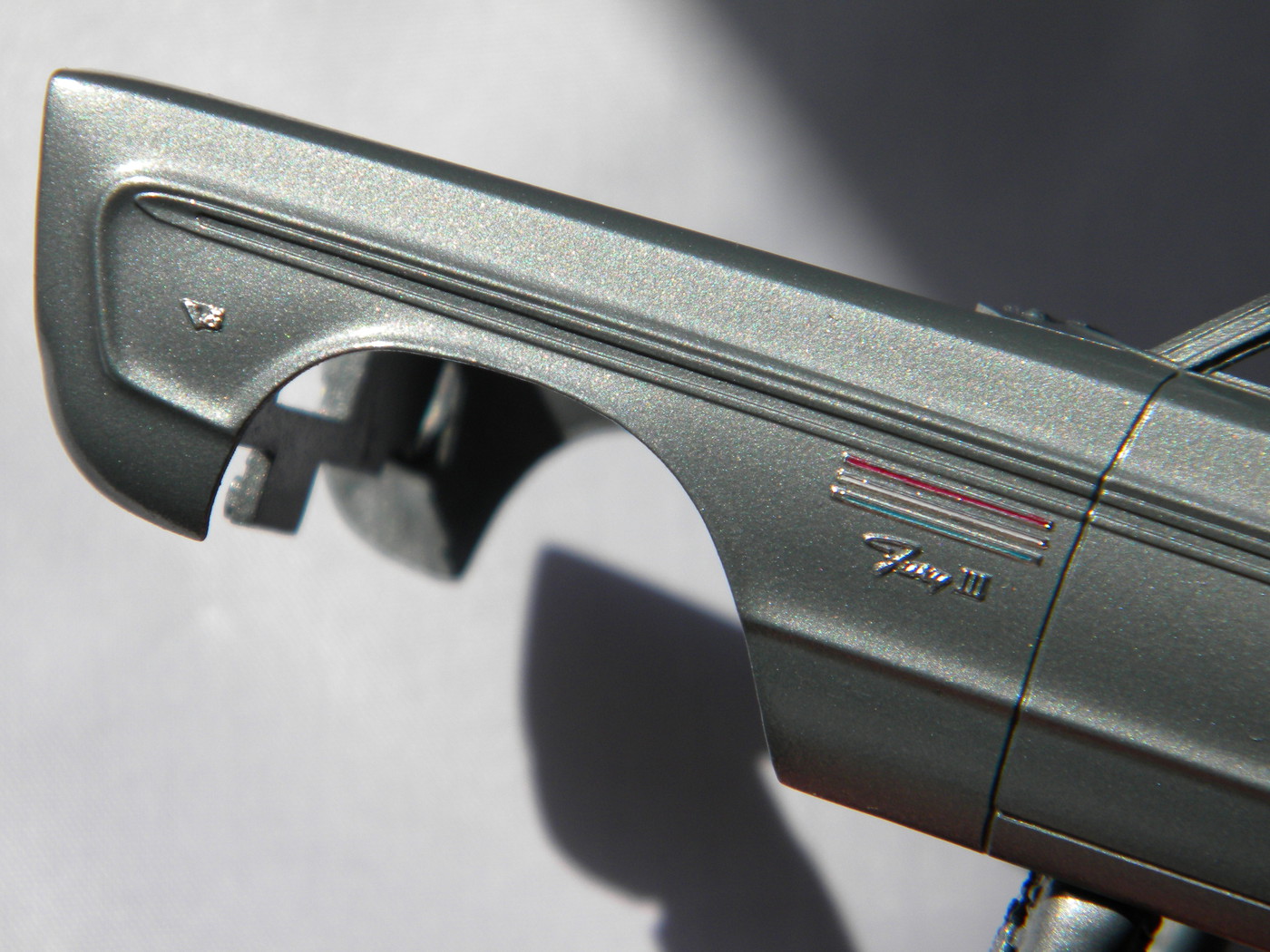

StevenGuthmiller Posted March 31, 2018 Posted March 31, 2018 1 hour ago, BigTallDad said: I use a piece of balsa that has been soaked in thinner...the balsa is more porous and softer, reducing the risk of scratching the foil. 1 minute ago, Snake45 said: That sounds like an excellent idea! I actually start with one of those small cone shaped Tamiya swabs to loosen & remove most of the paint. Then a sharpened tooth pick to get the edges & details. Another thing to remember guys, if you plan on polishing off the paint, one slight detail that you might miss, (and this may not be important to some) is the fact that the paint will still cover the sides of the script. It's a little difficult to describe, but the paint will extend from the body up the outside edges of the script. Polishing will not address this, & thinner will not eliminate it all, but with a sharp tooth pick & a little thinner, you can get a little ways farther down the sides to get closer to giving the script the "mounted on the surface" look, rather than a "peeking through the paint" look........if any of that makes sense!! A little hard to see things well in these pics due to the body color, but this is my latest attempt. Steve

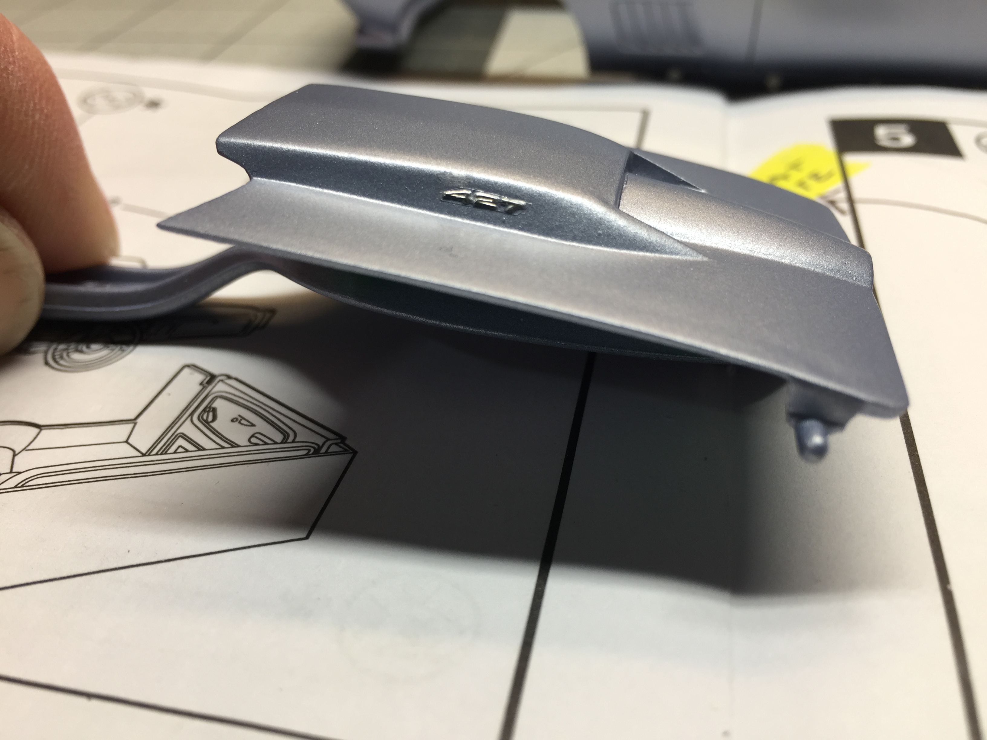

NOBLNG Posted April 4, 2018 Posted April 4, 2018 Thanks for the foil and Balsa wood tips Guys! My very first attempt turned out pretty good I think. I used the eraser end of a pencil to press the foil down between the numbers. The Balsa slightly dampened with lacquer thinner loosened the paint, and a light rubbing with dry balsa polished the letters up nicely. I did not attempt to clean the sides of the script this time, as it is quite shallow and I did not want to risk having to paint this hood a third time.

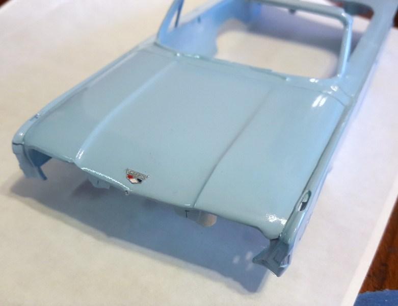

StevenGuthmiller Posted April 4, 2018 Posted April 4, 2018 You can hone this technique to do some pretty remarkable things. One of my most successful attempts was on this extremely faint '61 Buick trunk badge. Steve
