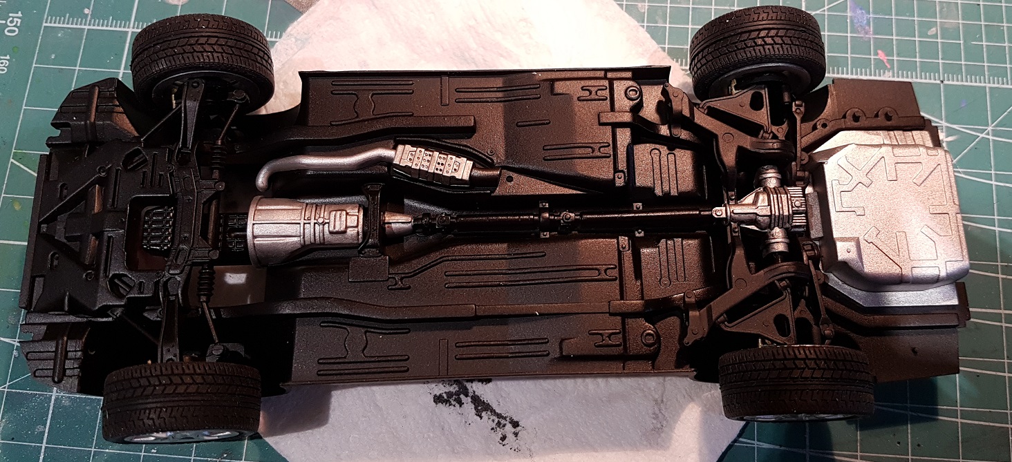

Photos are Box art, Chassis completed & misalignment of the exhaust box with the body shell shown!

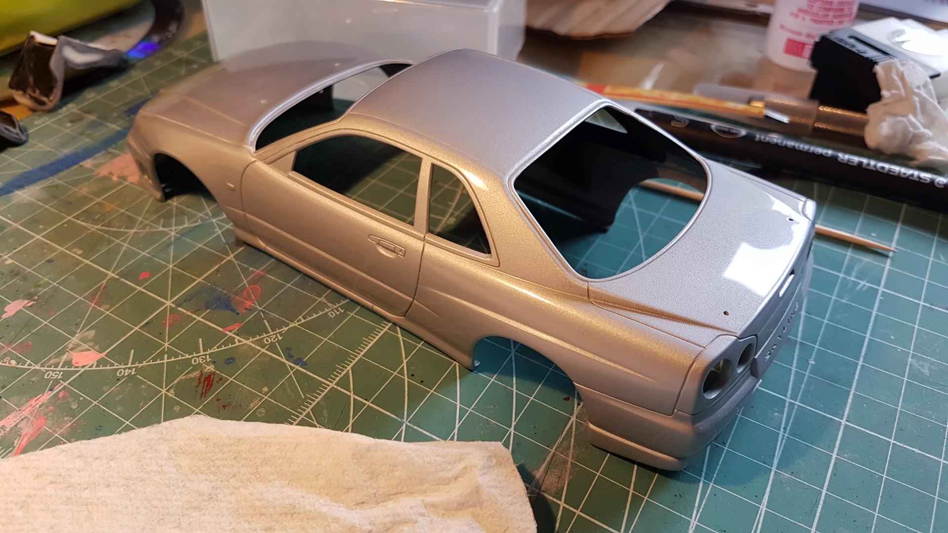

Body is sprayed in Tamiya Aerosol and Zero 1K 1 light coat & 2 heavy coats

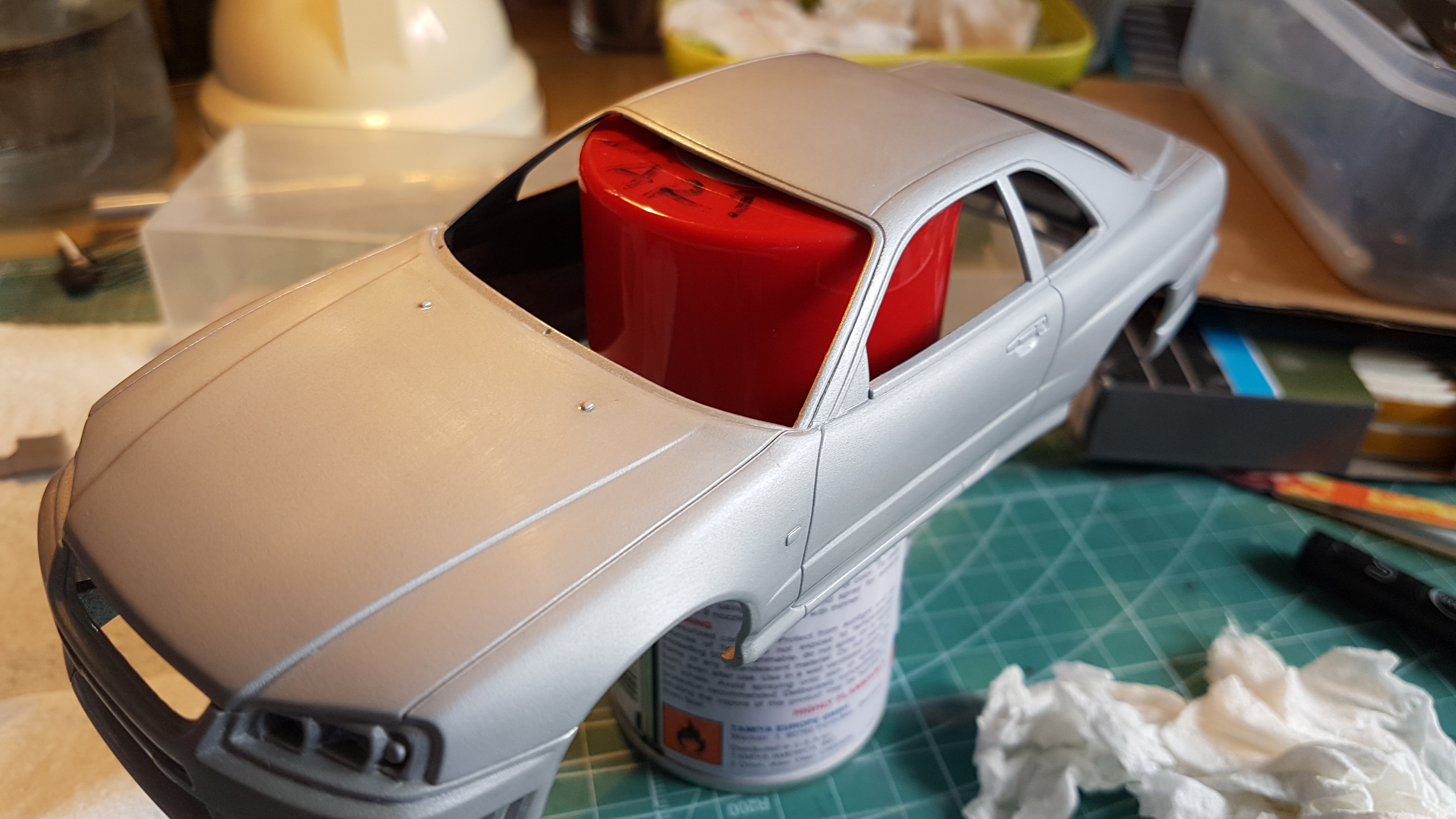

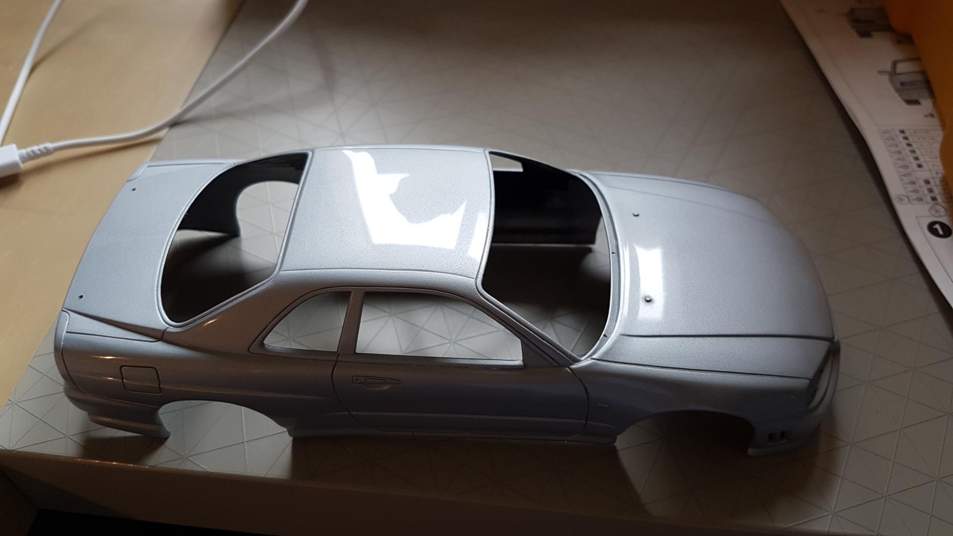

I've now sanded and polished out this shell.
probably my most successful polish ever. I only burned through in a couple of areas, and it's minor enough not to try to repair.
As painted: 5af0852a86cd0_1-Aspainted.thumb.jpg.5d9bd9fea3bbd4211038d3bfe919997d.jpg

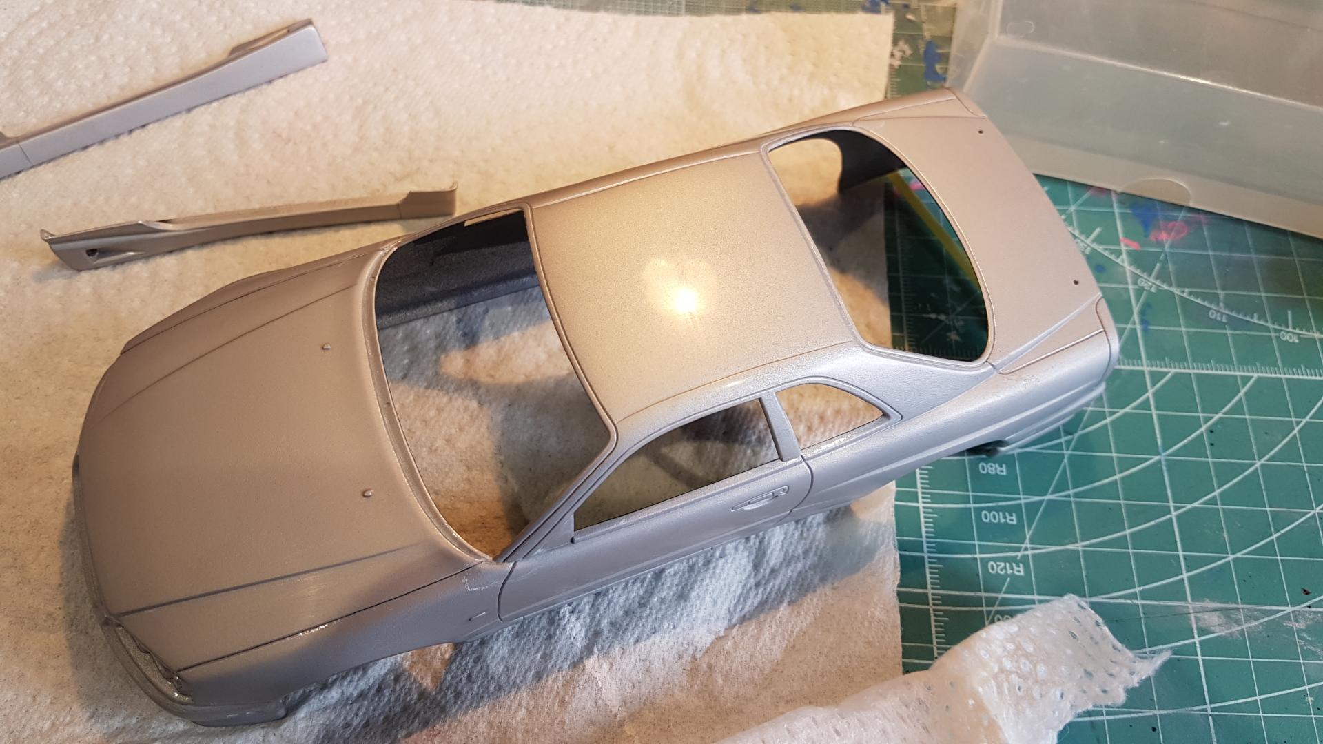

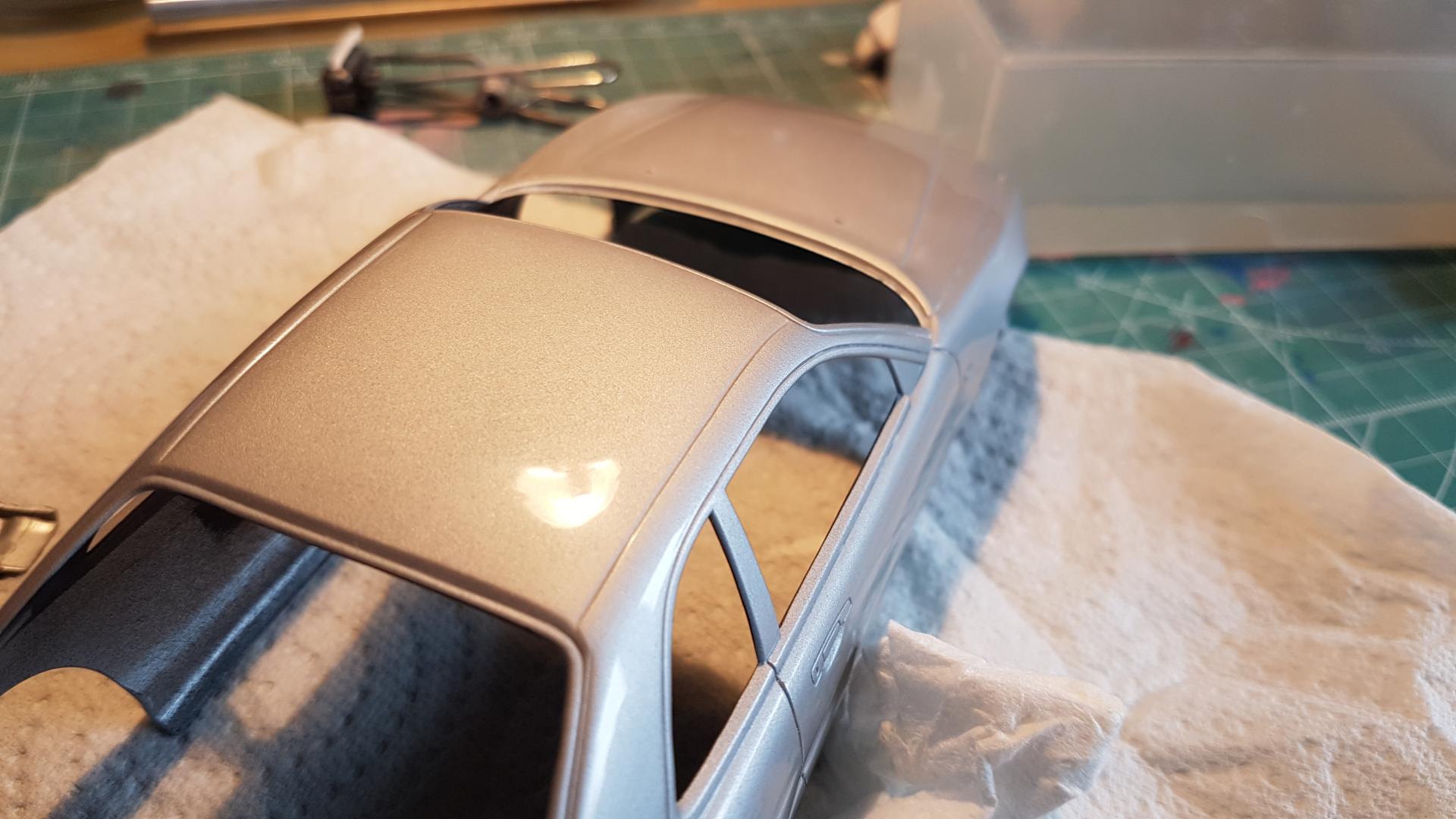

process was:
Tamiya 2000 grit
Micromesh 3600 grit:
Micromesh 3200 grit:

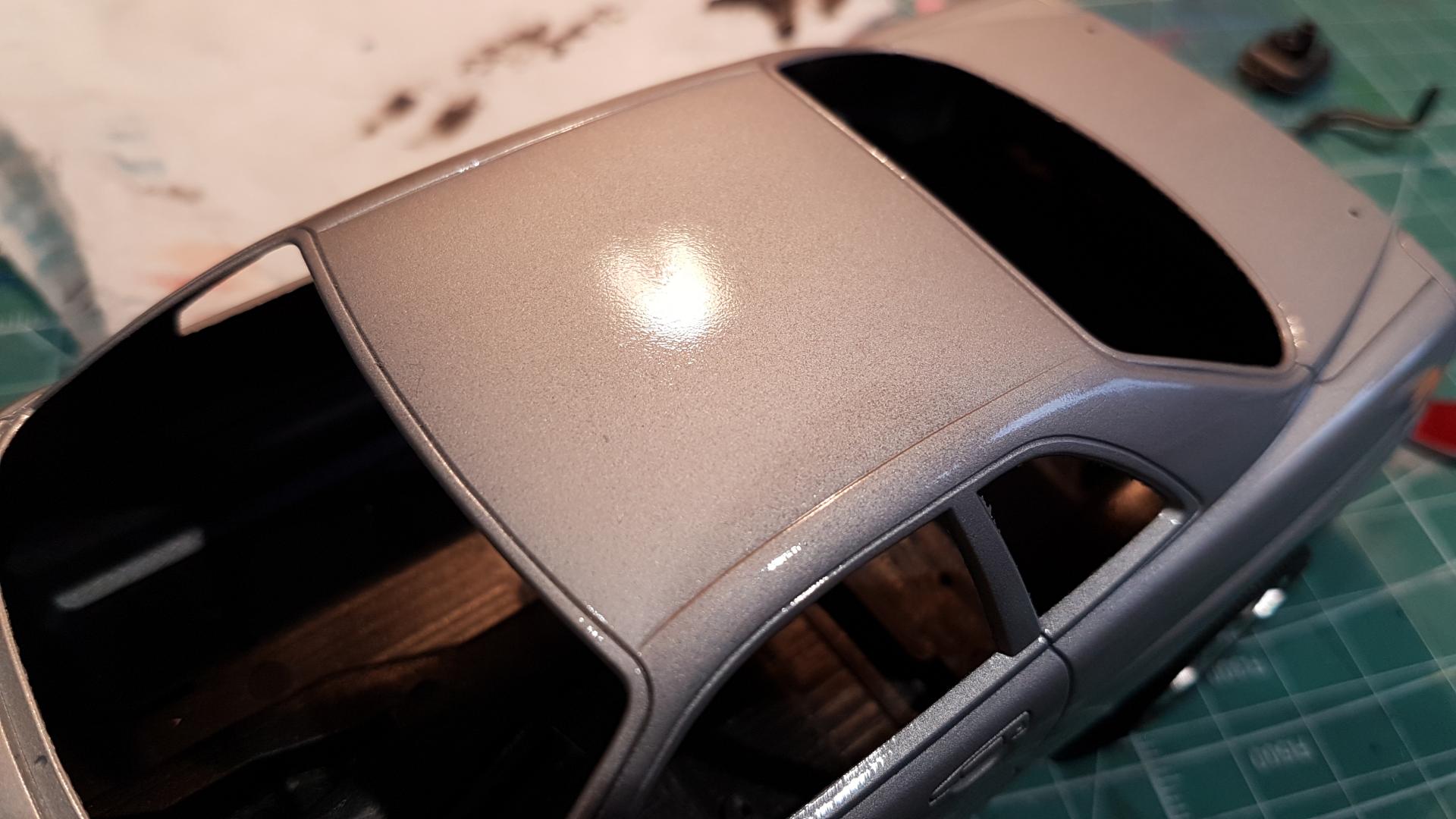

Nuvous Heavy Scratch remover:

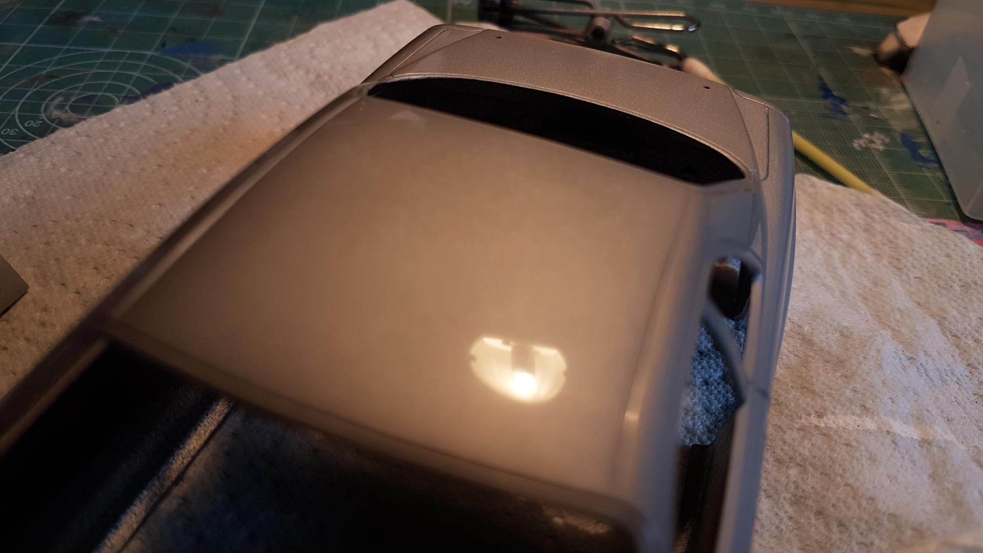

And then Nuvous Fine Scratch remover:
5af0854138a3e_6NovousFineScratch1.thumb.jpg.d004a4f5dc67885c69d0525ff1dec3e0.jpg5af0854690348_6NovousFineScratch2.thumb.jpg.ca956d5acf0aa016b3d17445867fba04.jpg5af0854c34544_6NovousFineScratch3.thumb.jpg.3181ed712441e06dc975ff716f2eba3e.jpg
I will detail it, then apply the final clean and wax...

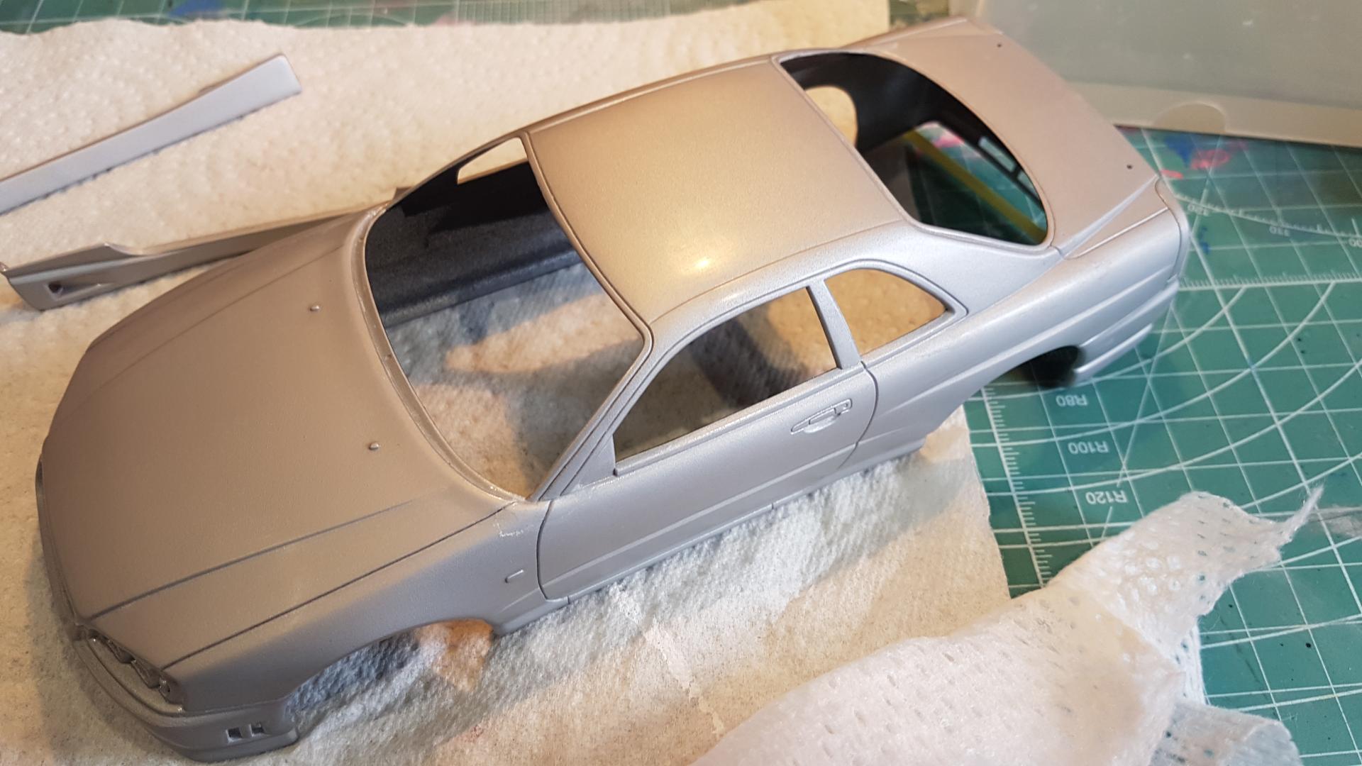

Soooo much work o nthis over the last month, but not much to show.

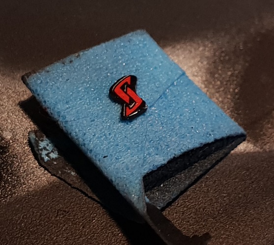

One small detail - the badge - the decal will not work on the PE mesh, so I made a little "S"for it...
It feels like such a bad thing to do - but I left the skirts until after the painting - as I wanted to put a bit of PE mesh in the gap
it's been scrapped ready for attachment of the skirts...
2 hours ago, DiscoRover007 said:
What happened to the paint?! You’ve done a brilliant job so far. That’s a nice silver paint job
I scrubbed it off to attach skirts!
Thanks for the compliment on the silver...!

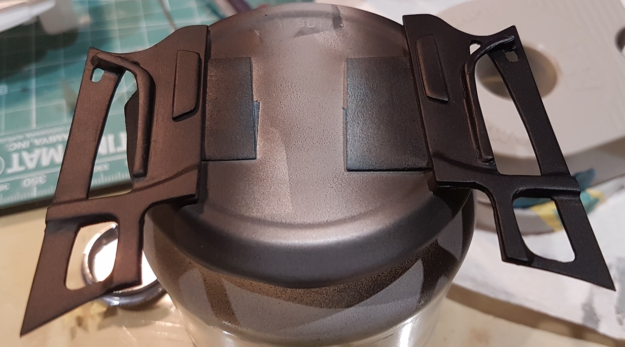

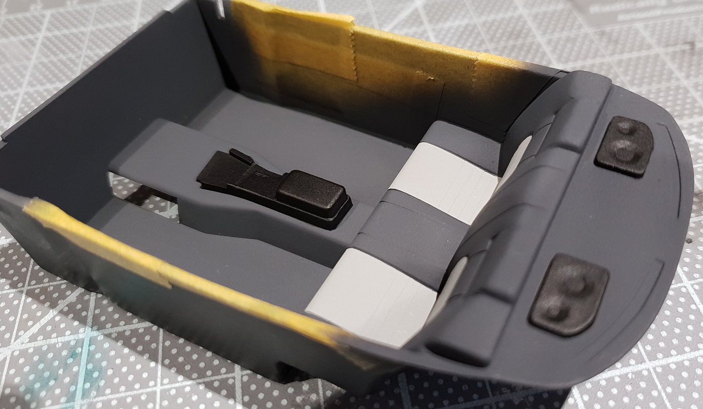

Interior is coming along nicely, but slowly. The scratchbuilt door cards needed several rounds of filling and sanding, as did the front seats. The tub needed lots of masking too, so it's taken a lot of time. I've got as far as a test of flocking, and now today I'll be flocking the rest of it - if I get given the time from the boss.
The door cards could be a lot better, but it would take forever to get them right... and flocking is another one of my nemesis, it never turns out right for me...

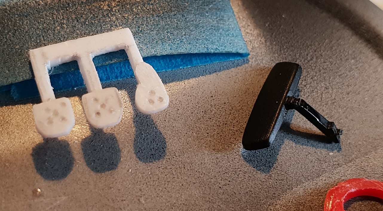

The rear view mirror broke & had to be glued back together, then kind of painted so it didn't look like glue.
the front badge is complete, sealed with Zero 1K clear
Then I decided that i really can't put this together without some pedals. I had nothing in the spares box, so I made some following some research off t'internet.
They are ready to be sprayed silver now...
