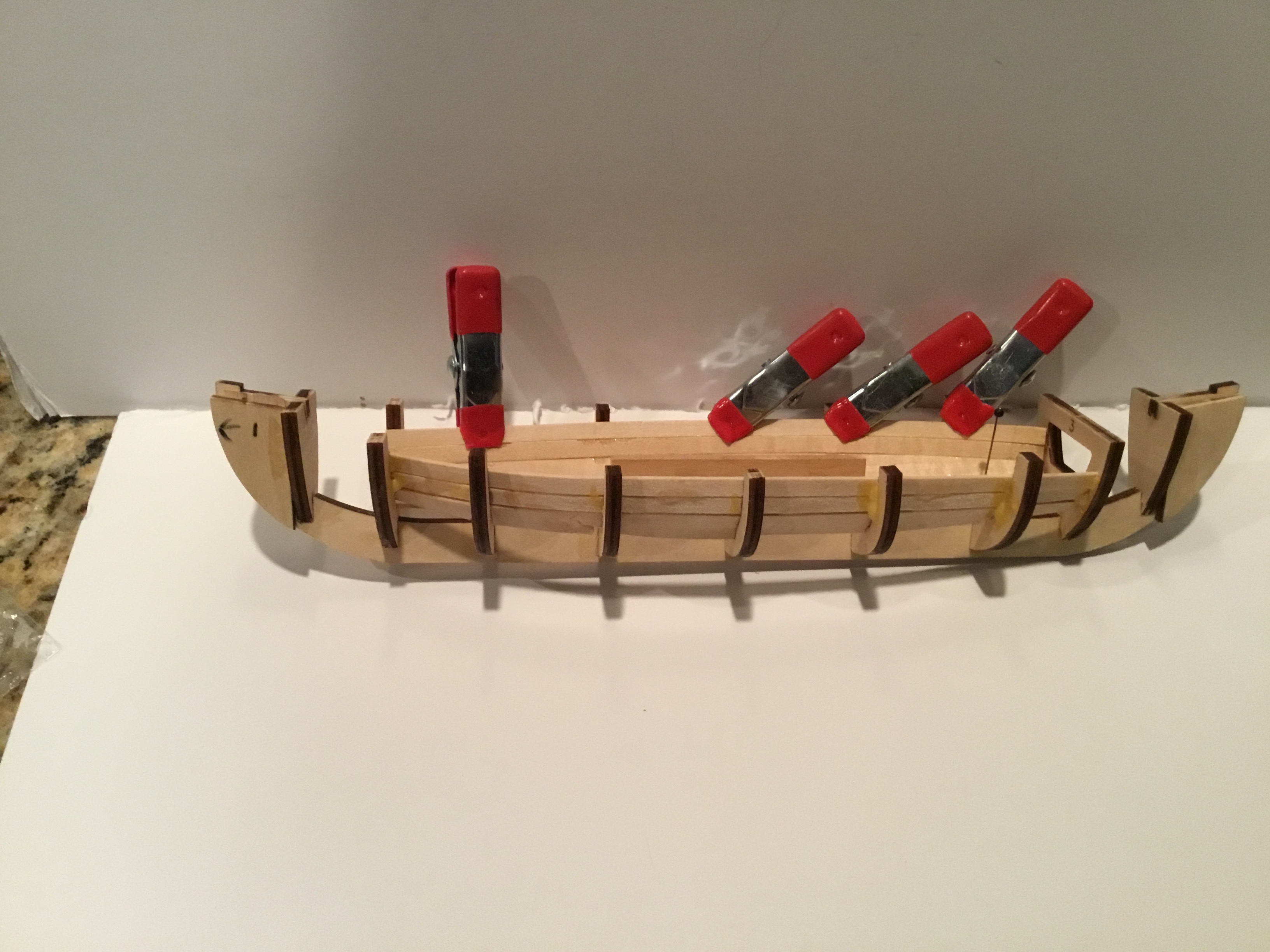

Was able to get some work done . Instructions are much better than the last kit but not without problems . Lots of different wood sticks of different sizes , thickness and length . Instructions may call out let’s say a number 10 but no sticks have numbers and no index to spell it out so some will be either trial and error or best guesstimate .

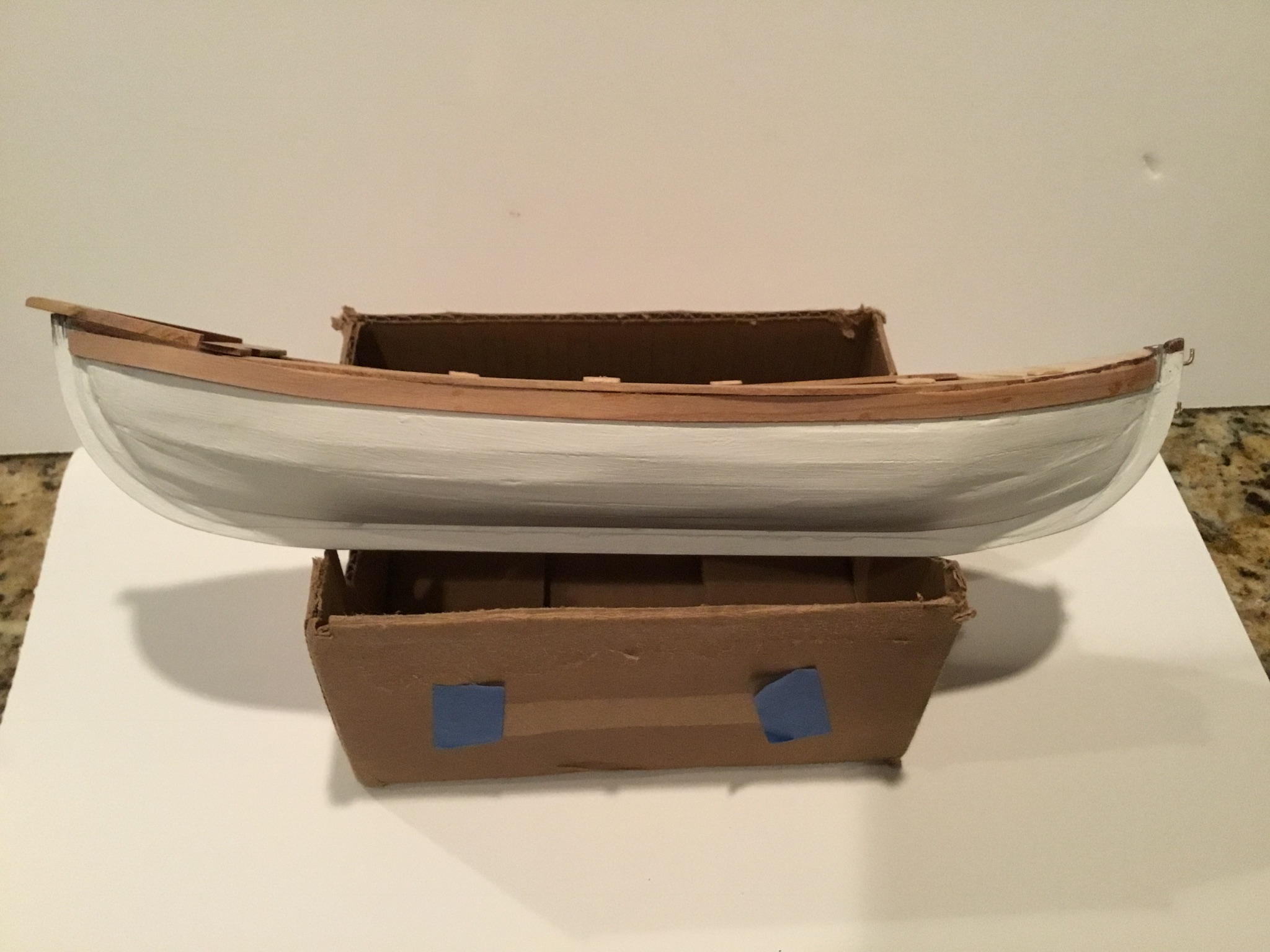

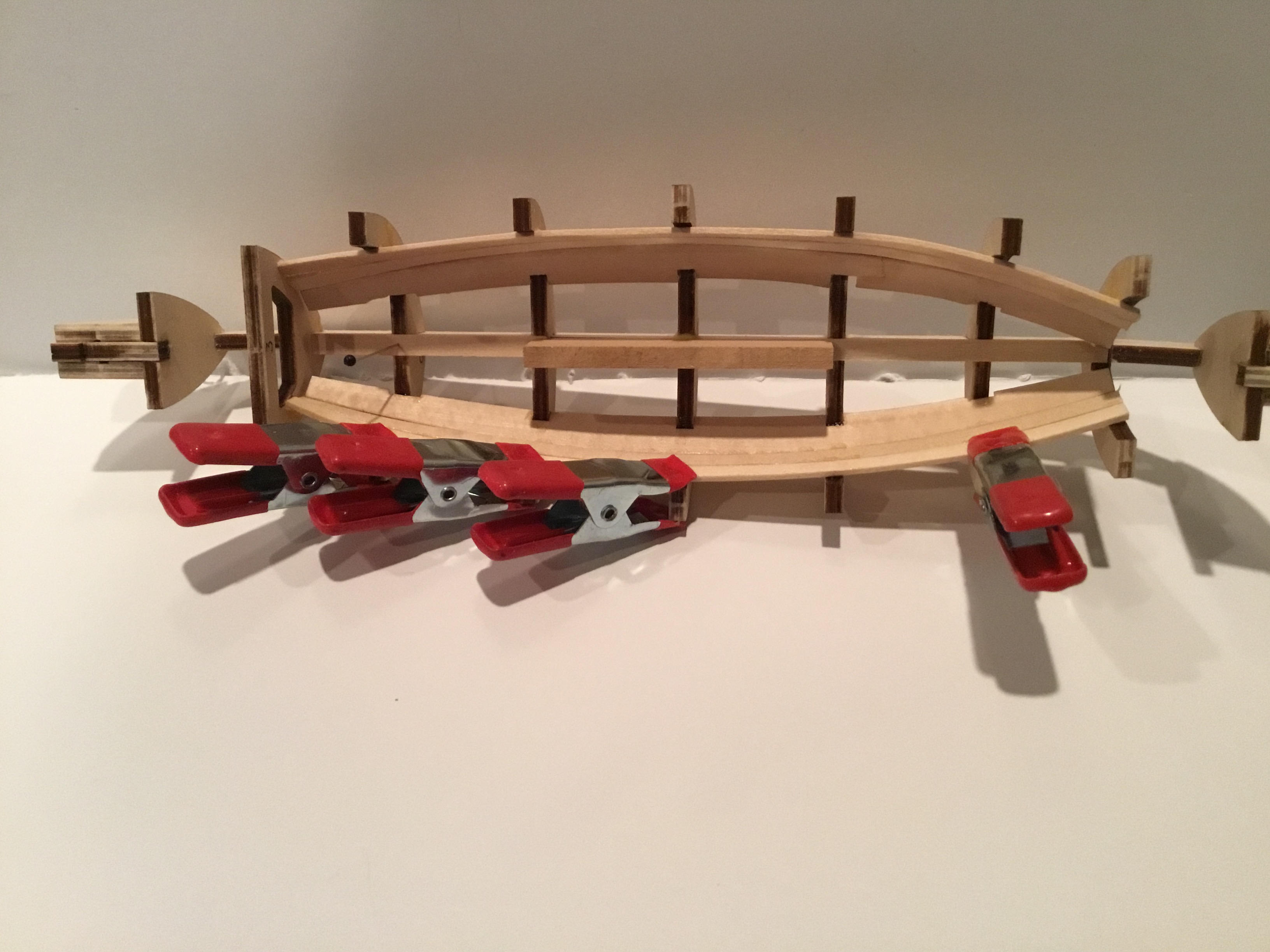

Made some progress on this kit. I will post photos later today or tomorrow. I learned one thing while working on this kit. A better kit does not make you a better builder. I had a lot of problems doing the planking on this one but I still find enjoyment in even the problems. The fact that I not once even thought of throwing it up against the wall proves I like building these things. Making errors for sure but I am hopeful this one will turn out better than the first.

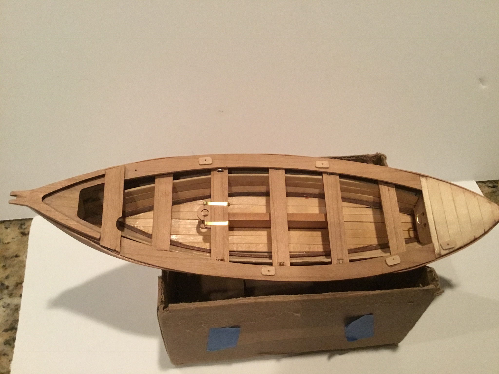

This is where I am now on this kit . Still a bit puzzled by these things but am learning at least some things as I muddle along . This kit is far and away better than the last one .
Thanks. I cheated with the planking. It was giving me fits and I ended up using some Tamiya putty to fill in the gaps. I still have to learn how to plank better.
I do have a planking tool and I soak the planking in rubbing alcohol as someone suggested and that helped a lot. As the planks curve up the hull they need to be tapered for a proper fit and lay down right. That's the part that gives me the biggest problem.
Looks good Ray.
Usually even the smaller boats (from kits) are double planked.  It's standard procedure after the 1st plank application, to putty and fill in the dents and voids that result from planking over the voids between the bulkheads.  Everyone does it, there is no other way to get the hull smooth enough otherwise.  No cheating involved, not to worry.
Hope you don't mind me posting an example of 'extensive' filling.  Here a hull done recently,  all the white stuff is an acrylic based wood putty (dries in 20 min. and easy to clean tools).  The 2nd planking is otherwise visible, already in progress.  Man I apply the soft and easily applied stuff from the tube direct to the hull and spread it out as evenly as possible with a butter knife.  After drying, it sands easily and quick with 180 grit;
When the hull is smooth, the 2nd planking is a breeze.  No more dents to worry about.

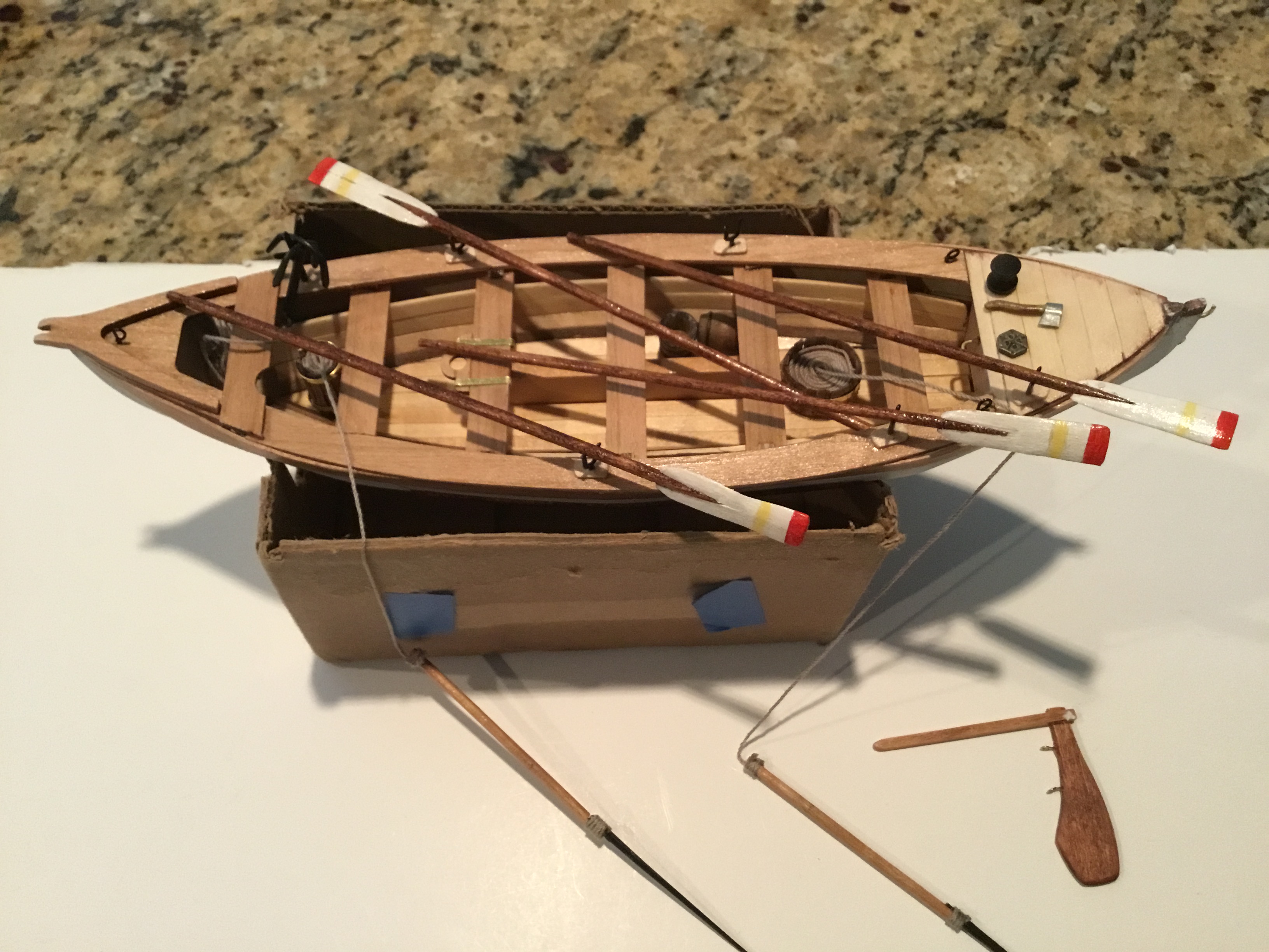

Making pretty good progress . Still making some errors but learning . Should be able to wrap this up sometime next week .
Ray, the boat looks REAL!

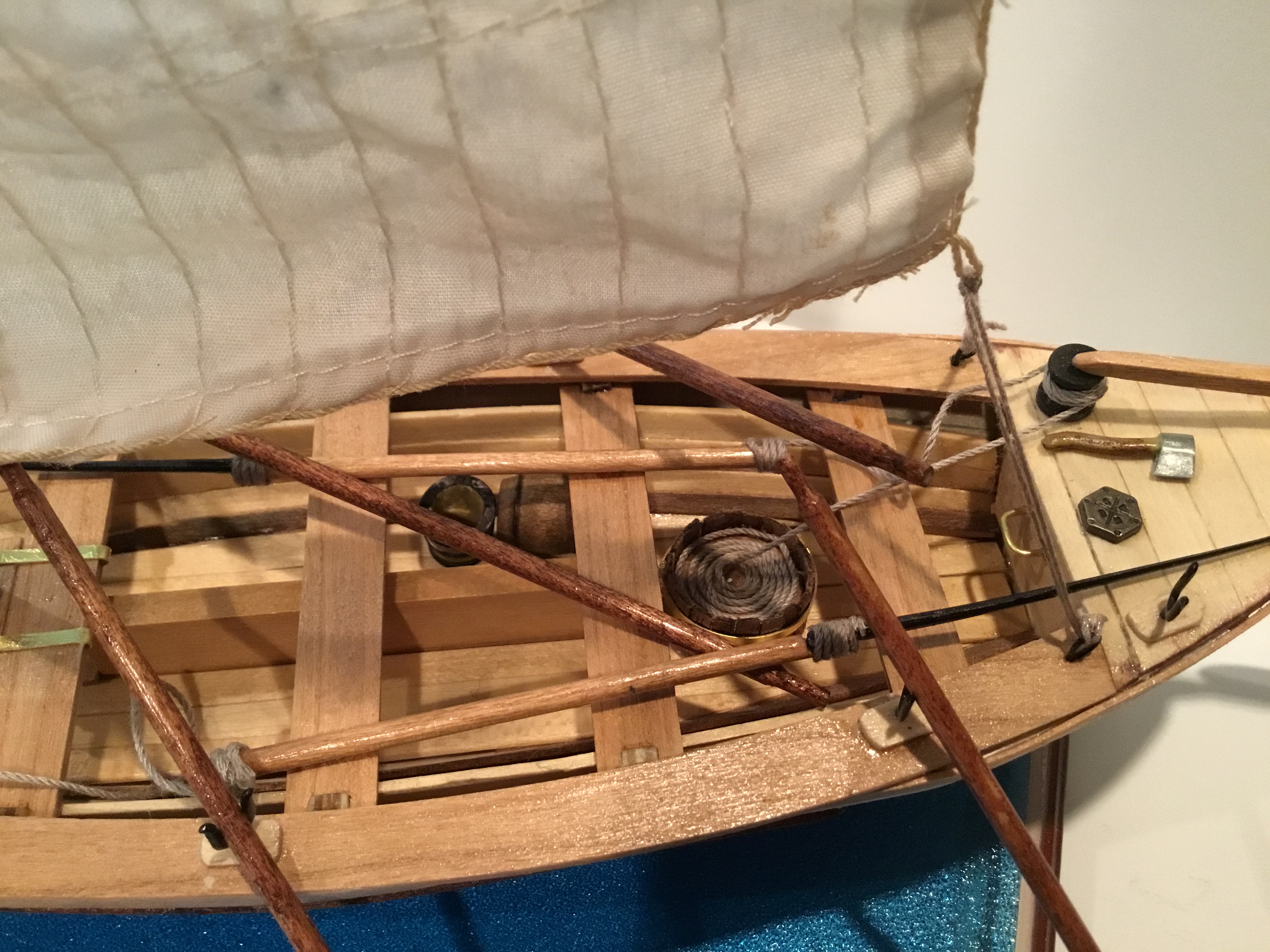

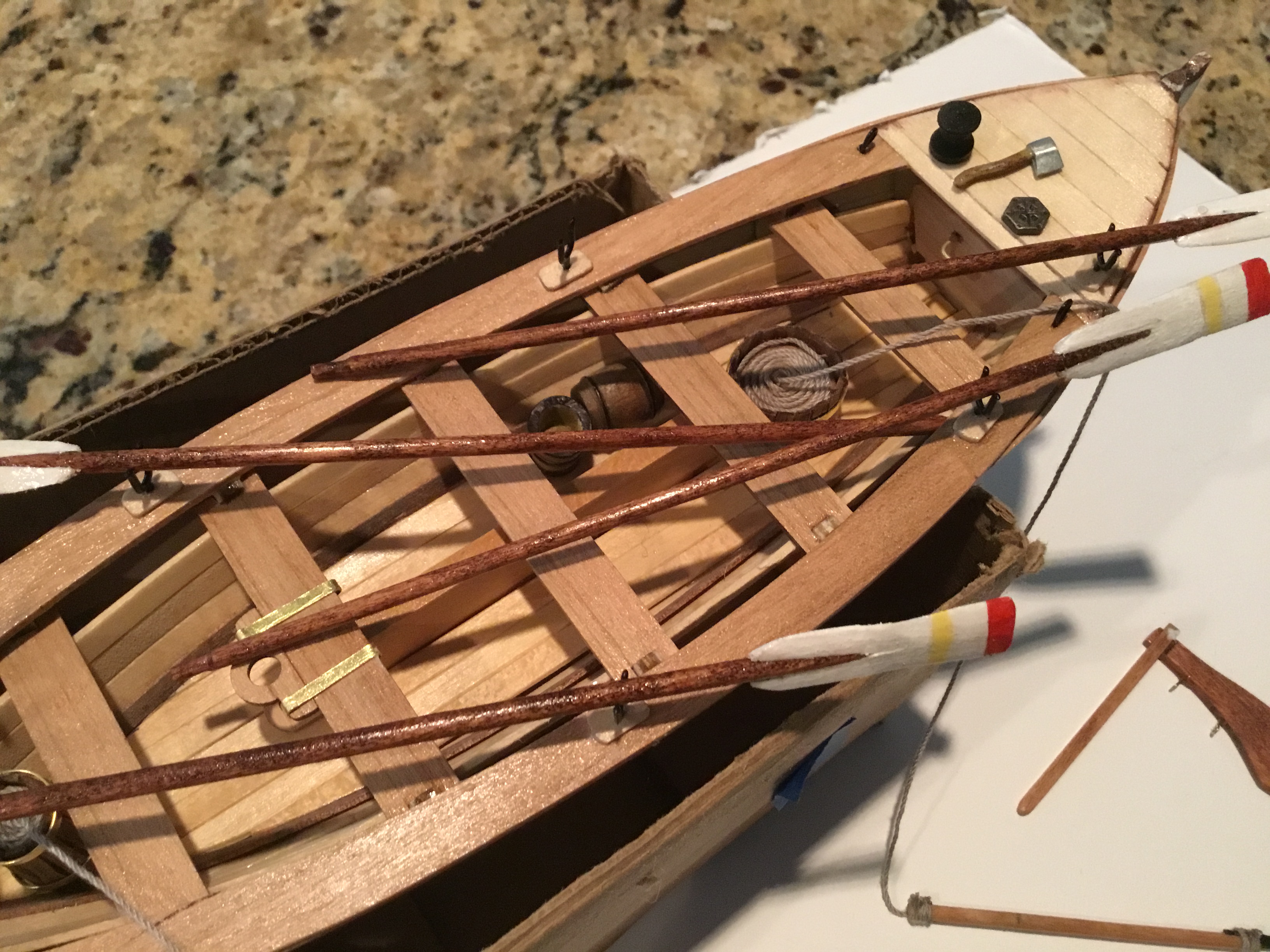

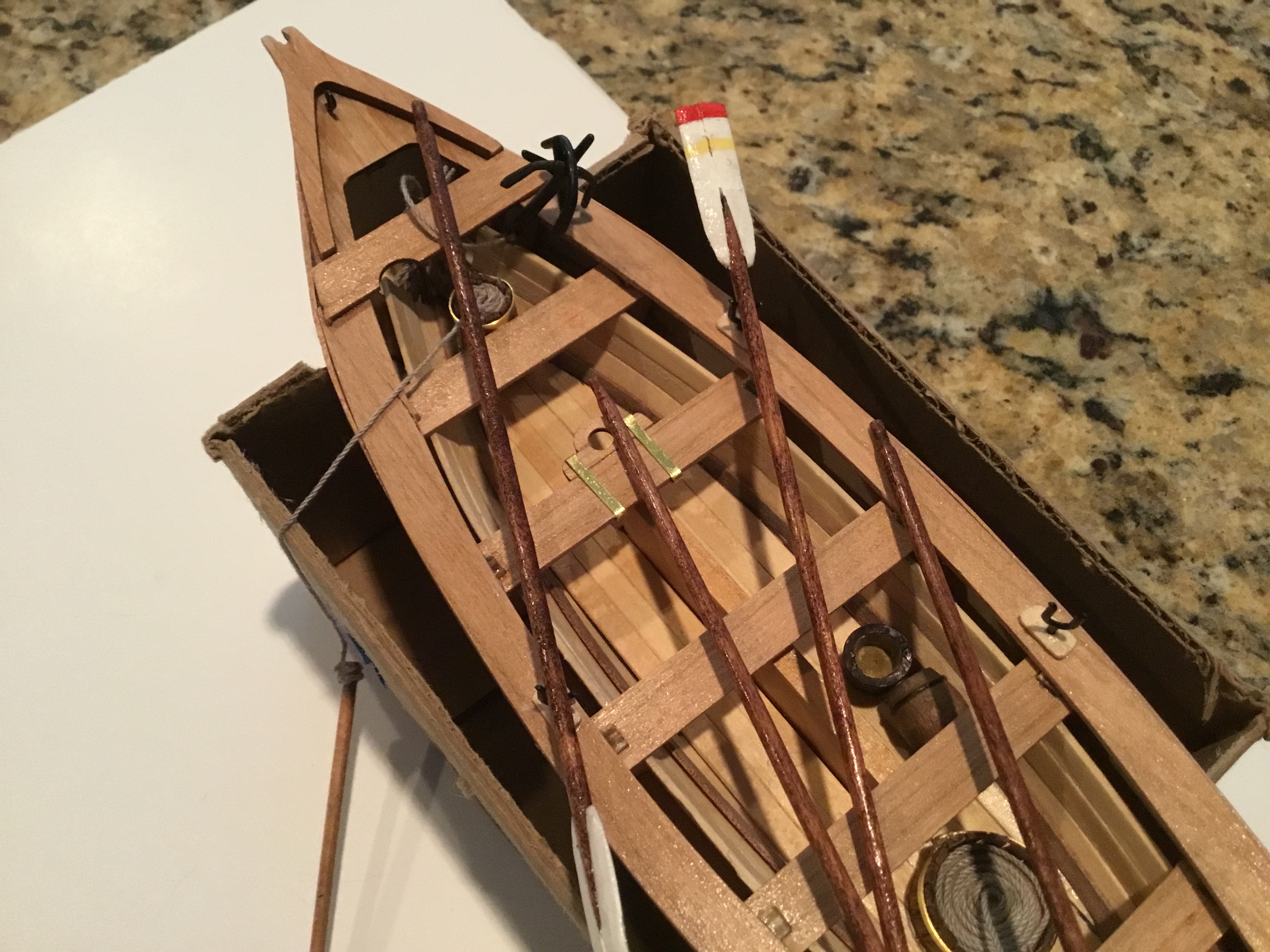

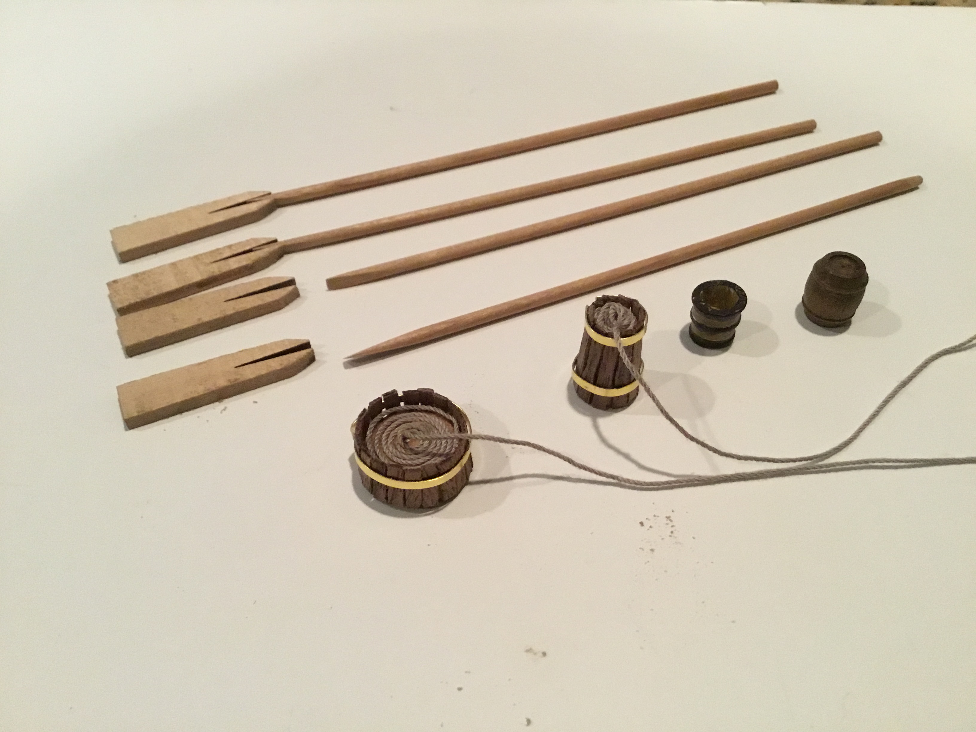

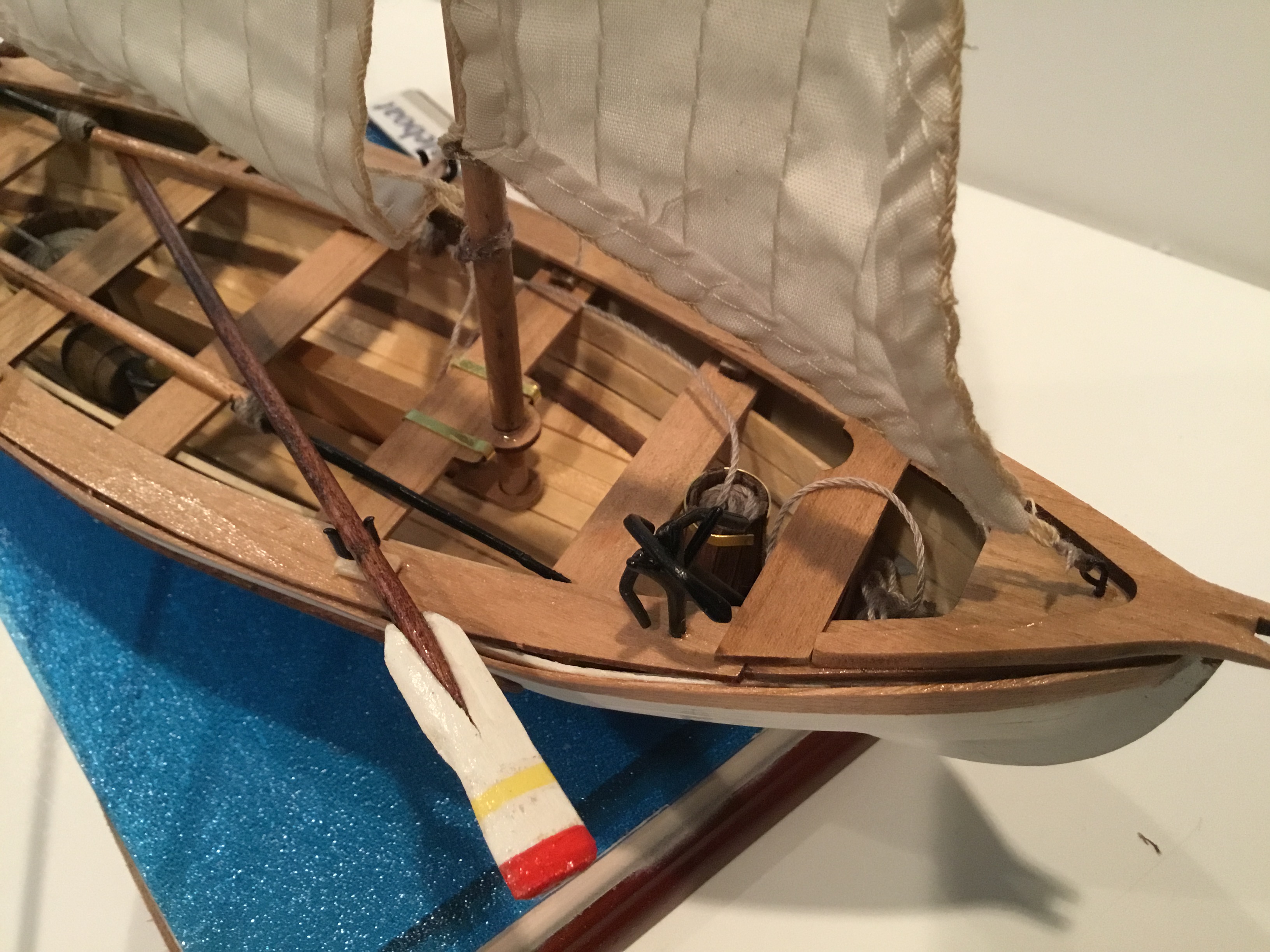

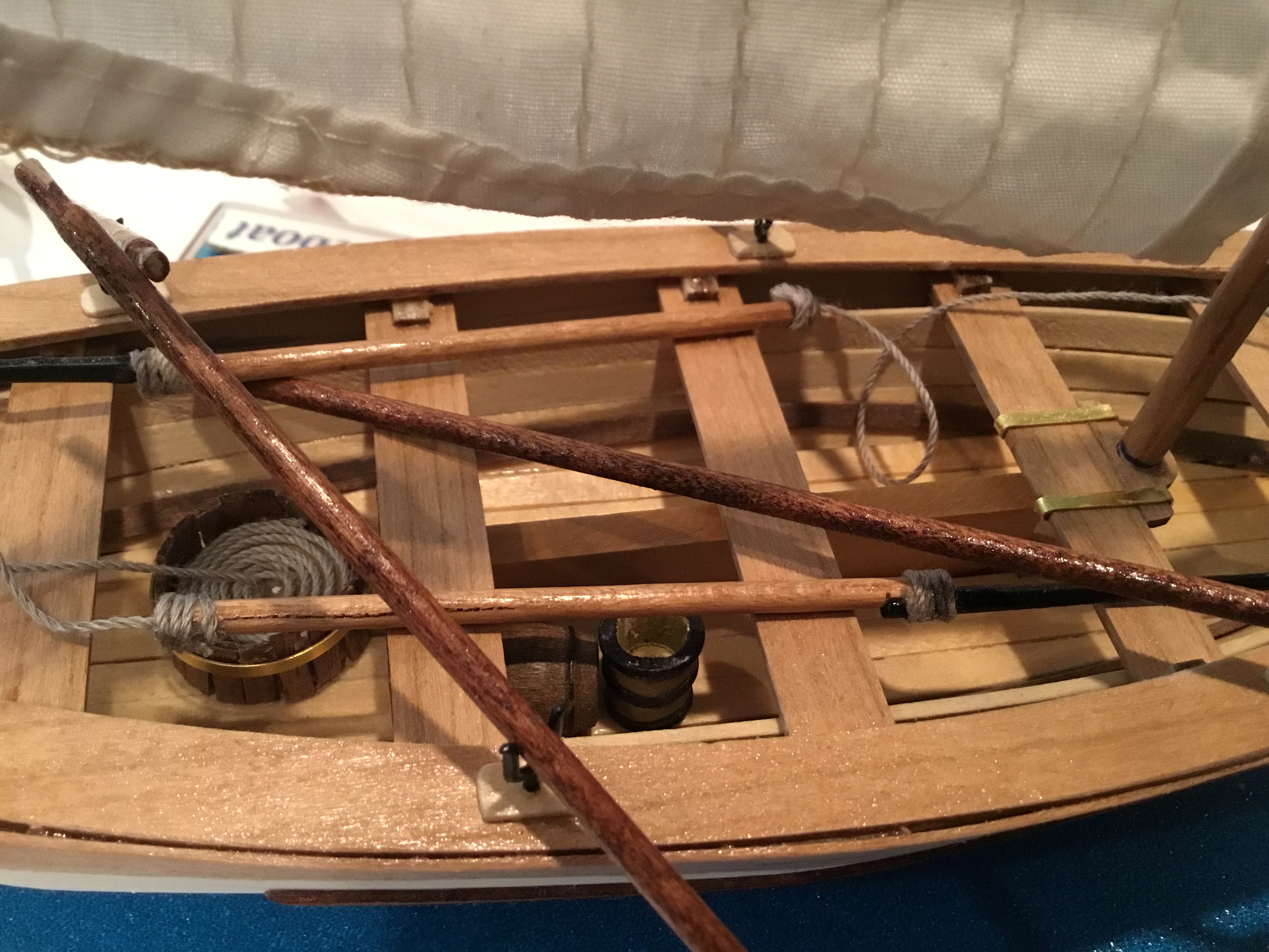

Thank you for the kind words. Lots of fitting and sanding of some parts like the oars. Pretty much a small block of wood that needs to be trimmed and shaped. Messed up some on them but I do enjoy the work and figuring out how do achieve the effect I'm looking for.

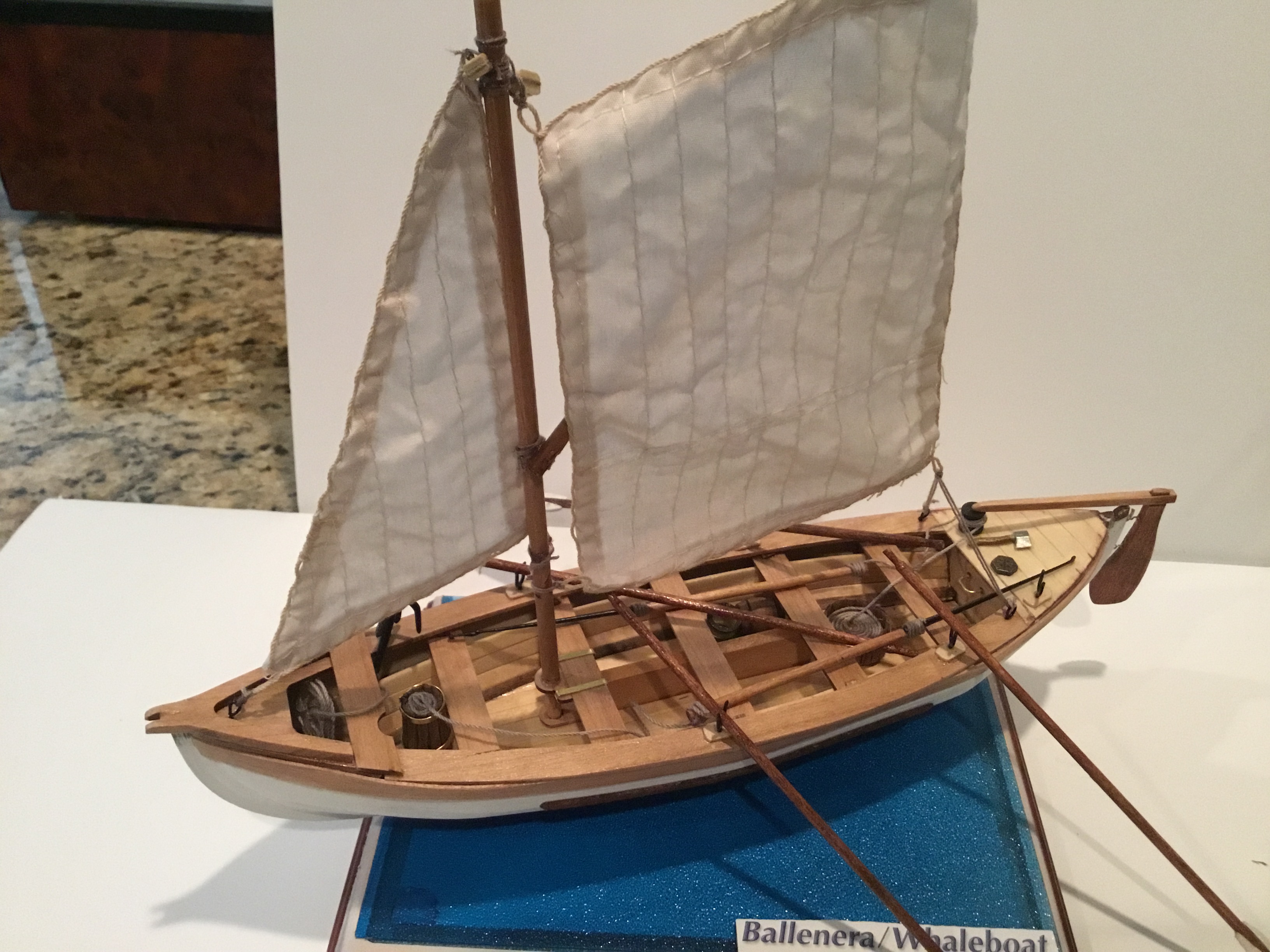

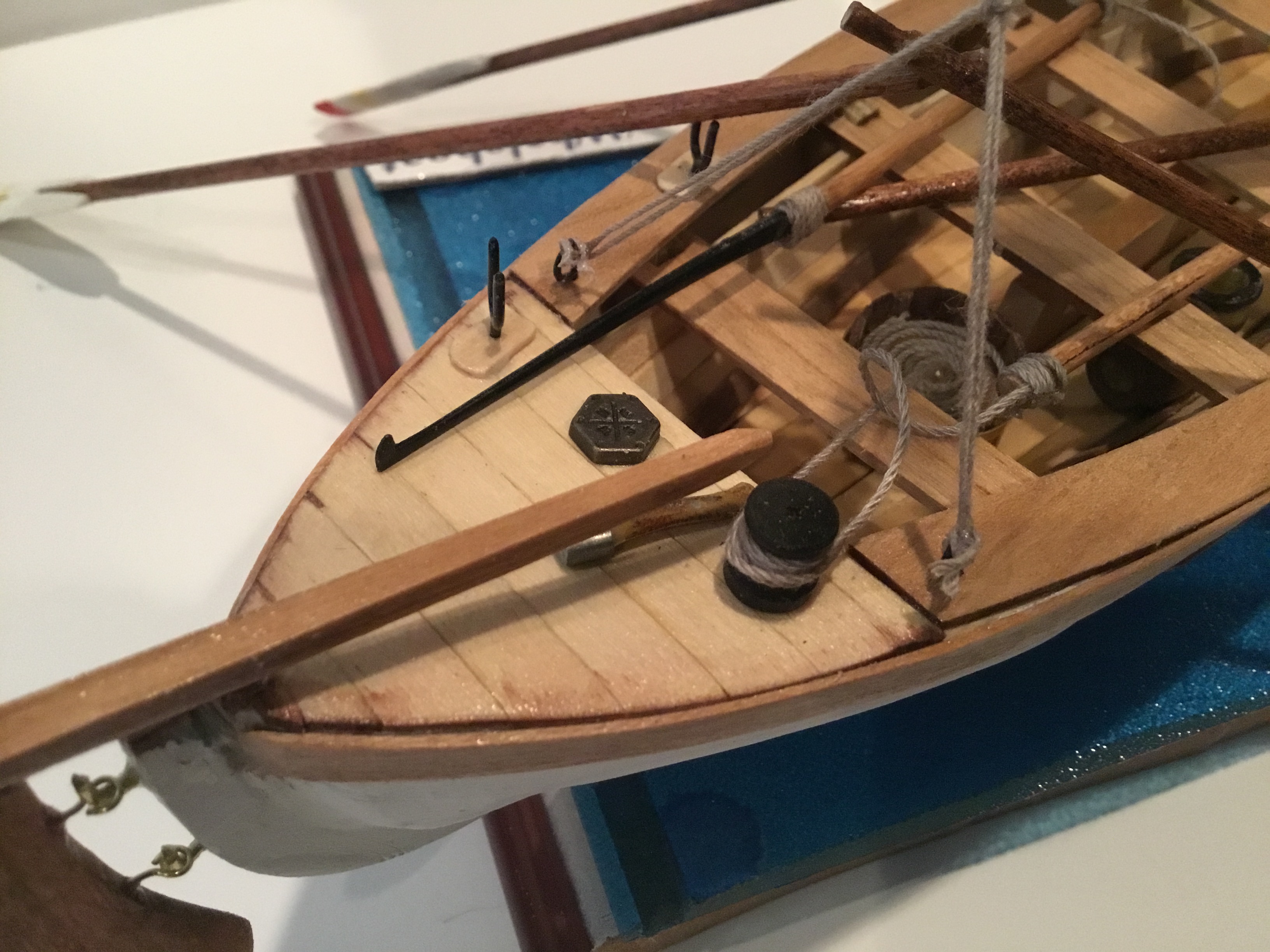

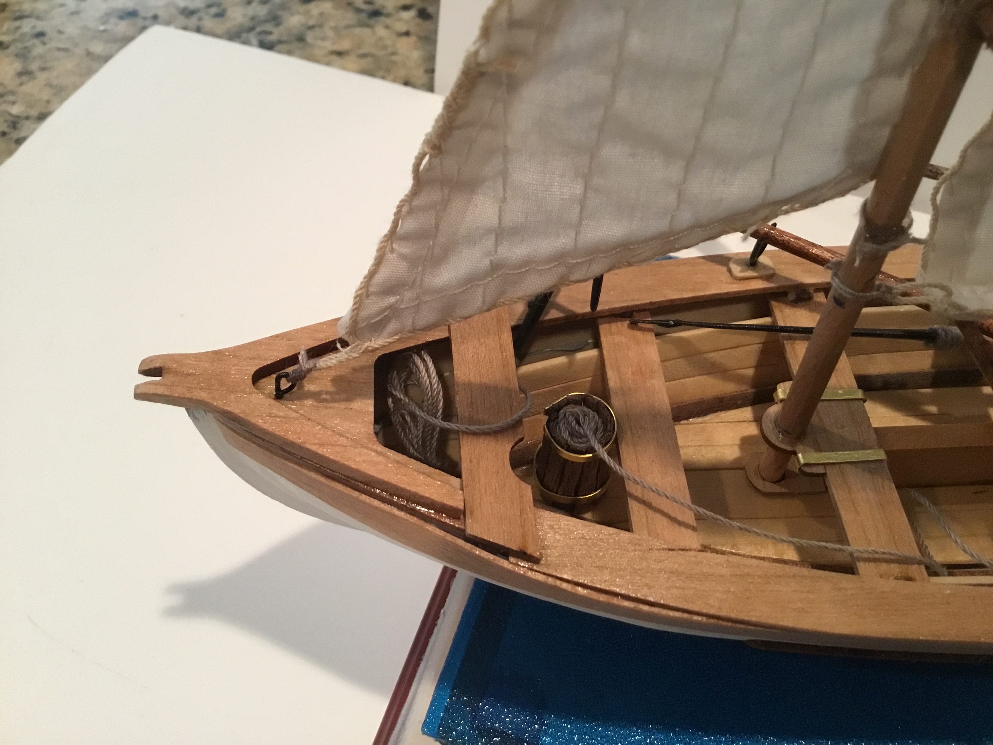

Here for good or bad is the finished product . Had some problems but I think it turned out pretty good . Still have more to learn to get better at these wooden kits .
