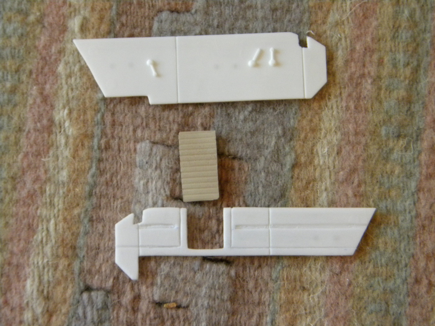

Well, I continue to go deeper into this project than I had intended!
I still have not decided exactly what I will do with the seats, but I have started to modify the door panels to replicate a standard '63 Fury.
I'm cutting up a set of the panels from the Lindberg '64 Belvedere, scribing some lines to add trim to & adding the pleated panel at the top of the door.
Making that pleated panel is an interesting technique that I saw somewhere & thought that I would try it.
It entails making a pleated mold from the tonneau cover from the AMT '59 El Camino kit & then filling the mold with cheapo acrylic craft paint.
When it dries it gives you a flexible panel that can be cut with a scissors & glued in place.
The tan piece in these photos is the panel molded from acrylic paint.
This photo shows the original '64 panel on the top & the pleated section & revamped door panel on the bottom.
This pic shows the same reconfigured panel on the bottom with the reverse side of the original panel that I am reworking for these panels.
I will be swapping the lower pleated portions of the door panels so I do not have to make new sections of those.
There will also be trim pieces applied to the scribed out sections of the panel to replicate the chrome trim.
Steve
