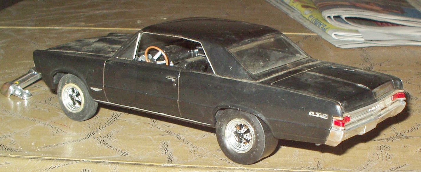

This built reissue (molded in tan, so I assume it’s the ‘80s boxing) ’65 GTO followed me home from the local toy show last month. Seemed to be a good candidate for one of my quickie “rescue” jobs.
If it had been almost any other kit, I’d have reworked it and had it back on the shelf in just a few hours. But the more I looked at it, the more I simply couldn’t live with the kit’s taillight treatment. Here’s what the kit rear end looks like, which bears little resemblance to a real ’65 GTO.

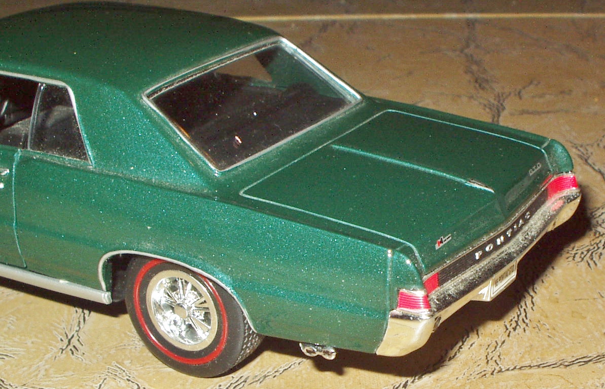

Even Welly’s cheap diecast got this area right—or at least a lot closer than AMT.

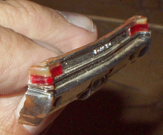

At first I thought I could fix the problem by filling the gaps between the too-small taillights and their trim with Elmers Sandable Carpenter’s Glue, applied in several stages over several evenings. The plan was to sand everything to shape (and I was hoping to avoid even that) and then paint the taillights and fill glue with Stop Light Red paint.

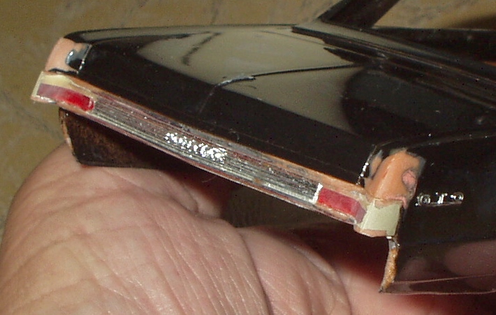

However, when I got that all done, I still didn’t like the shape. So I just puttied up the whole outer peaks of the taillights with Sikkens (tan/khaki color) and worked that down to a satisfactory shape. At first I was trying to do all this with the rear panel still attached to the rear bumper, but finally broke down and razor-sawed the rear panel free. This was a LOT easier to work with.

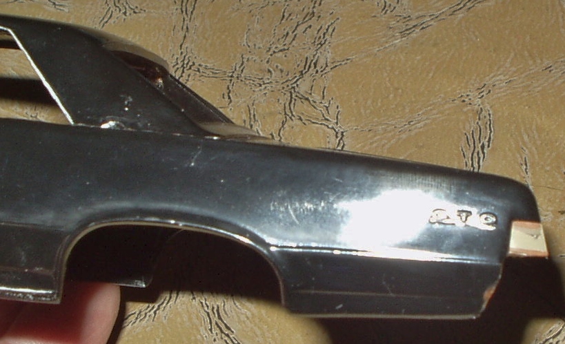

When I got the taillights where I wanted them, I taped the panel to the body and worked down the fender tips of the body to a more correct shape. Out of the box, the contour is more ’64 GTO than ’65. The tan body shows where/how I recontoured the mess.

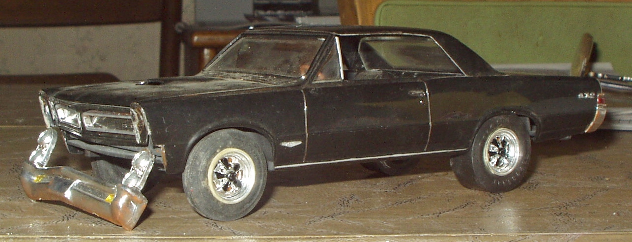

I've got the Modelhaus repop of the original promo front bumper/headlights, which is correct. Was saving it for a "good" build of a new kit, but frankly, who knows when I'll get around to THAT. So I think I'm gonna go ahead and stick it on this one until the time comes (if in fact it ever does) that I build my own. This will hold down the '65 GTO slot on my shelf until that happens.
I could even scrounge up a set of Rally Is and take this model back to factory stock, but I'm gonna leave it as a late '60s-early '70s street fighter. Its sit and attitude were what attracted me to it in the first place. OB sure got the stance right! B)

I got my Welly GTO at Rite Aide pharmacy

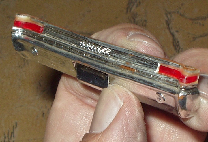

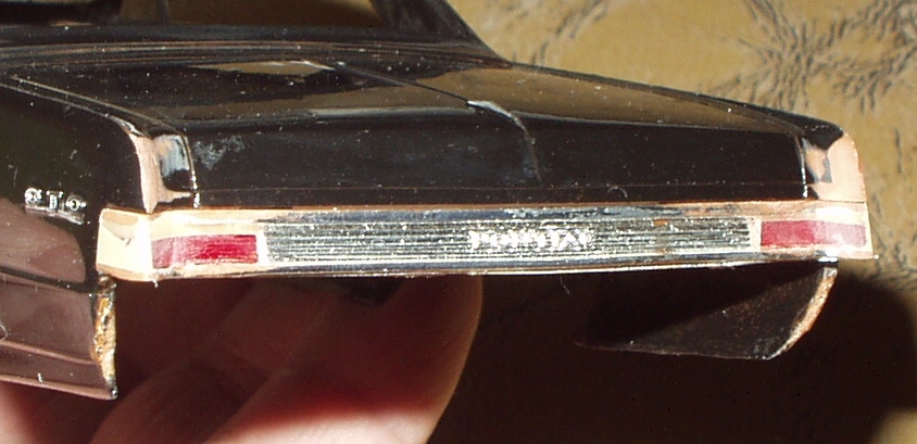

So here's what I ended up with. I covered my work (the taillight area) with Walmart aluminum tape, and then covered that with red cellophane from a Valentines Day candy box. I was gonna cut the red away at top and bottom for the trim strips, but got lazy and just drew the trim on with my beloved Silver Sharpie. This is a Glue Bomb Rescue, after all, not one of my "A" builds. I'll do it right when I build MINE. B) No, it's not perfect, but I think it looks 100% better than the kit parts.
